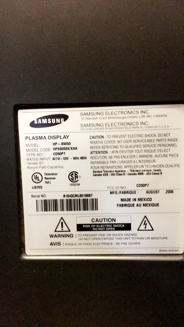

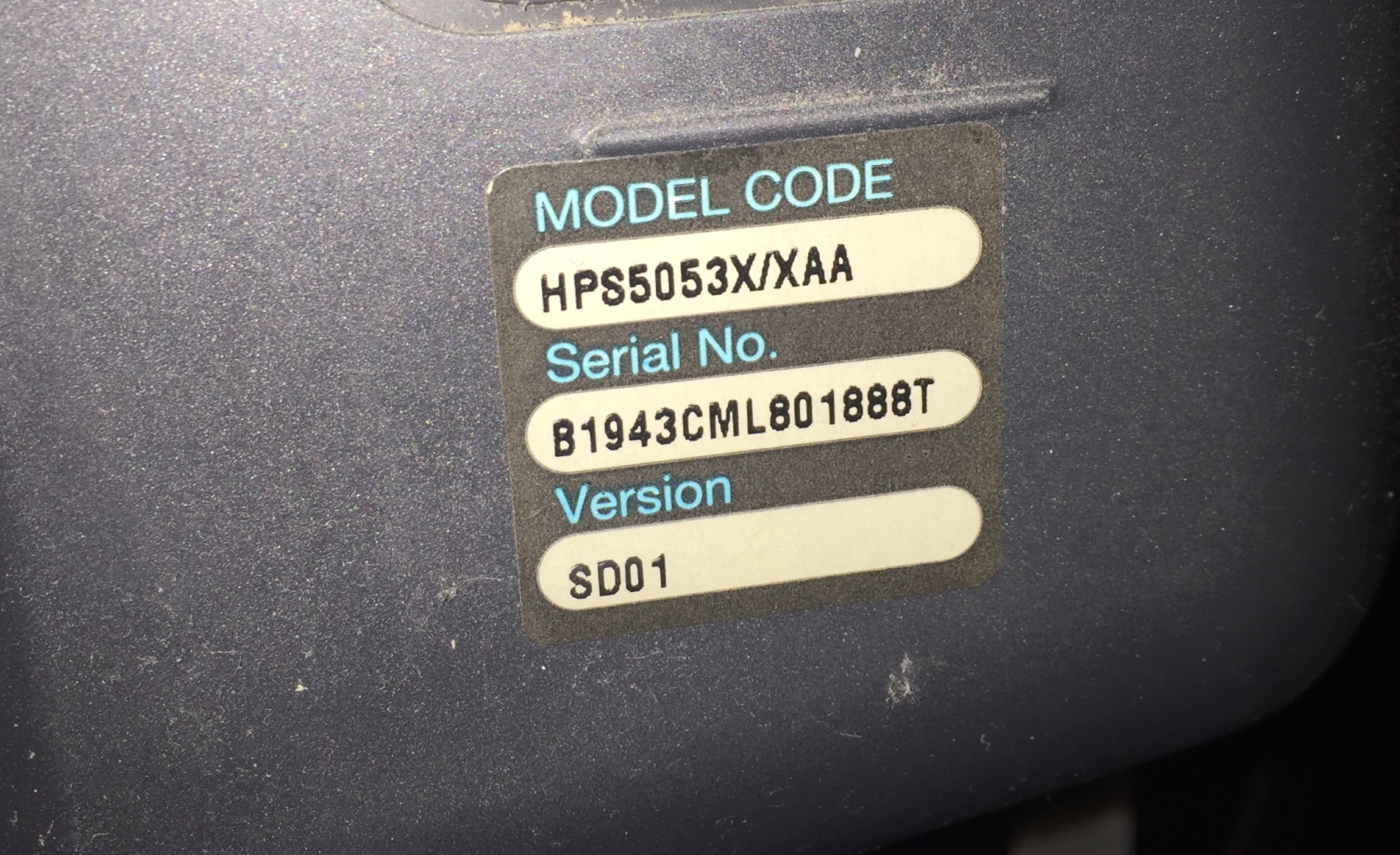

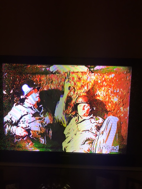

    Samsung hps5053x/xaa. Anyone have any idea of what could need to be replaced?

    clean the lvds cable first.then replace jumper coils on main board.L coils.if nothing happens change the tcon board

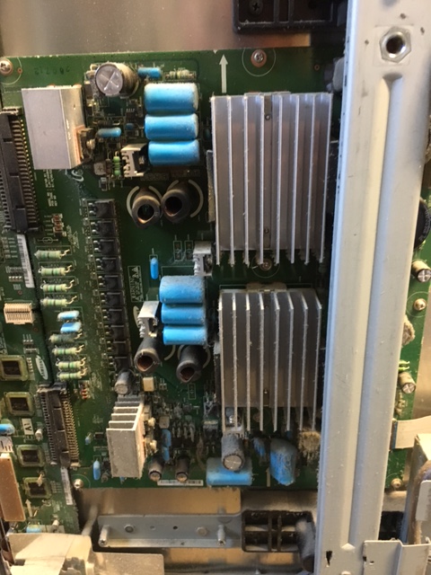

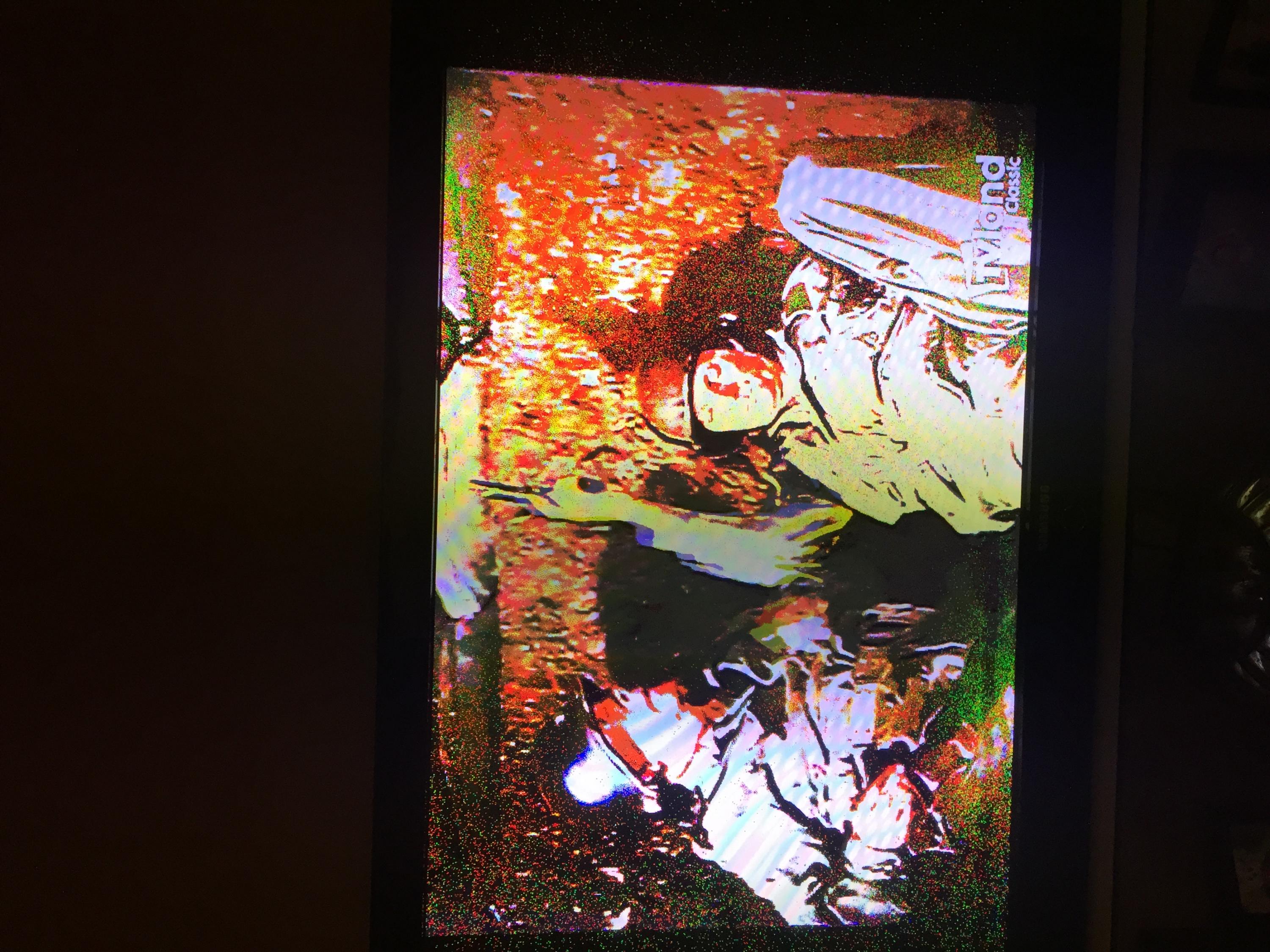

      Re: Samsung Distorted Screen
      Took the cover off...found two caps swelling...would this be the reason for the red and green dots all over the screen
        They would need to be replaced whether they are or not and they are cheap enough. Replace with high temperature, low ESR capacitors.
        I would also check all the solder joints on the board and make sure they are good.

            Ok sounds good. Do you believe all the dots could be caused by the capacitors swelling?

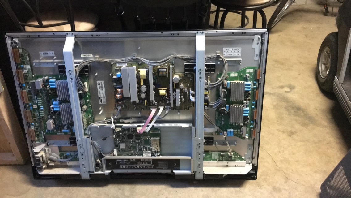

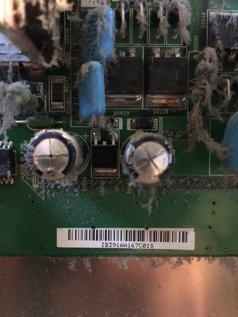

              Clean all that dust off, too. That looks like X-Board issue to me. That's the board on the right side looking from the back.
                Yes I have taken care of the dust now. I have two caps swollen (not on the X Board). I am going to replace the caps and then look into the X board. Anything in particular on the x that I should be looking for?
                  Basically cold solder joints, and measure the ESR on the e-caps on the X-Main and Y-main Bds. Measure the Vs, Va Ve, Vsc and Vy voltages and make sure they are in line with the voltages on the label.
                    I have found "working" X boards on Ebay really cheap. Y boards, not so much. I may just order an X board and go from there. I have been picking up so much time at work it is becoming hard to get to what I need to do at home. I have found a few x boards under $20, so that wont be much of a loss if that doesn't fix the issue.
                      Well, replaced the caps and screen is still jacked. May have to just order an x board anyway...
                        Well, I replaced the X board and the green and Red snowy screen is still there!!! Does anyone have any idea what it could be still?
                            Ok this is an LCD tv. Does not use an x board. X board is in a plasma tv. This honestly looks like an issue withh the eeprom on the mainboard.
                            Mute 1-8-2 power. Do this on thhe remote with the tv off. Look in service menu for lvds settings. Possibly someone got into menus and messed with it? Lvds bit rate possibly.
                              https://www.badcaps.net/forum/attach...1&d=1509508932
                              It is Plasma TV.
                              • freakaftr8
                                • Oct 2012
                                • 3743
                                Oh stupid me .lol I thought it said LNT.
                                For.some reason I'm not able to view pictures lately.
                                But I would suspect something going on with y sustain. Have you measured all voltages yet? What's your VSCAN reading?
