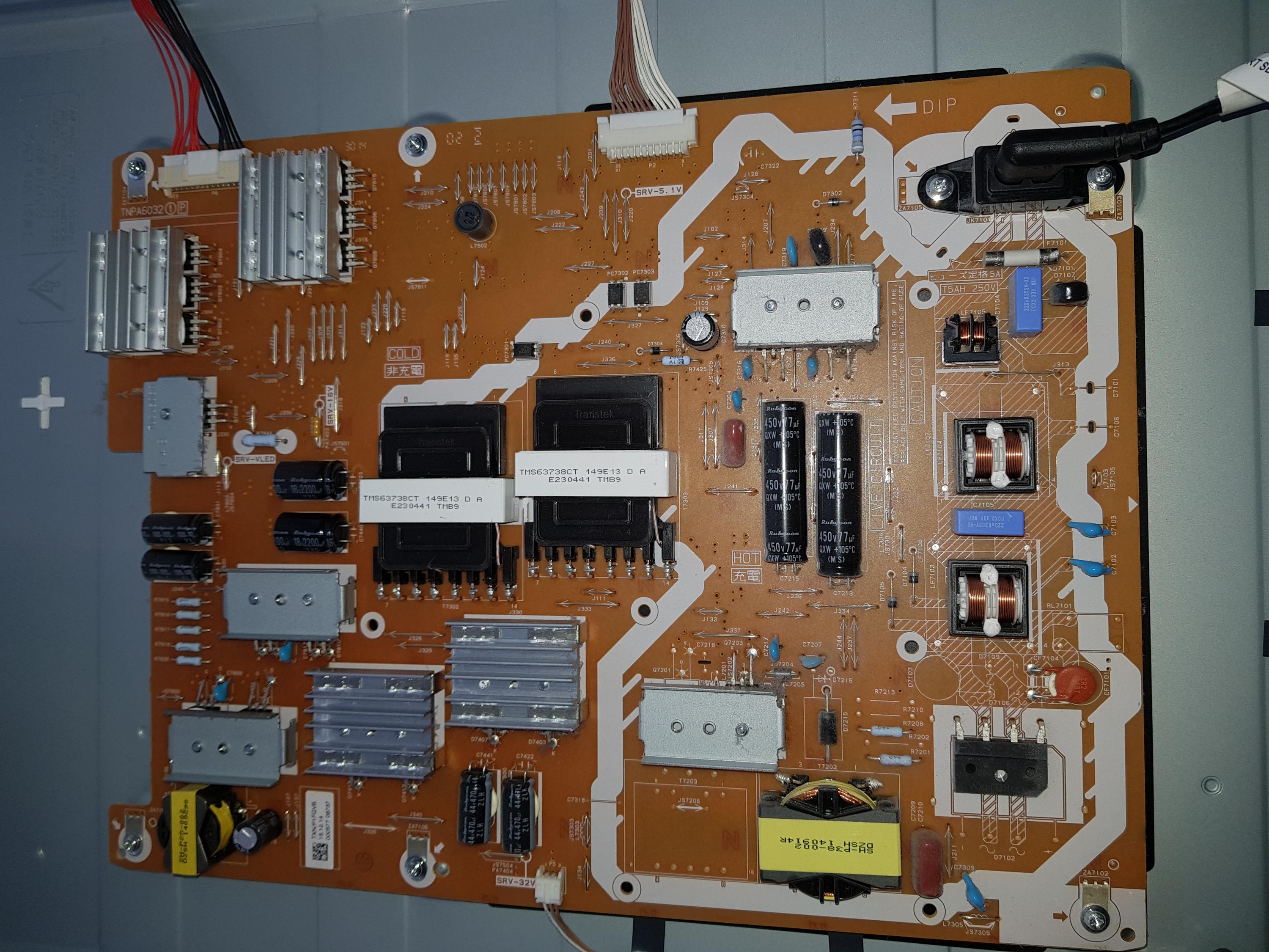

    hello guys
    has anyone come across this fault i`m leaning towards a faulty led but just wanted confirmation on this first
    symptons:
    The back light blinks once but still no picture or back light
    voltages on the PSU
    SRV 5.1v =4.9 volts steady
    SRV 32v =0.0 volts but 32v once tv first turns on then drops to 0
    SRV 16V =0.0 volts nothing even when tv is turned on
    SRV VLED = 70v once tv turns on but drops to 32v then slowly decreases
    thanks

        It looks like you have 6 LED strings so it has 6 power MOSFETs mounted on the heatsink for the LED current return controllers.
        1) TV off, black probe on the chassis, Red probe on one of the six black wire of the LED connector, turn on the TV and record the Voltage reading.
        2) Repeat the procedure as in step 1 on the other 5 black wires.
        3) Report all six readings.

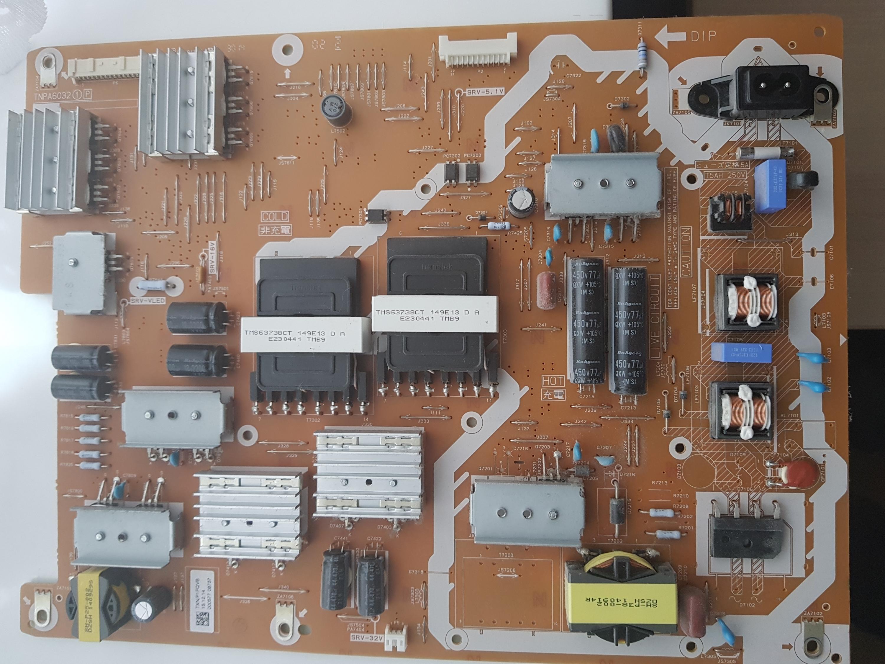

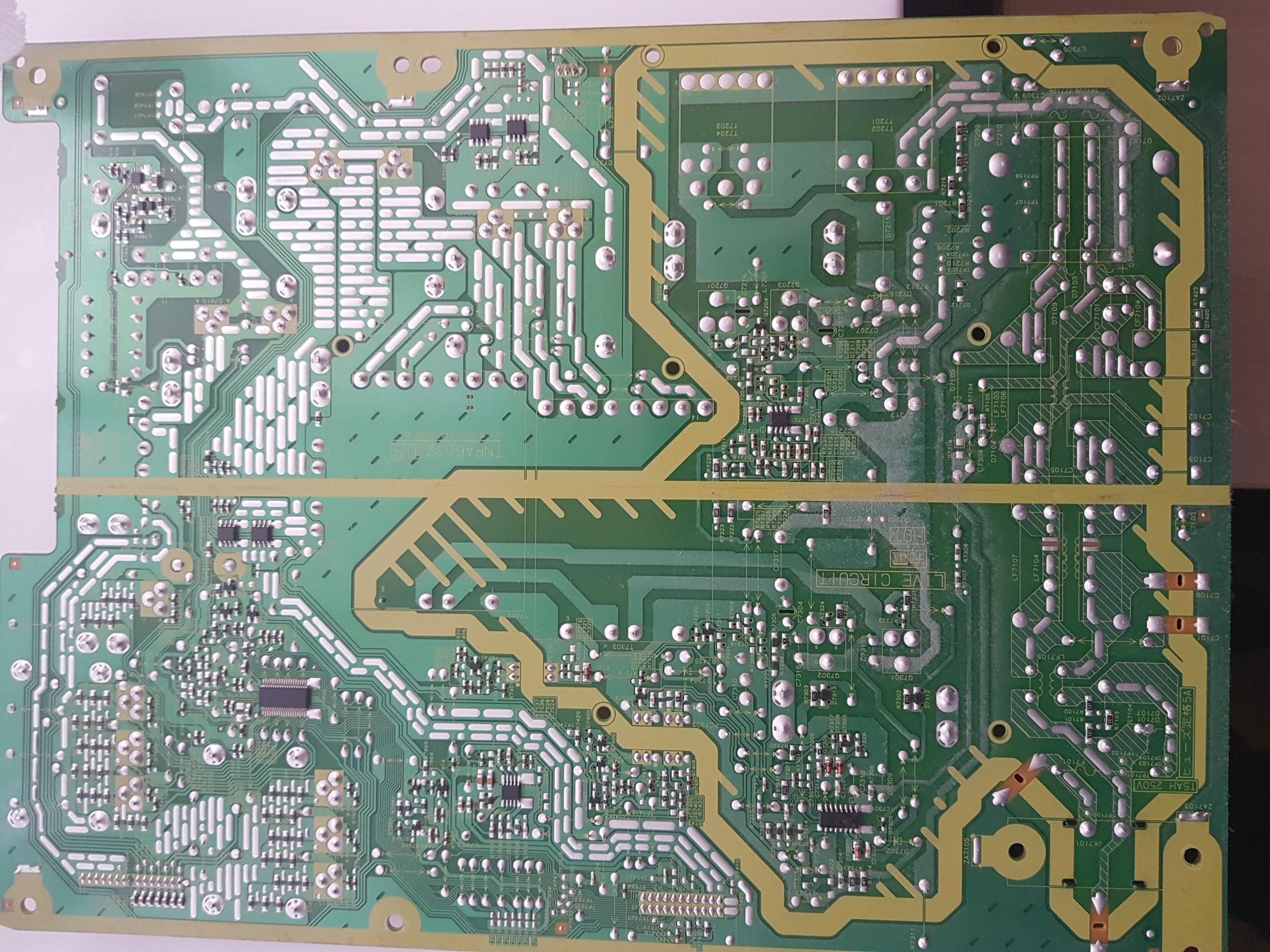

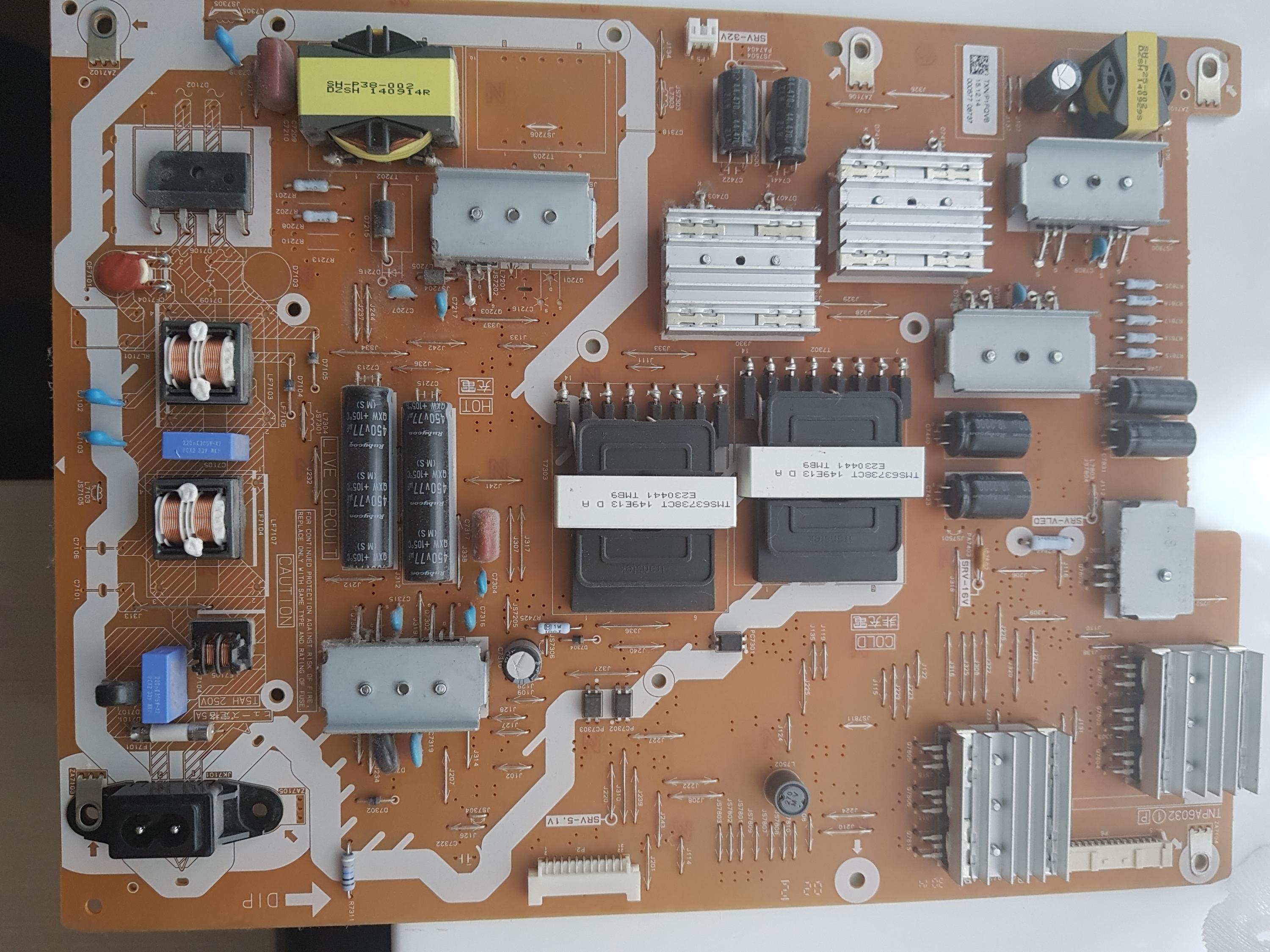

        BTW, please provide straight shot picture of the top and bottom side of the power supply board.

          P6 led connector has 7 black wires
          black pin 1 jumps to 36v when tv turns on then decreases
          black pin 2 jumps to 36v when tv turns on then decreases
          black pin 3 no reading
          black pin 4 jumps to 36v when tv turns on then decreases
          black pin 5 jumps to 36v when tv turns on then decreases
          black pin 6 jumps to 36v when tv turns on then decreases
          black pin 7 jumps to 36v when tv turns on then decreases
          pictures attached so im thinking its pointing to a bad led ?

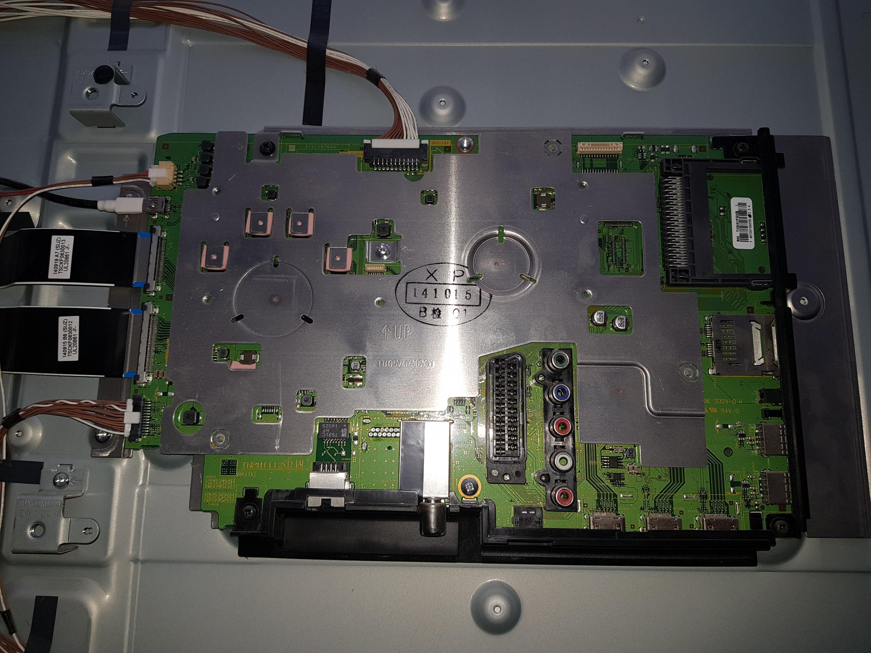

            i cant seem to get the pictures to face upwards

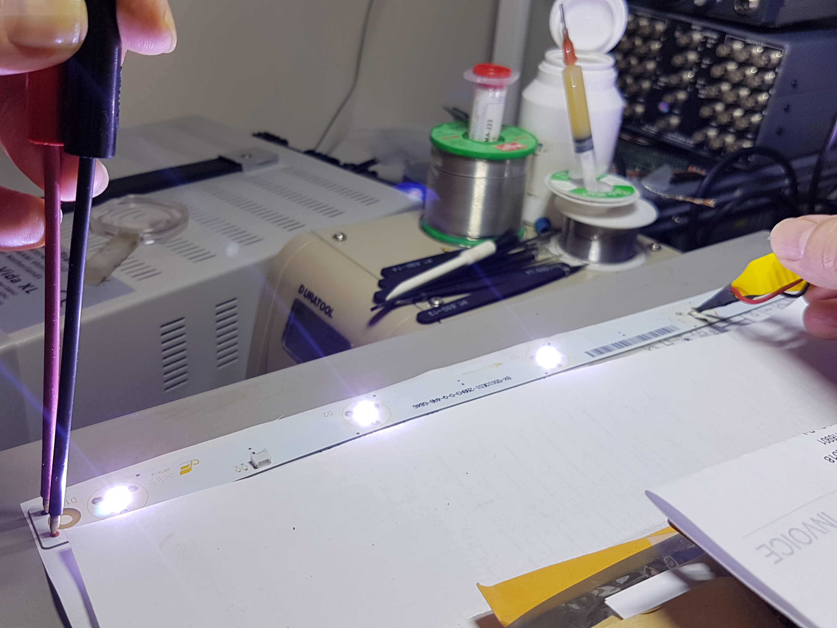

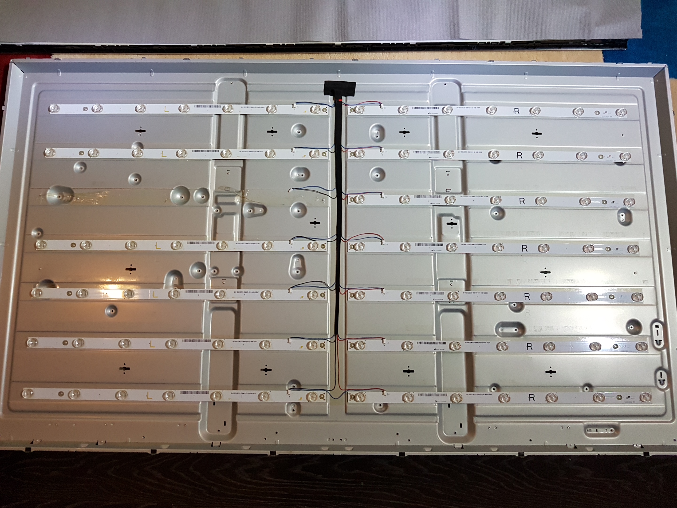

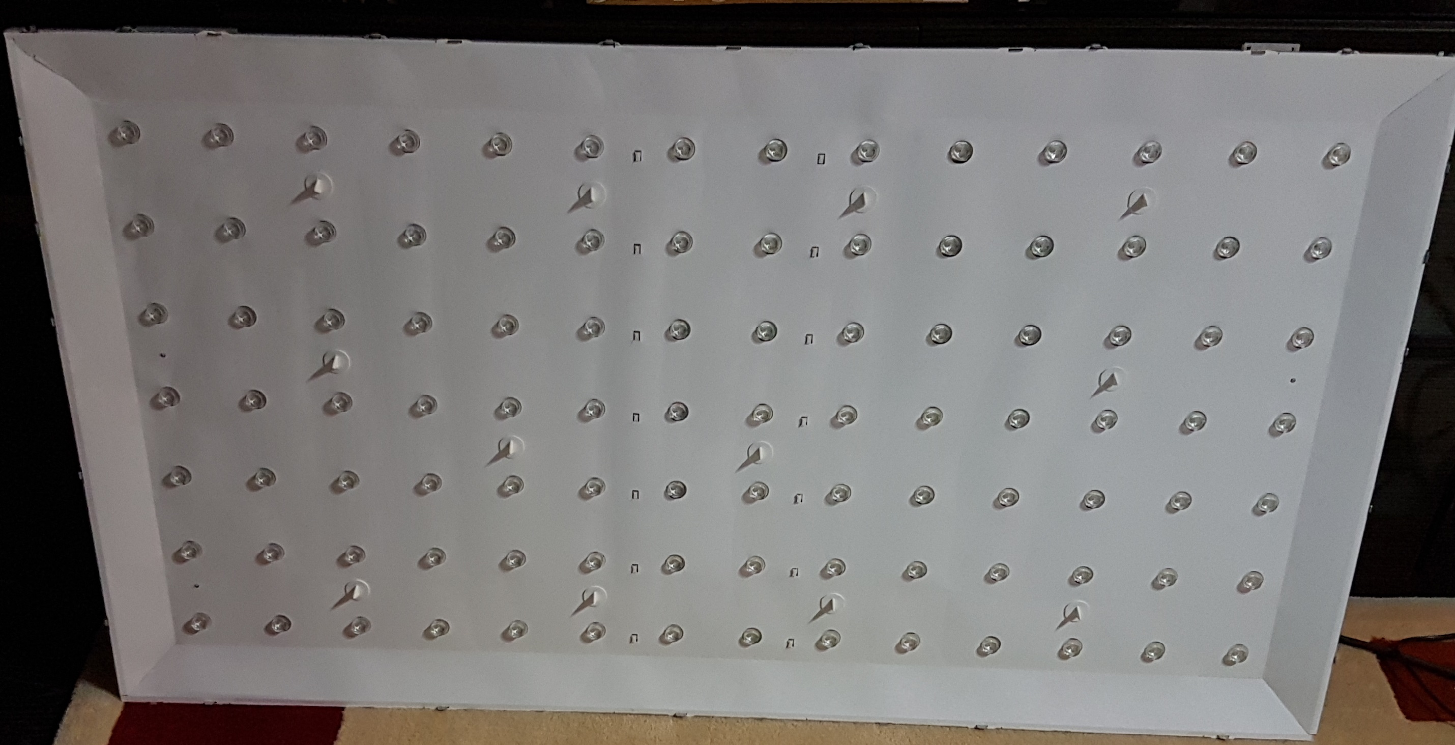

                              I've now found and fixed the problem.
                              This models back-light has 7 rows of l.e.d.s
                              Each row has a left & right string of 7 l.e.d.s. So each row has 14 l.e.ds making a total of 98 for the complete back-light. The left & right strings are wired in series.
                              7 mosfet drivers power the back-light through 7 pairs of Red & Black wires.
                              If any Black wire return current is low it means there is a problem on that row (at least one l.e.d has failed).

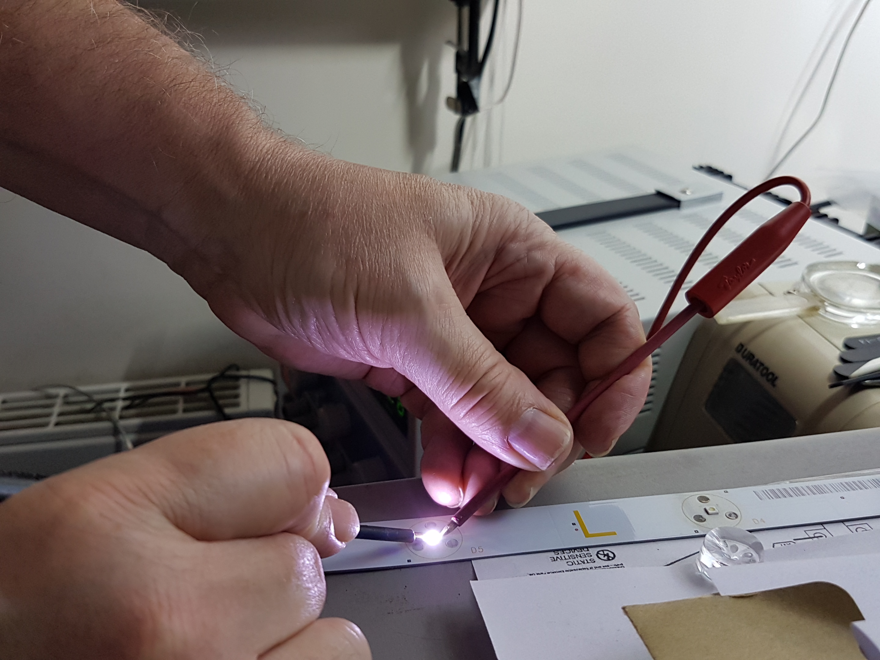

                              If the l.e.d is open then the whole string will be down and so you will need to test each l.e.d individually. 20v is enough to test each string initially to find the faulty one(s). I set a power supply to 20v @ 150mA which is enough to light the good strings without blinding yourself.
                              Replace faulty l.e.d.s with 3v types.

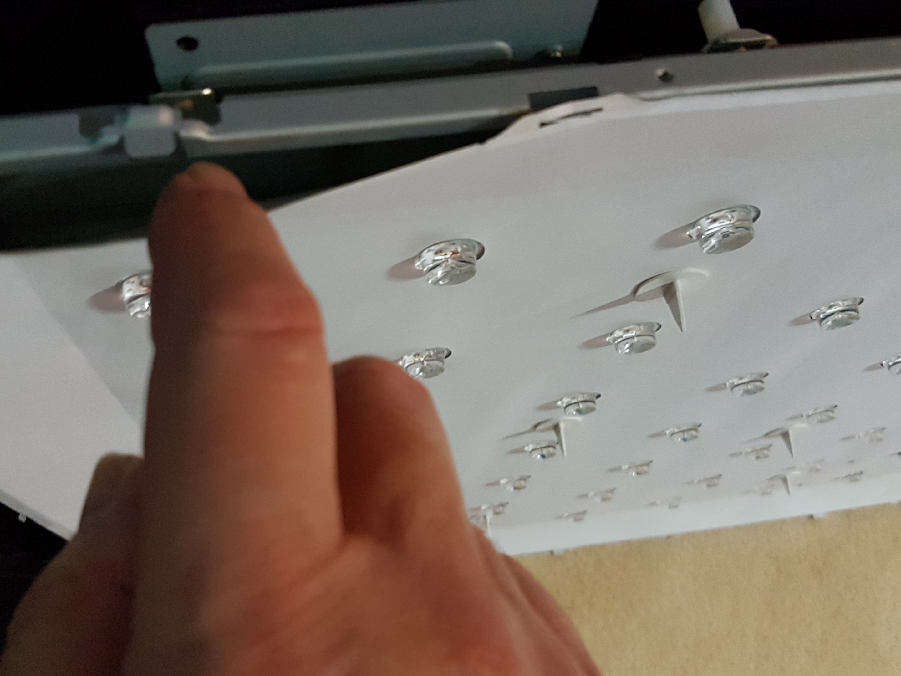

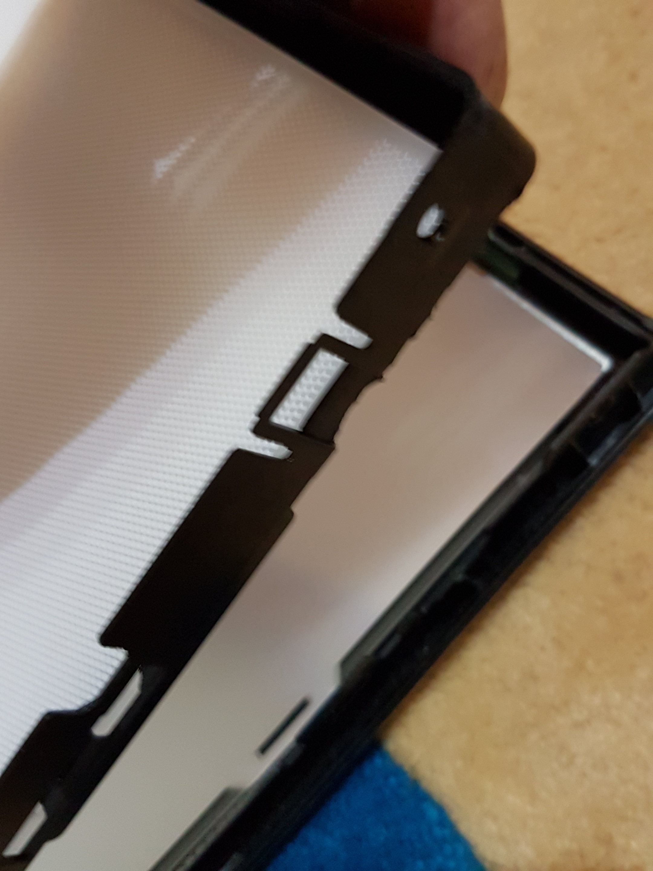

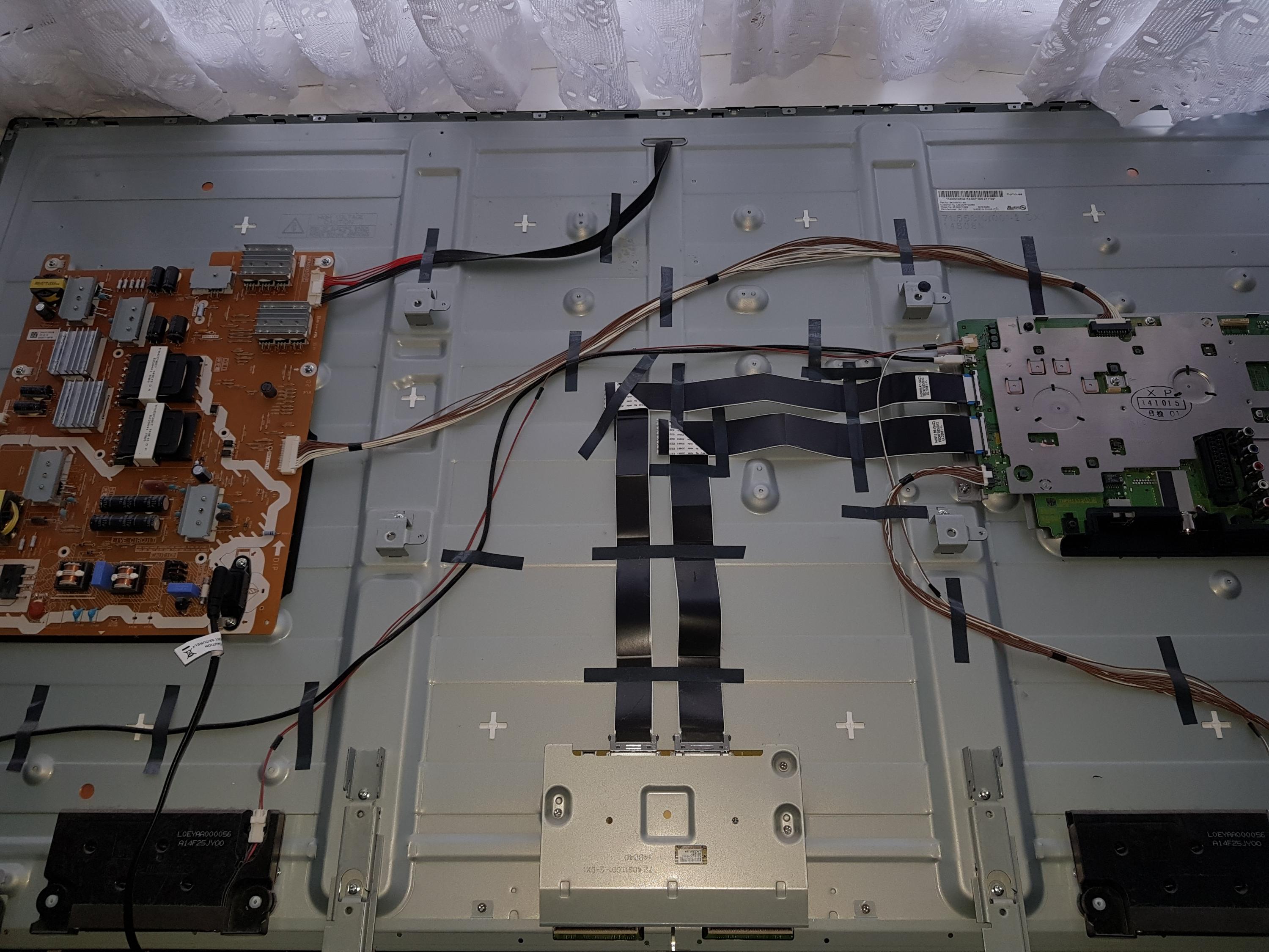

                              Taking a large panel apart is not for the faint hearted so make sure you support the panel glass and LCD properly. Remove all the countersunk edge screws and then release the plastic surround which is held on with a multitude of catches that will catch again as they did with me so another pair of hands would be useful at this stage. I didn't have this luxury but managed anyway.
                              If doing this alone it's best to reduce the weight by removing all the boards first and the metal pieces where the stand fit to so you dont damage the pcb edge of the LCD.
                              Everything is glued in place. The back-light has a White thin plastic reflector glued to the metal chassis which needs careful removal using a sharp knife around the edges and some careful pulling.
                              Once removed the l.e.d strings can be tested in situ to find the bad one(s).
                              The strings are also held tightly in place with thin double-sided tape which will tear easily so take it easy and you wont need to renew it. Also be careful because the string pcb is very thin. You don't want to damage it.
                              Pry off the l.e.d diffuser with a knife.. fit a new l.e.d and before re-gluing the diffuser clean the old glue from both the diffuser and the pcb to ensure the diffuser sits flat otherwise you risk a bright spot on your screen.
                              The Red standby light 1 second flash every 4 seconds points to this fault although obviously a failed smps could do the same but in most cases suspect the back-light.
                              Tony
