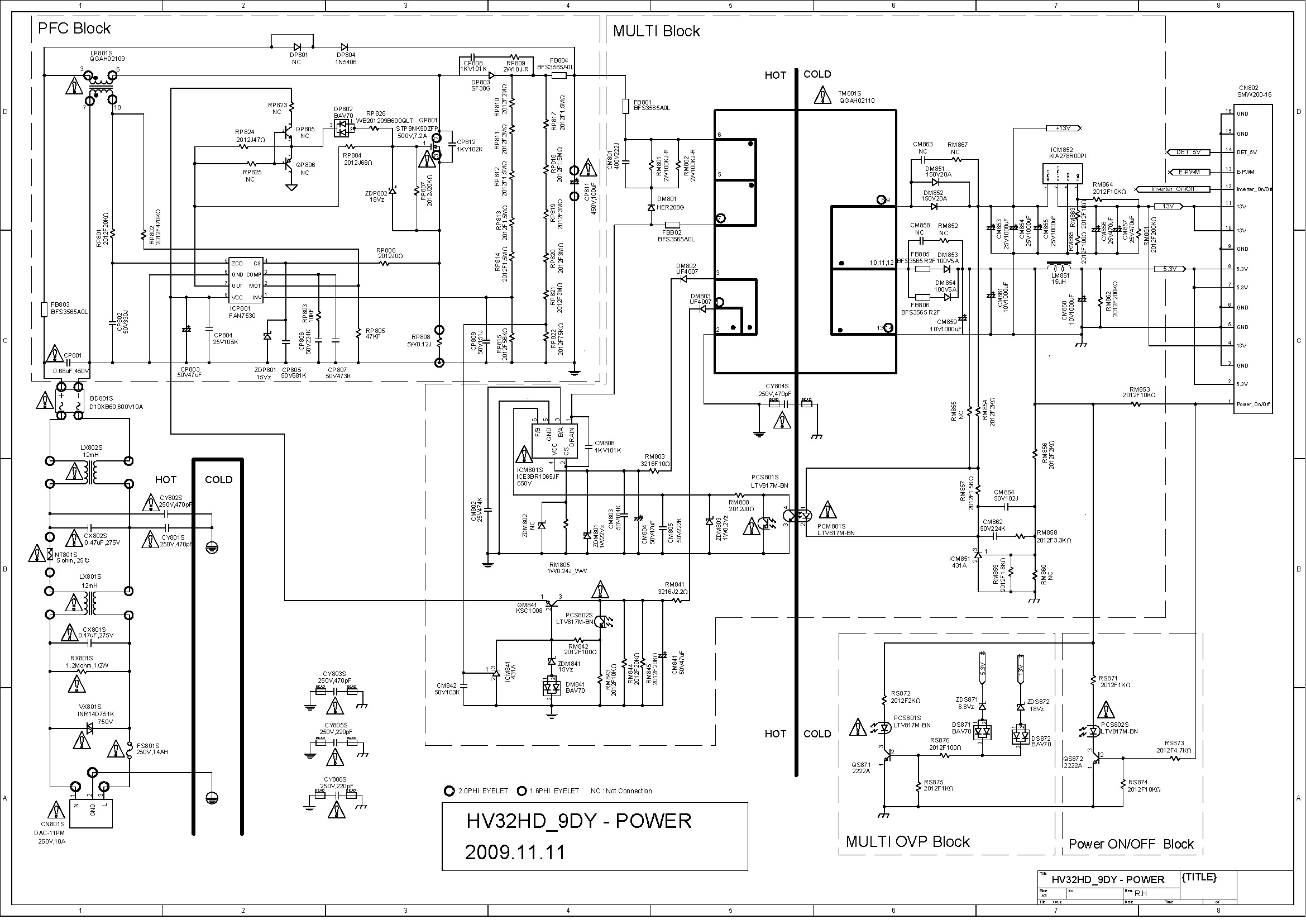

    The psu is this one BN44-00289A
    I measured voltage across the main filter cap and i get 350V dc. That is pretty low as far as i remember. Should be around 380 or more with TV turned on right ?
    So could anyone guide me what to do next ?
    Could it be a bad PFC chip ? i dont have a replacement for that right now...

    maybe worth a read of this thread as its the same psu and has a link too the schematic also maybe worth you checking the resistance on the invertor transformer winding's
    https://www.badcaps.net/forum/showthread.php?t=25196

      Re: Samsung LE32B350F1W BackLight problem
      There should be feedback resistors on your pfc chip. Make sure they are reading correct
          https://www.badcaps.net/forum/attach...4&d=1356896986
          Check the PFC diode DP802 (?) to make sure it is not shorted or has bad leakage resistance.

              The Dp802 removed from the circuit (by removing the jumper smd's) on my DMM set to diode test, reads 0 reverse biased and forward biased would slowly rise up to 0.513 - 0.515.
              I also get strange readings from ZDI802.With DMM set to diode test, when on circuit it will read 0.032 both forward and reverse biased.
              When removed it reads 0.692 forward biased and 0 reverse biased
              for the zener by forward biase i mean (negative off dmm to stripe on body and positive to other side). when removed i read no short accross its pads.
              P.S. i am going to replace it anyway since i happen to have one and i will see what happens. Though i suspect it is the rest of the circuit that produces the weird readings.

                I replaced DP802 and the problem is still there.
                I noticed thogh that Voltage across the main filter capacitor now when TV is on, is 383Vdc
                and when off, it goes down to 310.
                I will report the otuput readings of the PSU because i think they are slightly low.

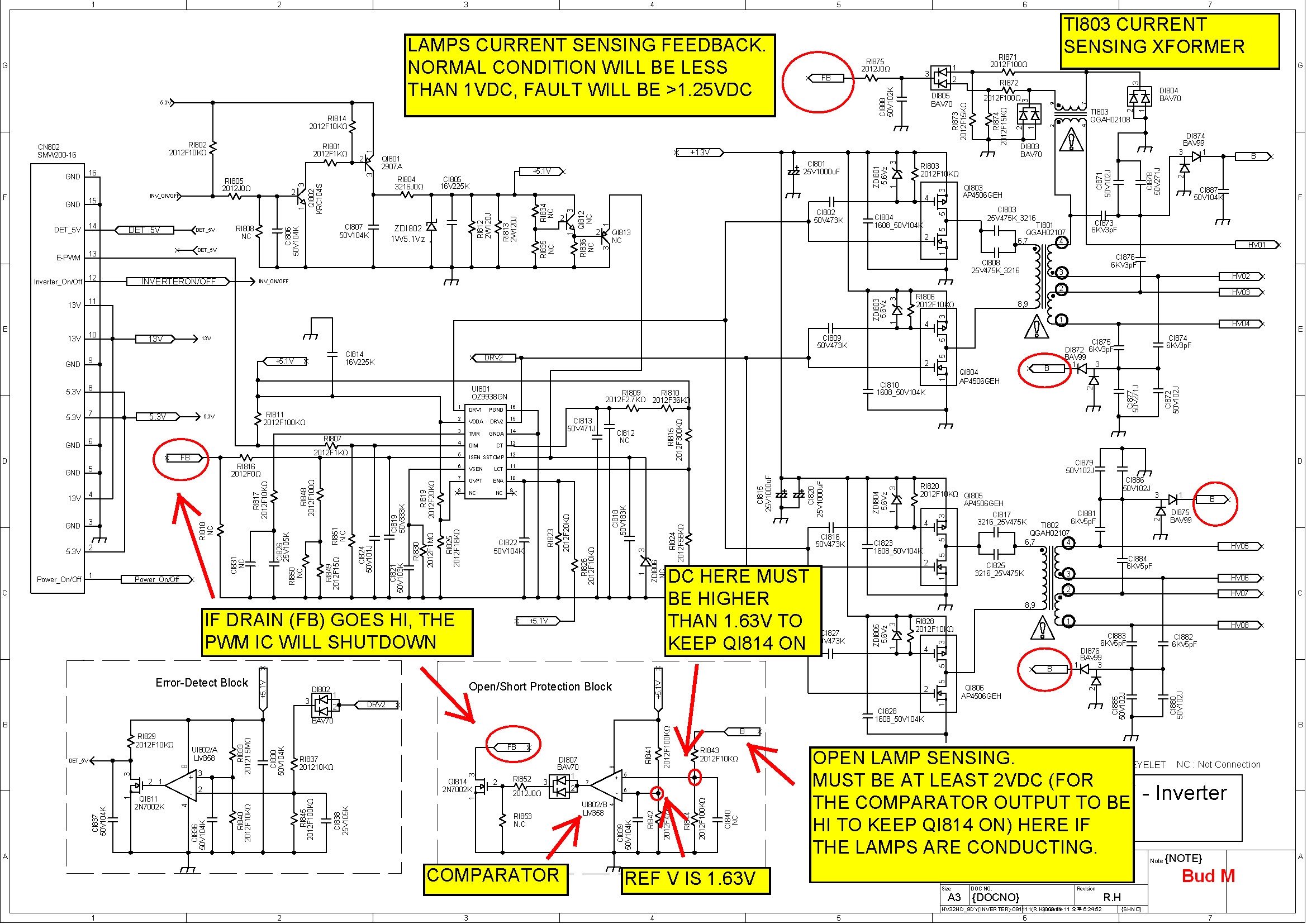

                  disconnect CN802 that goes to the main board (this will force the PS_ON and BL_ON line to go HI, if the board is OK, the backlights should turns on when you plug the TV into the AC outlet.

                          I think that the low voltage on DET_5V suggest problem with inverter or lamps... Thats probably why lamps go off but again how can i say for sure... Is there a way to test the CCFL controller chip ?

                            if you read that other thread i linked im sure it tells you how too test the controller ic or disable the det line

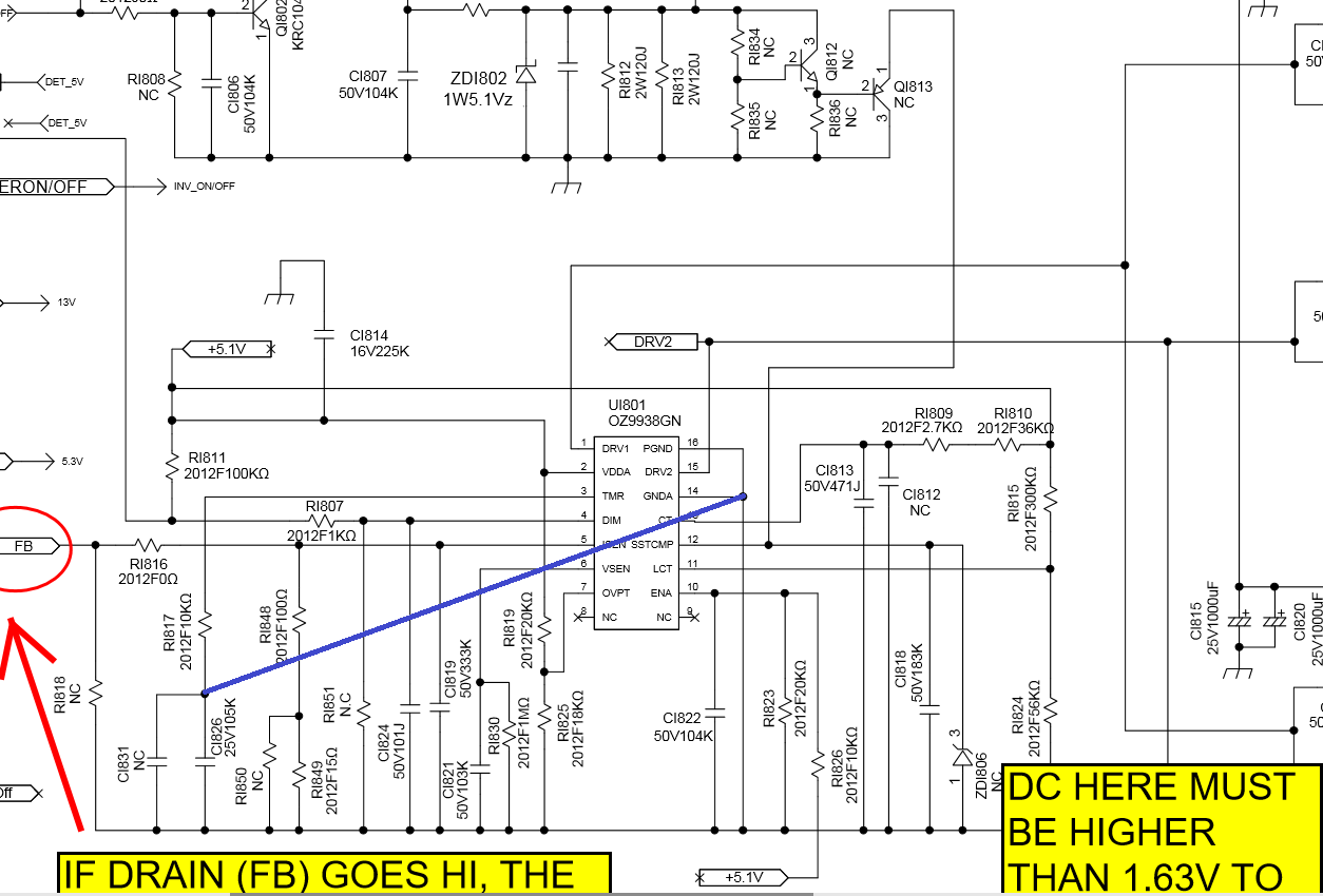

                              DET_5V should be <1V when TV is in standby and it should be >2.5V when the inverter circuit is running.

                                So now the PFC Voltage is correct. Does it stay at that level when the backlights come on?
                                Det_5V is just the error signal, LOW = <1V, HIGH = > 2.5V.
                                That 12.95VDC control signal cannot be right, it cannot be that high.

                                      Now this is interesting !
                                      i was looking at the OZ9938 datasheet and i thought to myself, why dont i try to disable protection just to see if the ccfl's will keep on !
                                      So i shorted pin 3 between the resistor and the capacitor to pin 16 and it worked.
                                      The ccfl's winn not go off.
                                      That confuses me further because the lamps are good, i have tested them one by one with a ccfl tester and they are all glowing.
                                      • HellasTechn1
                                        • Sep 2015
                                        • 176
                                        • Greece
                                        I have tested the ccfl's again one by one and found out that one of them is running a little noisy... Yesterday when i tested them the room was not that quiet so i could not hear it. I will dissasemble the panel later and replace it to see what happens.
