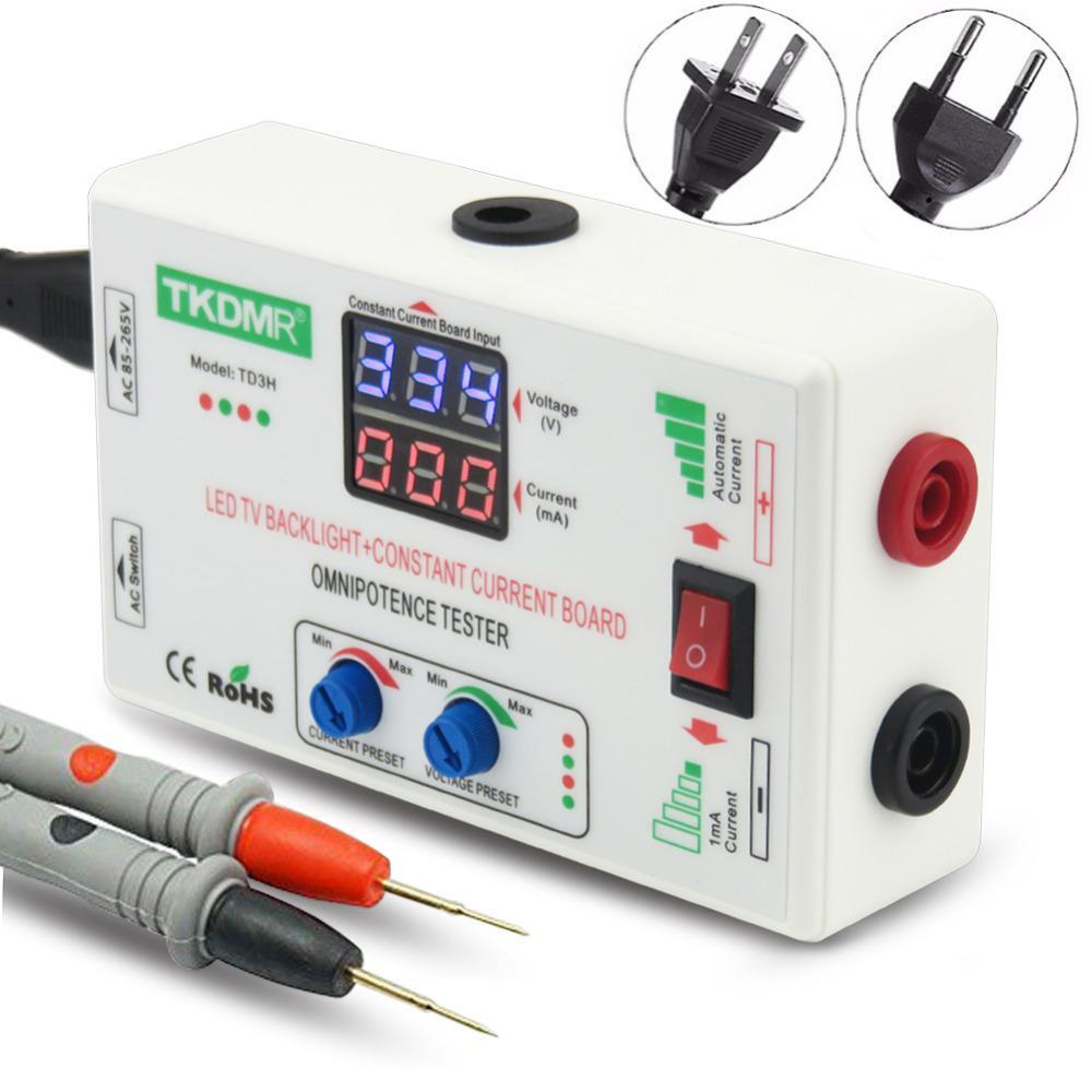

      I don't have a Backlight LED tester... I'll try to get one. This model seems to be really common on AliExpress:

      In the meantime, I do have a bench power supply, but it will only get up to 30V. Maybe I can get the LED to light up even if it's not full brightness?

                        Tester just arrived today, and the LEDs seems to be fine. I’m clueless now…

                          You tested all ribbons and all lights read what voltage?
                          You tested all 16 test lines on all 4 connectors right?

                            Yes, I set up the tester to 84V and 1mA, put the positive lead in the center of the ribbon, and I got 76.8V on the 8 outermost connectors of the ribbons.
                            I also tested the voltage on the ribbon when the TV is turned on and found no voltage present. Even if the LED[+] test point show 84V.
                            BLU_ON/OFF measures approximately 3.2V.

                                Set the tester to max voltage/amps. It has a safety on it. Set it to 330v or max.
