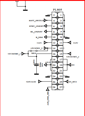

                    #149
                    Re: Digihome 32DLed906
                    budm im still learning myself so bear with me, ive just been looking at the schematic
                    it has bl-on/off listed on pin 12 pl804 connector on the psu and also bl-on on pin 8 of pl805 connector on the psu so i was just wondering why it has two bl-on/off connections on the psu.

                            #153
                            Thanks ron, budm i think also needed b-dim reading too pin 10 on pl 805 can you test that voltage as well
                            I think as dick-barton was suggesting, we may need to start by just testing all the psu output voltages without the main board connected maybe budm will advise which pins to jump with resistors.

                              #154
                              added picture of mainboard connector

                                #155
                                Vince
                                I have just measured pin 10 pl805 and I get 0.00v in ST/BY and goes to 3.42v when powered up when back lights come on it drops to 3.02v then just before the backlights go out it slowly goes down to 0.00v again it seems when this voltage starts to drop out it switches the backlights off ?
