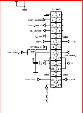

                        #171
                        Re: Digihome 32DLed906
                        you may of posted it already, but could you add a pic of the connector that goes to the main and a pic of the corresponding legend.
                        the secondaries obviously work since you had backlights earlier.

                          #172
                          This should help

                                #175
                                My guess too force this psu on with the mainboard disconnected, is join pins 4,6,14 then if still no back light voltage add pin 8 too pin 14, but this is only a guess its certainly worth trying whats advised in the above post and start from the beginning again with basic voltage tests.

                                  #176
                                  Yes 2-3 seconds to black
                                  All in 20v range
                                  st/by On
                                  soft switch pin 4=0.00v On 0.00v
                                  st/by on/off pin 6=0.00v On 0.00v
                                  bl on/off pin 8=0.00v On 0.62v
                                  b-dim pin 10=3.43v On 0.00v
                                  +12v pin 12=12.07v On 11.46v
                                  +5v st/by pin 14=5.20v On 5.19v
                                  pins 18 to 22 =3.45v On 3.44v
                                  +24v AUD pin 26=0.00v On 0.00v

                                      #178
                                      there are pins on the other half of the loom as well. what are they doing?
                                      might need some confirmation on the current readings too.
                                      bl/on, pin 8 - only 0.62v
                                      b-dim, pin 10 - 0.00v
                                      +24v aud, pin 26 - 0.00v
                                      pfc on main cap, 345v
                                      are you getting a few seconds to bet a stable voltage reading on these pins?

                                          #180
                                          You said in an earlier post that you did not have the 24V but in a more recent post you have 5V, 3.3V and 12V. Is that correct. If it is and the schematic is the correct one for your power supply board then the 24V is derived from the same transformer that produces the 12V supply so if the 24V is missing I would be checking around TR900
