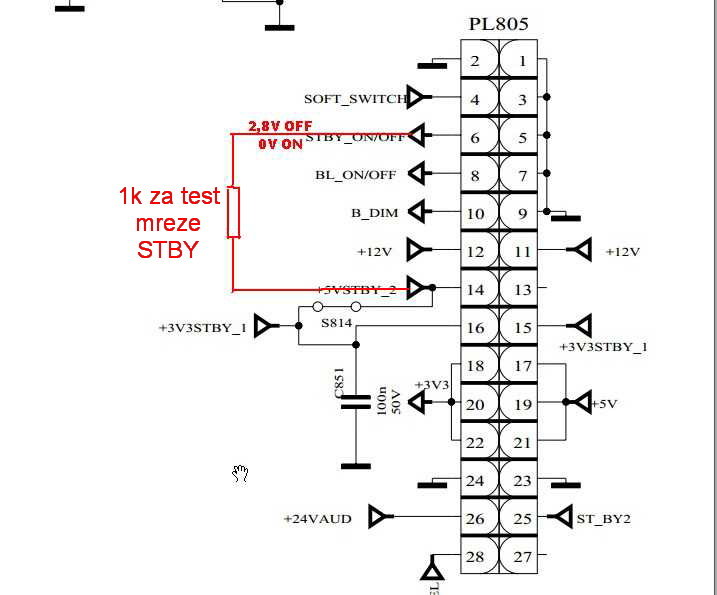

            #125
            Re: Digihome 32DLed906
            Can I ask what secondary voltages if any do you get with the mainboard disconnected and the two jumpers in place. +12, +24, +5STBY, +3V3STBY.
            If they are missing then one more connection. Connect Soft_Start Pin4 (PL805) to GND (Pins 1,3,5,7 or 9) as per the schematic on page 1 of this thread.

              #126
              Does that connection need to be with a 1k resister ?

                  #128
                  I may have the switching of Stby_On/Off backwards. Looking through previous threads on this power supply I found a drawing which would indicate that to power up the secondary supplies you need to do the reverse of what I was saying.
                  Can you give it a try and take Stby_On/Off to GND and see if the secondary supplies come up.
                  Initially we need to get the power supply secondary voltages up and running without the mainboard connected or worrying about the backlights at the moment.

                    #129
                    So am I linking pin 6 to pin 14 with a 1k resister and also linking pin 6 to GND with a 1k resister ?

                      #130
                      Or am I just linking pin 6 Stby_On//off to GND using a 1k resister ?

                          #132
                          I believe that flocko is correct, however starting from the very beginning the 1K resistor between Pin6 and ground should bring up the secondary supplies.
                          If it does then a second 1K resistor from +5V to BL_On/Off should bring up the backlights.
                          If the backlight flash then it would still look like a led problem.

                              #134
                              Linking pin6 to GND with a 1k resister has not brought up the secondary supplies ?
