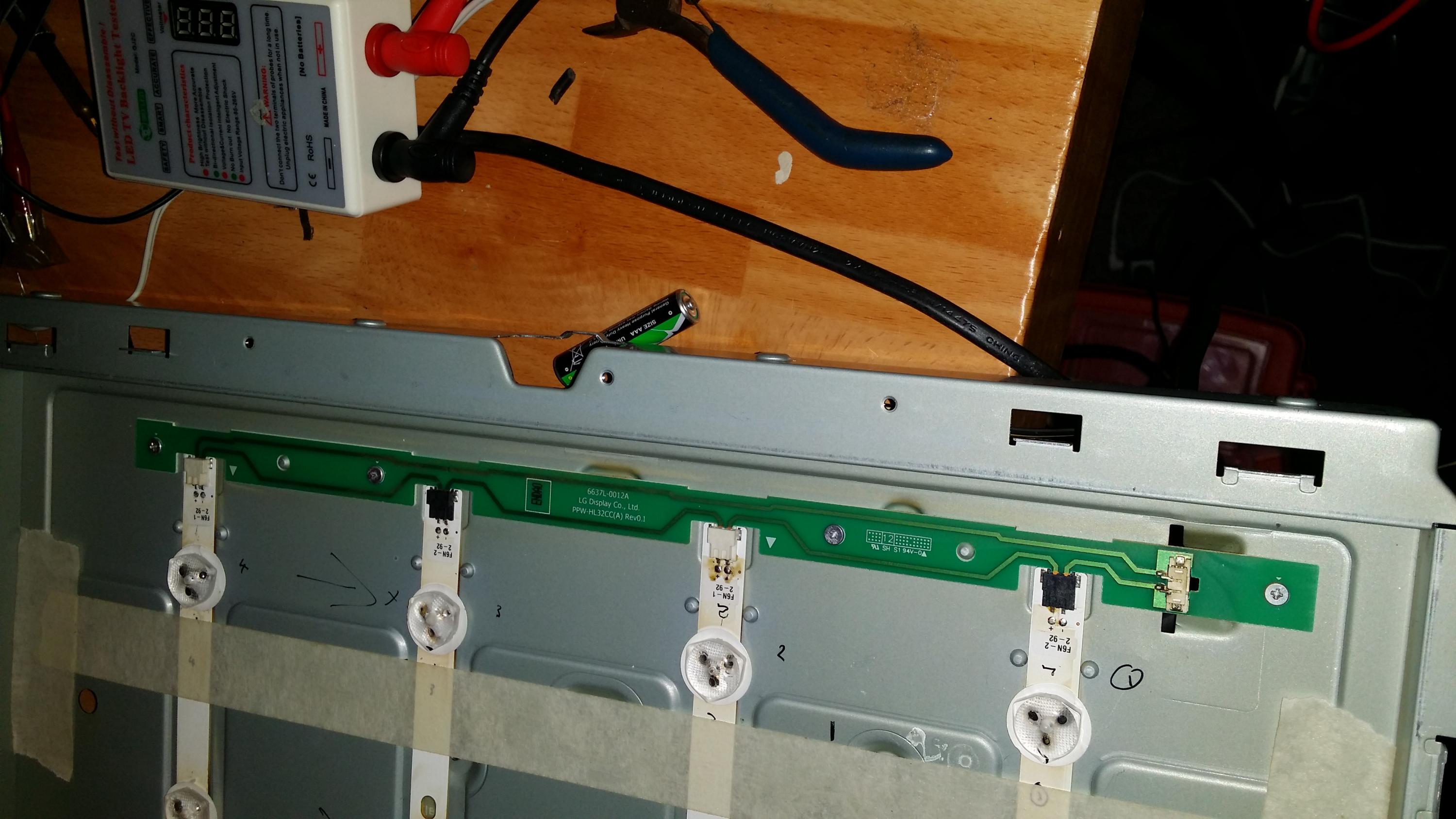

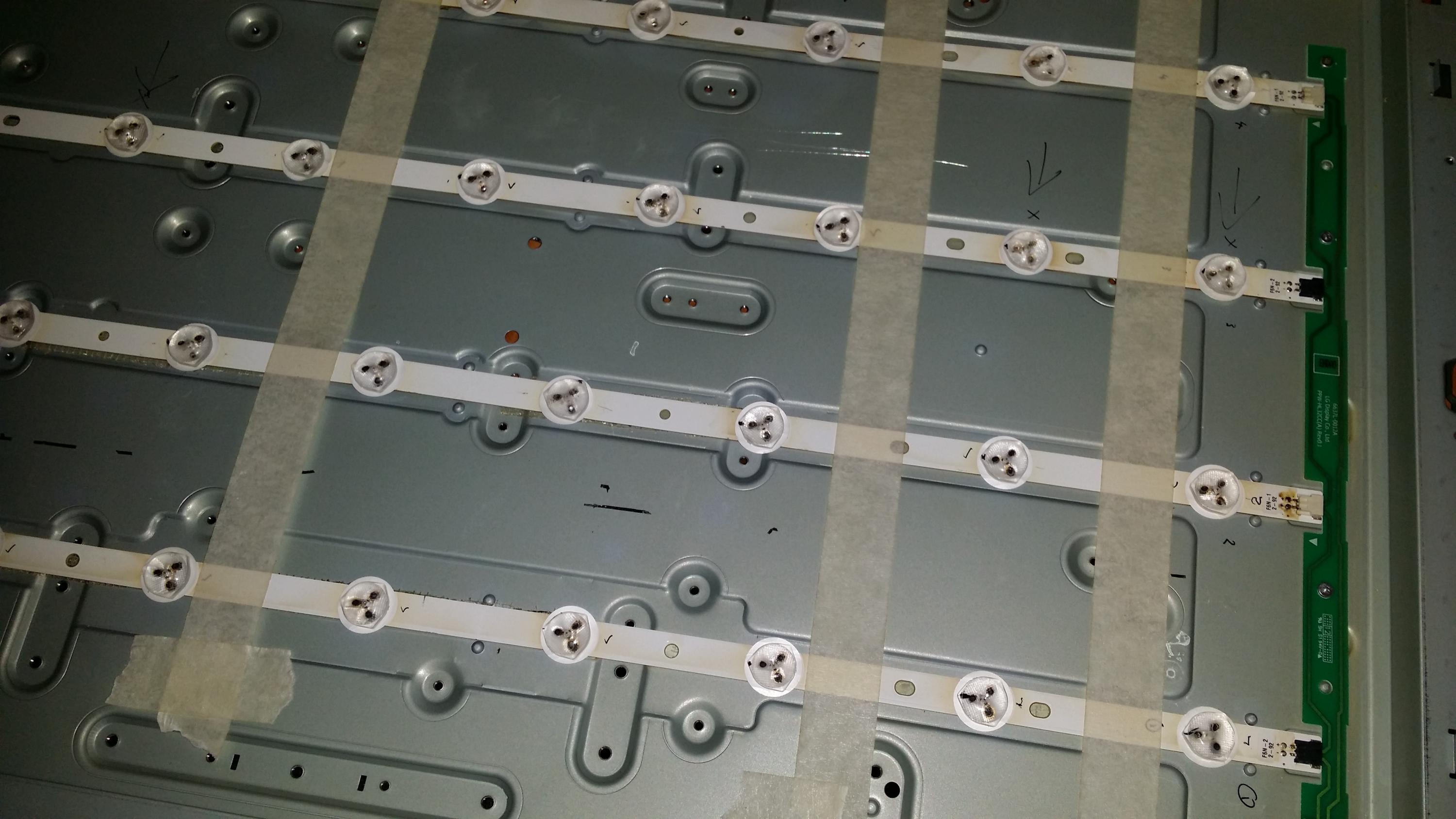

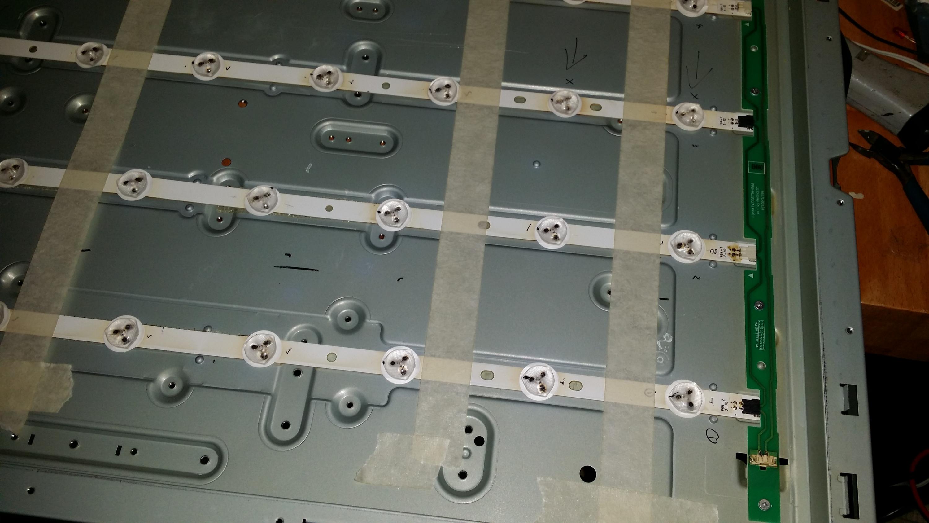

                Their is a long strip board that runs down the right side of the chassis and the four Led strips slot on to this board it has a connecter at the end and the two wire connecter plugs into this. I have started to strip it down when all is exposed I will take a photo of it and I will show a plan of how I intend to by-pass this board ?
                Perhaps you could have a look and let me know if what I plan is right ?

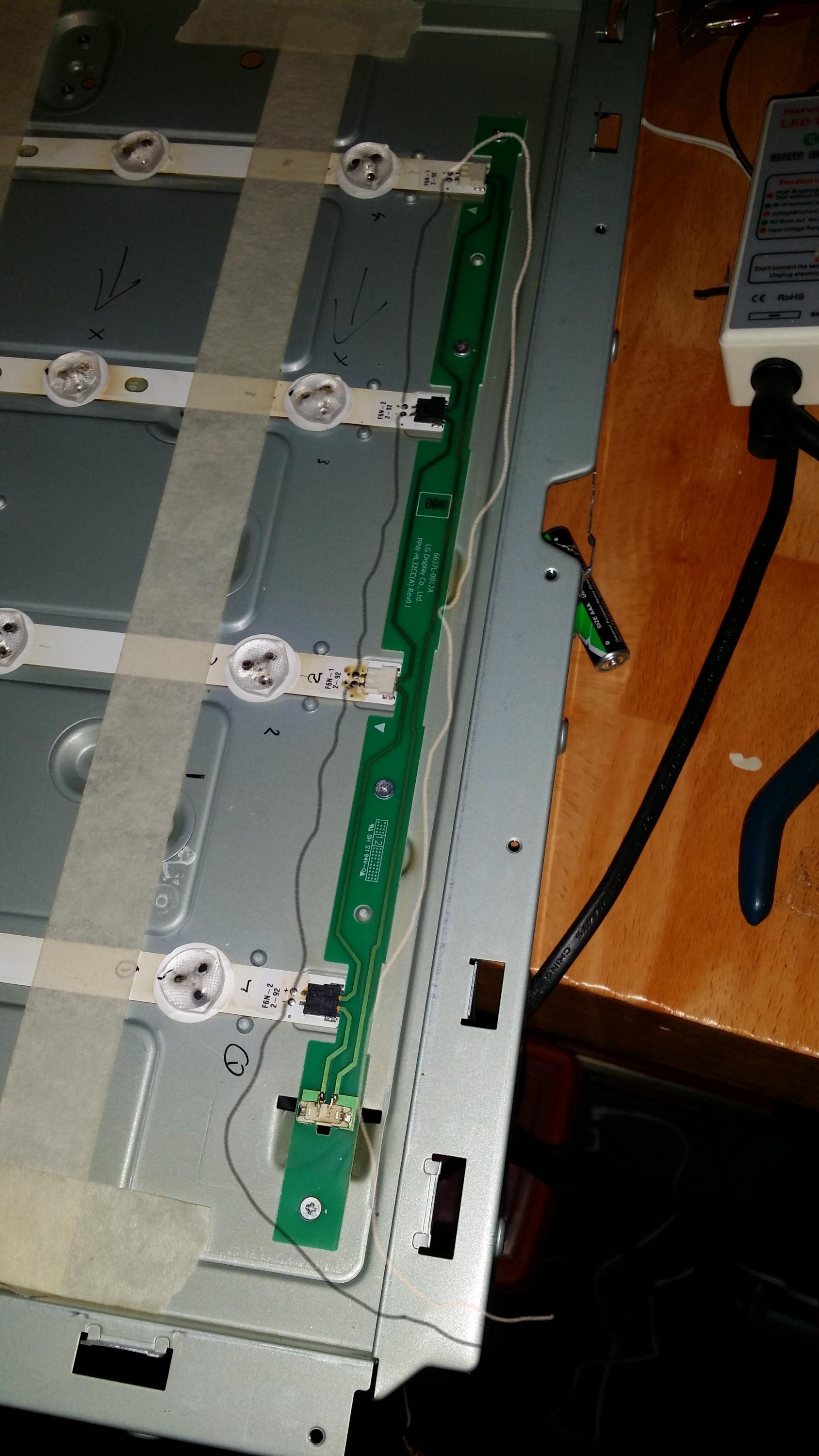

                    I have now stripped the TV down again now and here are some photo's of the Led connecter board and I have drawn on one of them to show how I intend to by-pass the board.. I will of course remove the board first and the wire will be a lot tidier than the drawing.

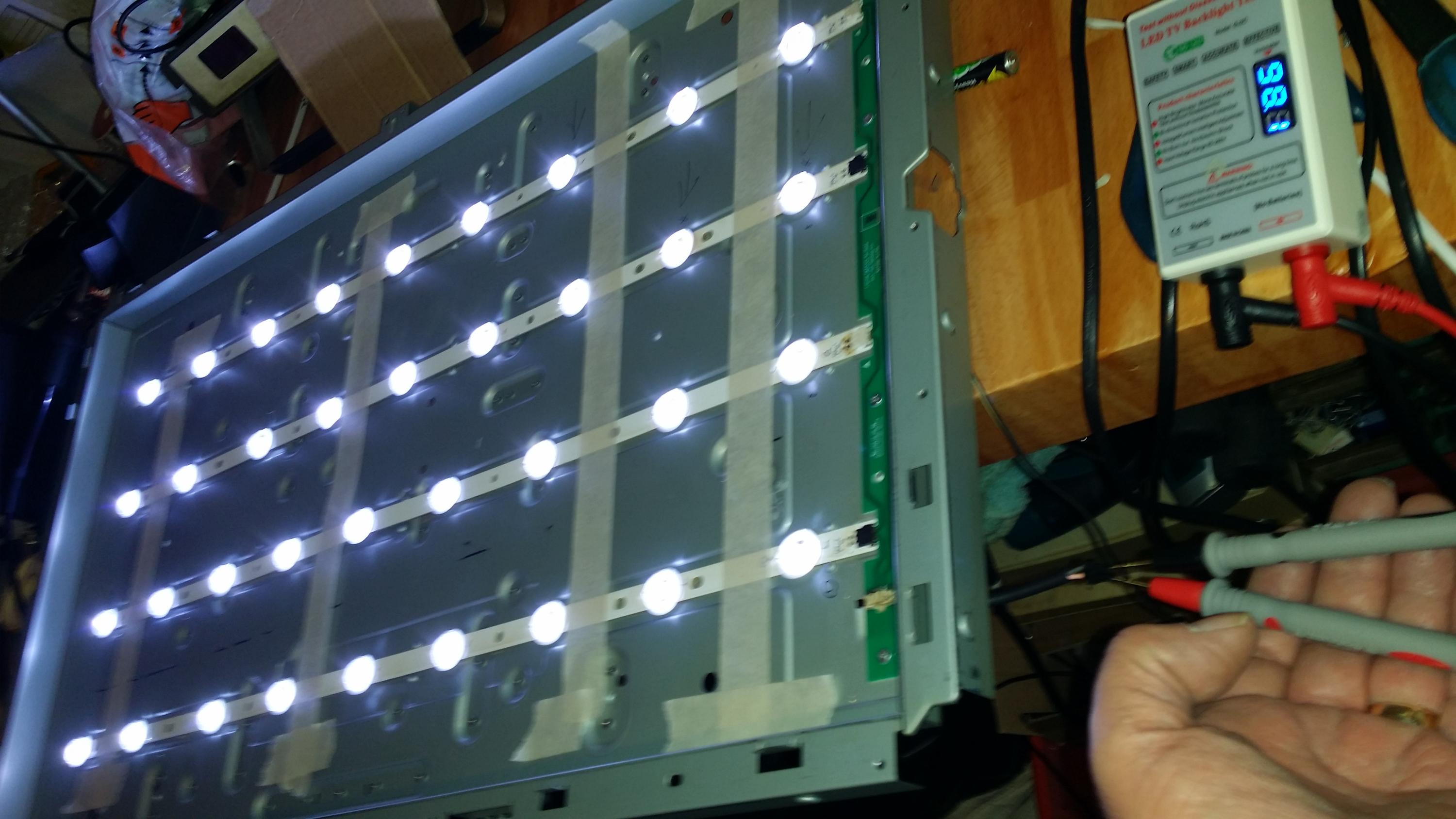

                        #91
                        Re: Digihome 32DLed906

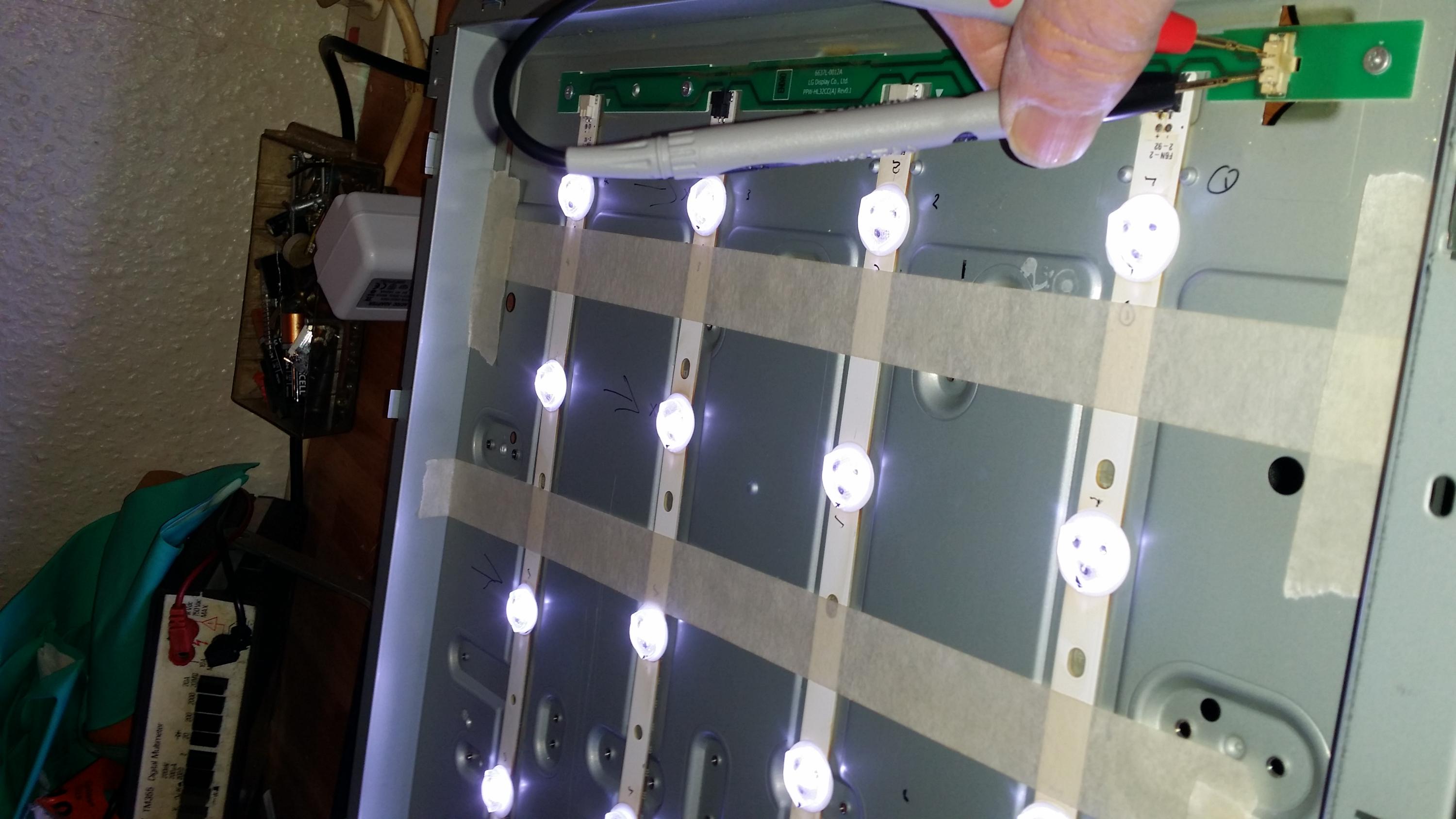

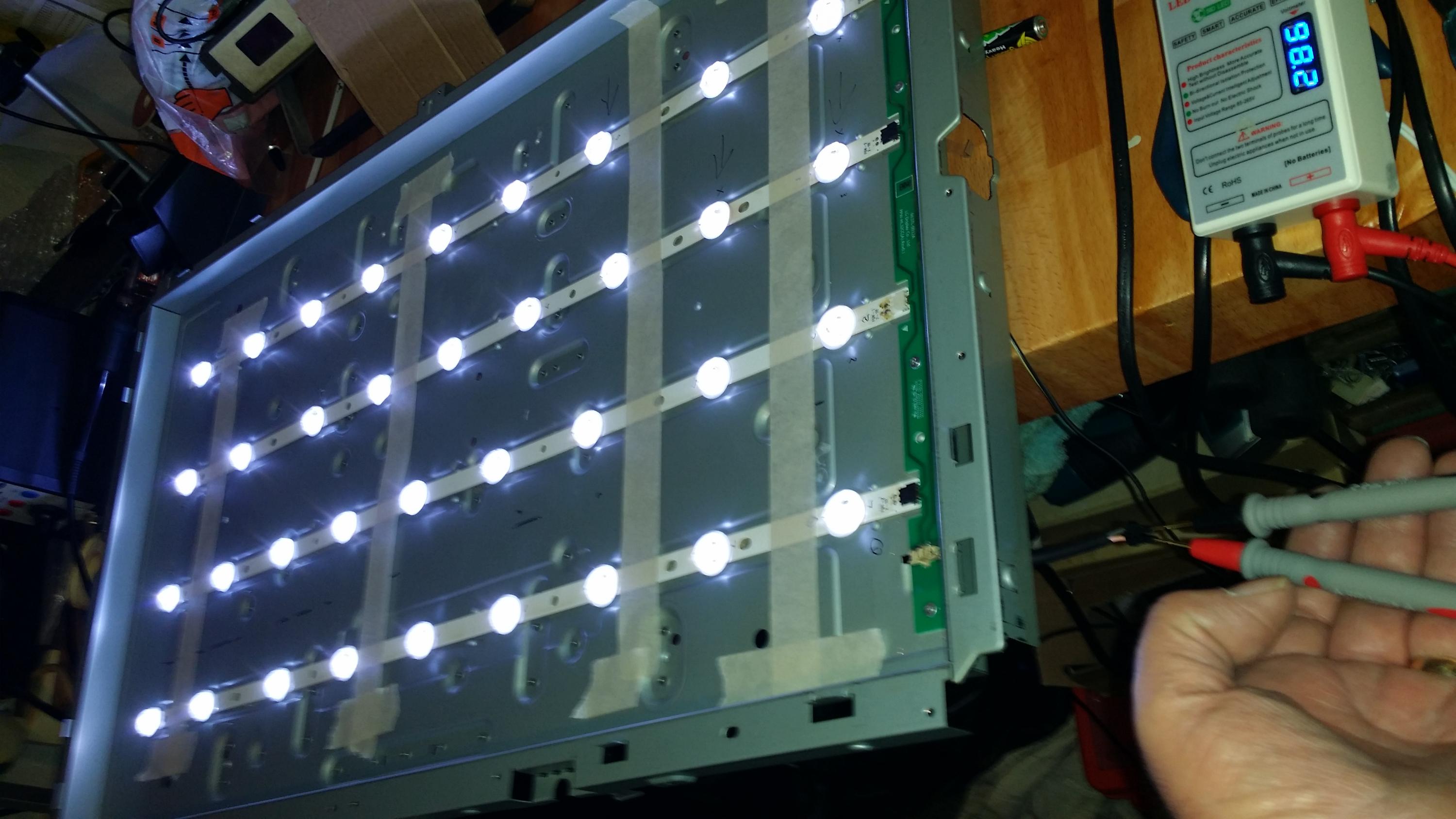

                        Here is a couple more pictures of me powering backlights .

                          #92
                          if the leds work like that i cant see it being a bad connection it has to be the driver board or mainboard ? and just saw your picture about the rewiring to rule out bad connections that should work fine in my opinion.
                          what i was trying too get you to rule out is the back of that connector your holding your probes onto in case theirs a bad connection there.

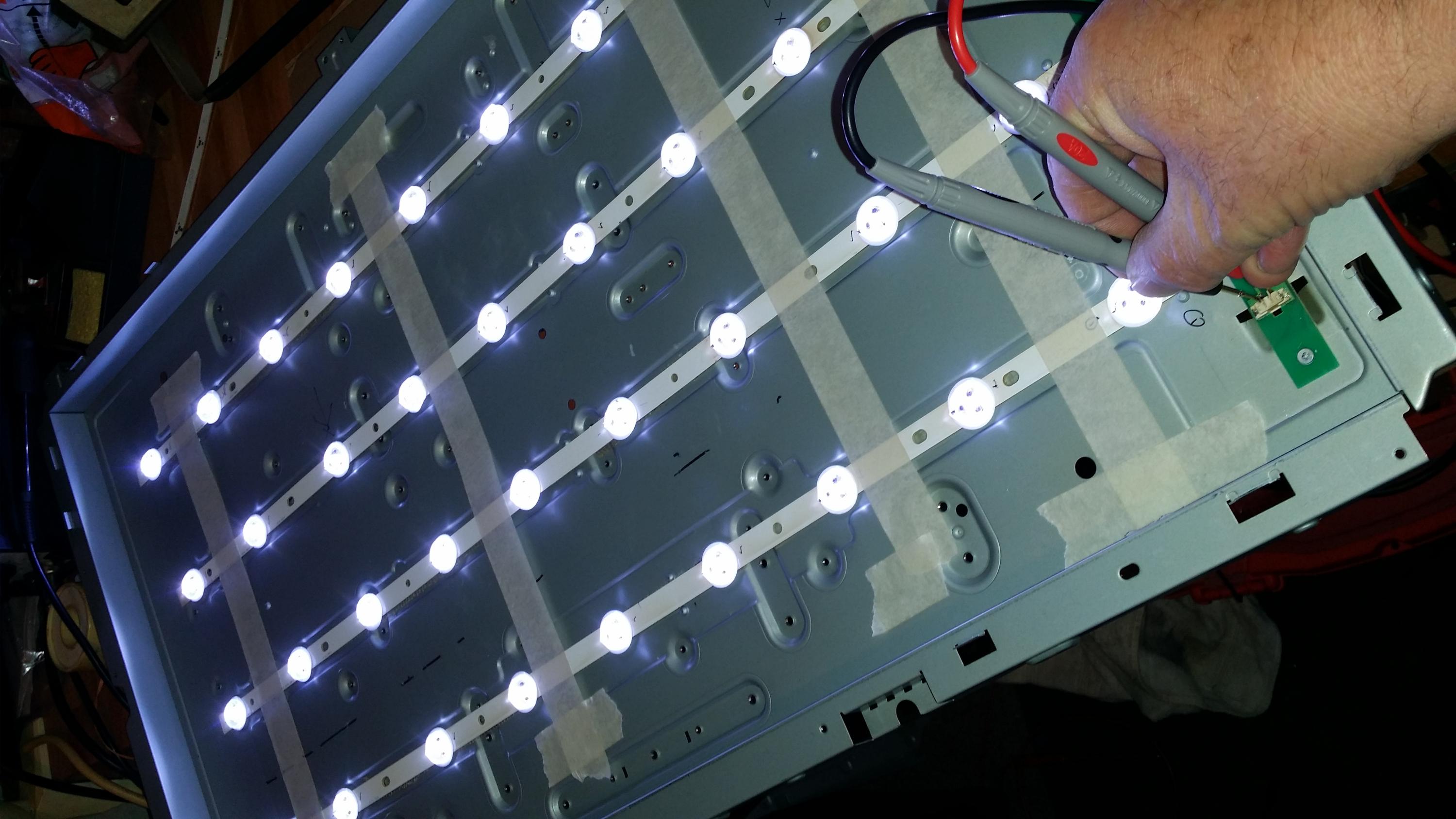

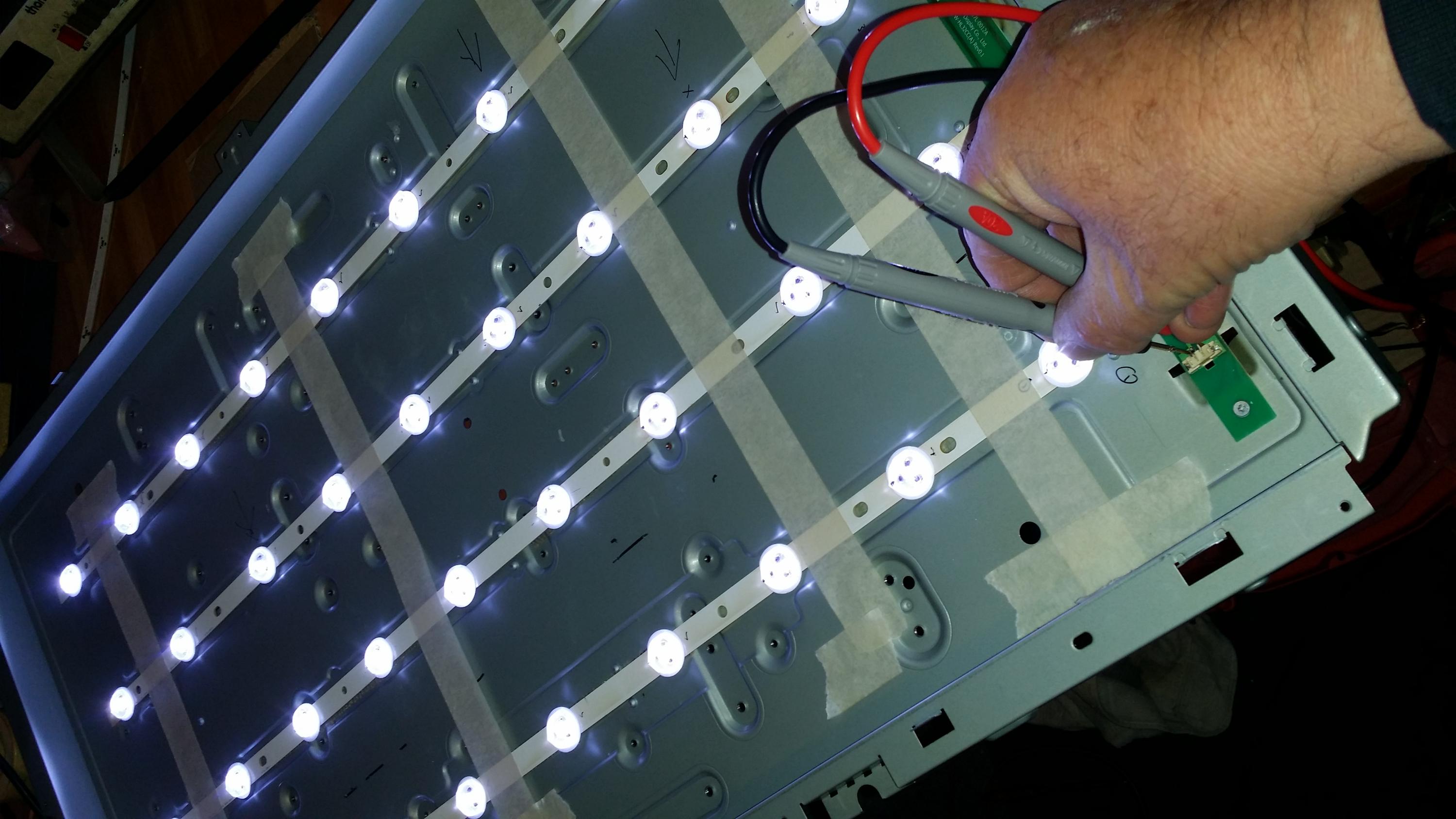

                            #93
                            With these two photo's you can see me powering up backlights by the two wires coming out the back with Led tester.

                              #94
                              i personally dont think its a issue with the leds it has too be the driver board or mainboard in my opinion hopefully dick_barton or budm will chime in with there thoughts
