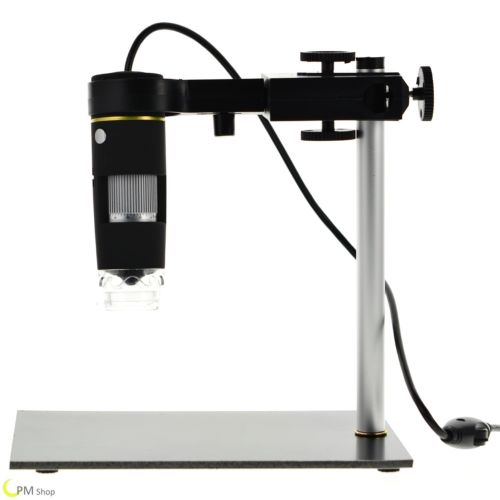

        #63
        Re: Digihome 32DLed906
        Yes my eyes are going as well I have just bought a cheap microscope of ebay one of those electronic ones not brilliant but does the job.

            #65
            yes i was looking at one of those theirs a video on you tube showing how you can modify them so you have room to solder underneath but keeps the magnification https://www.youtube.com/watch?v=jx0t...dex=23&list=WL
            i was looking at these reasonable price for hobby work

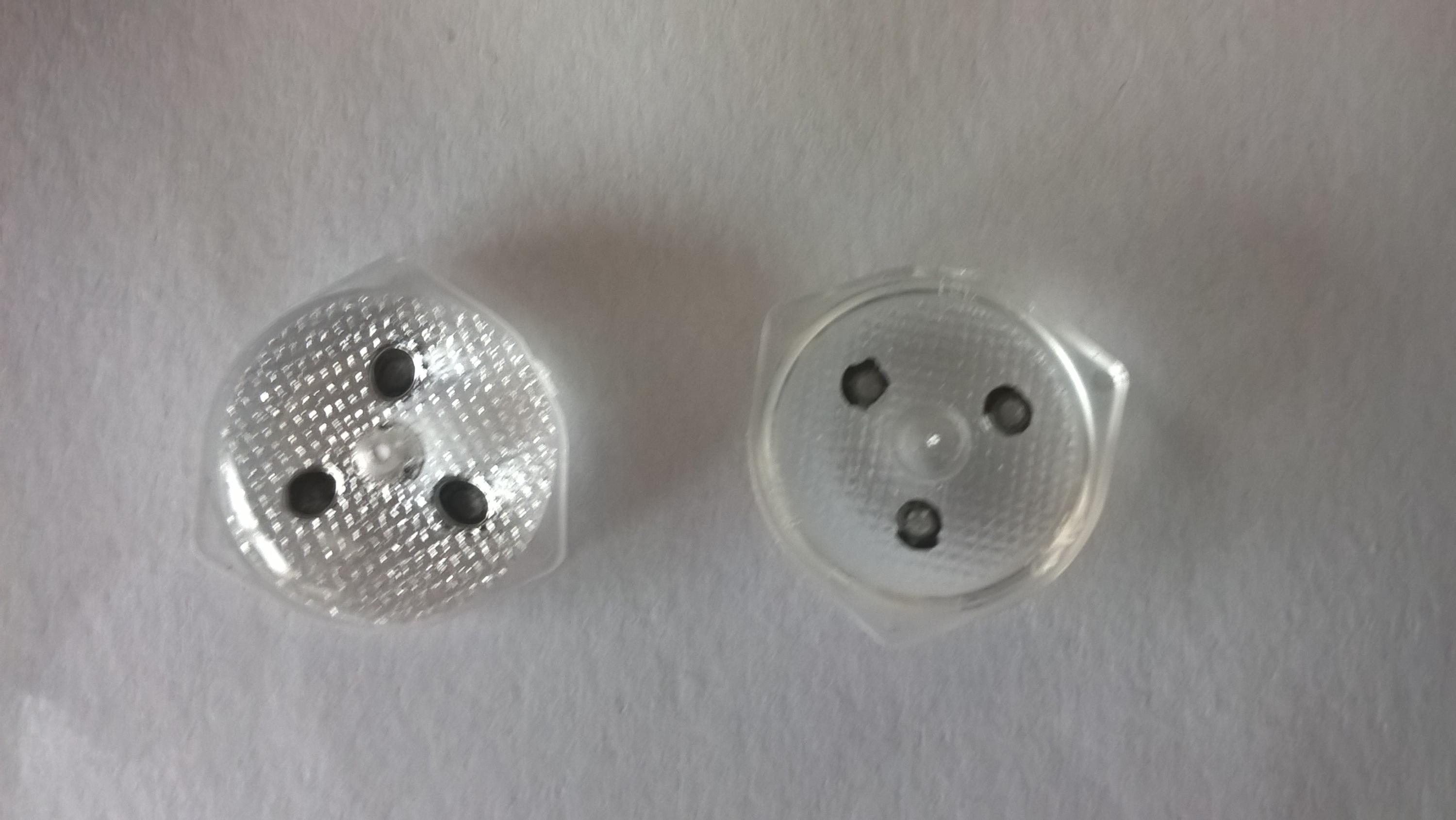

                        #71

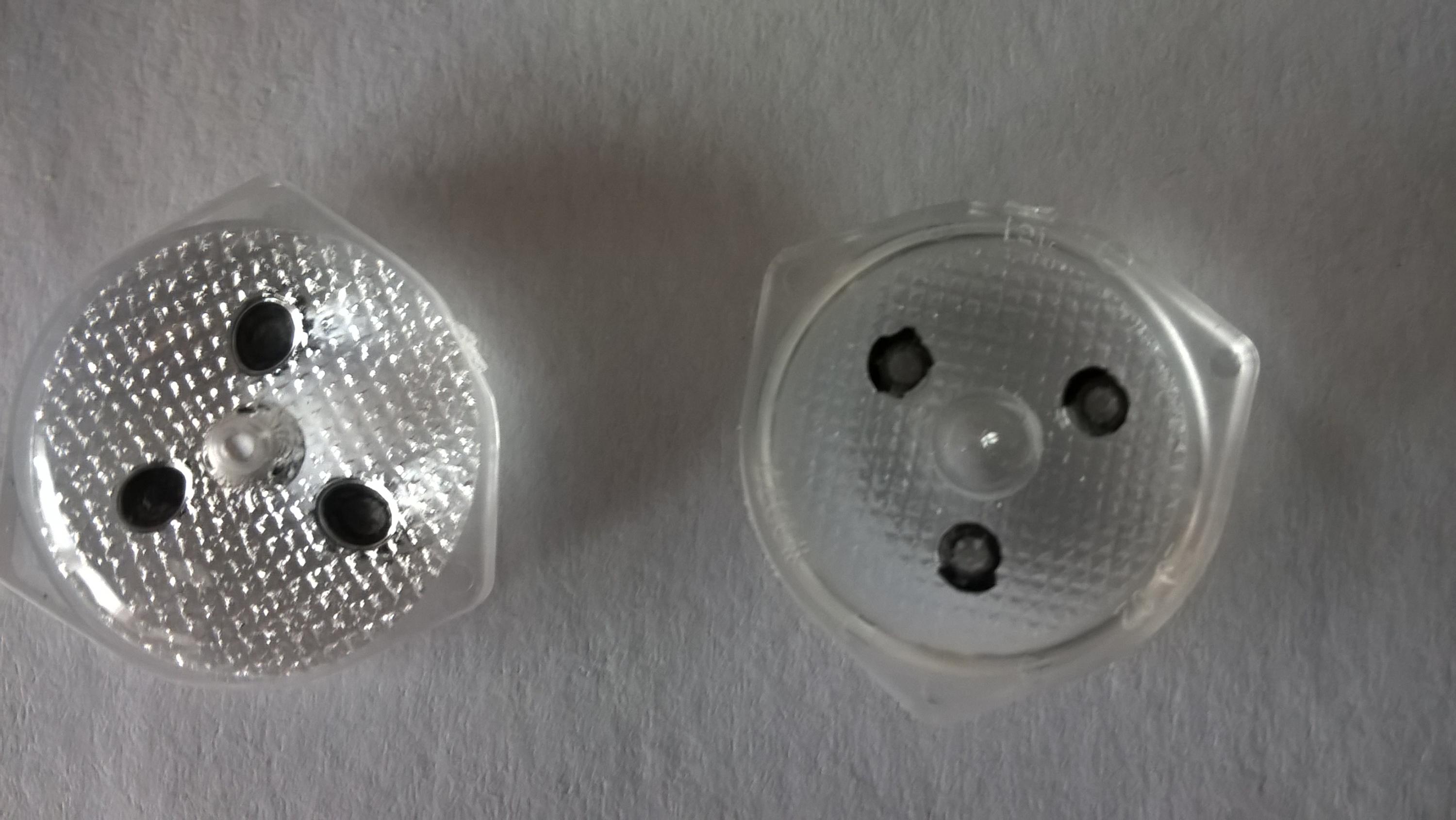

                        I think
                        Your right Vince I will change them all.
                        Here is a couple of pictures let me know if not clear enough.
                        I have just looked for my spare lenses i have these not sure if they match yours i have 10 all the same

                          #72
                          Hi All
                          Yes the one I have now is the same as the one in the YouTube video in Vinceroger69 post#65.
                          It only cost £29.99 from eBay item number (321866315973) it came with the stand and a instructions disc this one connects to your pc or laptop. and I must admit it is ideal for what I want , I used it to solder the smd cap in the LG 32ln578 the size of that cap was 0603 and as you know that is really tiny. I had the power board on the stand and worked from watching screen on laptop it was so easy.
                          I only bought a cheap one as I was not sure whether I would be able to work that way, but must say I am really pleased with it and to be honest I can't see any reason to upgrade yet as this works fine for me.
                          And to be honest if I had paid £130.00-£150.00 their is no saying it would do any better than this one does for the cost of this I took the chance and I am very happy I did.

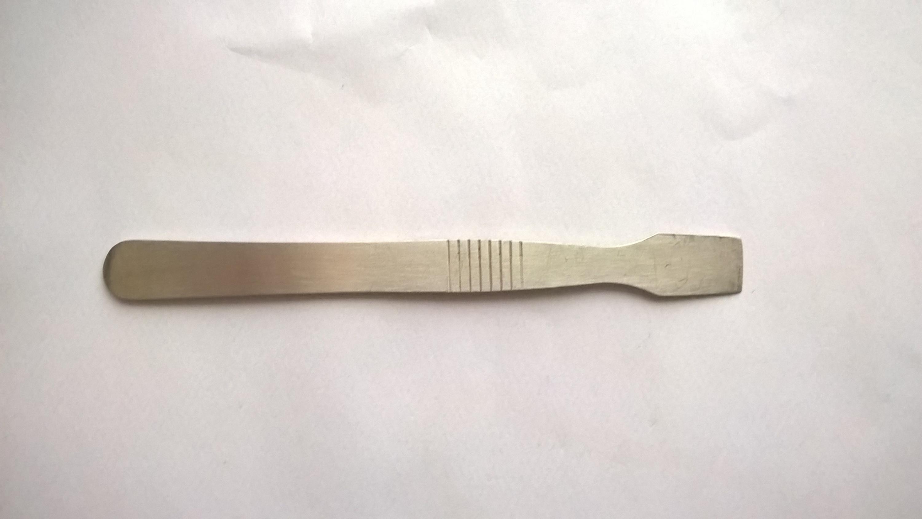

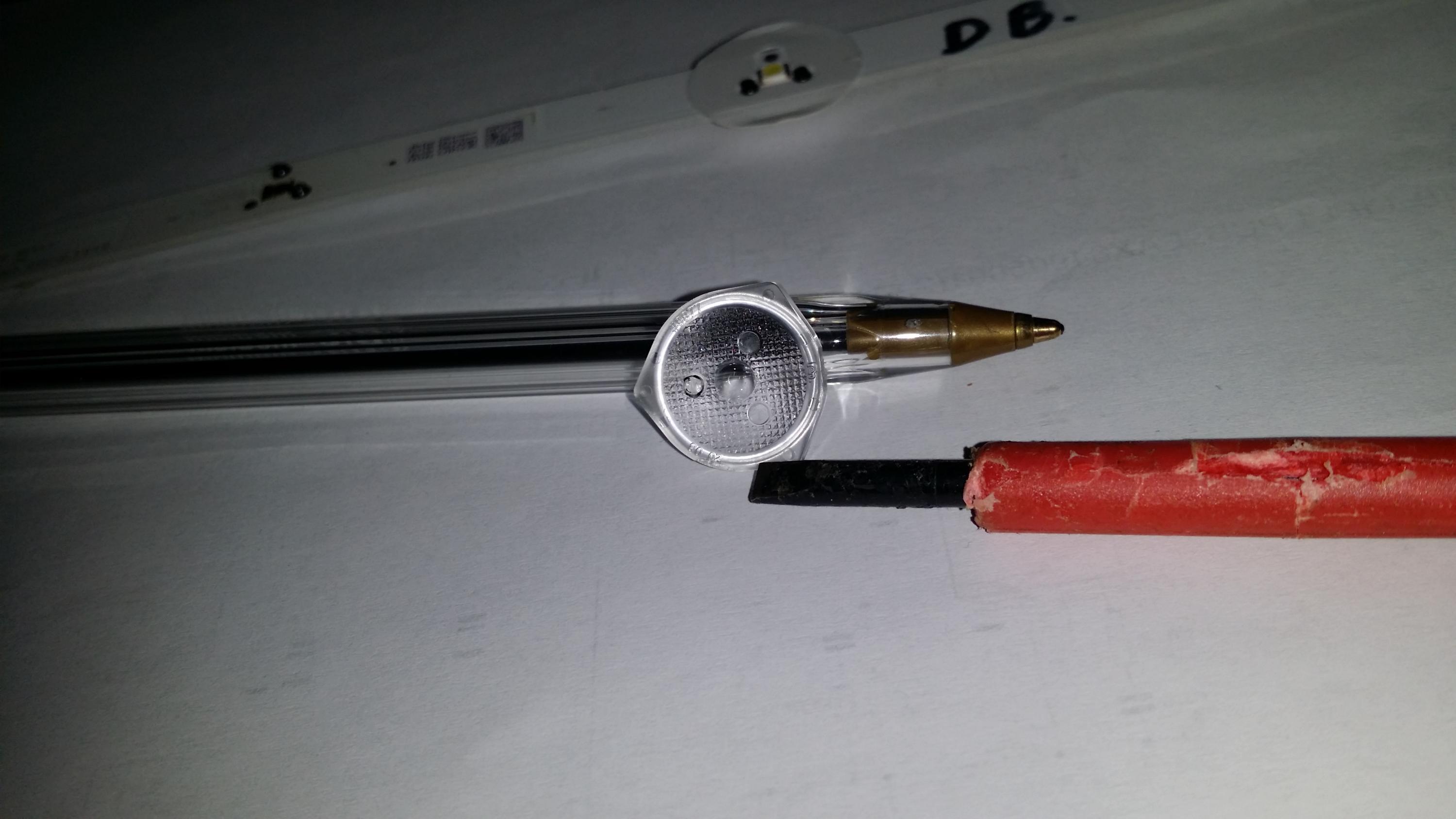

                          Yes Vince they do look the same as mine are these removed from a strip? If they are could you tell me how you remove ? as I have just been putting my thumb nail under and they come off but on a closer inspection when I turn them over I can see that at least one some times two of the legs are shorter and when looking at the strip I can see part of the leg is still stuck in the glue.
                          • vinceroger69
                            • Mar 2012
                            • 6714
                            • uk
                            #73
                            yes i removed them when i was practicing fitting new leds, this is the tool i use too carefully lift the lens just put it under one side and lift up if another leg on lens still feels stuck move tool around to the next space and lift again, none of these are broke pm me your address and i will put in post for you i dont want nothing for them.

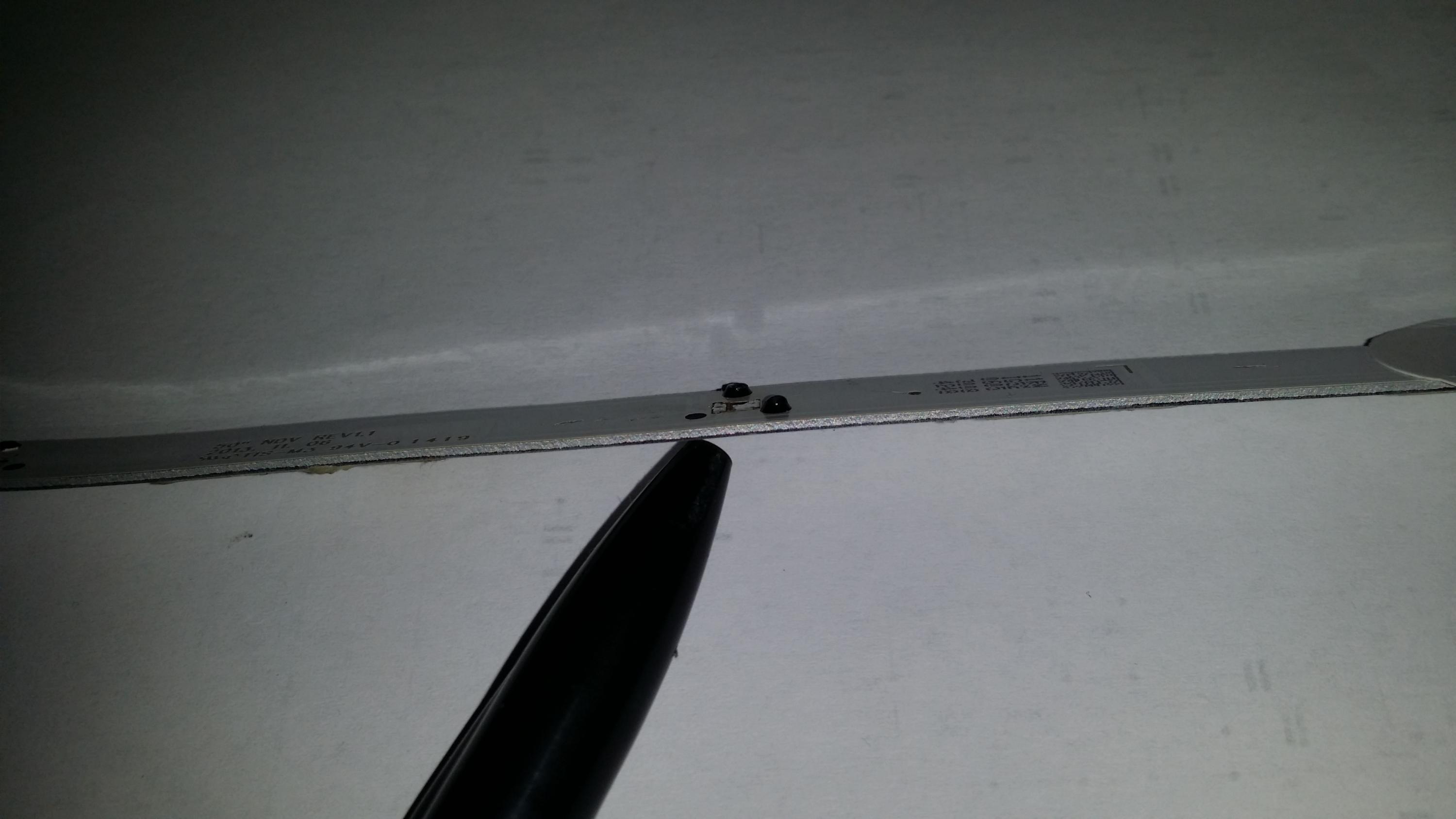

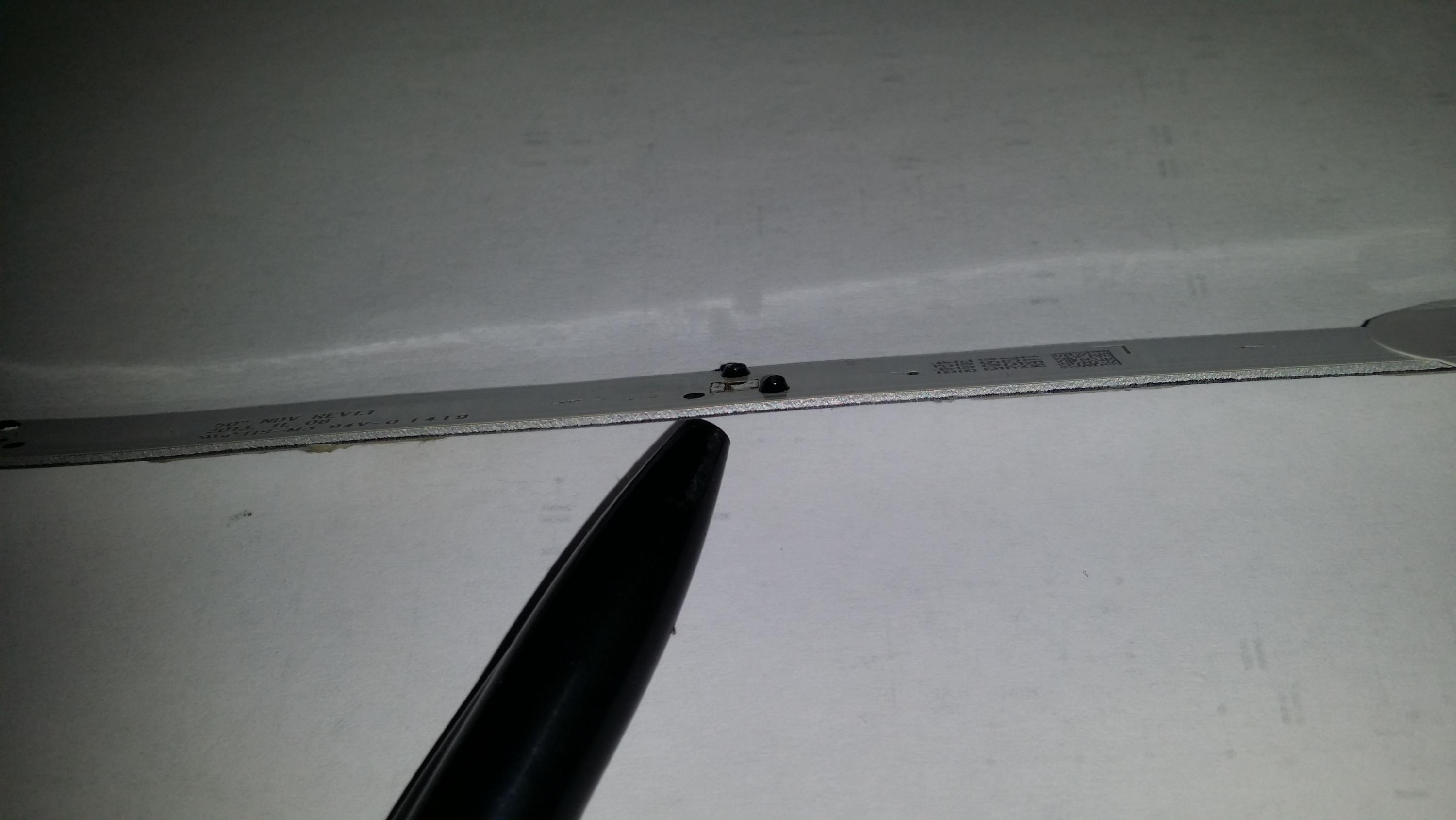

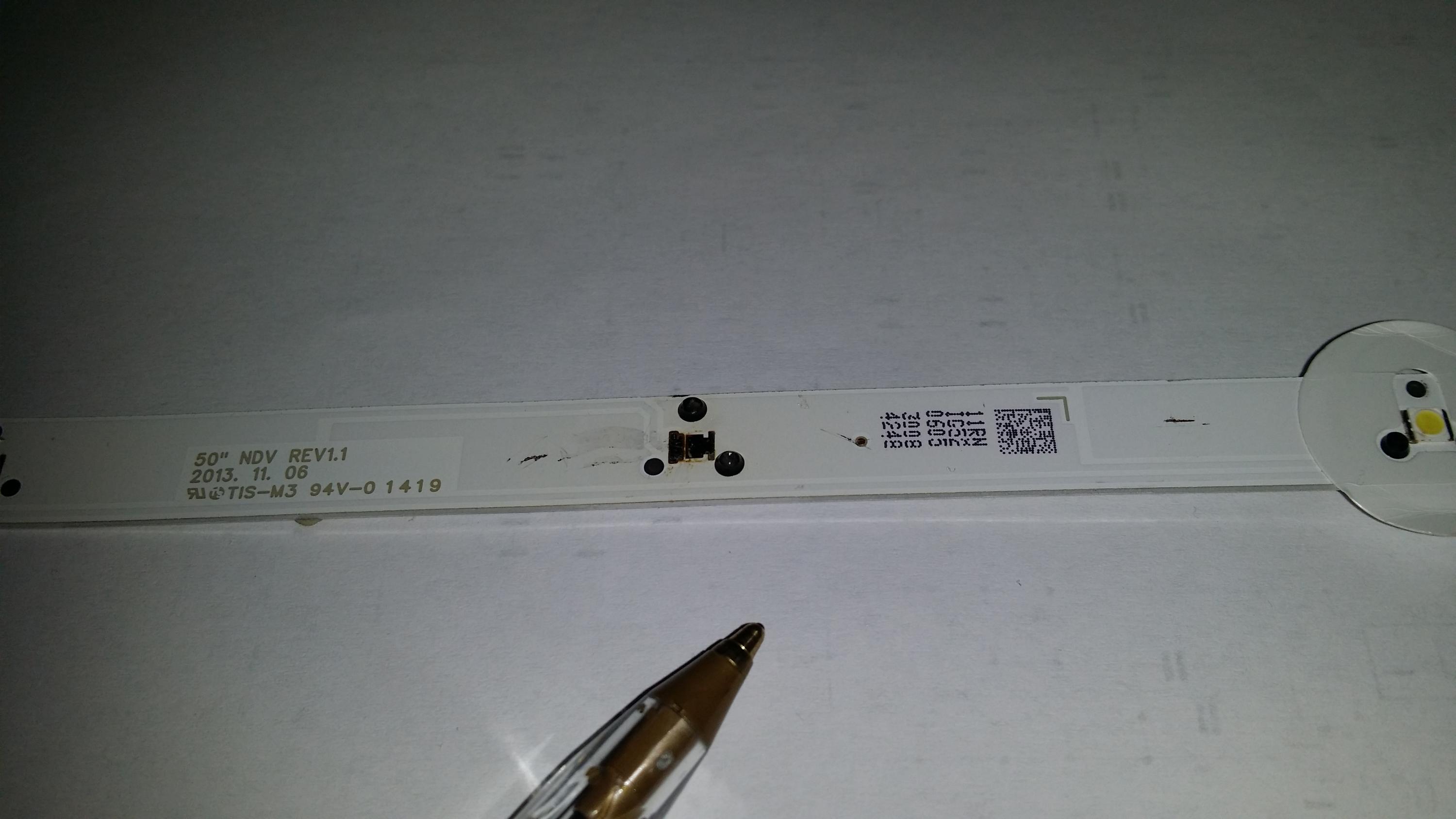

                              #74
                              Hi Vince
                              Here are a couple of pictures if you can see what I am on about ?

                                  #76
                                  yes i see what you mean maybe they used more glue the part numbers 20 03 are on my lens too so maybe the rite ones if you want the ones i have spare pm me your address and i will put in post today as need to go up too post office anyway

                                    #77
                                    Hi Vince
                                    I happen to have that exact tool and I have just tried your method of going around it on one of these strips and it worked just as you said lense came off with all legs intact.
                                    So as soon as those LED's arrive from proman I will start to replace all of them and see how I get on.
