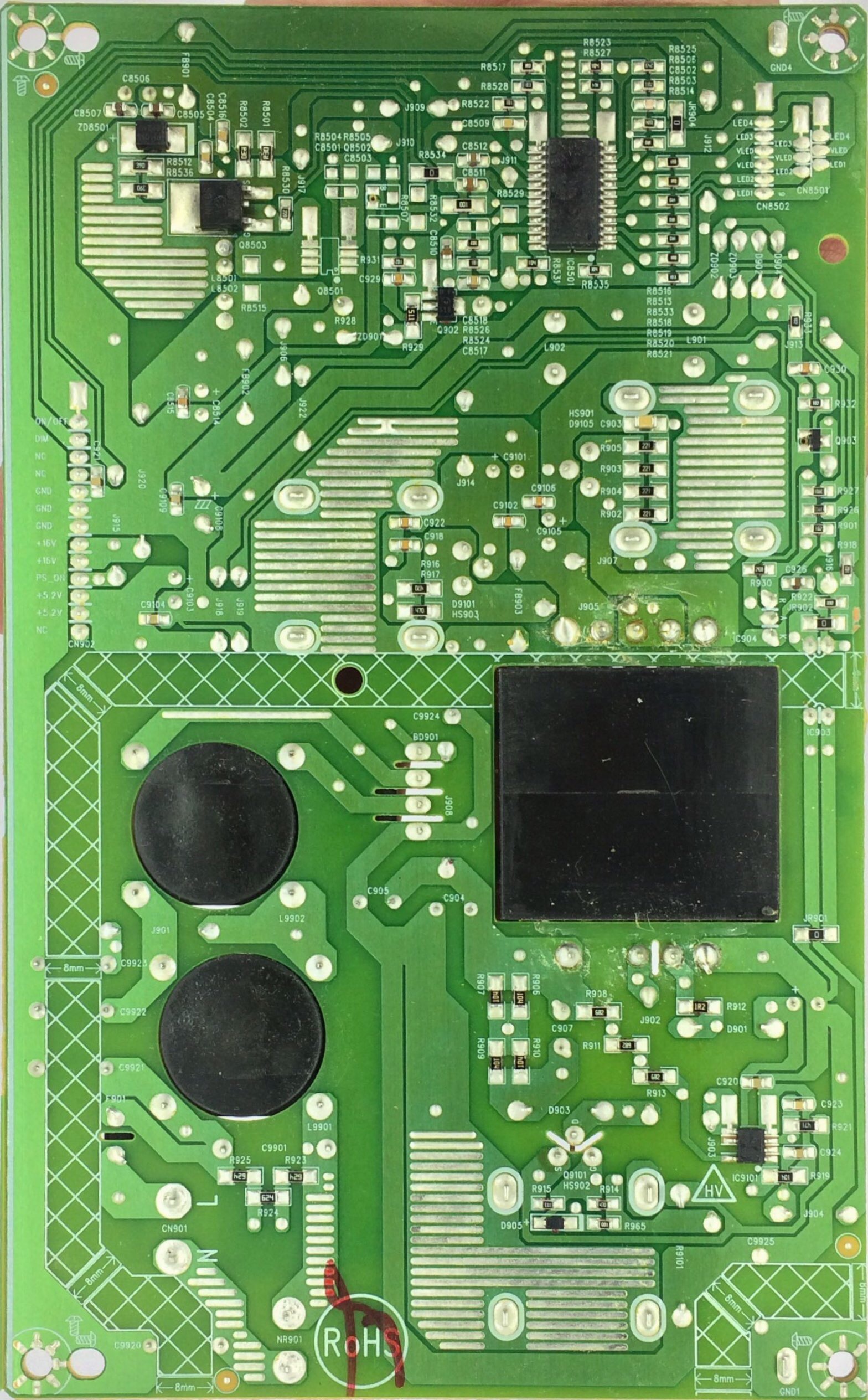

    I have a 21" AOC TV that is not turning on, the standby led (orange) is ON but when trying to turn it on, the led goes on blue for a second and it shuts off and goes back to stand by (orange).
    There's a whine noise coming from the transformer.
    I couldn't notice anything obvious in the visual inspection, while I know it is probably something wrong with the power supply, I don't know where to start.

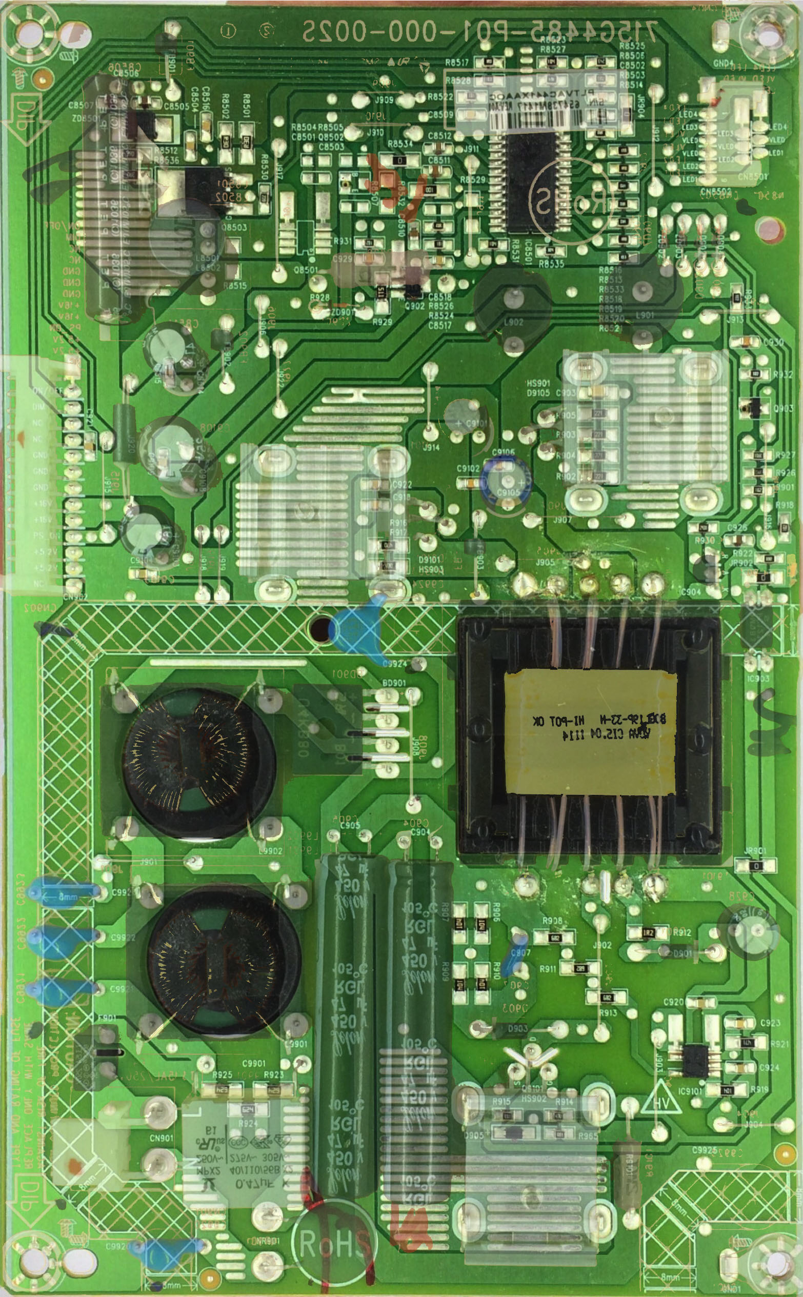

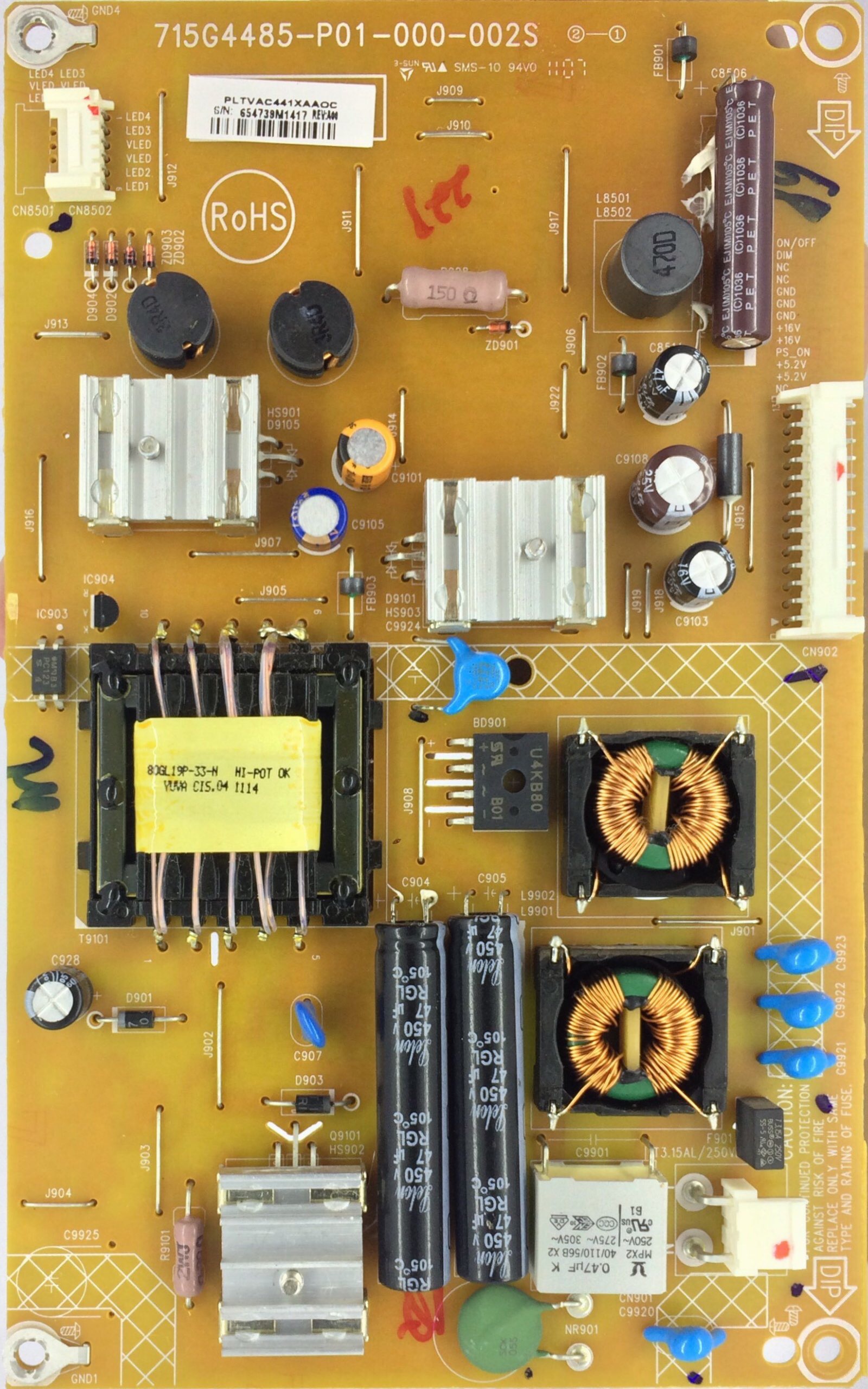

    I don't have schematics, but the circuit is fairly simple as it is a single sided board. I included the best pictures I could take of the top and bottom, and a combined top/bottom image.
    From the quite loud noise coming from the transformer I suspect that it is not switching as fast as it should be, due to some dry cap, but it is just a guess.
    Any suggestion of where should I start?

        Can we see straight shot pictures of the whole bottom side of the power supply board?
        Never mind, the second pictures of the bottom side is fine for me to see the traces..
            Please check the pictures 2 and 3 attached on the first post, I don't think I can get better pictures than that.
            Your body is limited, but not your mind.
              Re: AOC TV LE22H138 Power cycle when trying to turn it on
              I was looking at number two picture with that see through of the top side showing but then I look at number 3 picture and that one is OK for me to see the traces.
                  It is either the main board is drawing too much current or problem in the power supply with failed parts so it cannot handle load.
                  Unplug the TV from the outlet and use hair dryer to heat up the entire board for about 3 minutes and the try again to see if the squeal is still there.
                  I suspect bad cap C928 in the hot side of the circuit.
                  Also look real close at the legs of the main filter caps C904, C905 to see if there is some kind of corrosion on the legs of the caps.
