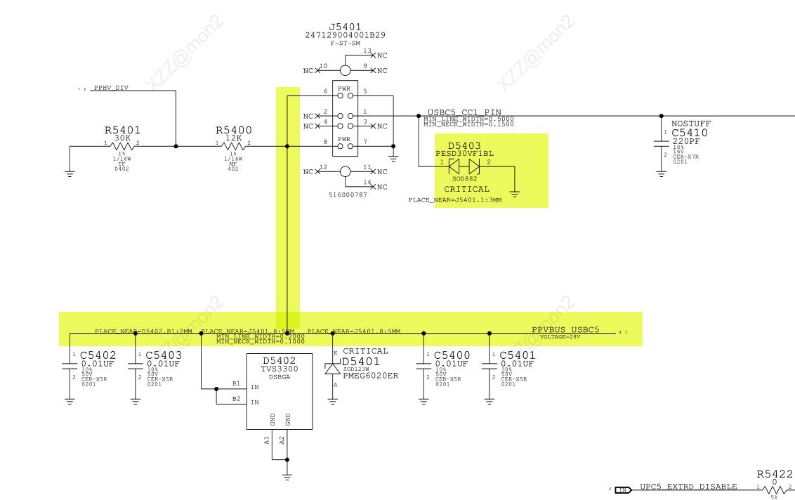

    Hello Everyone, I'm new on this board 820-02100 and having a problem on the charger 5v then 19v then back to 5V again in cycles. I don't know where to start. Any help greatly appreciate.

            Remove all power. Locate the magsafe connector @ J5401. On J5401 is a diode @ D5403. Meter in resistance mode. Measure the resistance to ground of this diode (USBC5_CC1_PIN).
            Also interested in the same resistance check of PPVBUS_USBC5 on this connector. No power to the board / no adapter during these tests.
            If the diode @ D5403 is damaged from an ESD event, then this resistance will be low and a defective diode will shunt the communication over this BMC line used for the power delivery contract. Under this condition, only 5 volt will ever be selected by power on default to power this logic board = too wimpy of a power rail.

              Okay! resistance of PPVBUS_USBC5​ = 36.6KΩ
              Resistance to USBC5_CC1_PIN = 4.8MΩ

                  I replaced UG800 due shorted on the ground, After replacement still have the same problem on the PPBUS_G3H Power rail pulsing from 12.35 to 10V. I removed the fuse again F5200 and F5201 and injected 13.0V on PIN2 and nothing is short. I decided to put it back the two Fuses F5200 and F5201 and pulsing for a second of and on off and on after couple restart finally I have a steady MagSafe orange light and steady PPBUS power and computer boots up. This is now FIXED. Thank you for your help.
                  • mon2
                    • Dec 2019
                    • 14509
                    Suspecting there was a shorted (partially?) capacitor on the PPBUS_G3H line causing the chirp mode pulsing. The injection smoked out the defective capacitor. Well done!
