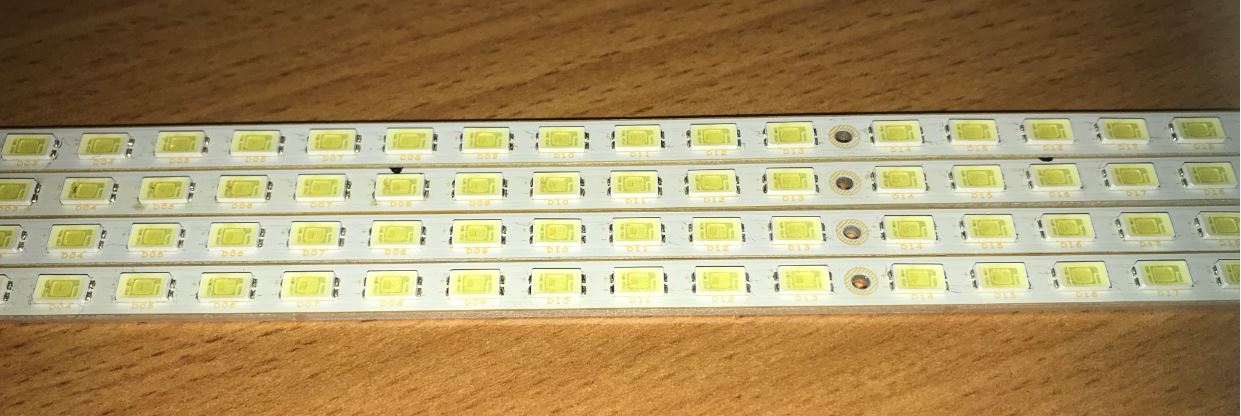

          Took out the LED strips. Took a long time to dig them out.
          4 x strips with 52 LEDs, and each LED is ~.720V drop.
          So, 52 x 0.720 = 37.44V for one strip, and I'm assuming the 65.9V output from the driver powers two of the strips in series.
          I measured all the LEDs individually, none are shorted, but some have a >.8V drop.

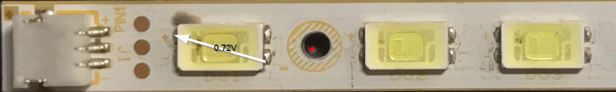

            Re: LG 42LE4500 PSU Replaced Backlight Failing Again
            0.720v drops, that cannot be right at all. How did you go about testing the Vf of each LED?
                These are so small I couldn't even see the + and - on the two pins on the left. I measured the pins in diode mode and the multimeter is seeing a diode, the cathode of that diode being on the + pin.
                My multimeter will not measure a 3V diode, it only goes up to 1V I think. I have a power supply here that I can set to 3V and limit the current to 10ma, so I could test the diodes by putting the pins across the + and -

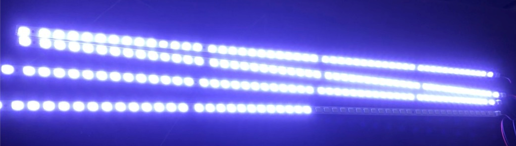

                        Well things have just got interesting. I did what I should have done in the first place, pulled out the LED power cables and wired it up on the desk. When I power on the TV, I see the following before the LED strips shut down completely
                        So I said "okay I DO have a dodgy strip". BUT, when I swop the four backlight cables, the fault follows the cable. It seems very unlikely that the backlight cable has been damaged but I will try and somehow work out some replacement wires for testing.
