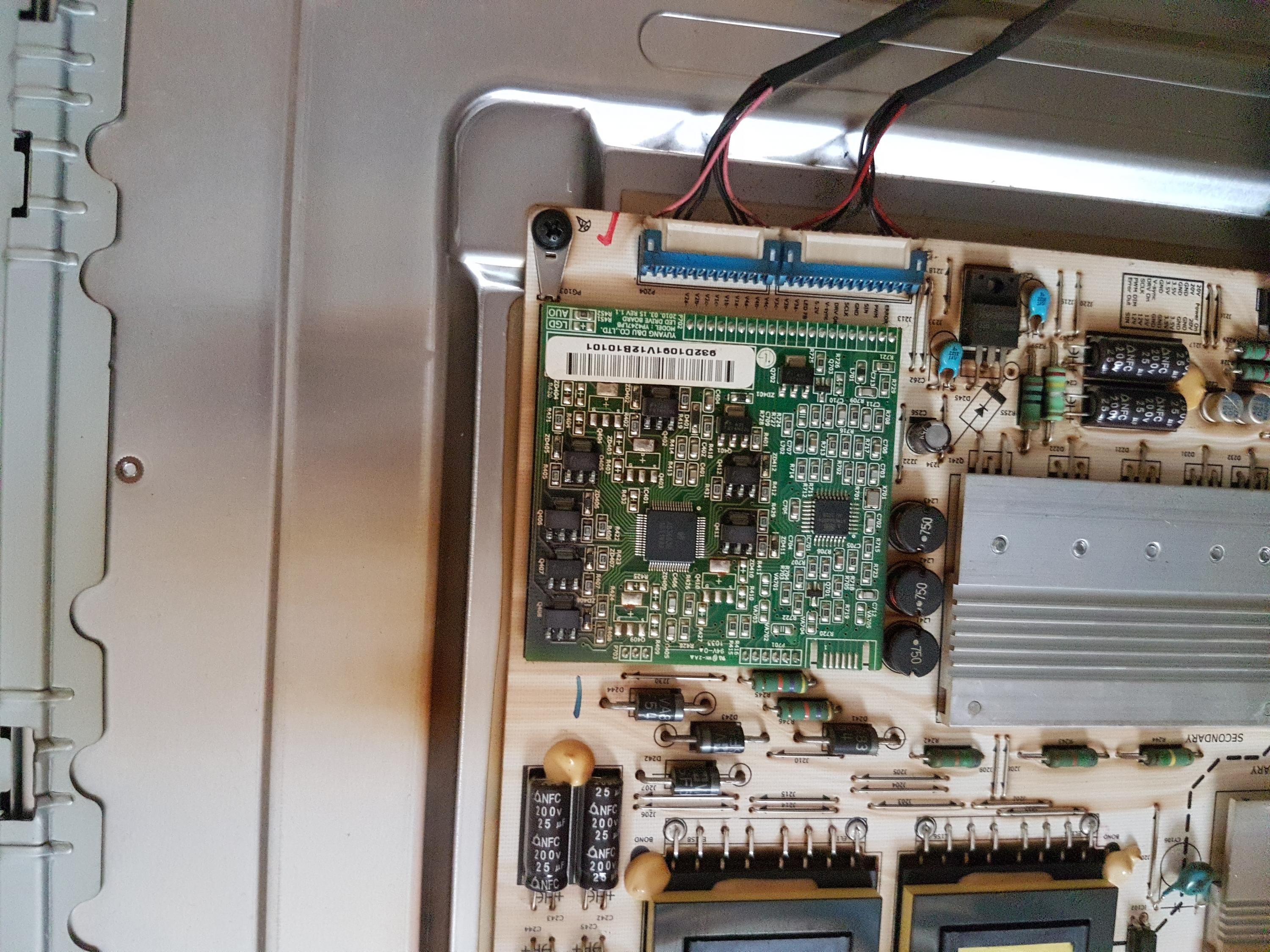

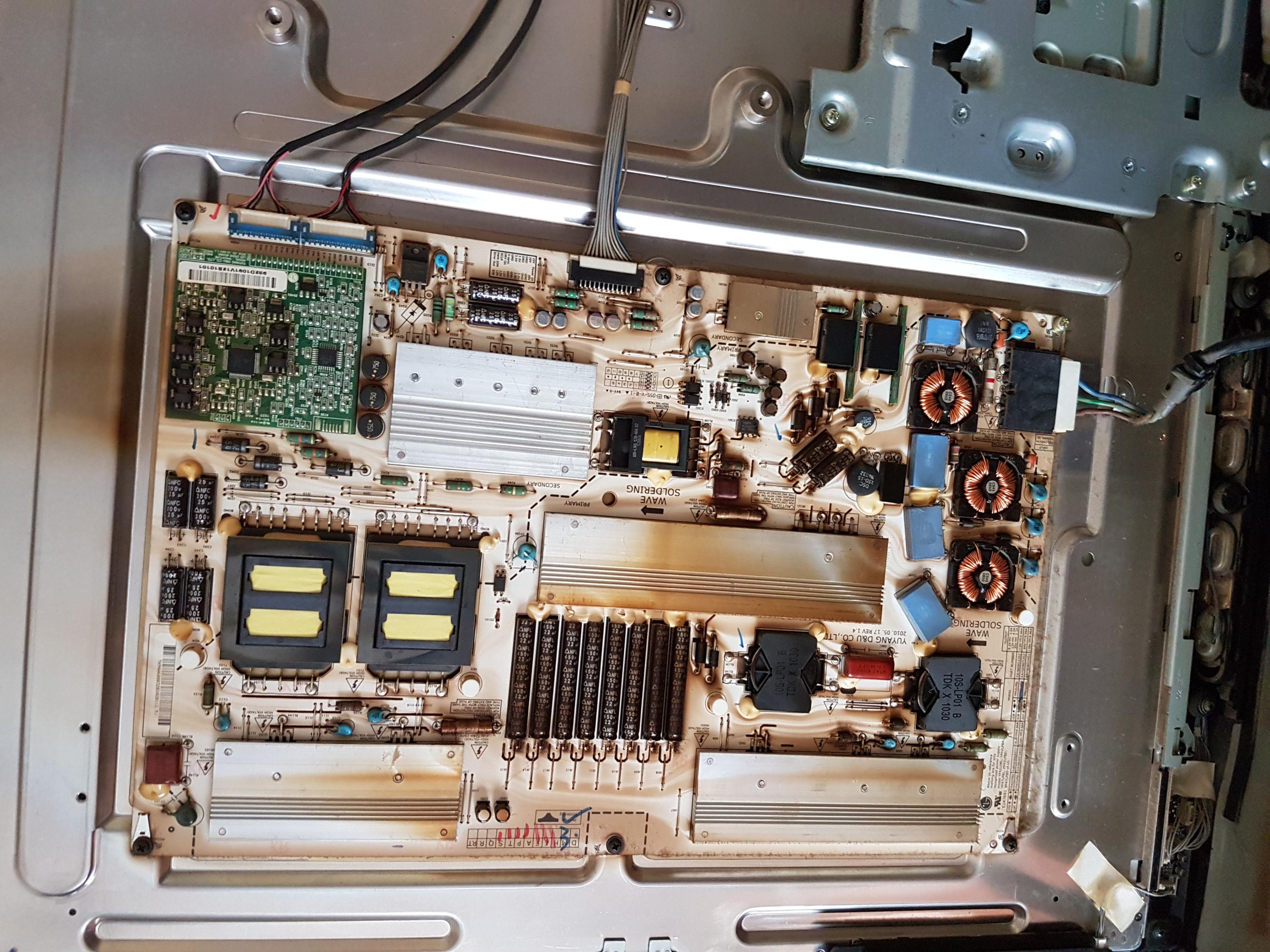

    Can you post pictures of your circuit boards especially the led driver board attached to the power supply.
      I can get you a new picture when I'm over there probably tomorrow but this is the original PSU that was in it when it failed.

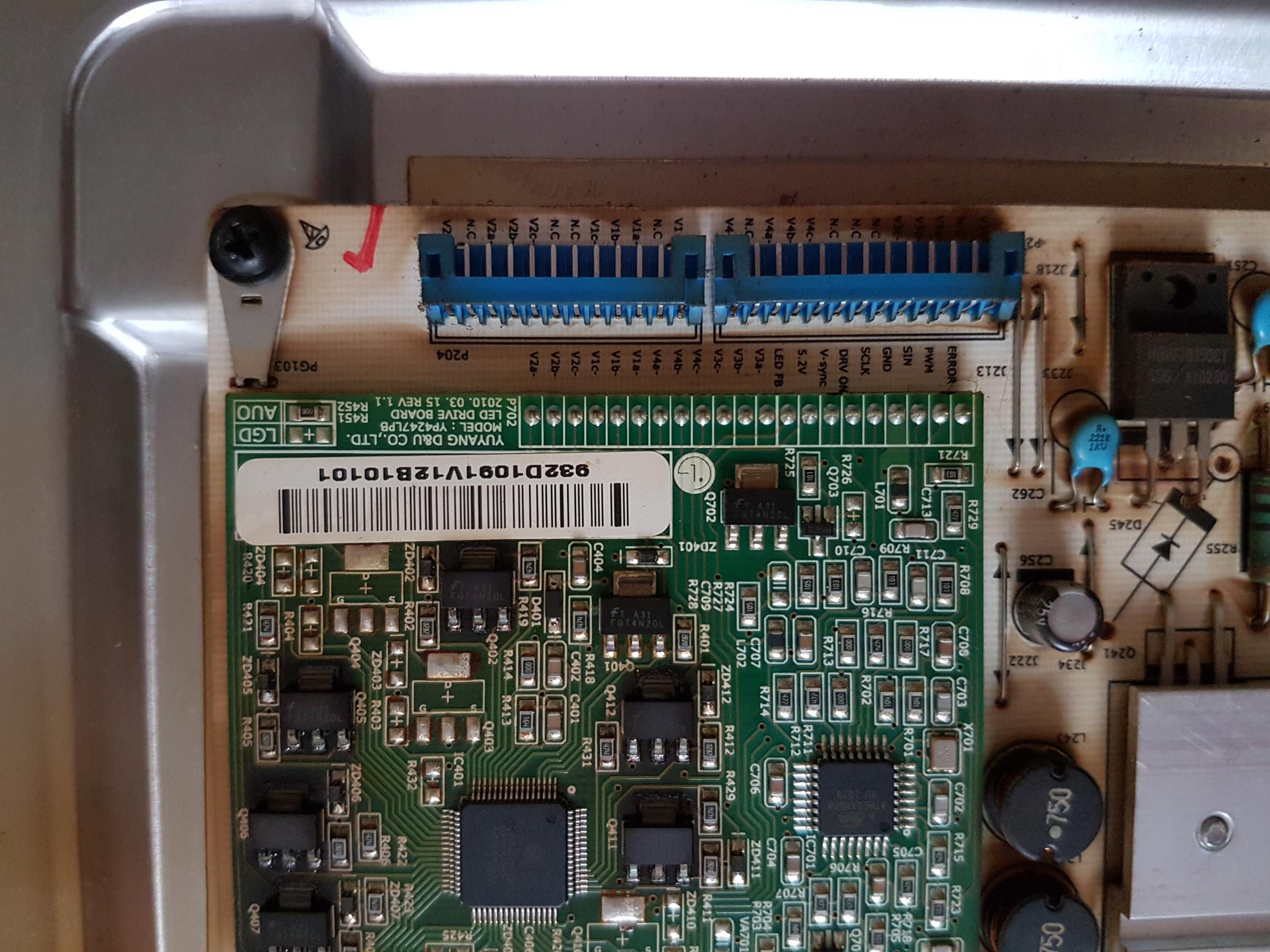

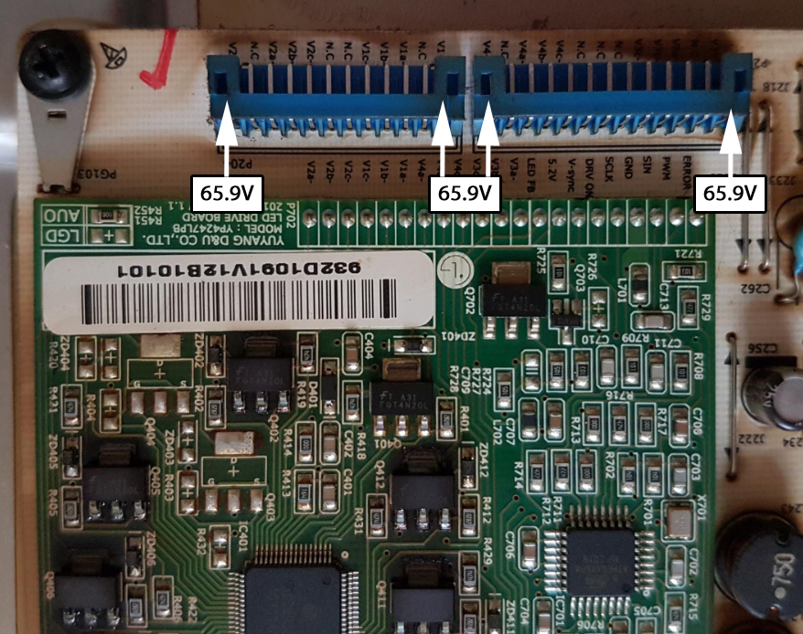

        On the Led driver board I would test Q401, Q402, Q411, Q412 etc. all the ones that look as though they have well and truly overheated

          I'll have look when I'm over. I'll see if the new one is burning out also. I'll bring over the multimeter and check them out to see if it'll be a cheap fix. I wouldn't mind replacing the whole psu again only what if it does the exact same thing again. The entire psu isn't too cheap either.

            Re: LG 42LE4500 PSU Replaced Backlight Failing Again
            I suspect you have bad led's
              Guess here since those transistors are COOKED that you have bad LEDs in the backlight.
              Those transistors regulate the current between strips on the panel by dropping voltage, but if the strips have shorted LEDs in them, then they will have to drop a lot more voltage to make up the difference.
              Then they will begin to cook (because if the current is the same but the voltage is much higher, they will have to dissipate a lot of power.)

                  It looks like the led controller mosfets took the strain of the leds going faulty as tom66 said and is why they appear cooked.
                  I see no reason why replacing the led strip should cause any problem, however the led driver board may now be damaged.

                      multiple shorted leds on multiple strips.
                      not uncommon.
                      the increased drop across the regulators is cooking them as mentioned earlier.
                      if you fix it update the firmware as change were made to prevent this.
                      lg pushes the leds too hard.
                      and you can replace the mosfets rather than the board.

                          Hi everybody.
                          I have one of these with the same fault. And I live in the same place, Leinster, Ireland!
                          Mine looks the same, MOSFETs looked like they have been through a deep fat fryer, and the backlight comes on and shuts off. However, when I plug out the backlight, I get 65.9V across the positive pins going to the LEDs.
                          So it seems that even though the MOSFETS don't look great, and the plastic that surrounded them looked singed, they are actually doing their job. I checked the LED strips and they look cracked and burned.
                          what do you think guys, is it worth throwing new LED strips in to this, or just shorting across the dodgy LEDs?
