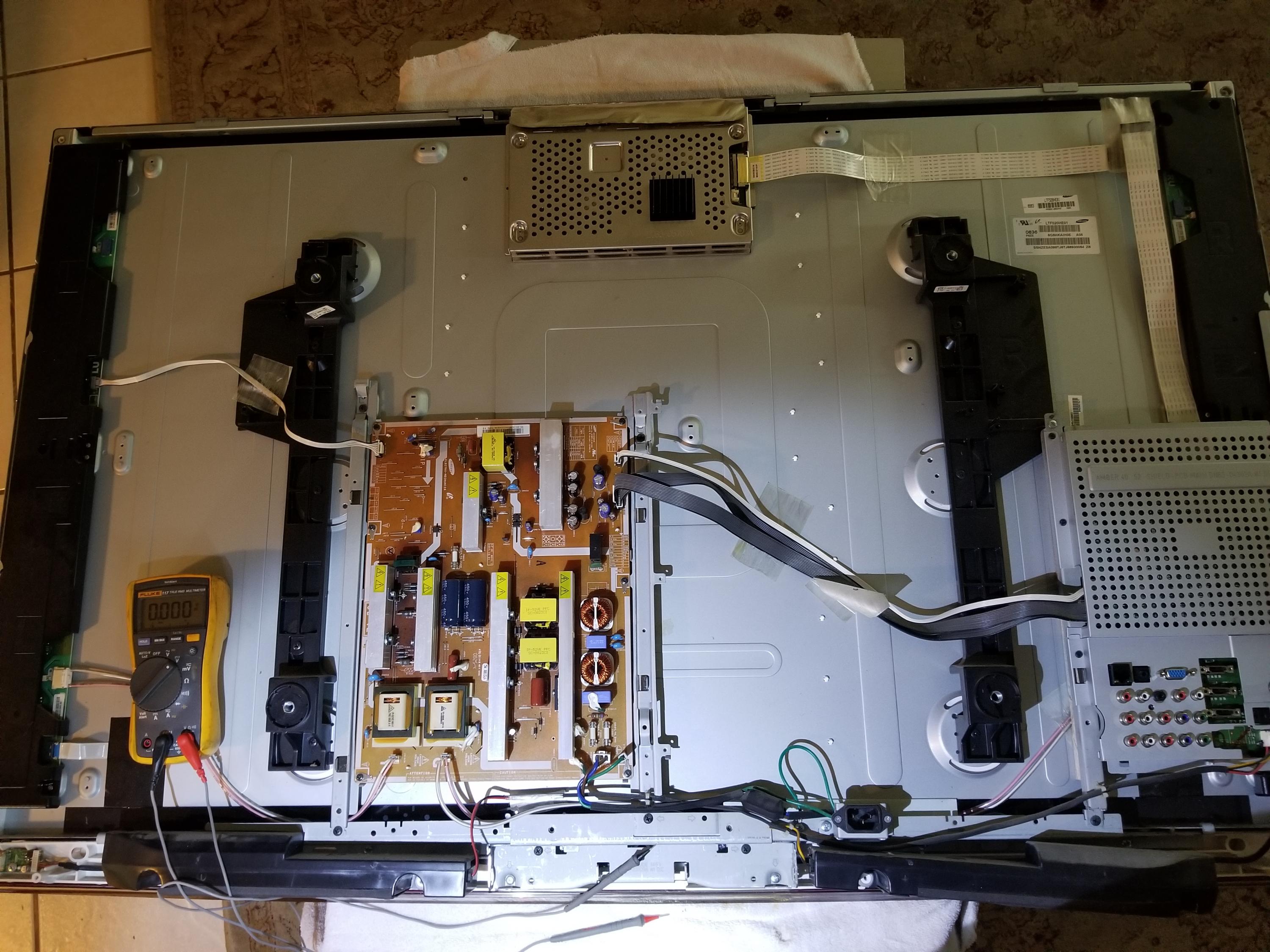

      It looks like there's a short on the main board, the 5V line.. I jumped the PS-ON and everything is good there. Haven't made any progress trying to find the short though.
      I've tried freezing components but no luck there as it doesn't stay on long enough to get hot, and same with an external PS.. Any ideas?

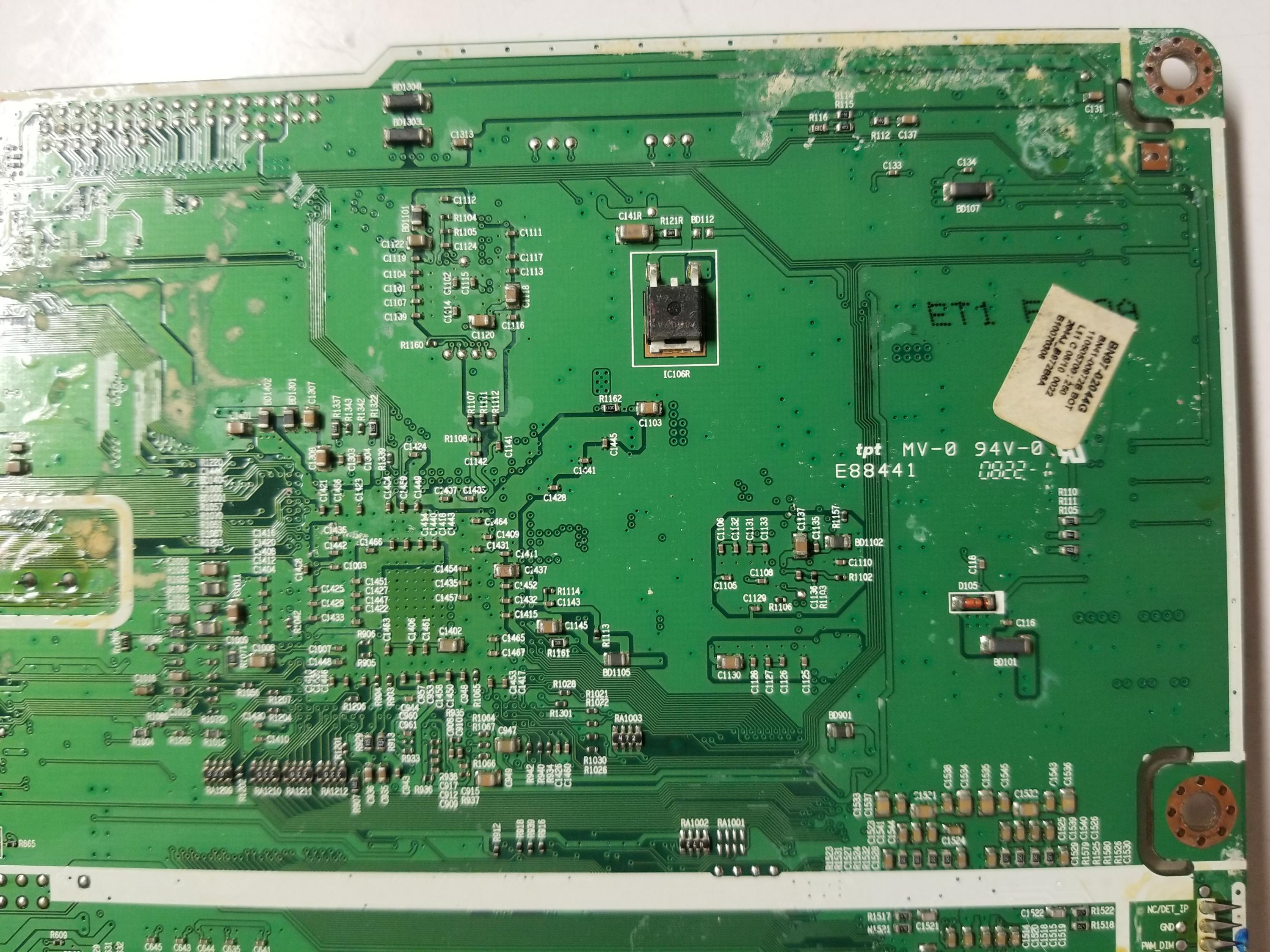

        Re: Samsung LN52A650A1FXZA dead, standby LED just flashes repeatedly
        Found the short on the B5V line but unfortunately did not fix the TV, all voltages present but TV does not turn on, no inverter_On from main board. Relay clicks every 40 secs. Thinking main CPU is bad.

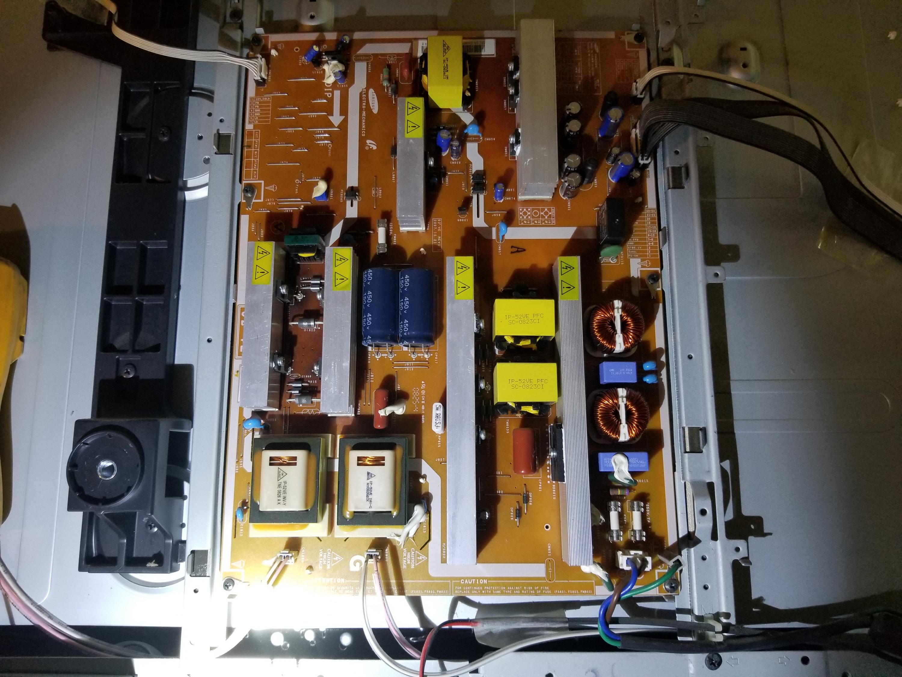

          What is voltage between legs of main cap in standby and when you press power button
            When you first plug in you get 163V at caps for a couple secs, relay clicks and PS turns on, voltage now 390V. It will stay here for 40 secs and repeat cycle. Power button does nothing. This is common with these models with a faulty main board, I've seen many and not found a fault so I've chalked it up to the CPU.
                For what it's worth, the shorted component was either C115 or C903. I took them both off at once so not sure which one it was.

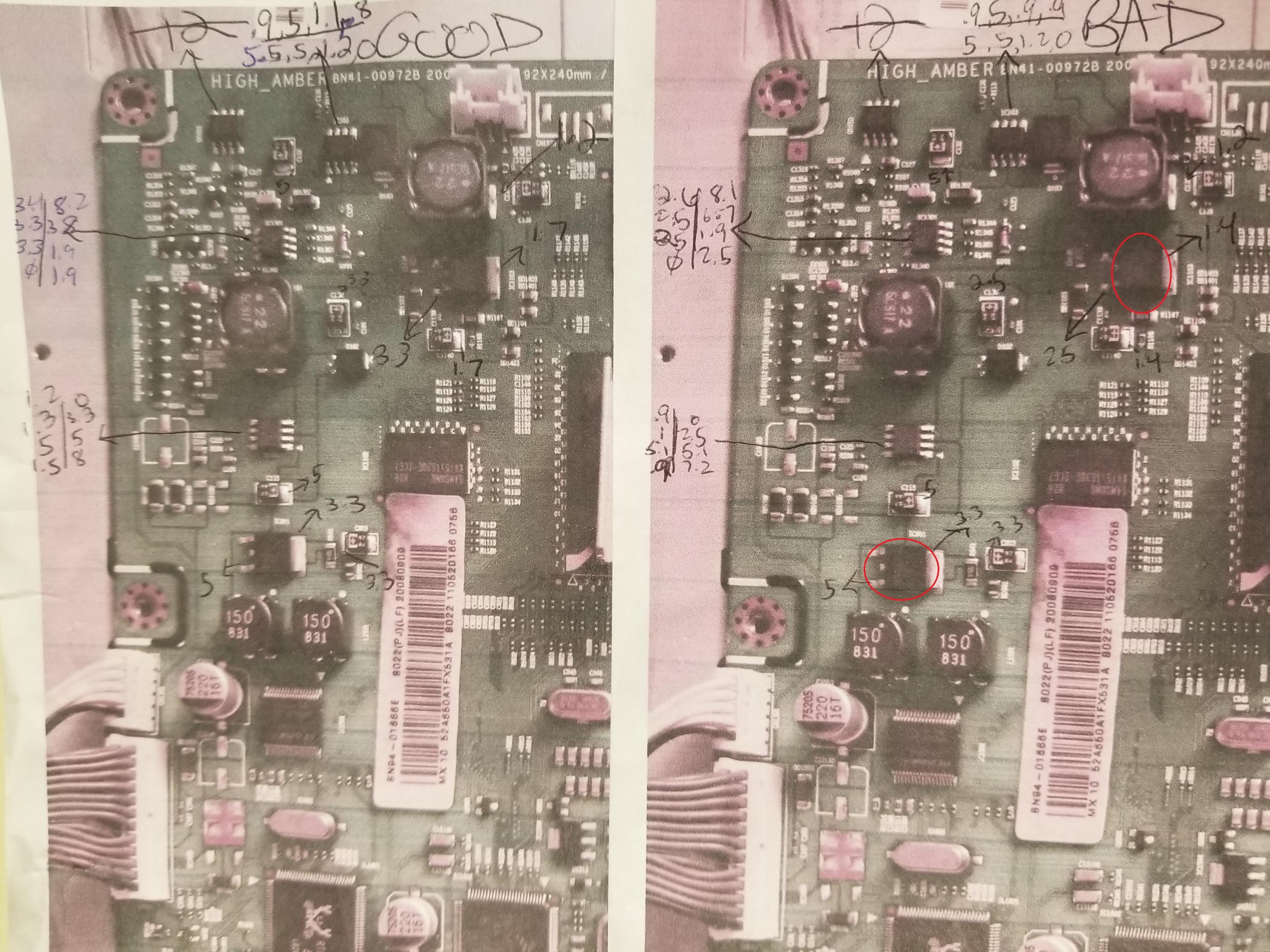

                      Can't resist the curiosity... Got a working board and tested the differences in voltages in this area.. Noticeably a problem between the 3.3v and 1.7v voltage regulators (see circled). Input/output on good one should be 3.3v/1.7v, but bad board is showing 2.5v/1.4v.
                      Is this worth trying to chase down? Every once in a while I see a quick backlight flash like it's trying to power on but then nothing..
                        Does the regulator get hot? Might trace back your 3.3v. May have problem on 3.3v line
                          you could lift it off of the board and see if your 3.3v comes back up.
                            No it's not getting hot.. But does the other regulator 5>3.3v feeding the 3.3v to this one? If so there is a breakdown somewhere in that line unless it's being pulled down on the 1.7V line? Is that likely?

                              That was my ? basically, so lift the 3.3V>1.7 regulator and see if input comes up to 3.3v?
                              Lifted input leg of the 3.3V>1.7 regulator but input voltage remains at 2.5V..
                                so now start working your way back to the supply voltage. with a good working board it should be easier to do.
                                post a high res pic of the area if you want more help, though i can't view it for a bit. dam teenager ate all of the data and doesn't refresh for 5 days. :'(

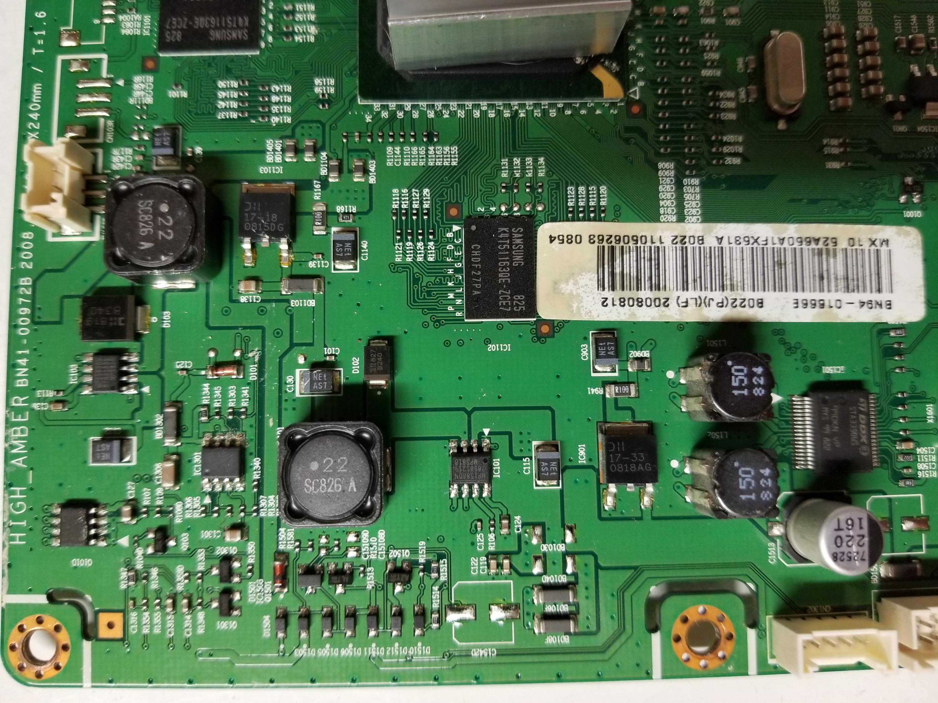

                                  Here's pics.. I'll start looking at it tomorrow. If anyone can look for tips please and thanks
                                    I suspect that the output of 3.3V regulator is bad which it feeds the input of the 1.8V regulator IC.
                                      I have 5v in and 3.3v out of that regulator.
                                        But some how it shows 2.5V at the input if the 1.8V regulator per your post:
                                        'Lifted input leg of the 3.3V>1.7 regulator but input voltage remains at 2.5V..'
                                        If you check the resistance between the 3.3V REG Output pin and the input pin of the 1.8V regulator, does it show < 1 Ohms?
