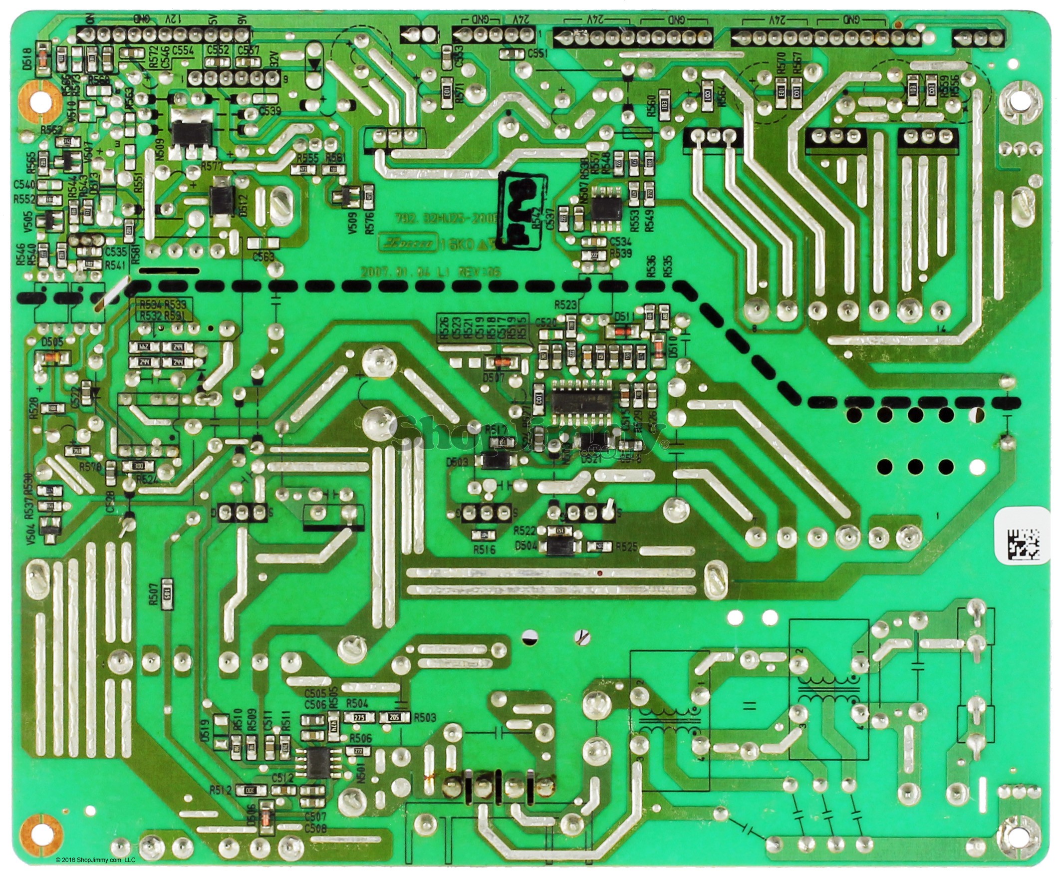

              There are pin names of those white connectors, you need to put down pin names and follow by the DCV reading of each pin so we can see what you have right now.
              Is this the exact board?
              http://www.shopjimmy.com/insignia-66...pply-unit.htm#

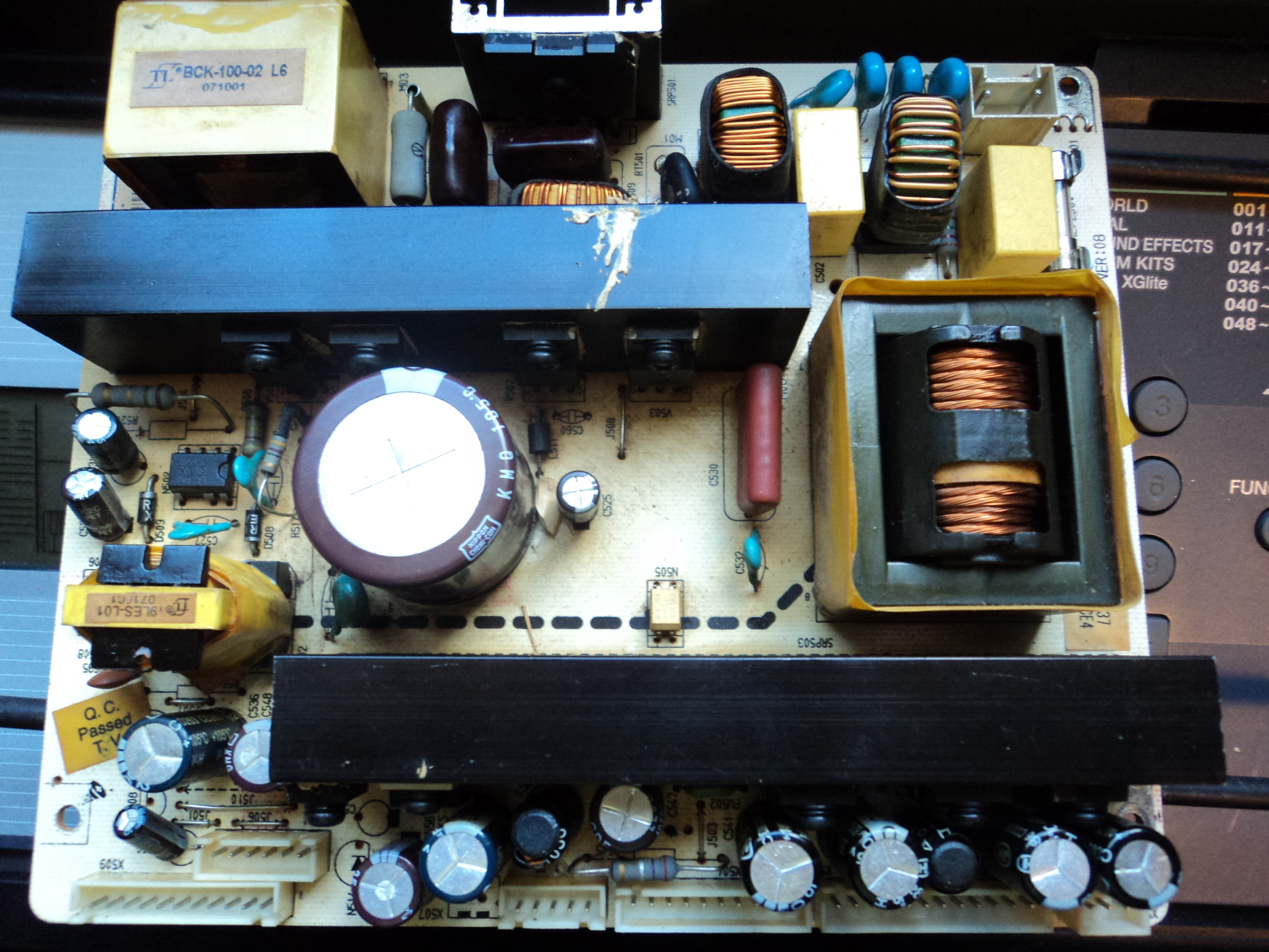

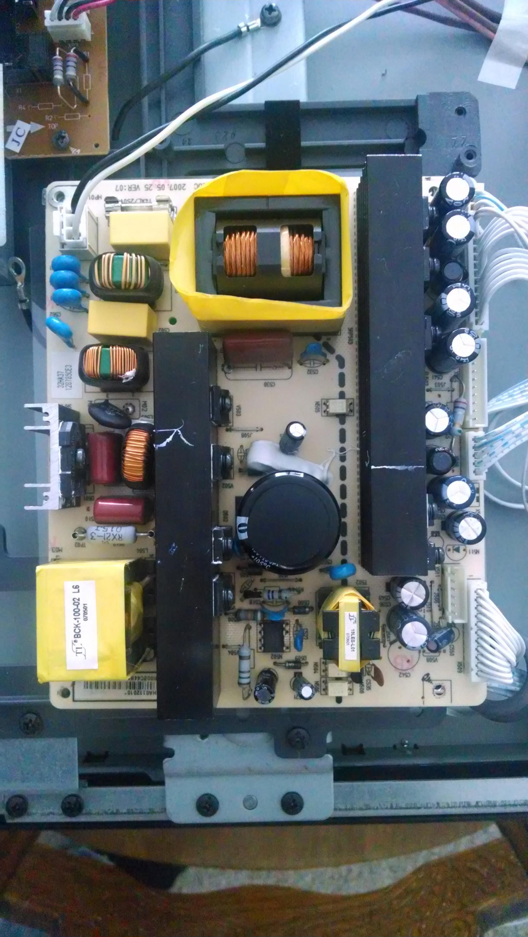

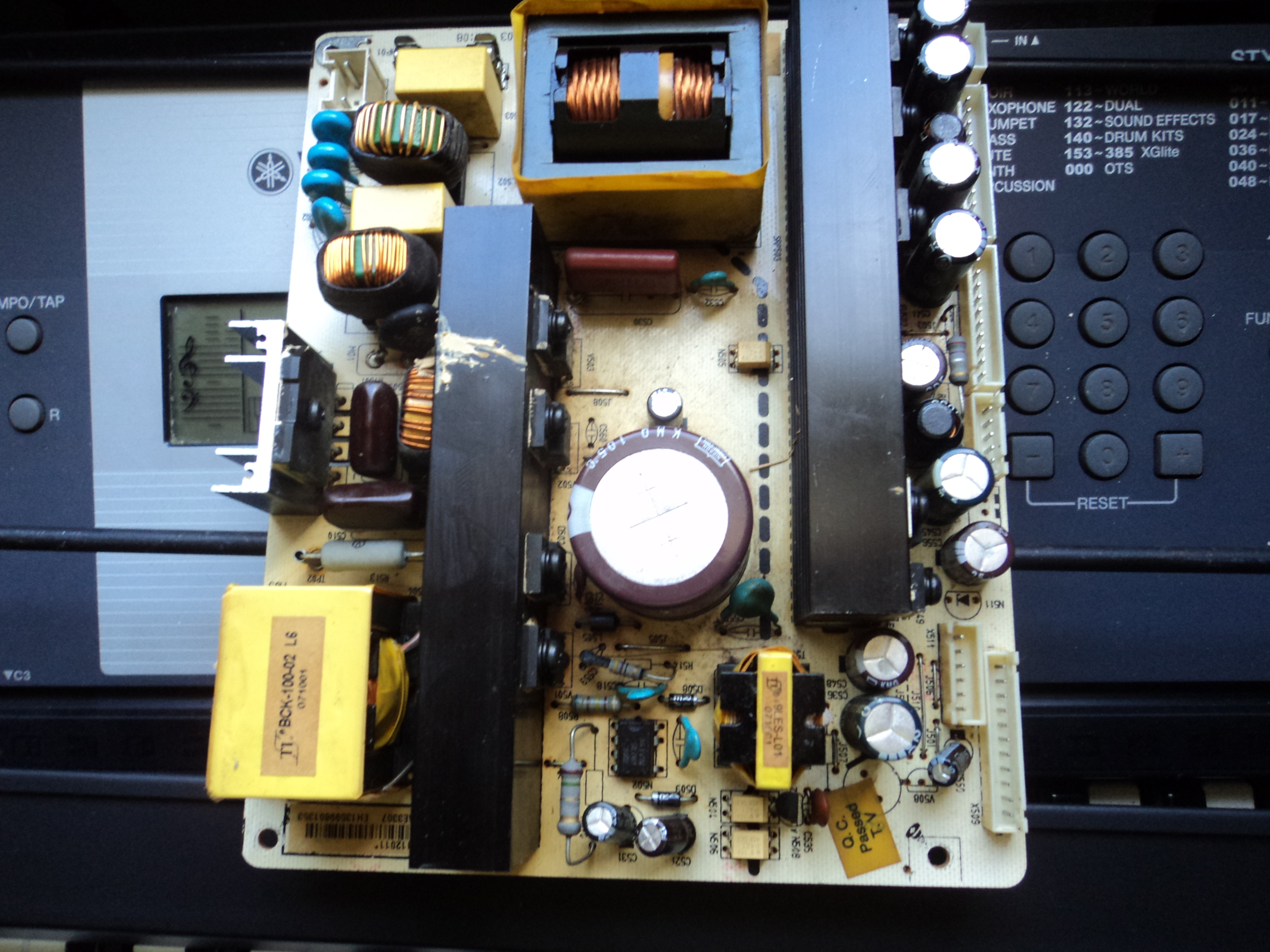

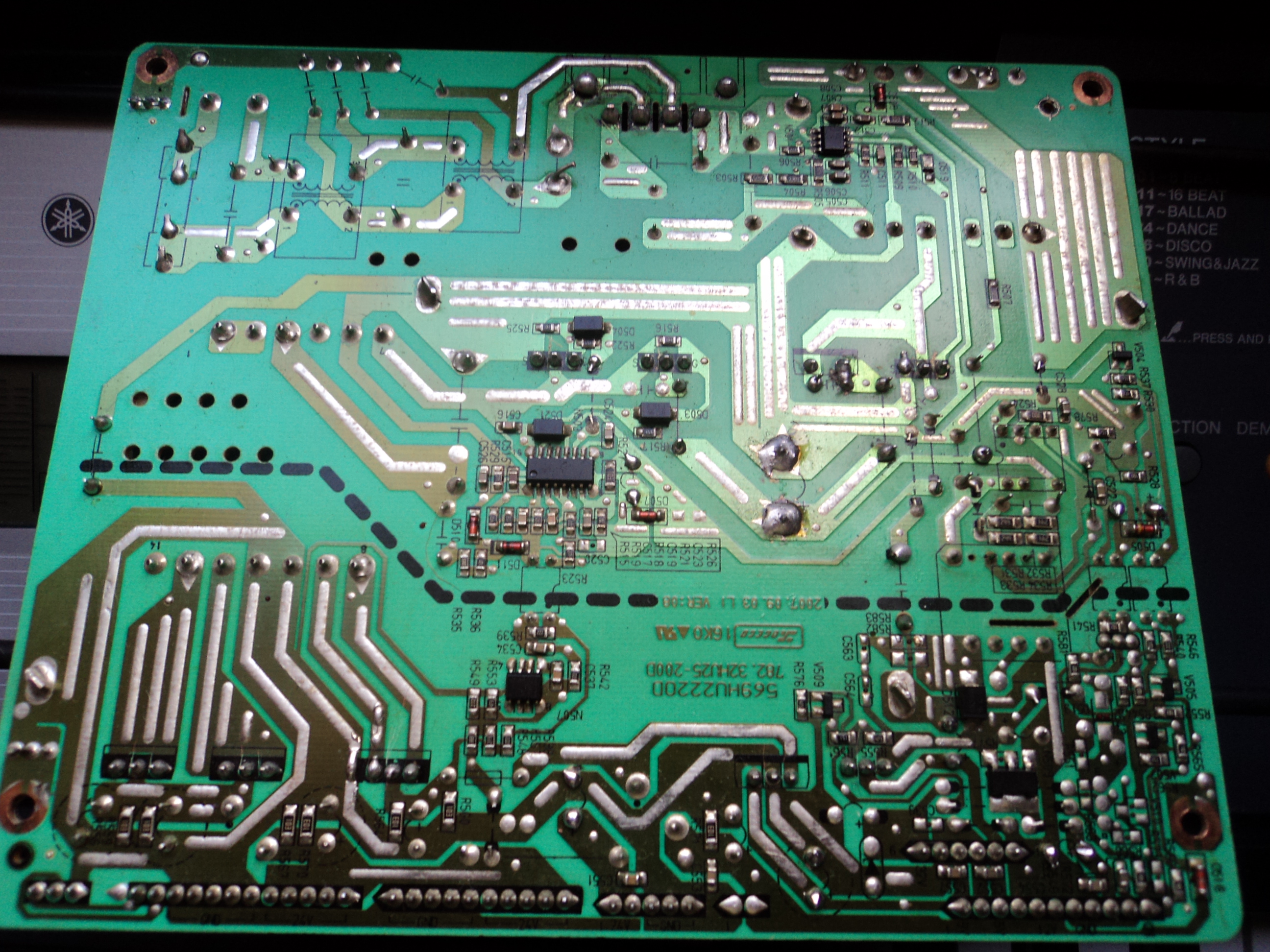

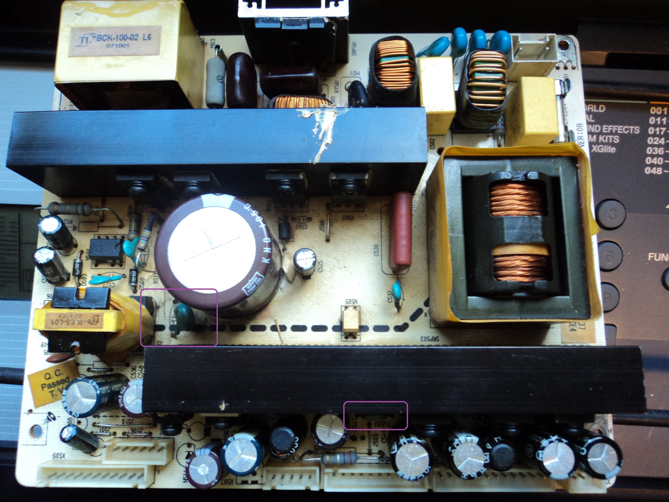

                      Hi guys here pics of my Power Board.
                      • maxvalutech
                        • Dec 2014
                        • 804
                        • australia
                        Re: Insignia NSLCD32 help.
                        I would think the big cap on your power board should churn out closer to 400v when all turned on - are you measuring legs of cap (hard to do with this mounting when assembled).
                        • vinceroger69
                          • Mar 2012
                          • 6714
                          • uk
                          theres not much in regards to pin markings on this psu there is two that say 5V and ON i wonder if you jump these two with a 1 k resistor will the other supplies come up then hopefully budm etc can advise before you try it.
                          • attainteddragon
                            • Apr 2013
                            • 764
                            • australia
                            this may be nothing but this cap is discoloured and have you checked this fuse.
                            also saw a few bad joints on the back.
                            pics aren't great, so i struggled to work out much of the stby circuit, and couldn't find a schematic anywhere.
                            WHY CAN'T PHILIPS USE PHILLIPS HEAD SCREWS?

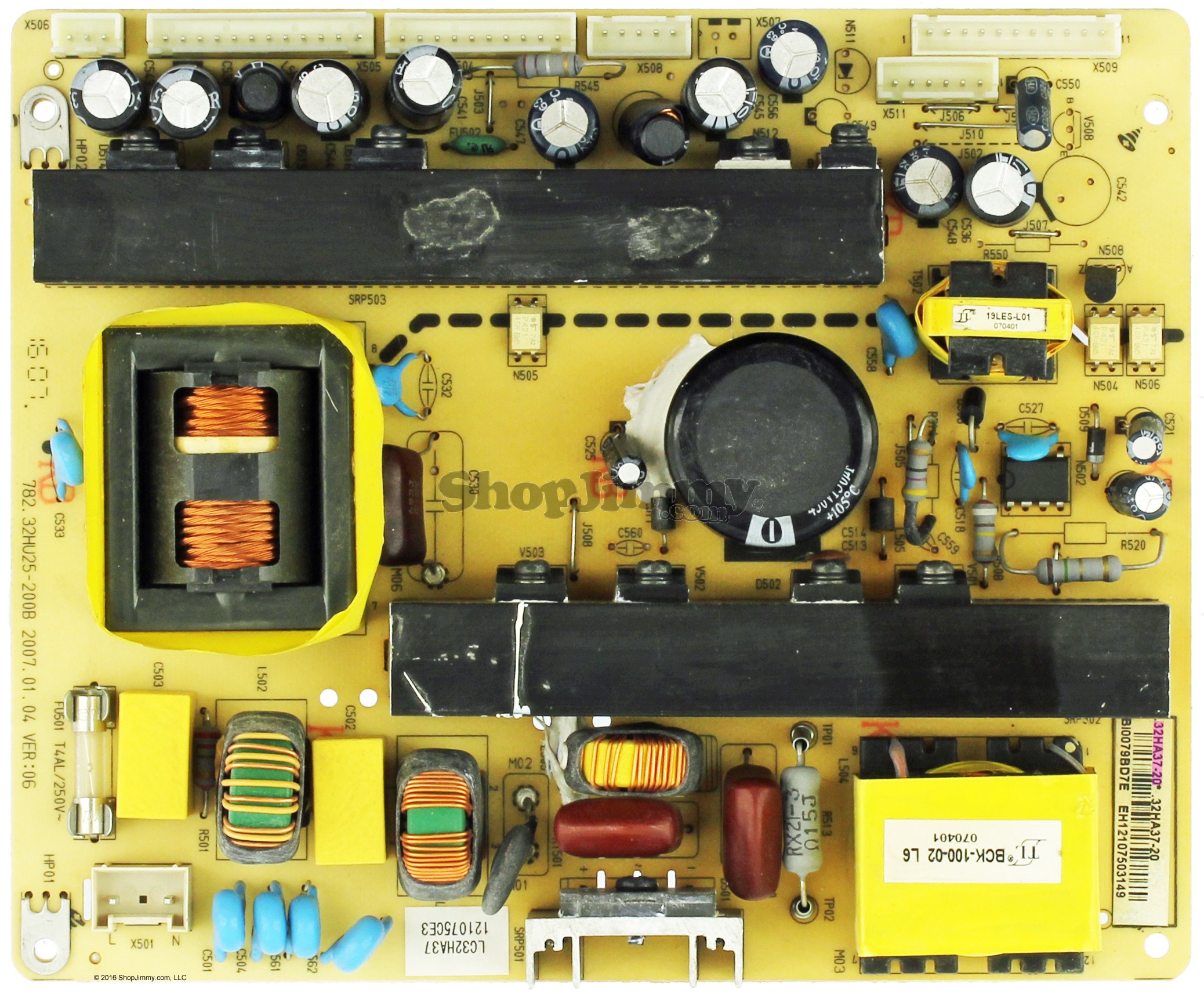

                              the link budm provided by shop jimmy has good zoomable pictures in maybe easier for you too trace the circuit?
                                    The pins are marked on the bottom side of the board. So do you have at least the 5VDC? IOf no 5VSTBY then check those big resistors by the SMPS IC N502, and also two startup/running caps C521, and C??? next to C521.
                                    Pictures provided by shopjimmy.

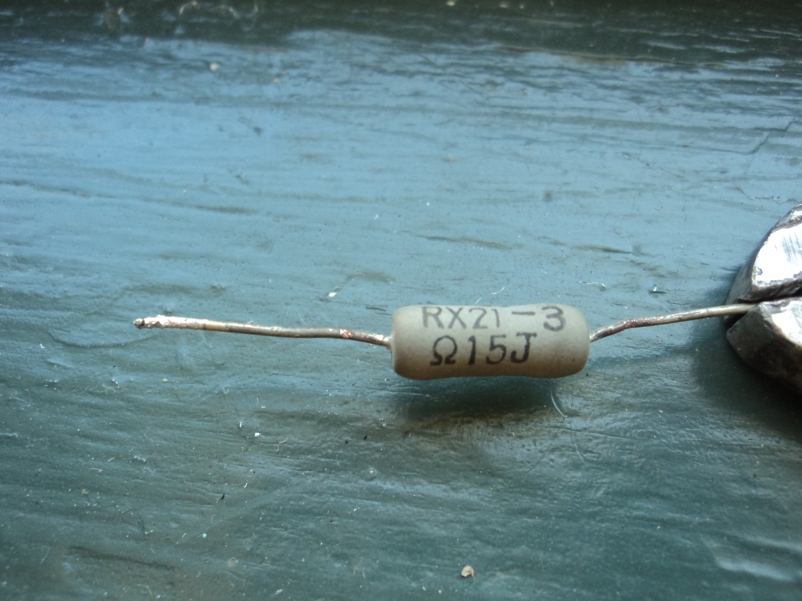

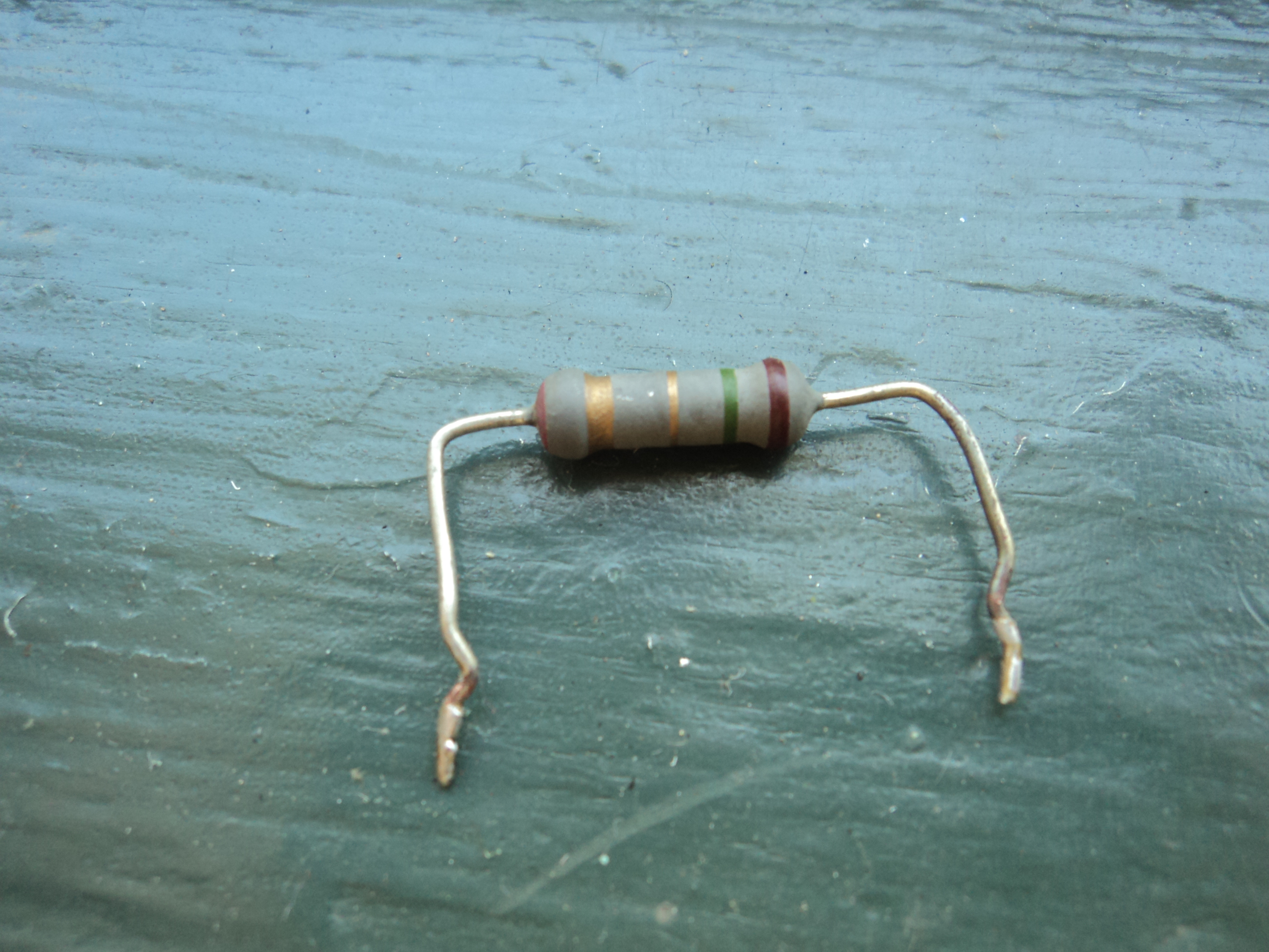

                                      Thanks Budm ;Appreciate the good pics,
                                      Ok i checked R514=74 it's ok 75Homs
                                      Checked R520= 1.7 ohms it's ohms not OK should be 75 ohms,
                                      also checked R513=0.5 ohms not ok should be 15 ohms,
                                      here pic of the bad resistors ,i think!
                                        R513 (in PFC section) is 0.15 Ohms resistor, it shows 0.5 Ohms on your meter because of your probes resistance.
                                        Try heating C521 and the cap next to it with hair dryer first and then apply the power to see if you will get the 5VDC back.
