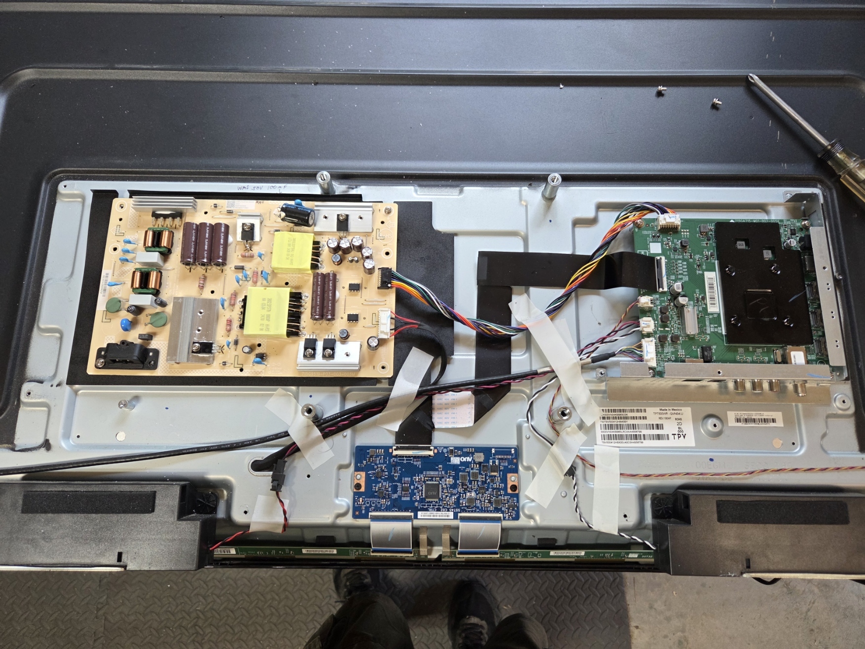

    There is voltage on the bridge rectifier and main caps (163V). Fuses all check good. One of the smaller electrolytic caps (C9112 which is 50V, 100uF) looked bloated, it measured 60uF with one tester, and defective with another. I replaced it temporarily with same uF rating, higher voltage since I don't have the exact one. I also found that one of the switching mosfets (for lower voltage DC supply I think) was shorted. It is a 50R800CE which I didn't have, but had something with the same voltage and current rating and a similar Rds. None of these fixes helped. I'm out of ideas. Any suggestions what else to check? Any possible sources for a schematic?

    I would prefer to replace with the exact parts but sounds like you may have an open resistor or something, there are quite a few SM components on the reverse side, start tracing from the blown fet, i would suspect U9101 could have taken a hit when Q9101 blew.

      Thanks and yes, I will replace the mosfet with the exact part if I can get it to show signs of life. You were right about an open resistor. The .3 ohm resistor was open. But after replacing that, still no joy. I had to get out the high powered microscope the read the number on U9101. It is SSC3S121A, if anyone else needs to know. Anyway, it is supposed to have 15V on Vcc, at least during startup and I measure about 1.5V. It is not heating up, according to my thermal camera. I will order a replacement U9101, but are there any other parts I should order? I will of course get the correct mosfet.

        Maybe get 2 or 3 of U9101, in case it blows again, check everything in that area all the little resistors and mlc caps if they check out you should be good to go once you replace U9101.

          The ic9101 will be damaged for sure, when Q9301 shorted and R9122 opened, 165vdc would have been applied to the OCP pin of the ic.
          This link is to a SIMILR power supply that uses the same ic CHINA 715G7574-P01-000-0020 PSU SCH Service Manual download, schematics, eeprom, repair info for electronics experts (elektrotanya.com)

            Awesome, glad you were able to make some progress, be sure to try and get authentic/genuine parts, hope you get it sorted, we all love it when something gets repaired on the component level but as a last resort in case you didn't see it, Tvpartstoday has a package deal containing all the boards for US33 : https://tvpartstoday.com/products/ns...-ns-50f301na24

              Thanks for all the help, you guys! I will order the parts tomorrow and if I get it working, I will donate it since Best Buy is replacing the old one under warranty. I also hate to see things go to the landfill.
              BTW, I can't believe they sell all 3 boards for only $33. It may be a wash buying the boards, vs. the parts I need.
              • tbsmith
                • Sep 2016
                • 21
                Looks like I will buying the repair kit instead of indivicual components because I can't find U9101 (SSC3S121A) from the usual suspects (Mouser, Digikey). Will post back here when new boards are installed.
                • nomoresonys
                  • Jan 2013
                  • 12206
                  • U.S.
                  Two U9101 there, looks legit, speed pak shipping, looks like it's SSC3S121 no A on the end. This chip is compatible. The A replaced it, they say the A is new and improved but who really knows: https://www.ebay.com/itm/28401461038...Bk9SR-yO87KUZg
                  • tbsmith
                    • Sep 2016
                    • 21
                    Thanks for the link. Since we can't be sure if that's the right part for U9101, and also since there are other parts that need replacing, I decided to go with a used PS board from Ebay for $21. The kit with 3 other boards could have been a good buy, but with shipping and tax, the total would have been over $60.
