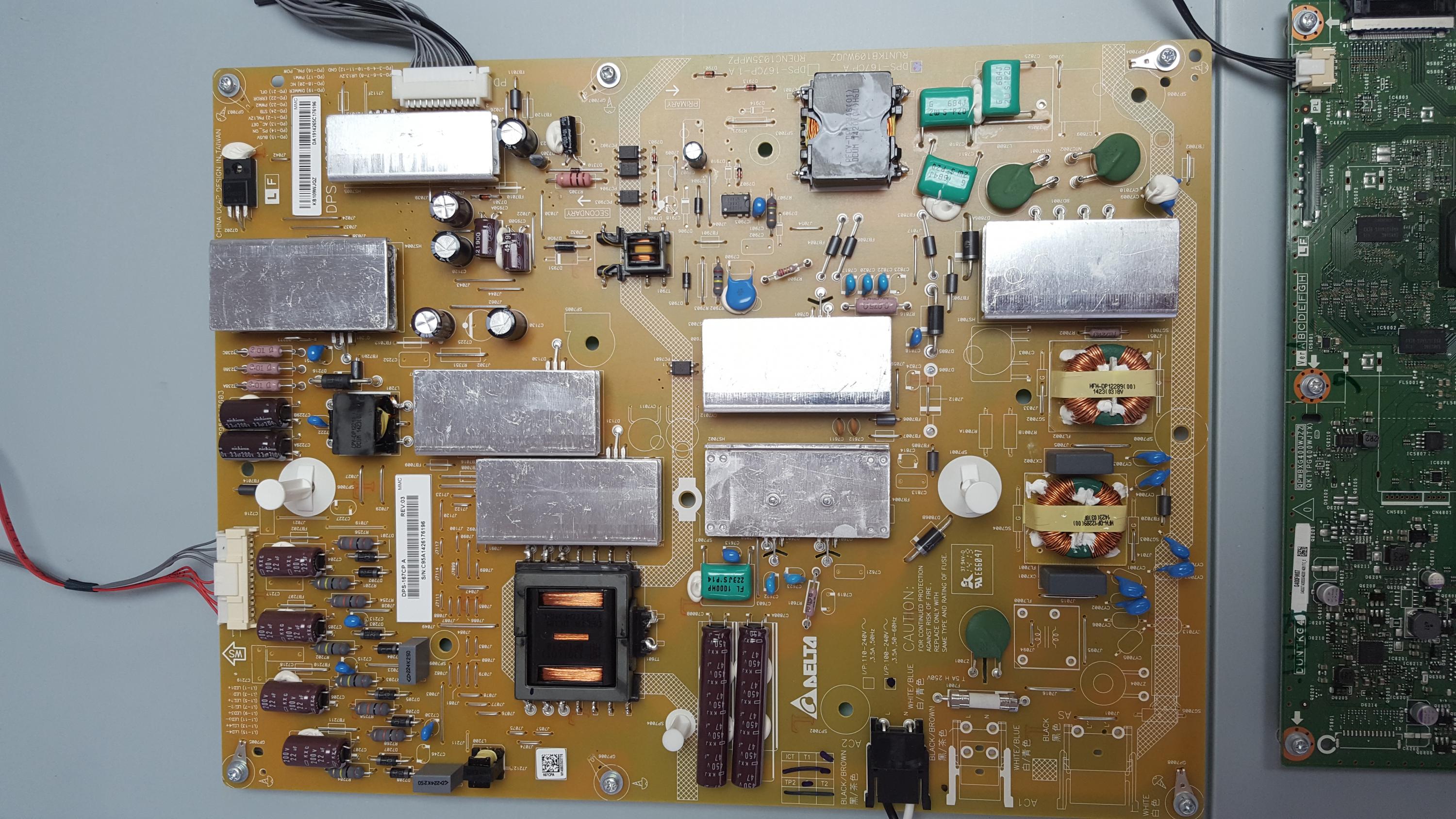

          Here are the L1 readings:
          (L1-15) LED4-: 10.5V
          (L1-13) LED4+: 83.5V
          (L1-11) LED3-: 10.5V
          (L1-9) LED3+: 85V
          (L1-7) LED2-: 10.5V
          (L1-5) LED2+: 85V
          (L1-3) LED1-: 10V
          (L1-1) LED1+: 85V
          Originally posted by budm
          Are you getting PNL-12V feeding the T-CON board?
          Yes, at PD pins 1 and 2 (PNL12V) I am getting 12V.

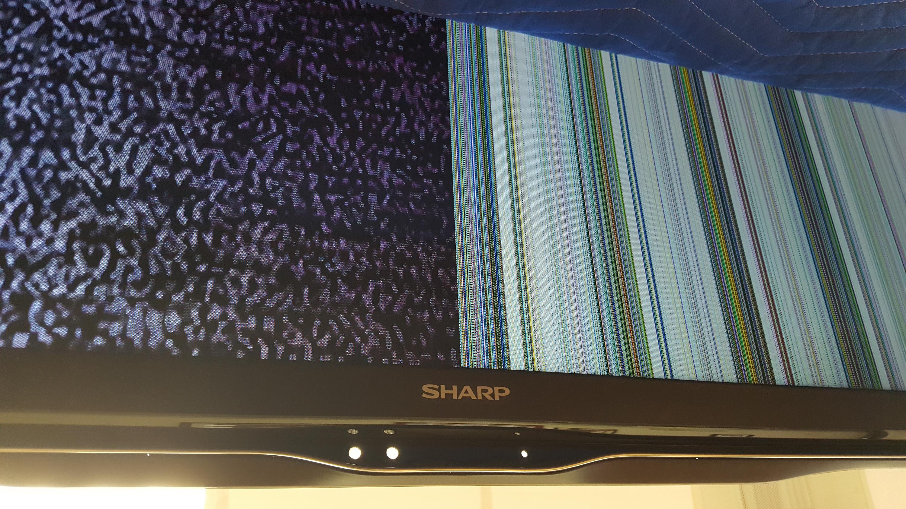

                          Good call, bud. With SC5302 disconnected, I get half snow and half vertical lines. Pics attached. Bad T-CON?
                          With any of the 4 other cables disconnected, I get no backlight.

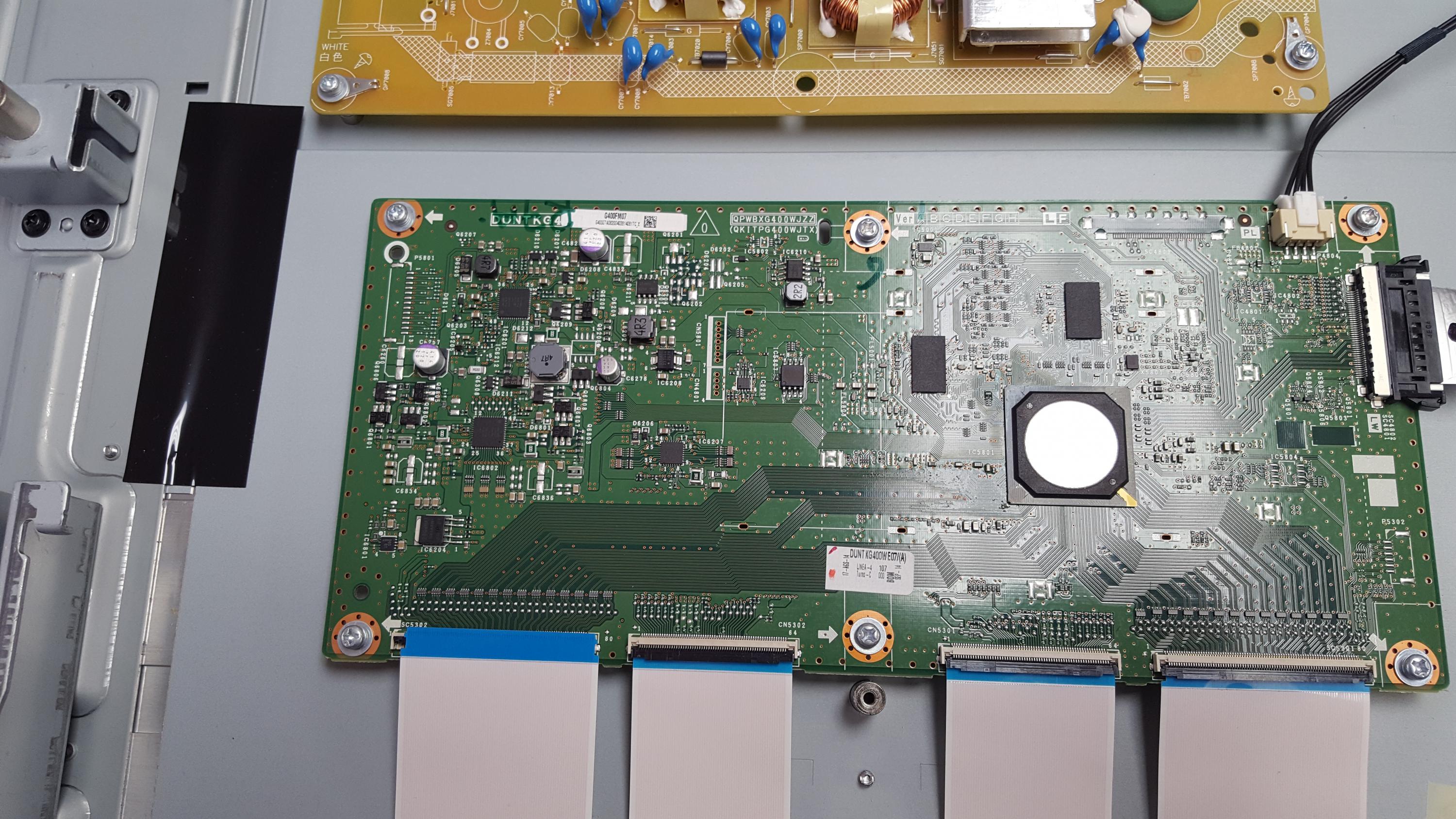

                            So, replaced the TCON with a "good" board from eBay (they claimed it was tested; only place I could find one). The same problem persists. Disconnecting one ribbon cable from the TCON gives me half snow/half vertical lines.
                            Any other suggestions?
