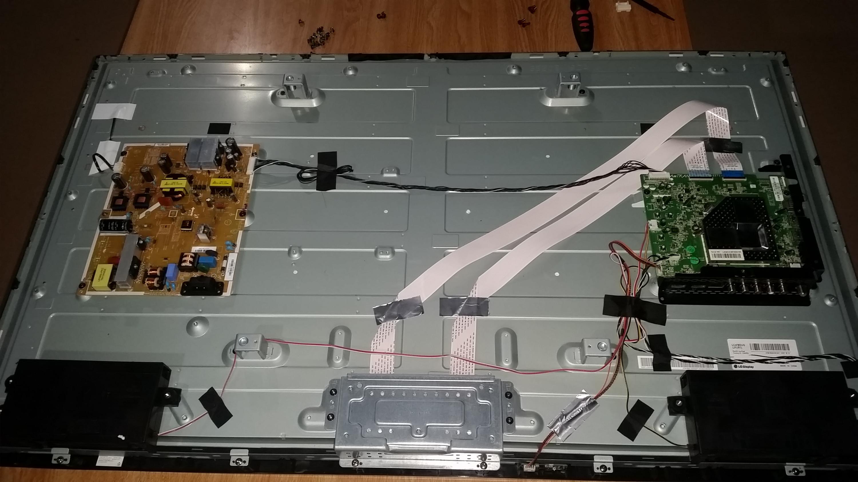

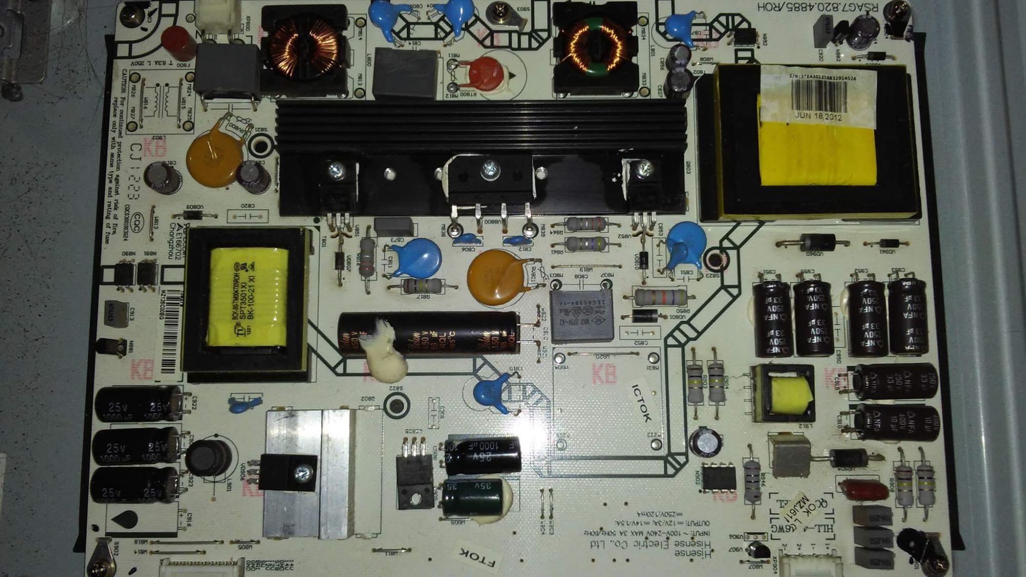

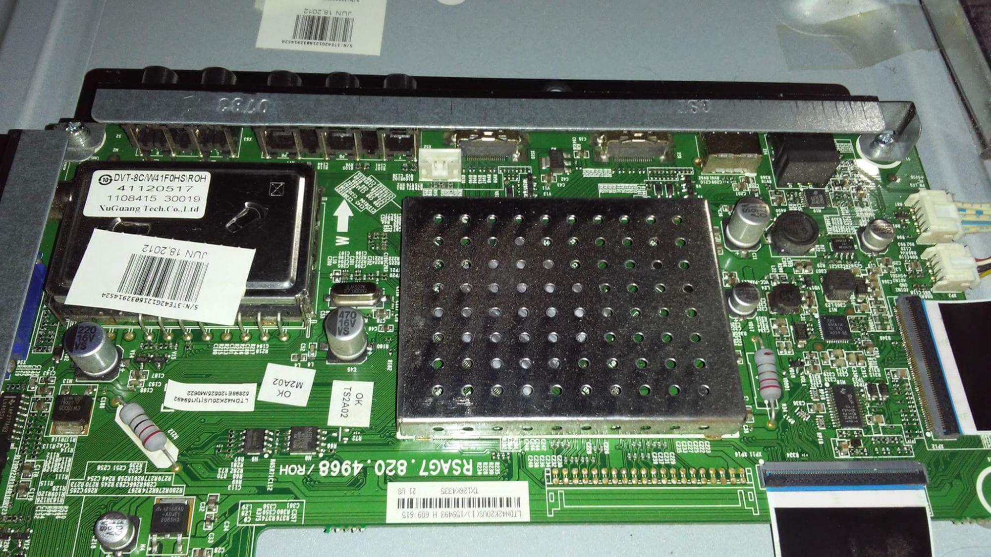

      Re: Hisense f42k20e turns on, screen goes dark
      Any pictures of your circuit boards would be useful.

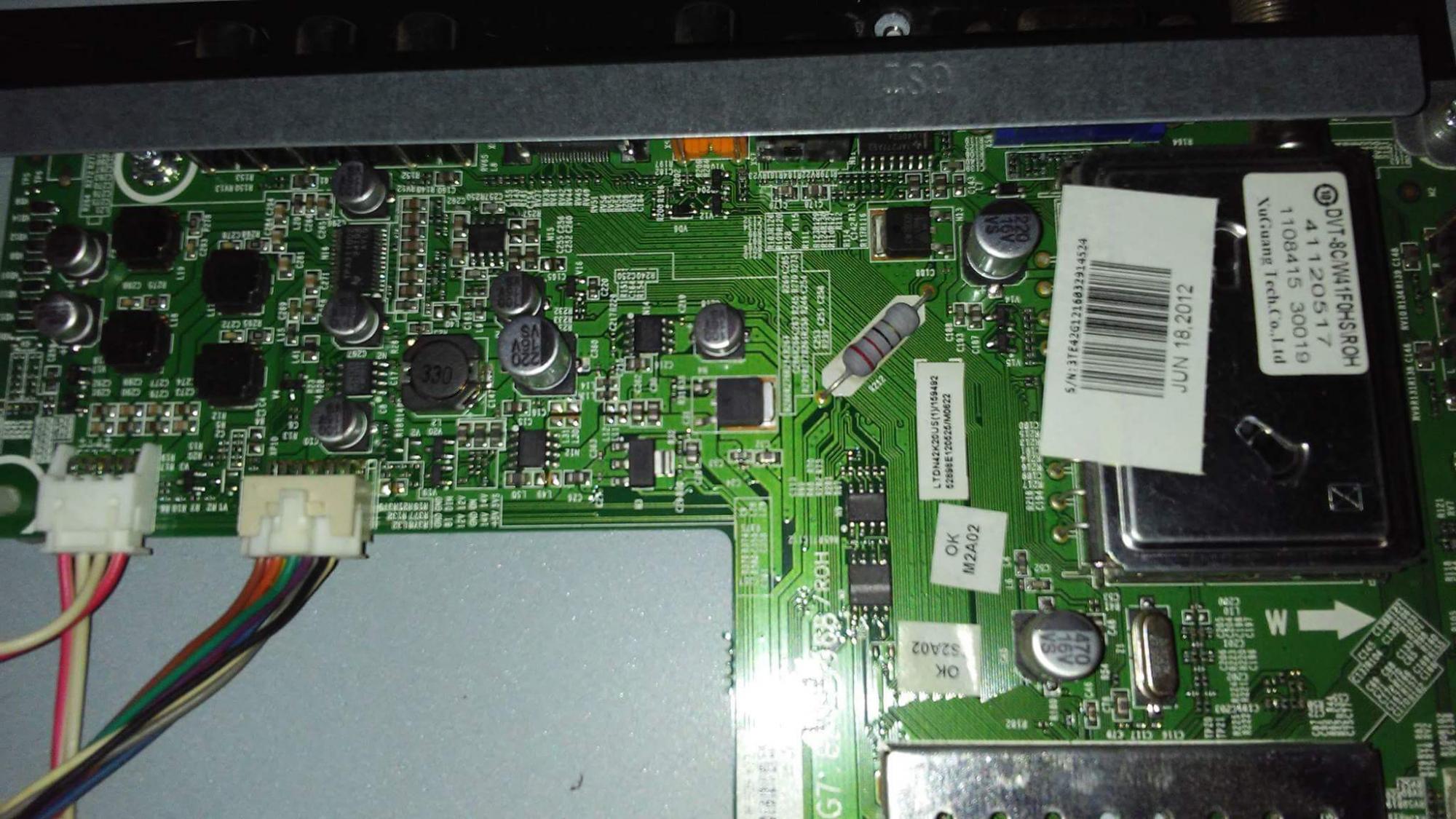

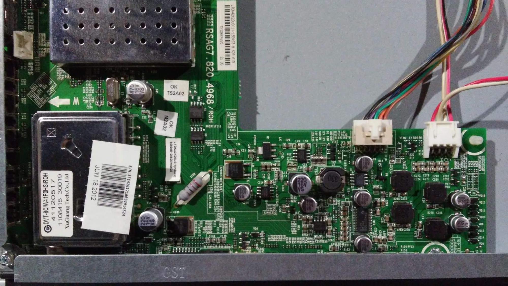

        In the picture attached, the coil with the black bands on it makes a low pitch buzzing sounds when the tv is in standby, and stops when it's switched on. The large yellow block with the sticker on it makes a strange sound when the leds light up, then stops when they go off (even with them disconnected). The sounds it makes is a little reminiscent of a hard laptop drive if that makes any sense.
          I just realized the first picture of the back of the set is incorrect. Please ignore that one.
            If you place your meter probes between the two legs of C810, what DC voltage do you have in standby and out of standby?

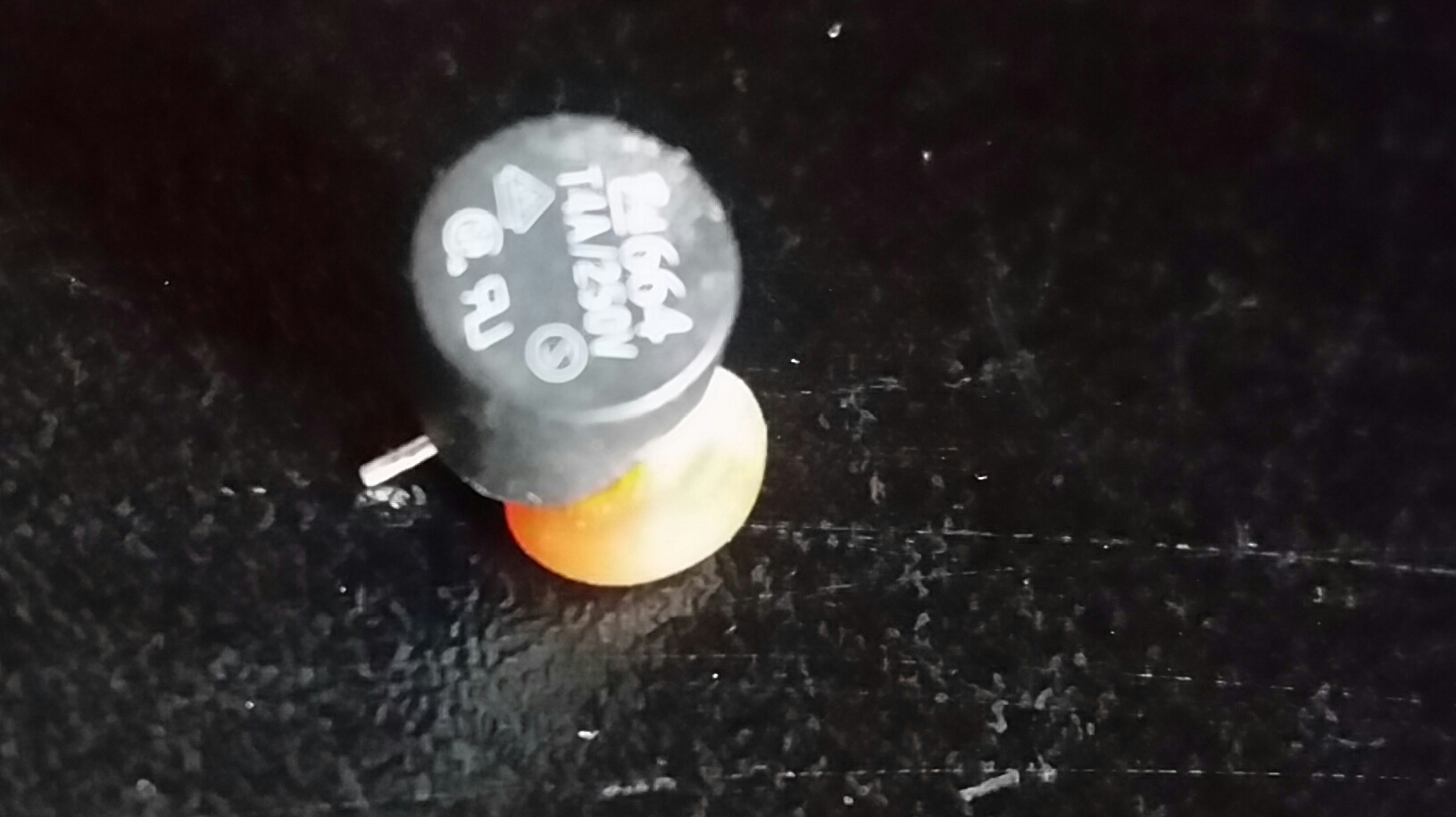

                  When removing the power supply to inspect the bottom, I found this little guy on the floor (picture attached). I don't know if it came from this tv, or my Vizio I posted about in another thread. After I found it I plugged the power supply back in and the tv still acted the same.
                  What is this and where might it go?
                    That is the a fuse. You should leave the meter probes on the two legs of the main cap again and see if the Voltage jumps up higher than 160V when first turn on the TV, since the boosted Voltage for the LED has gone up and then drops down it may have been due to the protection circuit kick in so the PFC also gets shutdown too.
