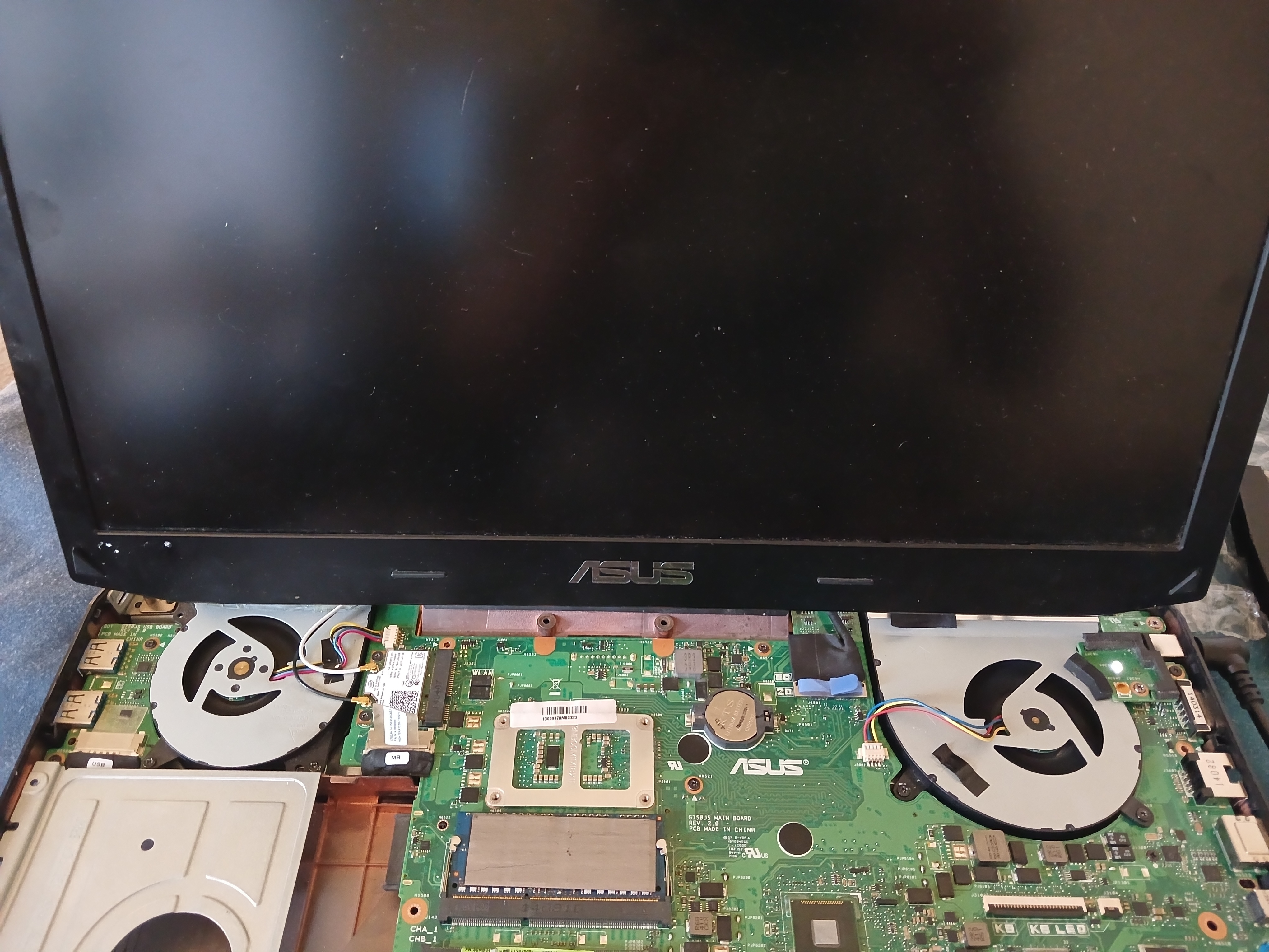

    hi all i was wondering if you could help me troubleshoot this laptop. i bought the motherboard off eBay. it is used. i fitted the motherboard into the housing of the gaming casing and turned it on. nothing shows up on the screen. i checked the connectors and no missing connectors. i also removed the graphics card and nothing on the screen. i even reflashed the bios but still nothing on the screen. can it be a corrupt bios? i even used the HDMI port but it also shows nothing on screen. could this be broken screen or a dead ec chip?

      What was the problem

        i opened up my screen and on the inside under tape was a torn screen cable. no way to repair unless i order a new screen. the cable is made that way.
