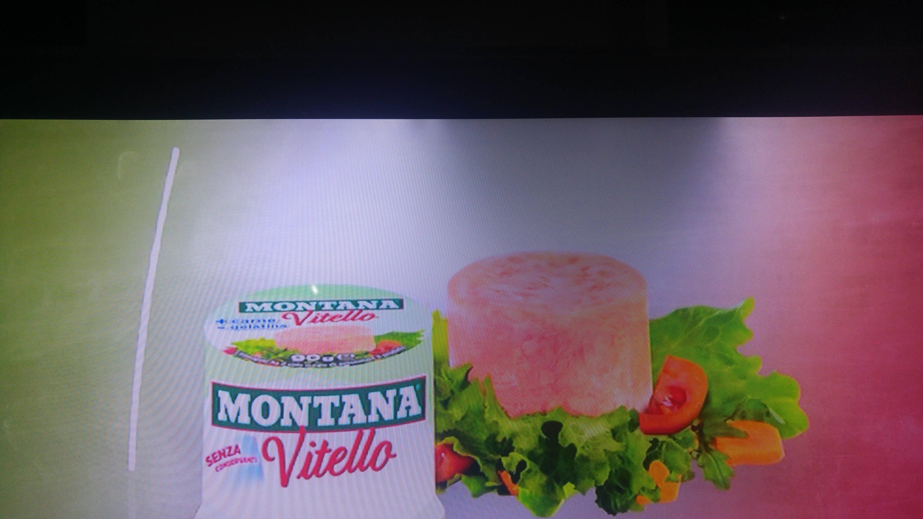

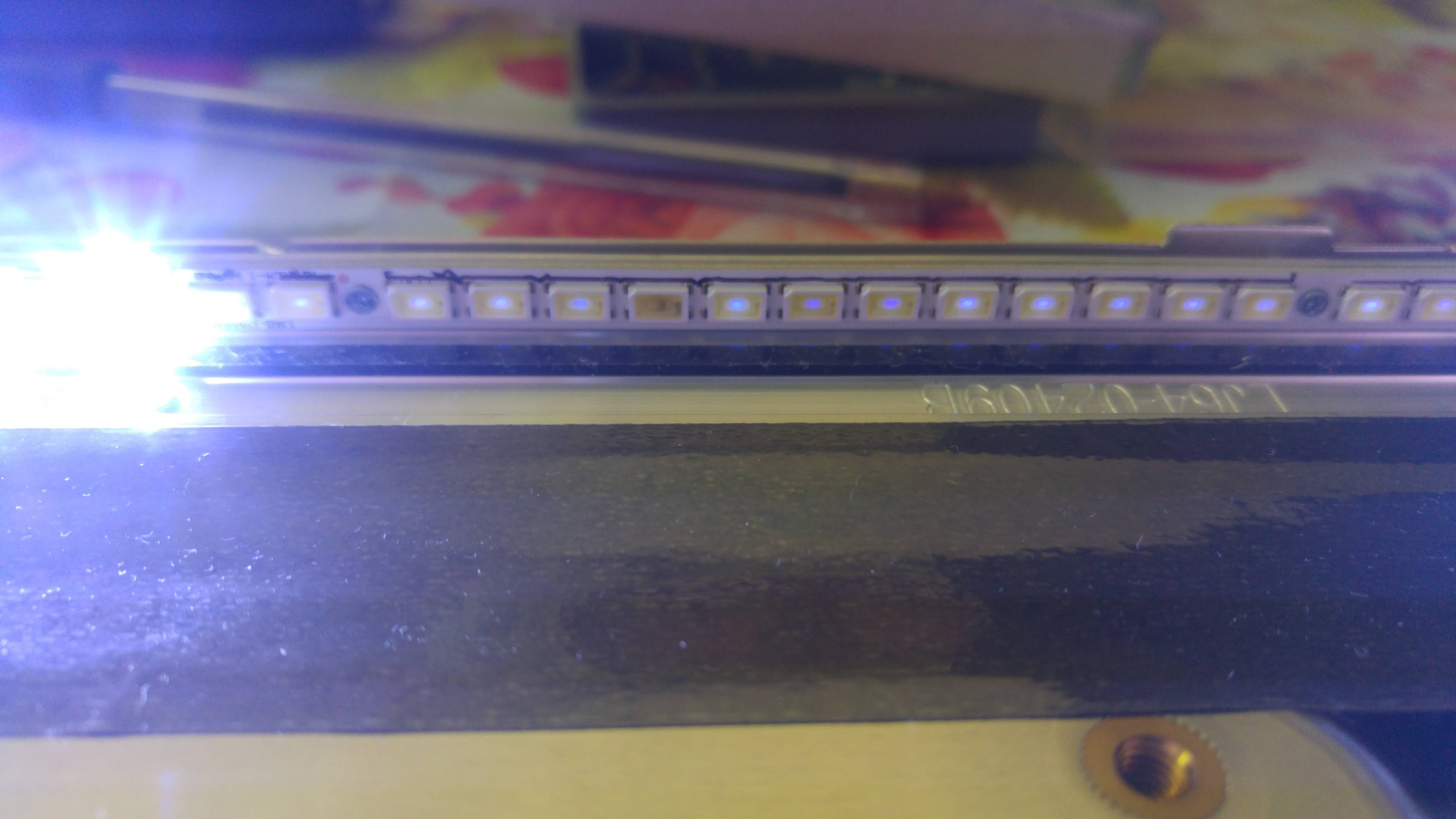

    I notice also a black spot on the top of the screen...looks like a burner LED backlight..

            From the photo's above you also appear to have at least one faulty led that needs to be replaced.

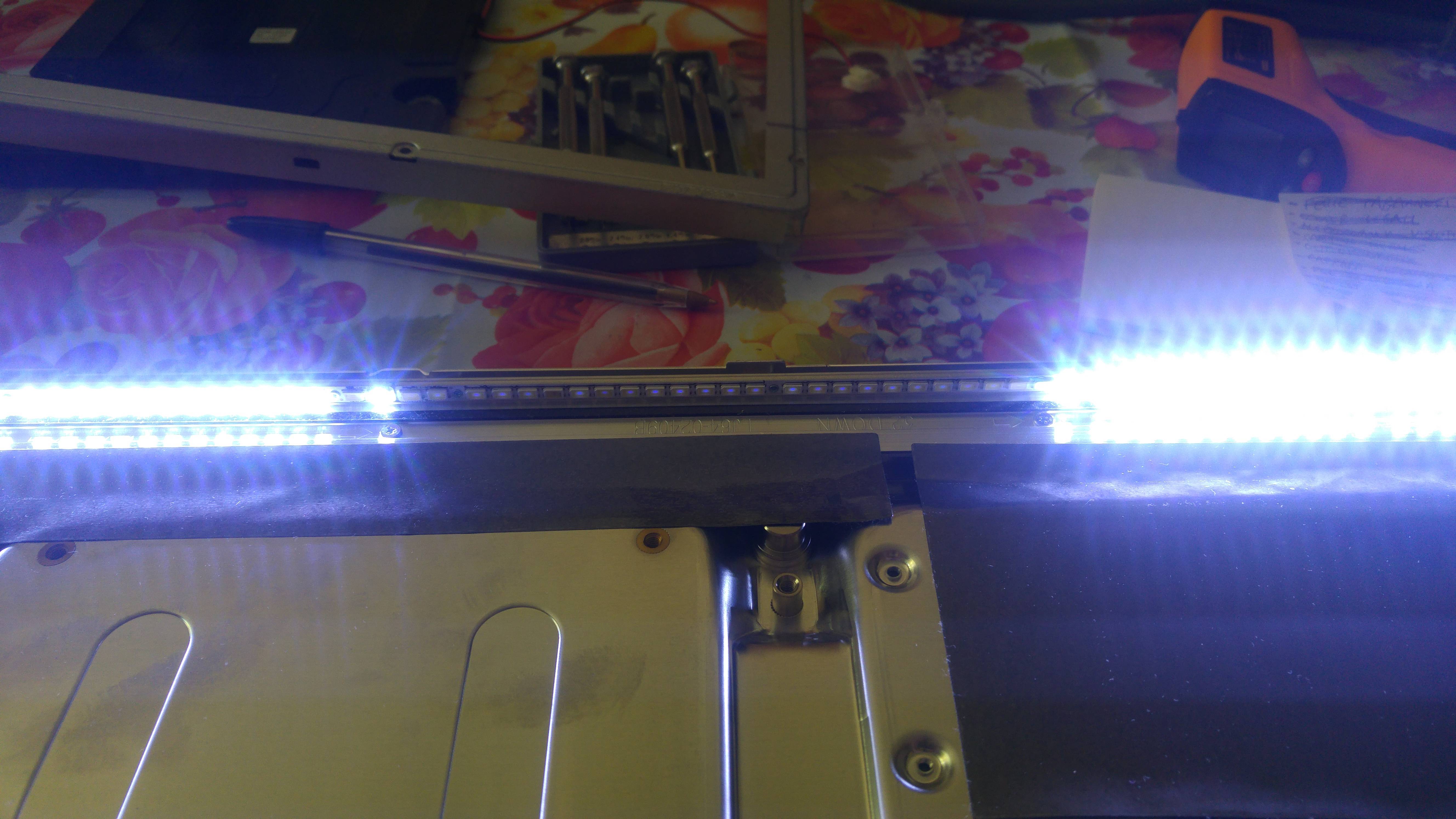

                        i'll try and let you know...i've disassembled the panel, and the TV got two stripes of LED named LMB-3200BM11. Can't find the replacement....i am able to desolder and resolder and smd led, but i need the exact model of that led

                                That is a burned LED!
                                Looks like a Osram Duris E5 LED....
                                https://www.led-tech.de/en/High-Powe...0_206_216.html
                                replace the faulty led.

                                  #56
                                  Re: Samsung 32" power supply BN44-0351B no backlight
                                  thanks looks like very similar...but which temperature? 2700k? 3000k? 5700k?
                                  and...how many? i suppose that they are connected in parallel, so it's not only one burned.

                                    #57
                                    They are connected in series. If 1 dies , the whole strip is off. ( Christmas lights ).
                                    So in this case it looks like you only need one. Not sure about the lumen , maybe someone else can answer that. Maybe it is in the service manual.....

                                      #58
                                      The best thing you can do is google the led strip name!

                                        #59
                                        Bright white which has a bluish tint. So I would say 5700K. Others will give yellowish tint
