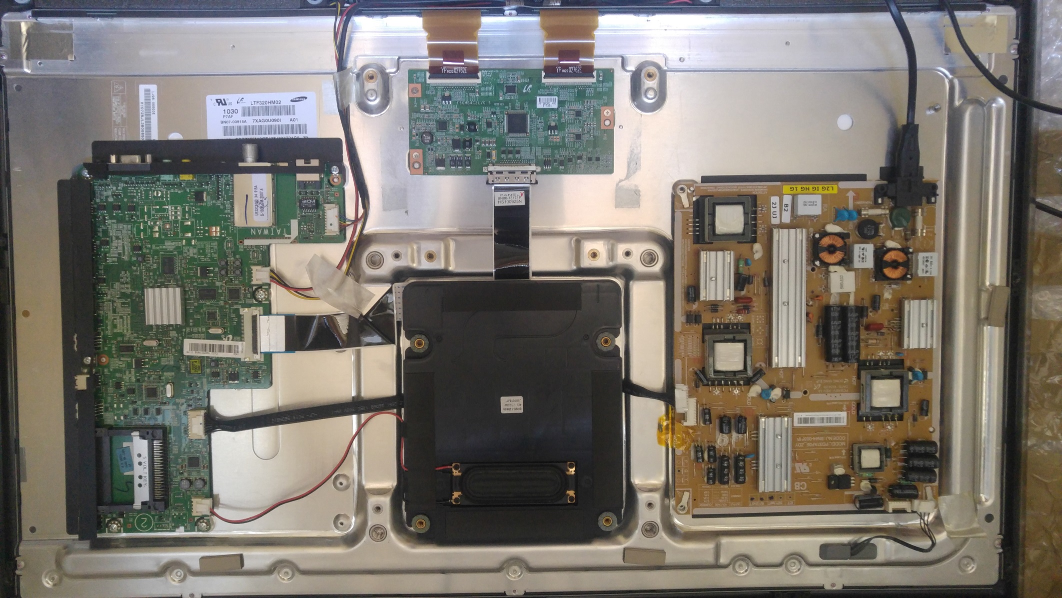

    Re: Samsung 32" power supply BN44-0351B no backlight
    pictures of the entire back of the tv and a pic of the ps, to start with.

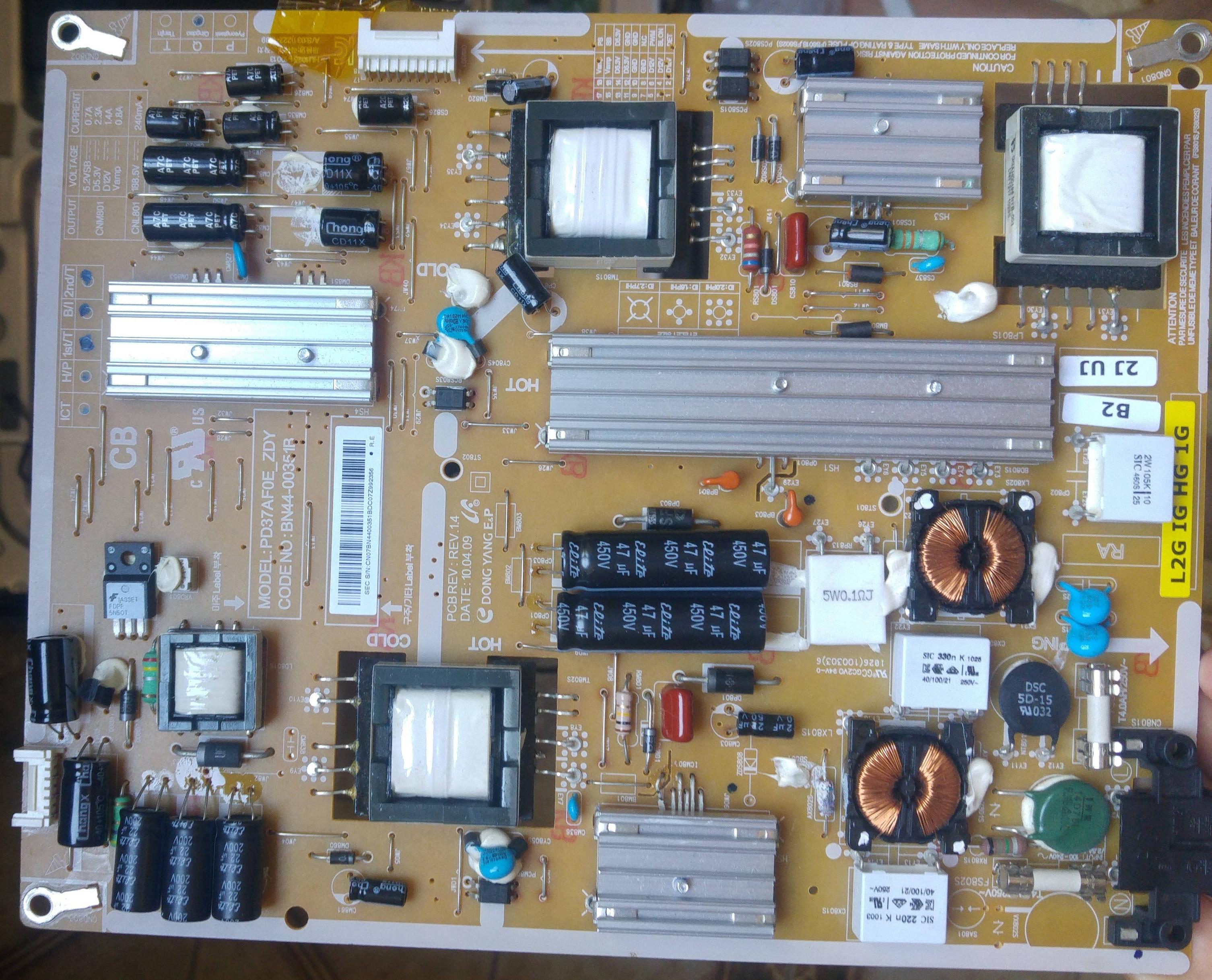

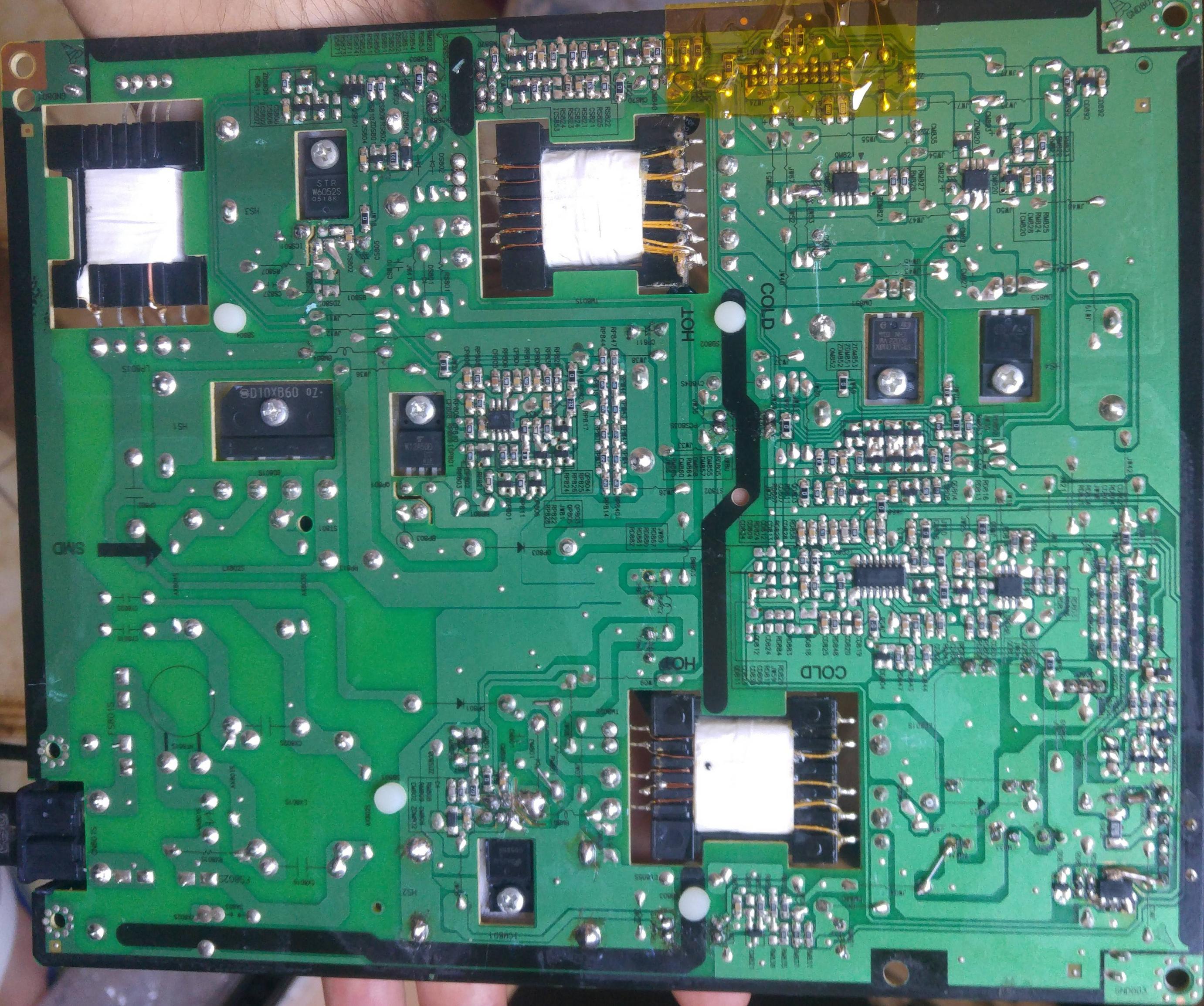

      ok here you are:
      http://imgur.com/fVgnZDS
      http://imgur.com/fOE2XLH
      http://imgur.com/aVTshVM
      Model of the PSU is BN44-0351B
        If you could add your pictures as attachments on the forum it makes it easier for people in the future to follow your repair.
        Does pin 4 BLU_On/Off go high when switched out of standby. If it does then what voltages do you have on pins 1 to 16 of ICD801

                          If VCC = 0V then the led driver circuit will not be working. What voltages do you have on pins 1,2 & 3 of QD801 as shown in the diagram.
                          Is one (or more) of those capacitors leaking since there appears to be some liquid or varnish around the legs?
                                liquid is flux...previous owner tried to replace caps.
