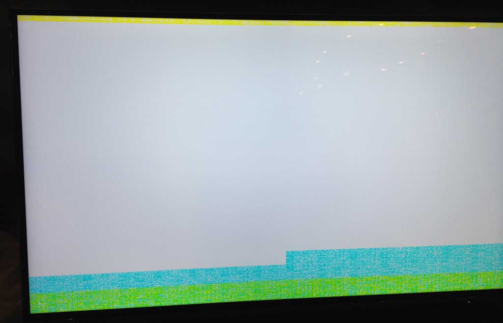

                      I wanted to update the thread here with another symptom that we have been coming across more and more often lately which is caused by a faulty main board.
                      When the TV is turned on with the one connect box, nothing is displayed on screen, not even the smart TV logo nor the smart apps logo shows up. However if you unplug your one connect box from the TV, and let is sit for about 30-45 seconds, your screen will turn on, and show a bright white image with a bit of green and blue near the bottom of the screen.
                      A picture is attached with this post

                        Hi Nick, thanks for this post. I have the exact problem. My tv is 4yrs old with about 50hrs. This problem surfaced this Sunday. I'm beyond ticked but sol. I can't believe Samsung is aware of this and is not willing to resolved. I've seen other blogs where the caps are replaced. It's possible replacing the caps than the m board to fix the problem? Thank you very much
