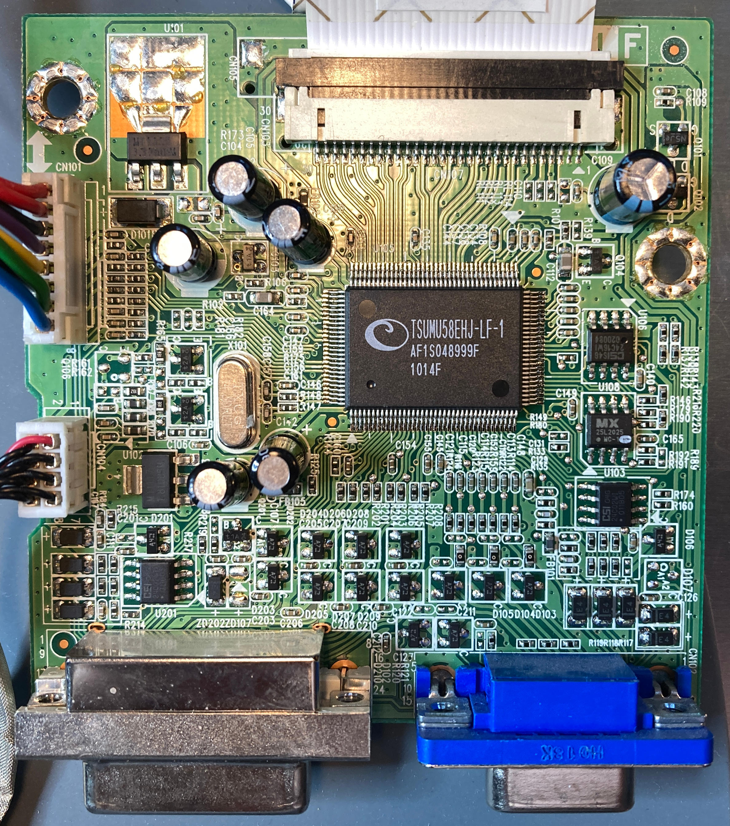

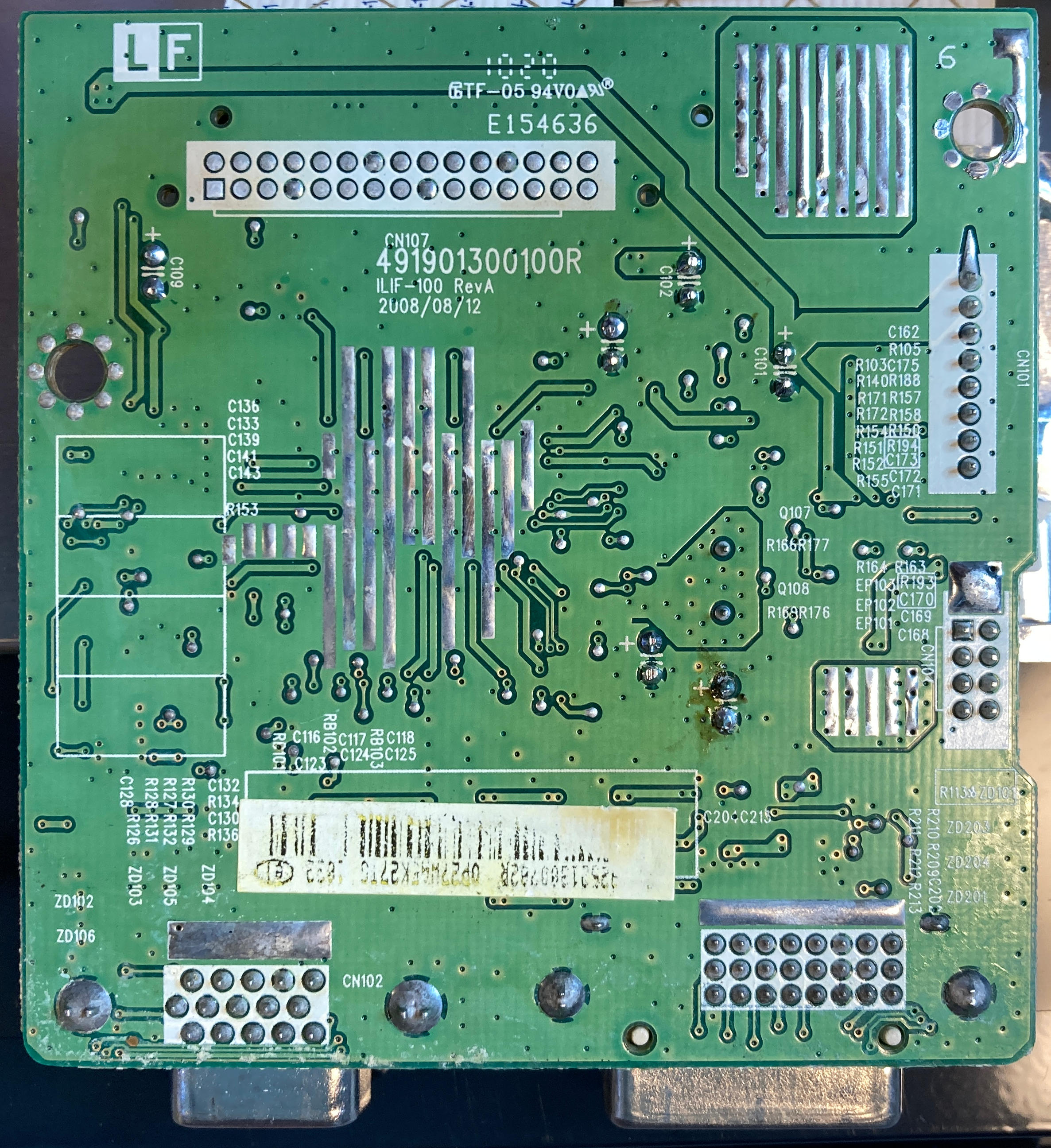

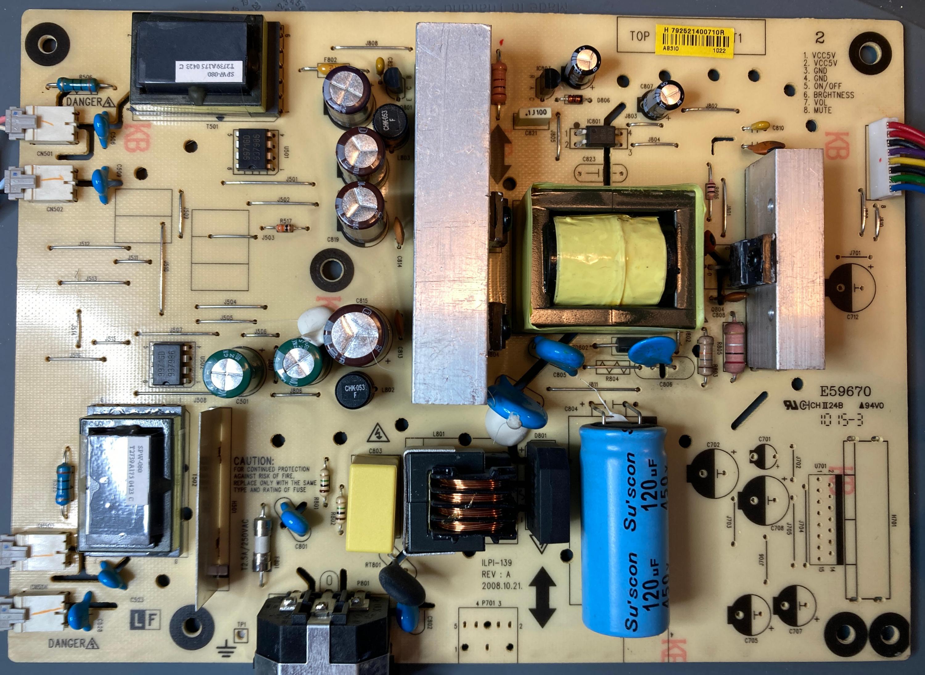

    Disassembling it, there are no visually bloated caps. On a whim, and because I had the right values I replaced the 2 smallest (in value) caps with Panasonic FR series (top right in the first image, just above the opto-isolator, C807, C827). This brought no change.
    I also replaced the large filter cap, 120u/450V, temporarily but that also didn't make a difference.
    Finally I repaced all the caps on the main board with Panasonic FRs, again no change in behaviour.
    Reading through the first thread mentioned above I started taking measurements at the 8-pin connector between PSU and Main PCB:
    With the monitor off (no power light):
    Pin 1: 5.09V (VCC5V)
    Pin 2: 5.09V (VCC5V)
    Pin 3: GND
    Pin 4: GND
    Pin 5: 124mV (ON/OFF)
    Pin 6: 3.18V (Brightness)
    Pin 7: 3.30V (Volume)
    Pin 8: 3.30V (Mute)
    However, when the monitor is manifesting the power cycling, all these voltages will drop toward 0V when the power light goes off (same as in the the first post mentioned above), never reaching 0V because the monitor turns into standby (amber power light) again rather quickly.
    When the monitor is on (blue power light):
    Pin 1: 5.07V (VCC5V)
    Pin 2: 5.07V (VCC5V)
    Pin 3: GND
    Pin 4: GND
    Pin 5: 3.21V (ON/OFF)
    Pin 6: 2.7V +/- 10mV fluctuating (Brightness)
    Pin 7: 3.3V (Volume)
    Pin 8: 3.3V (Mute)
    The outputs of the regulators on the main PCB are 3.33V and 1.84V.
    Now while I was taking these measurements repeatedly during the power cycling I pressed the power button to see if any of the voltages changed when pressing the button.
    What happened is, the monitor turned off (no power light) and stays off. The VCC5V voltage remains at a steady 5.09V, all the other voltages are steady as well (first set of measurements above).
    This is a notable difference because while it was power cycling, the VCC5V (as well as the other voltages) would drop towards 0V.
    Pressing the power button again, the monitor turns on (going through standby phase for a second a so), and stays on, no power cycling anymore. It's been rock solid ever since. I've had it disconnected from mains power for 36 hours even and this morning it still runs fine after plugging it back in again.
    I cannot reproduce the power cycling anymore.
    Now, I don't have a need for this monitor and was going to give it to someone who has a need but I would really like to understand what exactly happened when I interrupted the power cycling by pressing the power button, and of course if this "fix" is only temporary.
    If anyone can shed some light on what is happening here I'd love to hear from you. I'd also be happy to take more measurements as I'm really intrigued by this.

    Re: Acer X223HQ (Version Bbd) on/off-power-cycling
    Originally posted by usbdevice
    Hi all
    There's two other threads about this monitor with seemingly the same problem. The problem was resolved in one case by replacing the entire PSU board and in the second one by replacing an unknown IC.
    https://www.badcaps.net/forum/showthread.php?t=50657
    https://www.badcaps.net/forum/showthread.php?t=40512

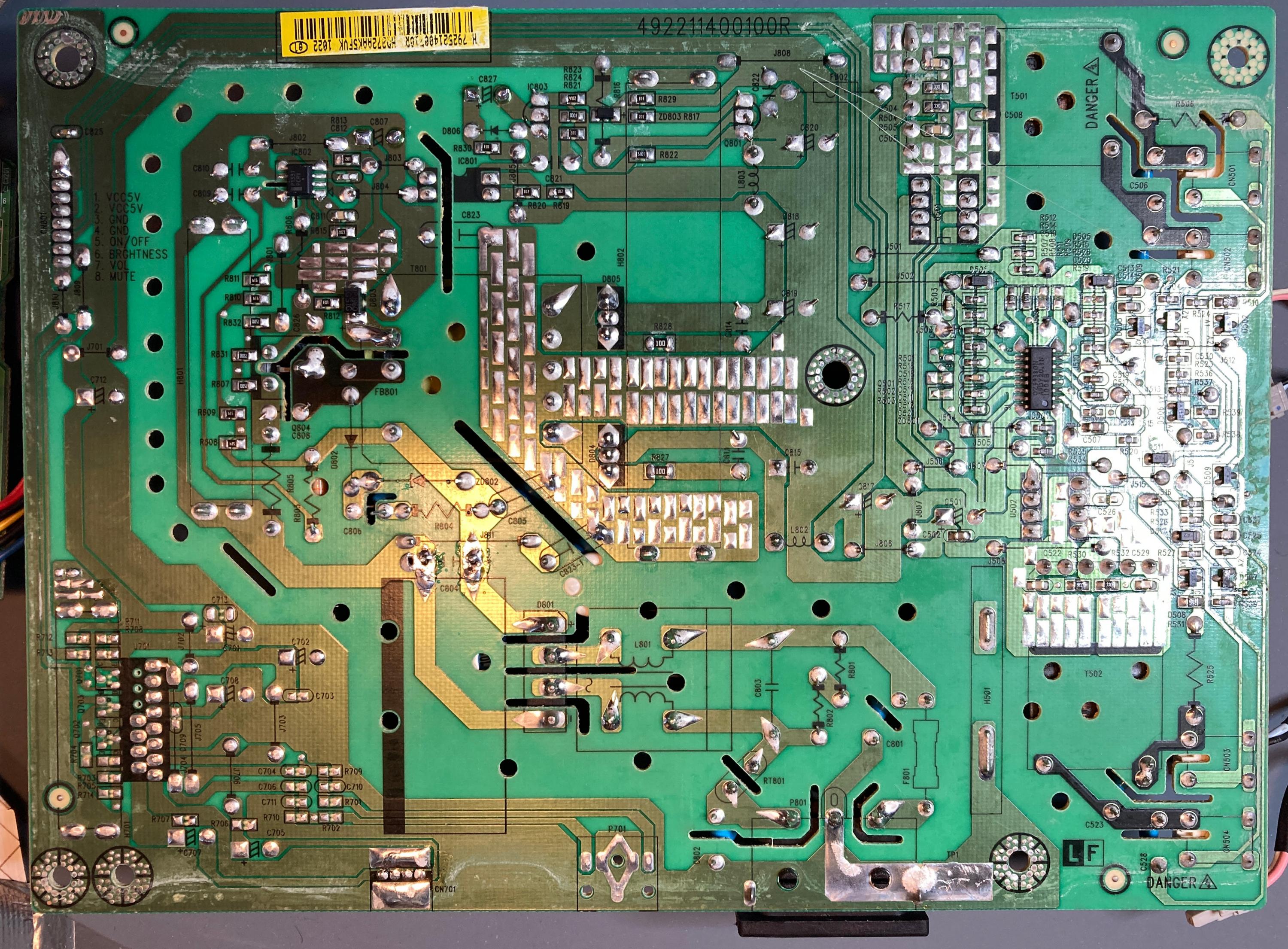

    The first one has pictures of the pcbs and I noticed that there's one IC and assorted caps not populated on mine (but the PCB itself looks identical) so I thought that'd warrant a new thread.
    The "unknown power IC" is the IC802 on the back of the PCB, an NCP1337 PWM Controller or the Power FET it is driving: Q804 an AP2761i N-Channel power MOSFET.
    Your missing components are for an optional speaker amplifier.
    <snip>
    I would say you most likely have a bad solder joint on the power board.
    Look very carefully at it with a magnifying glass under good light and you might be able to find it.
    I usually find it easier to take really high resolution photos and look on a computer monitor for the bad joints, but I guess that is just because I don't have a good enough magnifying glass
      Bad solder joint could very well be, although I'm having trouble thinking of a reason why the power cycling would stop after using the power button if a bad solder connection would be the only fault.
      Would you care to take a guess as to where I should start looking for (a) bad connection(s)?
      Thanks again
        The 8-pin connector between PSU and Main PCB and any large / heavy components like transformers big capacitors etc
