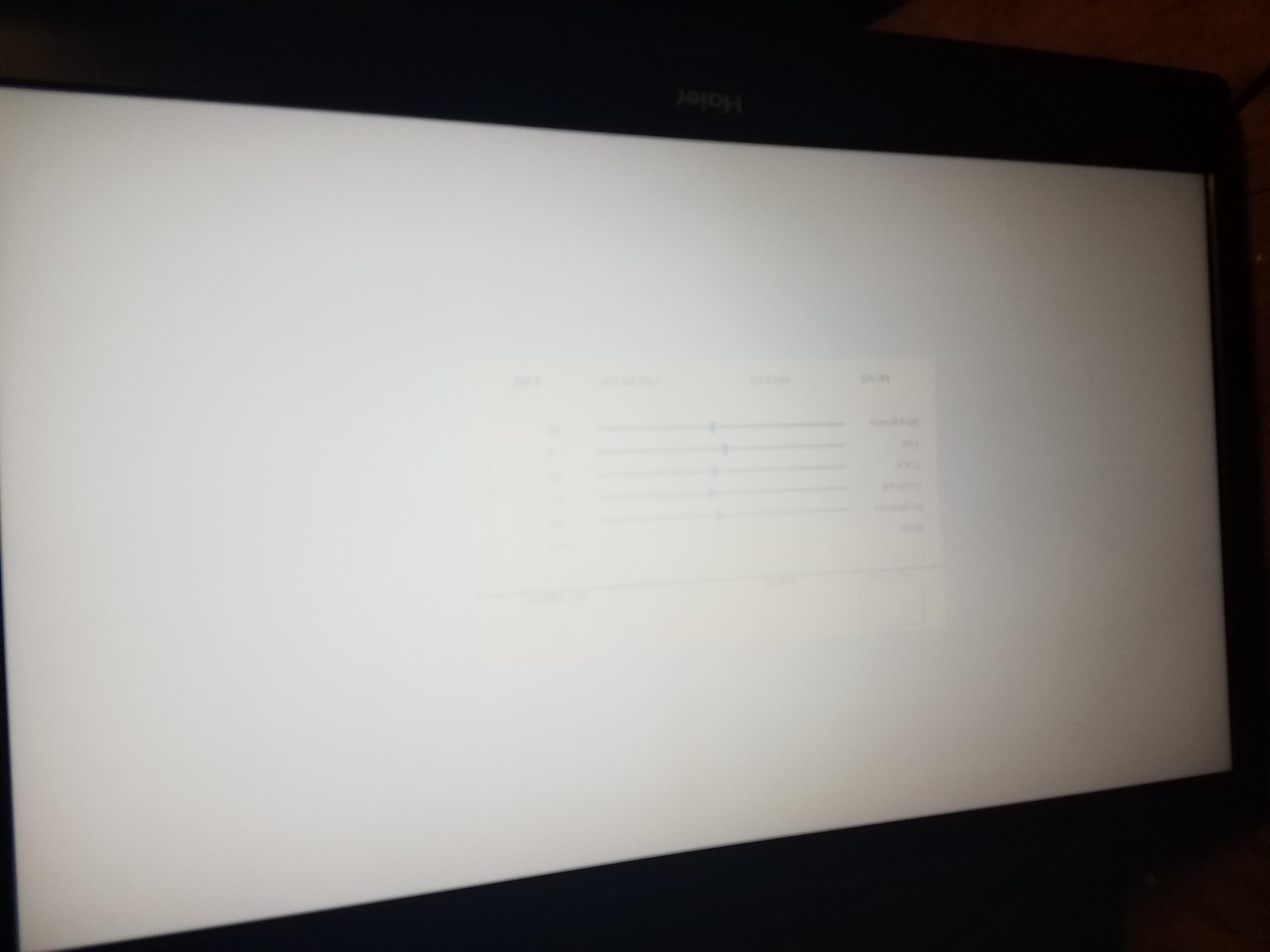

    Was just giving this tv. Haier hl40xp1 when it's on it is very bright. I can see what's on, Just really bright. I'm thinking it the t-con board. I fixed one years ago but I don't remember what the pin pads on the t-con board are suppose to be.
    Low to high I believe, but I'm getting 1.1v , 1.4v and 1.5v from just about all the pins. T-con board T400hw01 v4
    They need to gradually climb up in voltage right?
    But anyways does it sound like it's the t-con board anyways???m

    Maybe some pictures of screen

      list your vgma voltages.
      does sound like the as15 chip though.
      couple of pics would not go astray either.

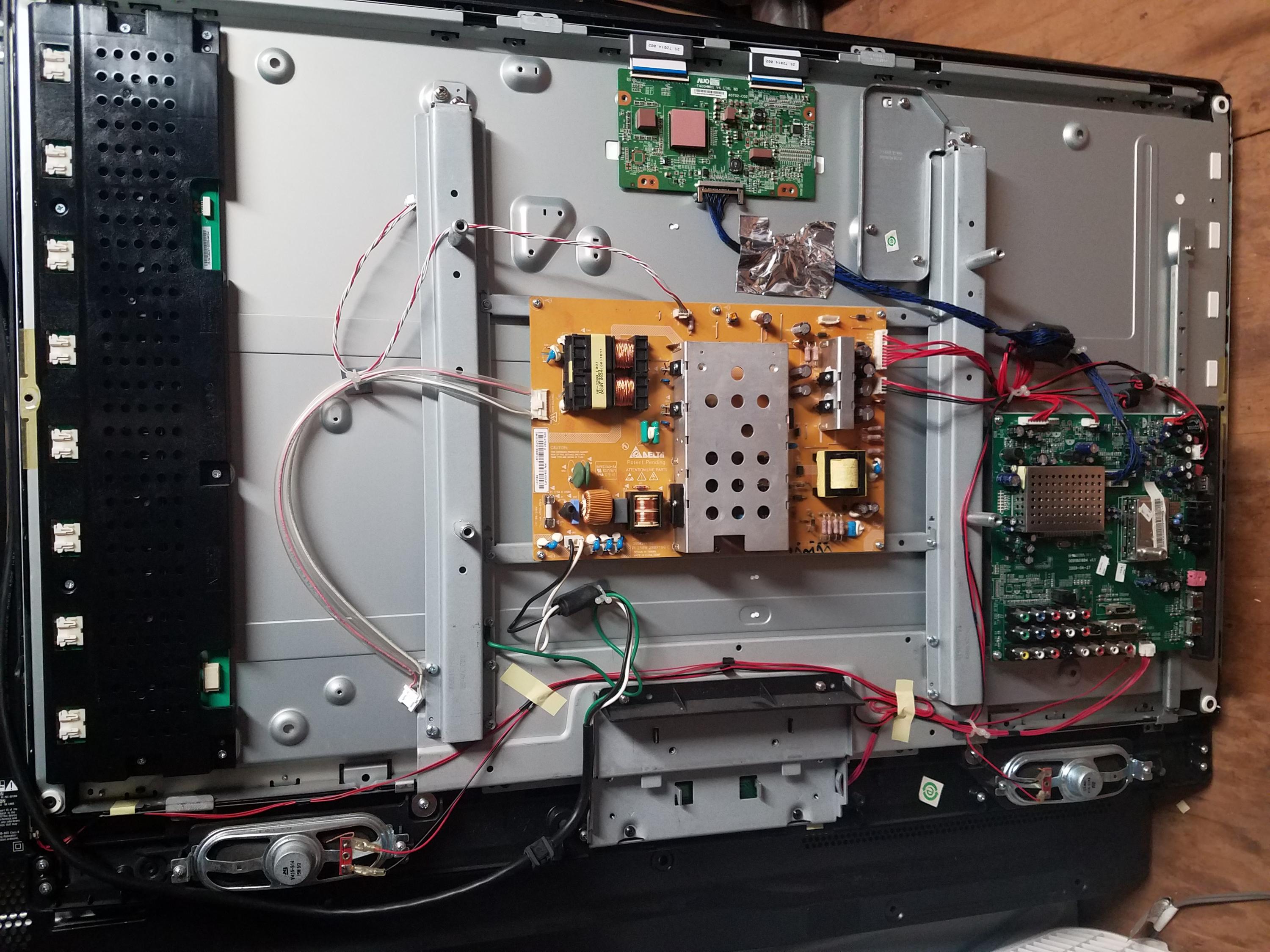

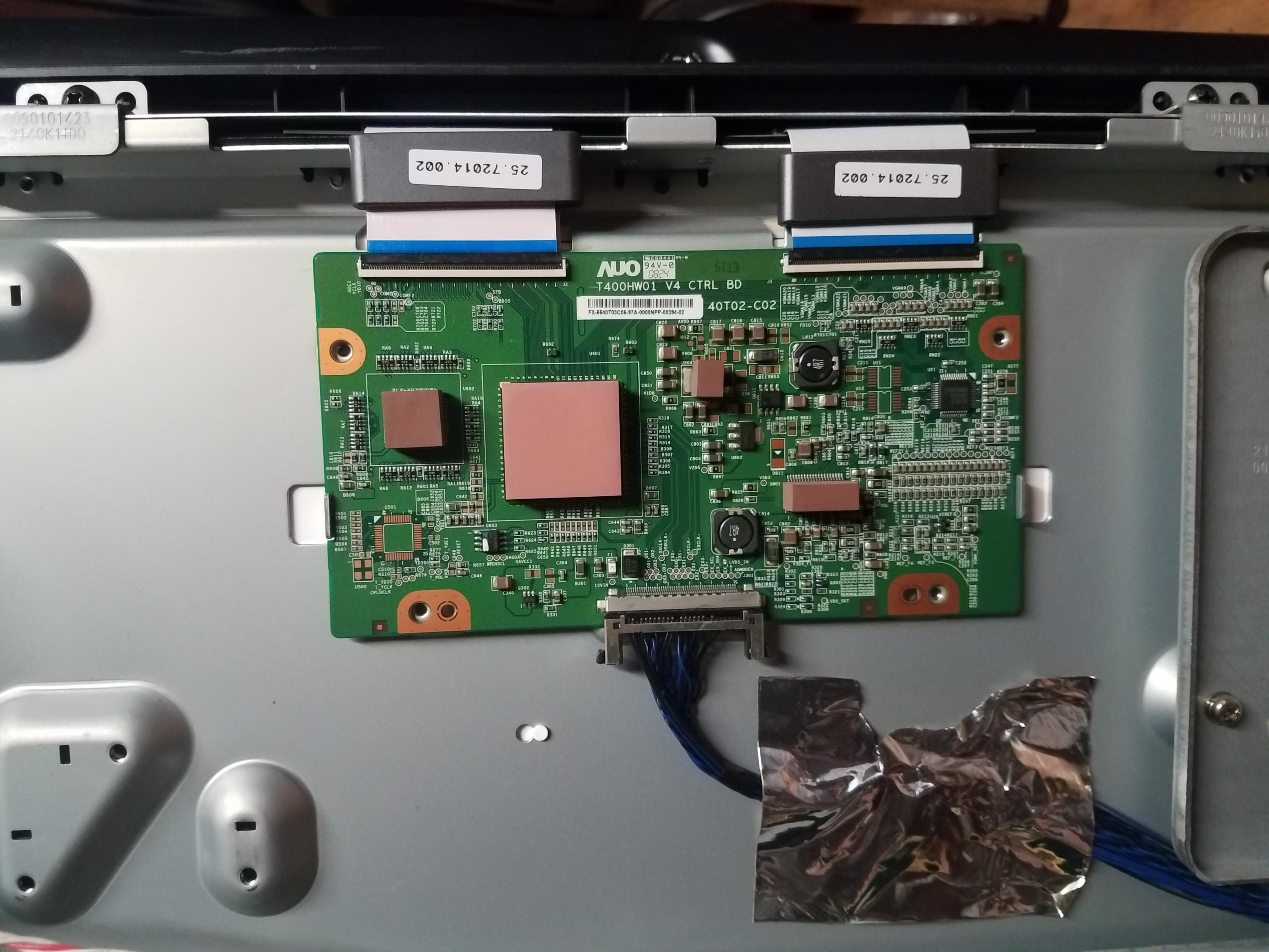

        Pics of front and back.

          You have like 22 VGMA points on t-con you can measure and post
