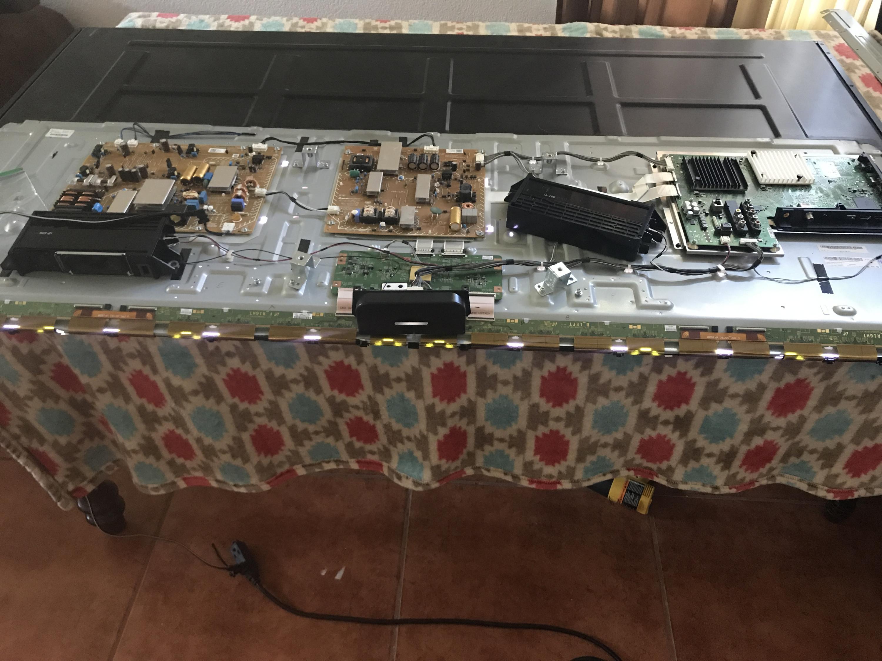

    Hi everyone,
    So what happened was that in the middle of watching a movie the screen went completely black. I turned the TV off, then back on but at that point all that happens you can hear a relay click on then back off every 15-20 seconds.
    I have tried replacing both the "G2" $ "G4" power supply boards as well as the motherboard and the T-CON board. The replacement boards did come from eBay, however the symptoms are exactly the same after changing them out.
    I thought the power supply may be getting a failure protection signal like over current and shutting itself back off so I started removing the output cables from the power supplies one by one. I discovered that when I removed the T-CON 12V connection that the power supply will stay on. At that point I thought for sure it was the T-CON that was bad but like I said after replacing it I have the same issue.
    I then removed one of the 4 flat cables from the T-CON to the LCD Panel and then plugged in the AC power. This allowed the power supply to stay on, the backlights come on and stay on and the Sony into sound plays through the speakers.
    Does this indicate that the Panel itself is pulling too much current and causing the power supply to trip off? Anything ideas are greatly appreciated.

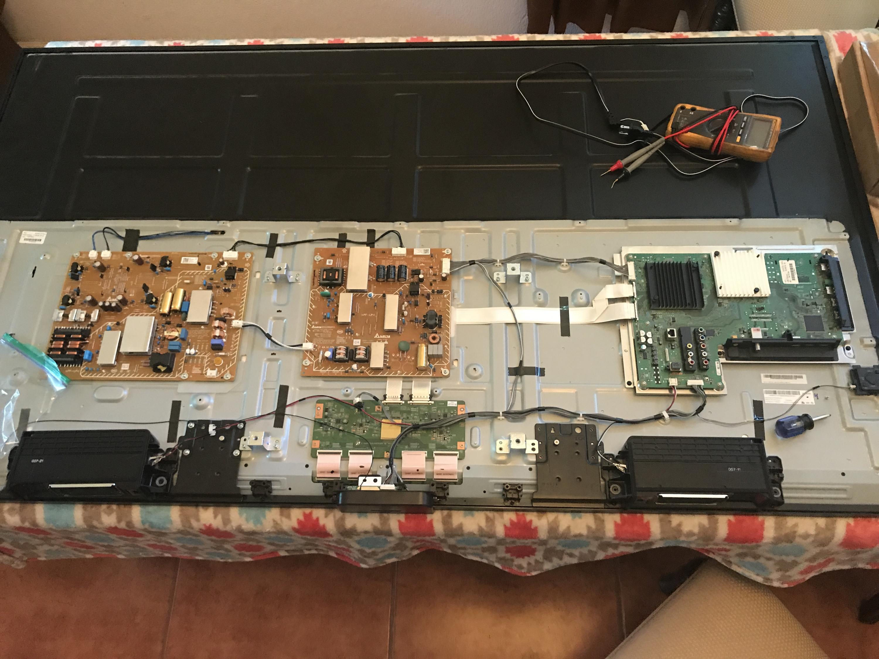

    Need good clear straight on pictures of back of tv with cover off and each board. And pictures around ribbon cables to the panel

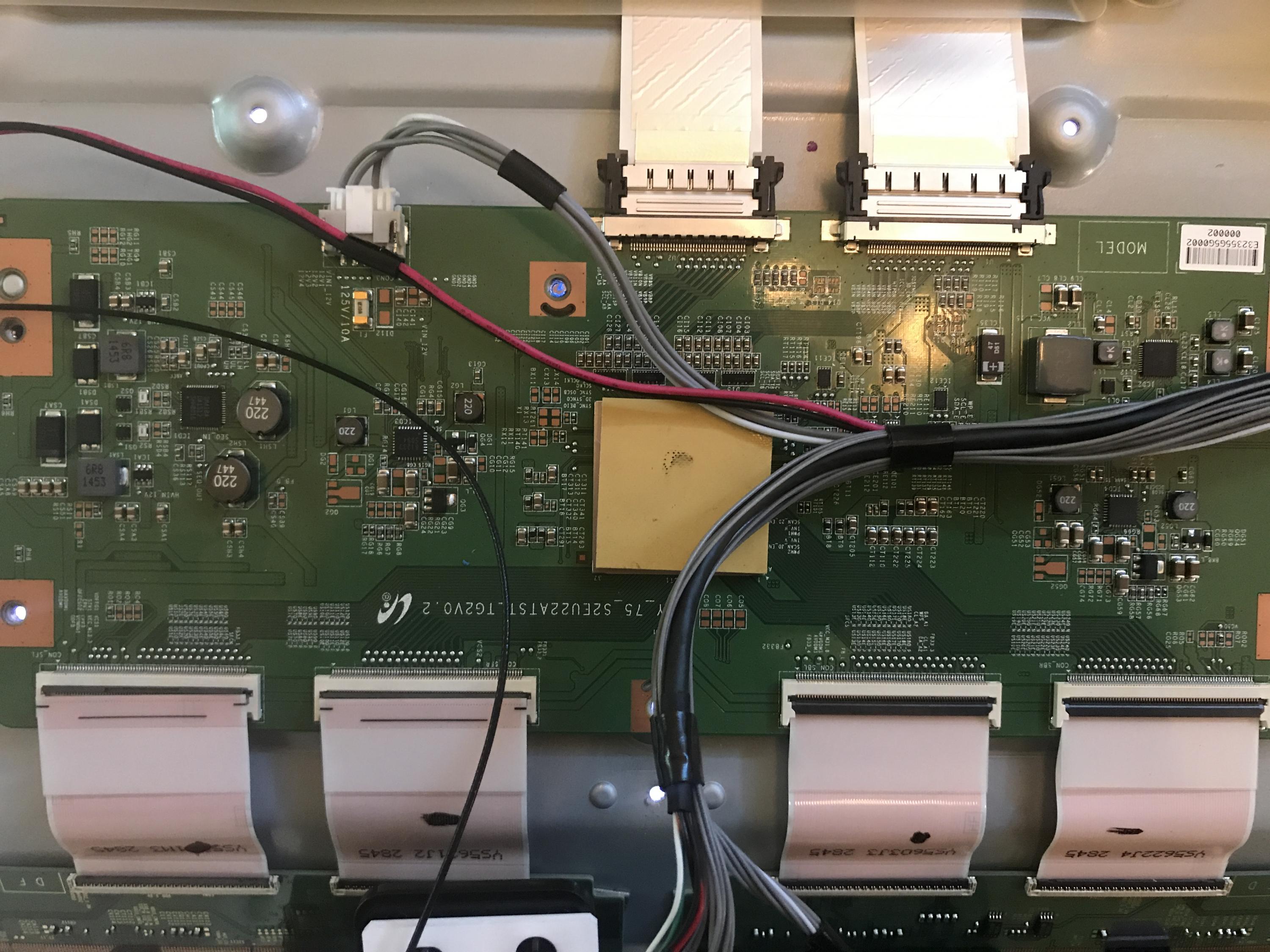

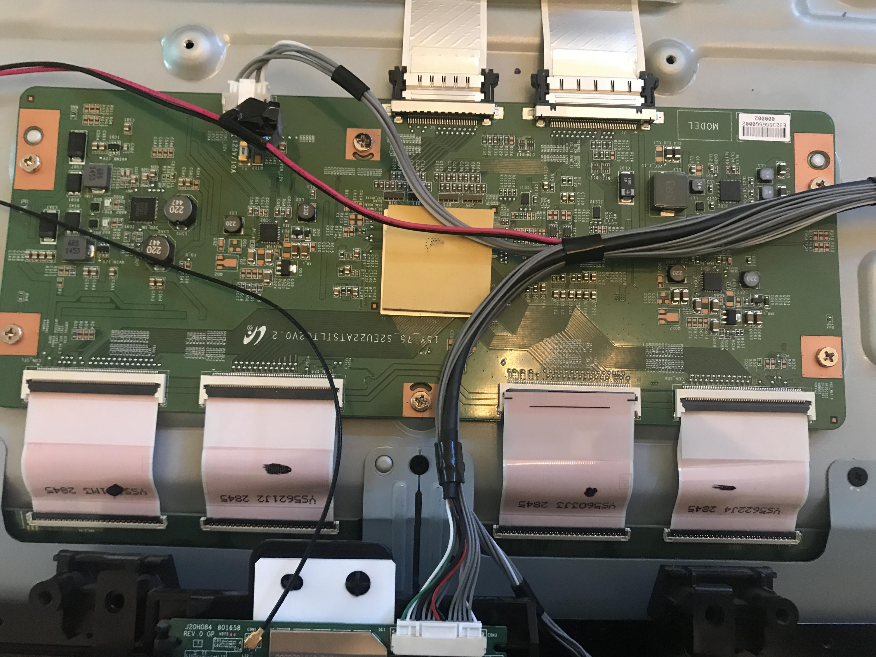

            Re: Sony XBR75X850C won't power on, no LEDs
            Ok here's some pics.
            On the T-CON photo the cables I was talking about disconnecting are on the left.
            Also there's a small cable that joins the panel boards together. If I disconnect the left or right cable junction and plug in the AC I get the same, backlight and sound, no display though.

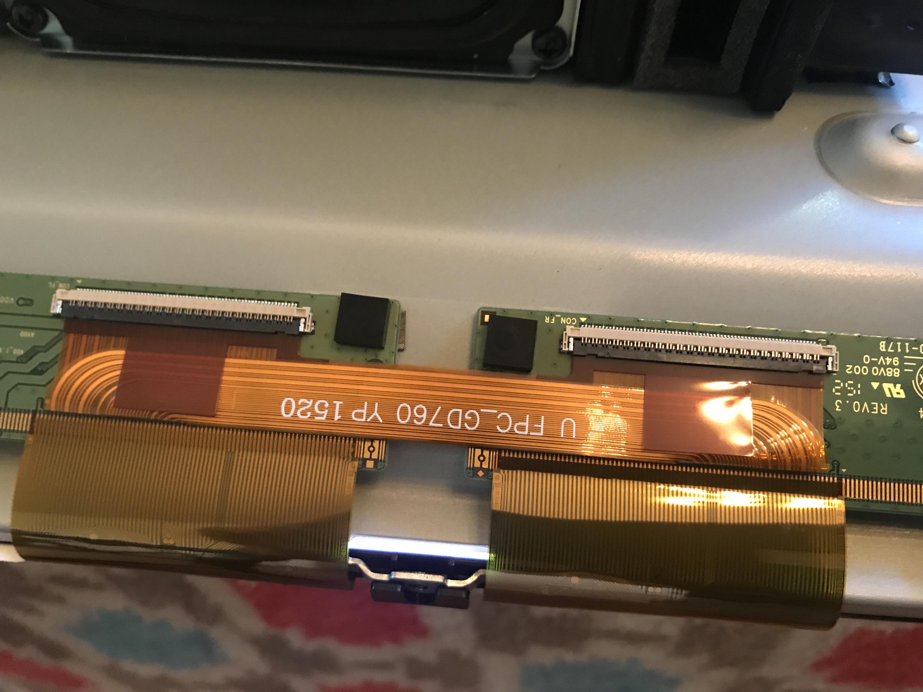

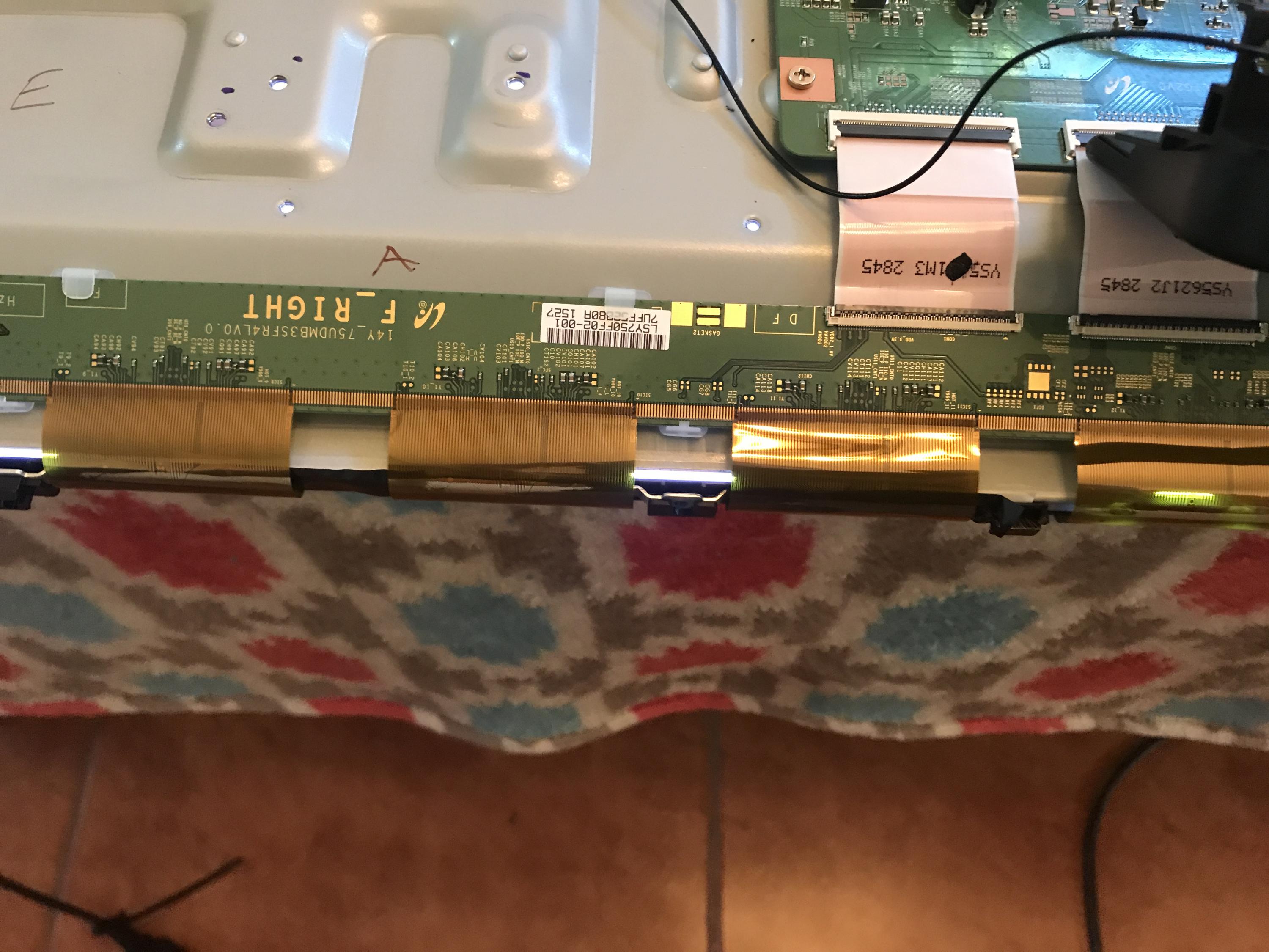

                  Ok, I disconnected the 2 left cables and after connecting the AC all the backlights lit for about 5 seconds then they all went out and after about 5 more seconds they all came back on. Then after about 30 seconds the intro music began to play. The results are the same if I disconnect the right side. I also tried it with all 4 cables disconnected and again the same result.
                  I tried connecting all 4 back and the original failure symptoms return.
                  Here's a couple more pics.
                  • CobrajetMach1
                    • Jul 2017
                    • 9
                    Reading a dead-short across C01 on the panel board labeled "B_Right"
                    The panel board labeled "Front_Left" looks like it's the same board, just has everything laid in the other direction. The reference designator is also C01 and I measure 1.85K and 2.25K acrossed it, depending on the meter lead direction.
                    Maybe tombstone C01 on the "B_Right"?

                        It shows <10 Ohms? Remove it and test it off the board also test the empty pads of the cap too after the cap is removed.

                            Ok I tombstoned that cap and measured again. It's in parallel with R06 which is a zero ohm resistor. This differs from the "F_Left" which has the zero ohm resistor installed in the component location right next to it and it is not in parallel with C01.
                            Anyways I removed R06 on the right side and with the short gone I plugged the TV back in and have the same original symptom.
                            Anyone have schematics?
