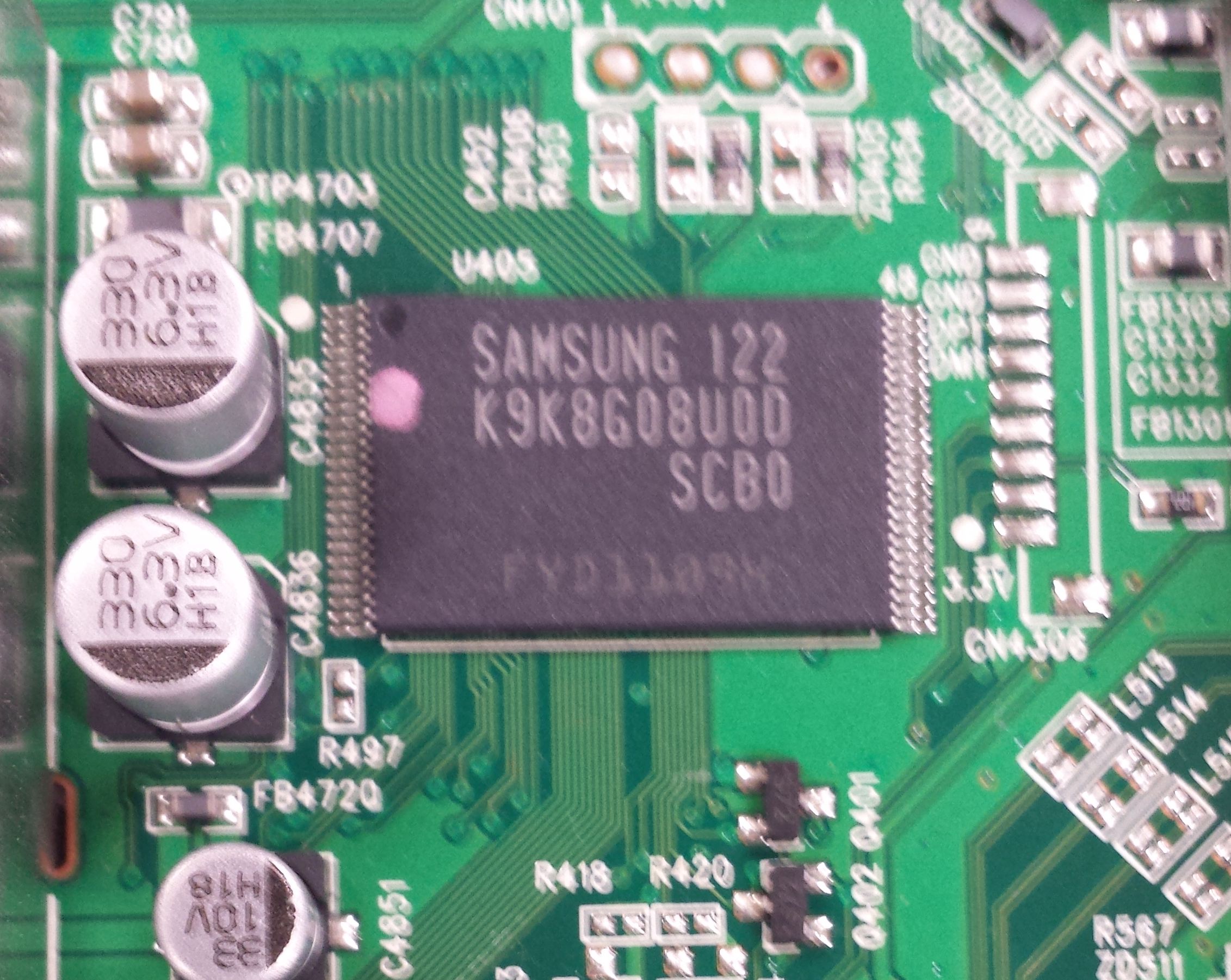

    TV perpetually power cycles with a backlit Vizio logo. Looks like it keeps failing a power-on-self-test. Been reading about a possibly bad EEPROM, but the one thing I have yet to try is to plug in the TV via WIRED Ethernet.
    Supposedly, the TV will download the most recent firmware and self-update.
    Has this worked based on your experiences?
    I can't find scorching, heat, or burning on the "offending" EEPROM on the video board.

        Sounds like the EEPROM is the common failure and link below seems to be the only seller. Service manual shows its actually a 256Mx8 NAND Flash. I wonder if wear leveling is the issue? I have a 2013 Tesla Model S and the entertainment unit has a NAND Flash that wears out as Tesla dumps linux log like crazy and kills it. A few aftermarket shops doing flash replacement (10x bigger capacity so a lot more durable) + data transfer.

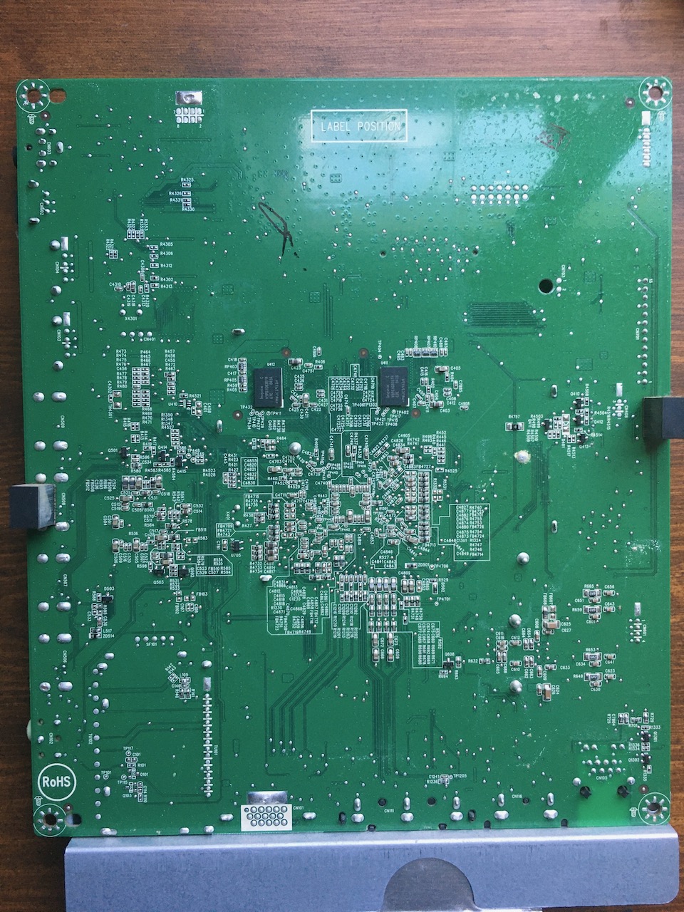

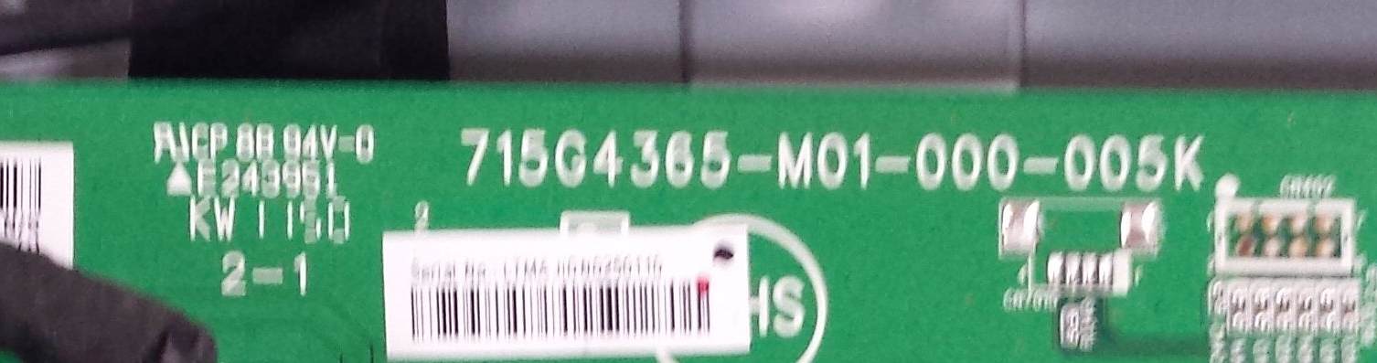

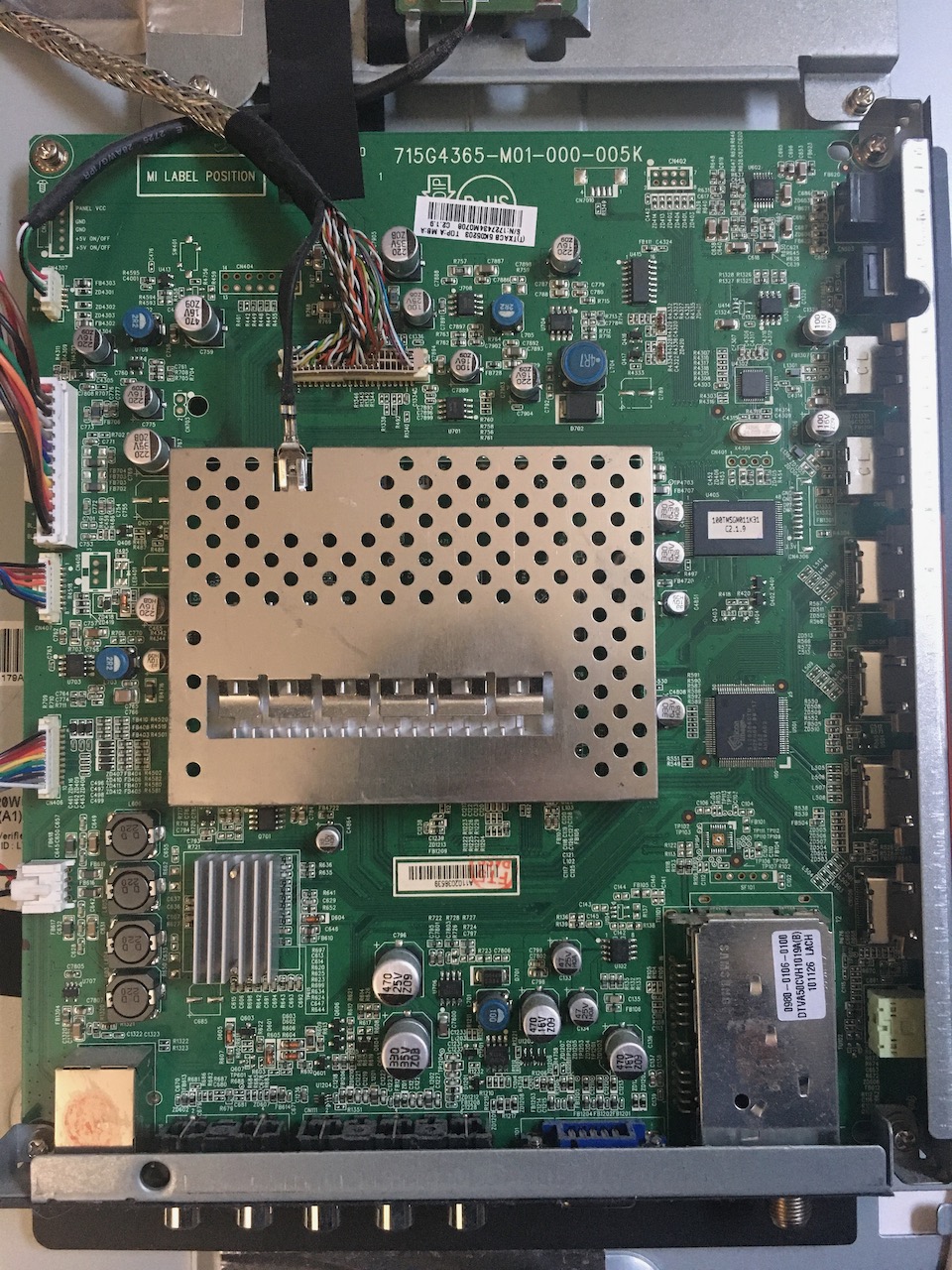

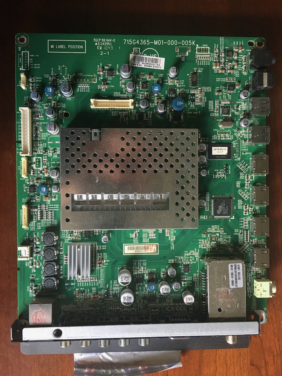

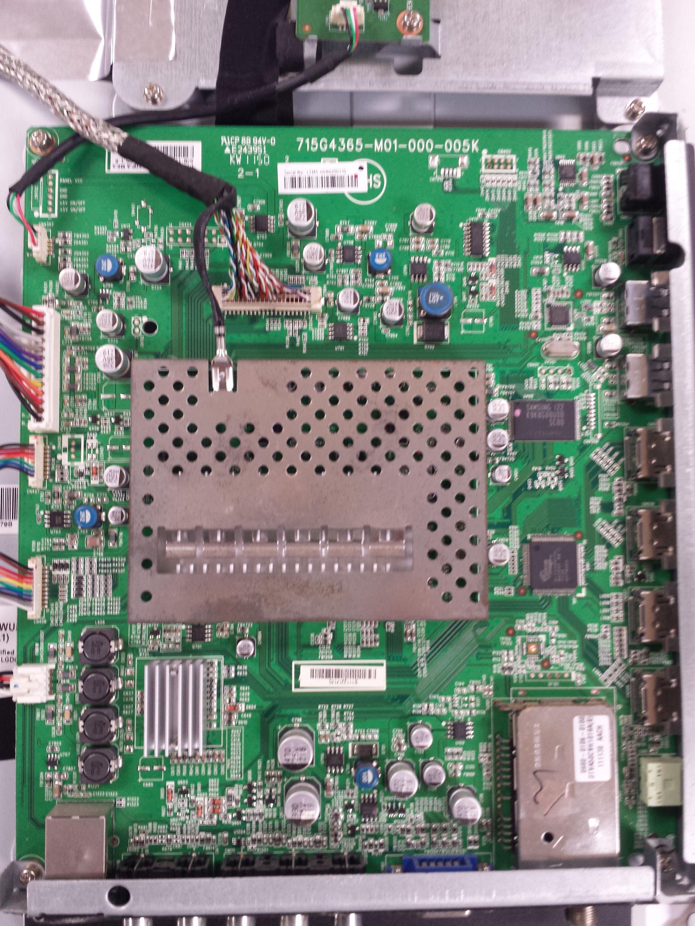

        Attaching my board pics for reference. Will take some voltage readings next.

              Yes, thanks. Know about this option. Provider has to have a flash image and a programmer to make these. I think likely my problem. Like to study the main board some more to make sure CPU is not an issue. I would guess IR power on, V logo + T-Con board working probably means CPU is fine. When powered on and stuck on Vizio logo, enet IP/Mac address shows up on my network. Sounds like CPU is probably good.

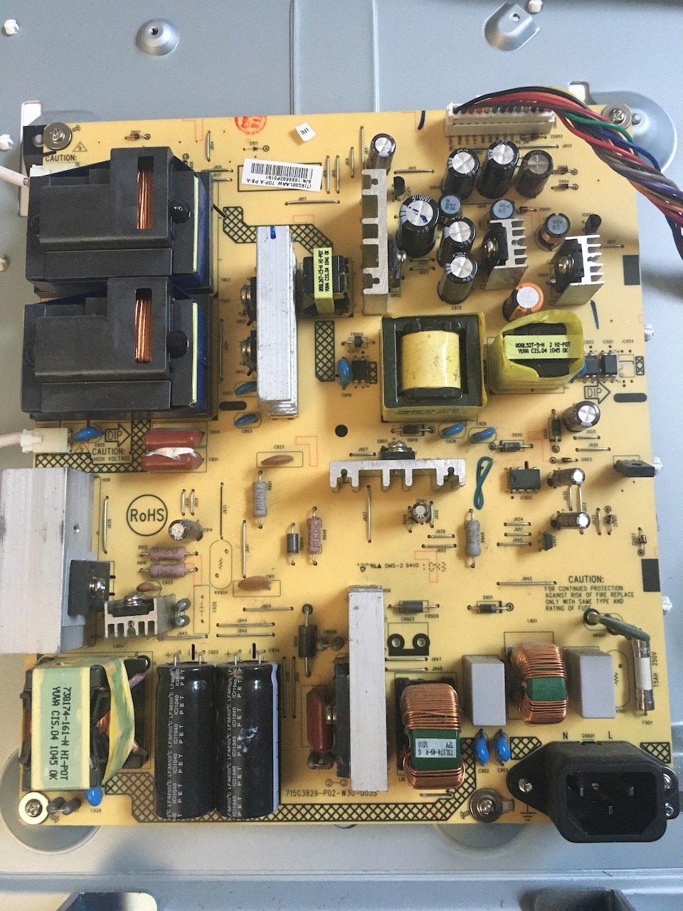

              Took readings on voltages. All the main board to PSU connection signal looks reasonable although I have no spec. 5, 12, 24V all there as well as 390V on the big PSU caps when BL on.
              EEPROM/Flash seems to be the likely failure.

                FIXED with reflow
                Fixed this with a simple reflow after diagnostic steps below
                - googled and read a whole bunch. Was able to ping the TV (enet connected) 10s after Vizio logo showed up. I reasoned the main CPU+RAM must be good based on this. Suspected the EEPROM (NAND Flash).
                - Reviewed the ebay EEPROM seller's feedback on this part. One buyer mentioned NAND works but wasn't his problem problem. Had to reflow the main SOC.
                - contacted the ebay seller with my symptoms, asked if he thought EEPROM will fix it. He said no but could be wrong of course. Hearing this, didn't want to gamble on EEPROM hearing from an expert.
                - From board repair services and ebay seller's youtube videos, found HDMI area also potential issue.
                - Took a heat gun and generally heated the backside and topside of the main SOC area (didn't remove EMI shield) and HDMI area. Didn't have a temp sensor so didn't dare to get it too hot. Didn't even see exposed solder joint get shiny.
                Anyhow, it works now. Will test it for awhile and do a proper reflow if any problem shall occur.
                BTW, my flash part was Hynix H27UAG8T2MTR BC which is a 16Gbit SLC flash. This is 4X bigger than many Samsung parts I see in most google photos of boards. My main board number shows its one of the later versions. 16Gbit SLC with wear leveling should be more durable than the Samsung 4Gbit parts. However, I don't know where wear leveling is done (in SOC HW or SOC SW) or if its even done at all.
