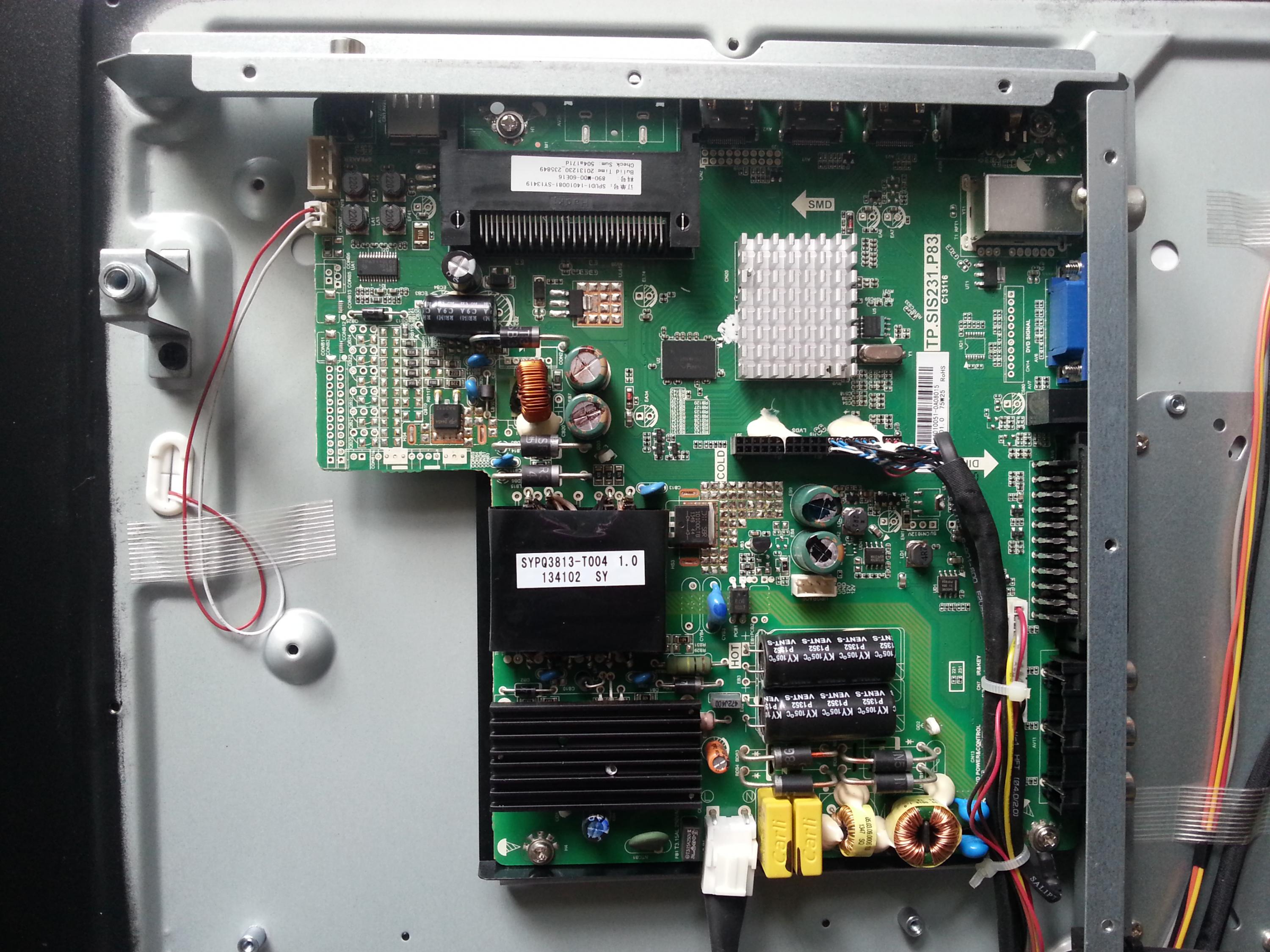

    This is a picture of the back. Not used to these new tv's. Seems like the psu and main board are combined??

      Looks like there is an eeprom for this board

        It's strange that it is only partially corrupted.. I've had it working twice (last night and this morning until I turned it off then it wouldn't work again). It's just stuck in this boot loop. Can't get a board or eeprom anywhere.. Not really sure what to do next

          Re: Seiki SE39HY03UK won't go past Seiki start up screen?
          Not good at troubleshooting integrated boards could be another problem. Did find eeprom: http://www.ebay.com/sch/i.html?_from...1.p83&_sacat=0
            try cooling or heating the eeprom ic that may prove its at fault then

              It's got the textbook issues with the bootloop, but I'm no expert. That eeprom is for the 32inch model for the same board.. (unless that doesn't matter). I spoke to a TV guy earlier who sells eeprom chips on ebay.. He said the board and screen number both have to match.. Can't vouch for that so bit apprehensive to order. Thanks for the reply
                Will give that a go Vince. Thanks... Now just to find out where the Mrs hairdryer is..
                  cooling is usually the better option maplin sell electronics freeze spary not cheap but is good or poundland air duster works (hold can upside down) dosnt get as cold as proper spray but does the job usually regarding heating the eeprom some people have luck and some dont but hey worth a try.
                      If it takes quite a while to come on then works, it may be a weak/bad capacitor, usually located on powerboard.
