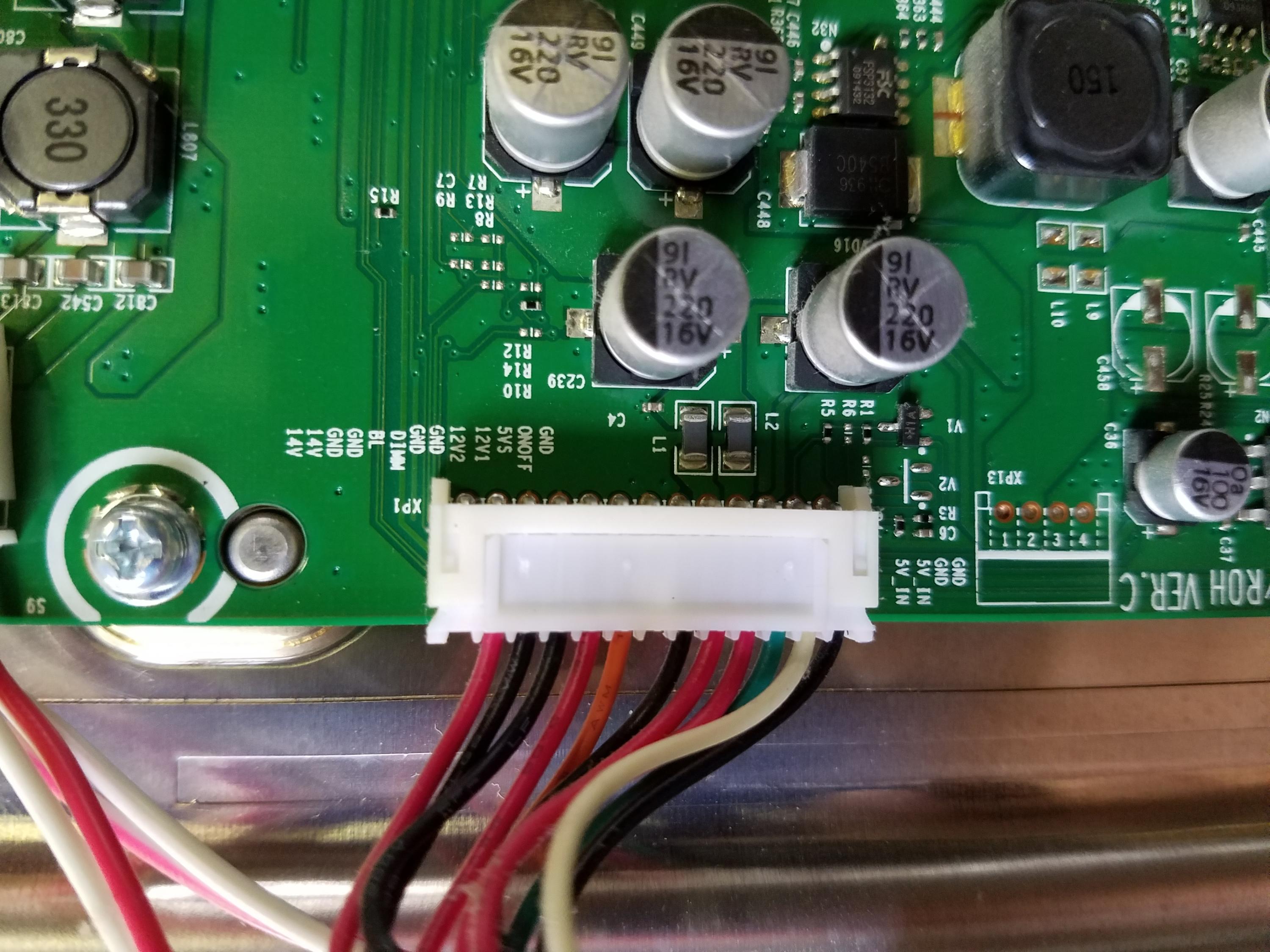

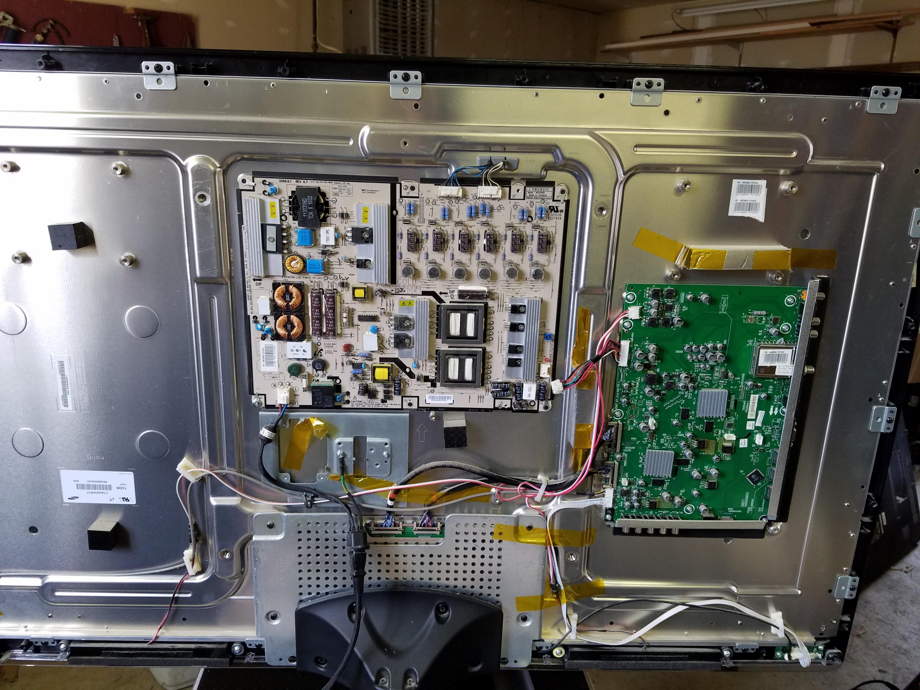

    NS-46E560A11 Will not turn on.
    I received it this way. Plug the tv in the red lights along the buttons light up (all of them) and the power display in center, all in red. The button lights will shut off after a couple seconds. If I press the power button the red buttons will light up again and shut off. The power indicator at center stays red. If I unhook the back lights or t-con nothing changes. If I disconnect the power supply form the input board it puts it into a back light test mode? (similar to Samsung). I have zero or almost zero voltage at all points except BL which is 4.108V off and 4.103V on, 5V 5.169V off and 5.162V on and OFF 50.8mV off and 50.7mV on.(when hooked up and testing between power cycles) If I disconnect the cable between the input and the power supply the reading on the cable are 14V 11.921V, BL 4.098V, 12V(both) 11.93V, 5V 5.175V, OFF .83V. everything else is zero. I can not find a flow chart. I believe this indicates a bad input board. Any thoughts?

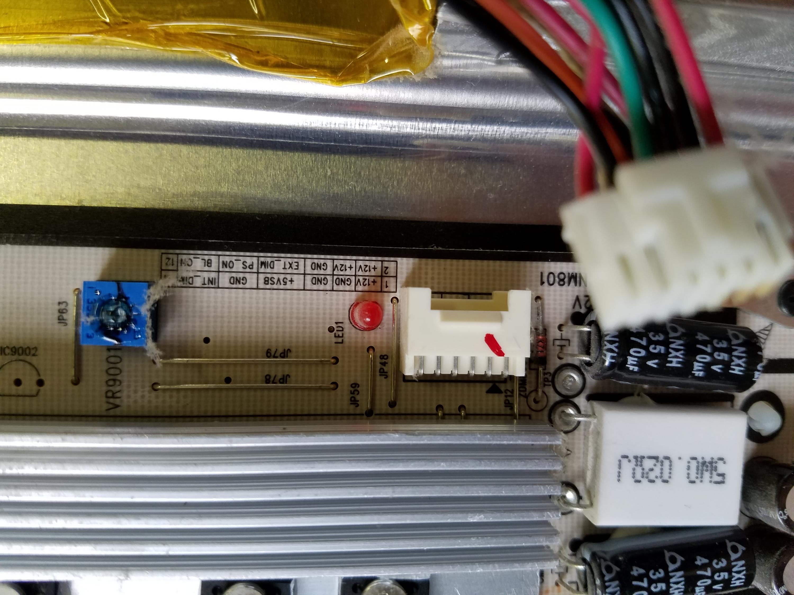

      Re: NS-46E560A11 Will not turn on.
      With the main board disconnected what are the voltages on the following power supply pins next to Led1
      Code:
      1 +12V =      2 +12V =
      3 GND =       4 +12V =
      5 GND =       6 GND =
      7 +5VSTB =     8 EXT_DIM =
      9 GND =      10 PS_ON =
      11 INT_DIM =    12 BL_ON =
      • johns1mj
        • May 2015
        • 242
        1 +12V = 11.92 2 +12V = 11.92
        3 GND = 0 4 +12V = 11.92
        5 GND = 0 6 GND = 0
        7 +5VSTB = 5.176 8 EXT_DIM =4.088
        9 GND = 0 10 PS_ON = .822
        11 INT_DIM = empty 12 BL_ON = 2.9
        • dick_barton
          • Aug 2015
          • 6643
          • Wales
          With the main board reconnected can you monitor PS_ON when you switch out of standby. Does the voltage rise and then fall?
          • johns1mj
            • May 2015
            • 242
            unplugged 0V
            plug in 1.275V
            "click noise" 50.8mV.
            Does not change after this.
            • dick_barton
              • Aug 2015
              • 6643
              • Wales
              I'm not 100% certain but since the supplies are all up and backlights on when the mainboard is disconnected then I'm suspecting a main board fault but would be worth waiting to see what others think could be the problem.
                Seems an odd ps_on voltage and all voltages in standby?
                • dick_barton
                  • Aug 2015
                  • 6643
                  • Wales
                  That's what's confusing me. I believe it is ON when PS_ON is taken low by the main board.
                  But with the main board connected and in standby, PS_ON at 1.27V looks awful low to start off with but does go 50mV when switched out of standby.
                  The power supply itself tested OK when PS_ON was at 0.8V
                    So does adding voltage shut it off? Because at .822v everything is on
                    • dskall
                      • Oct 2016
                      • 2905
                      • usa
                      Still pretty new so have not seen a ps_on voltage in between. Either around 3v or close to 0.
                      • johns1mj
                        • May 2015
                        • 242
                        First test was connected which gave the same voltages listed above. The second test with the main board disconnected that turned on the back lights was a similar method used on Samsung TV's for testing the power supply.
                          It is may one of those similar to Samsung board that only needs about 1V for PS-ON, and 0V for OFF.
