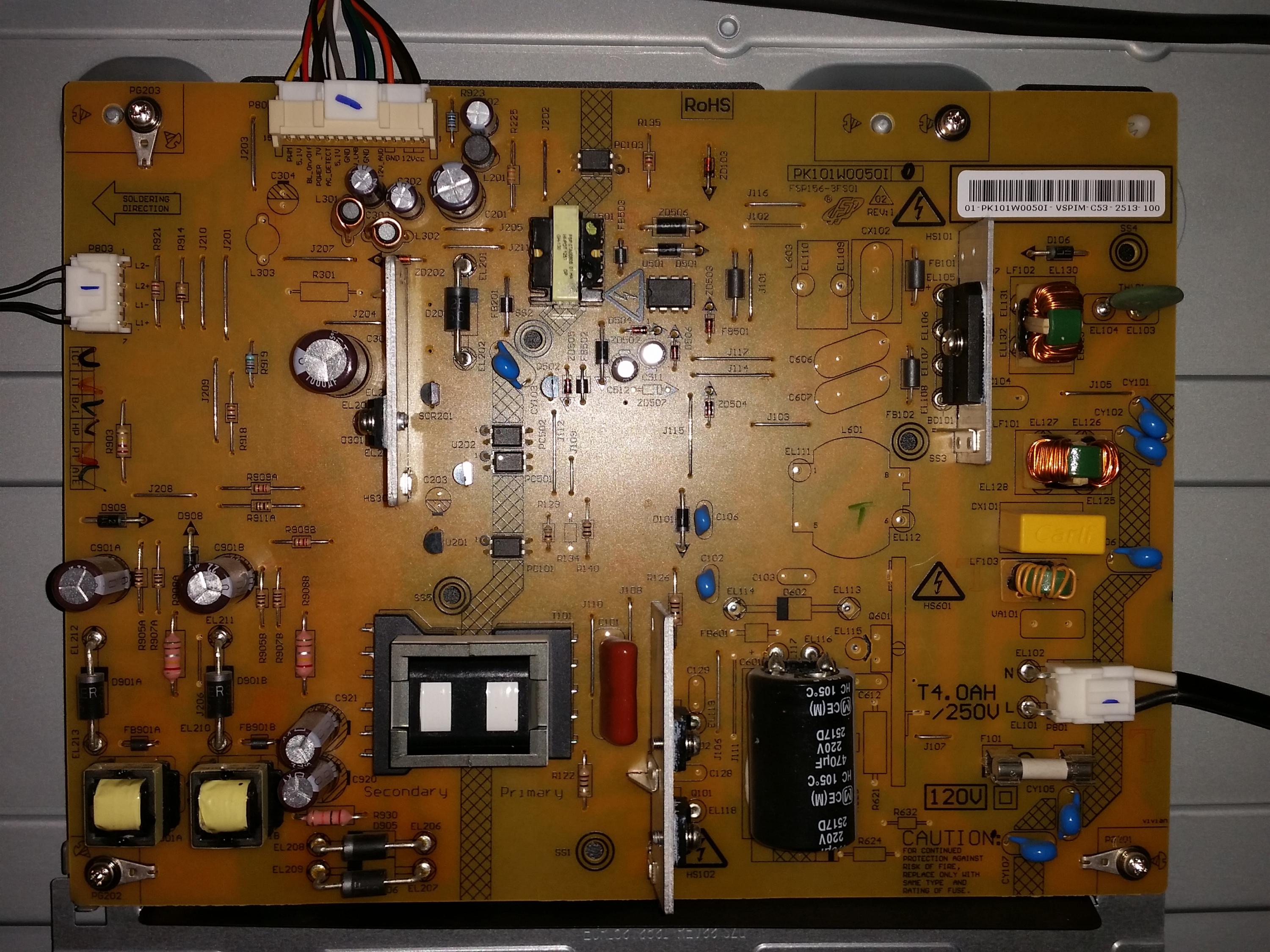

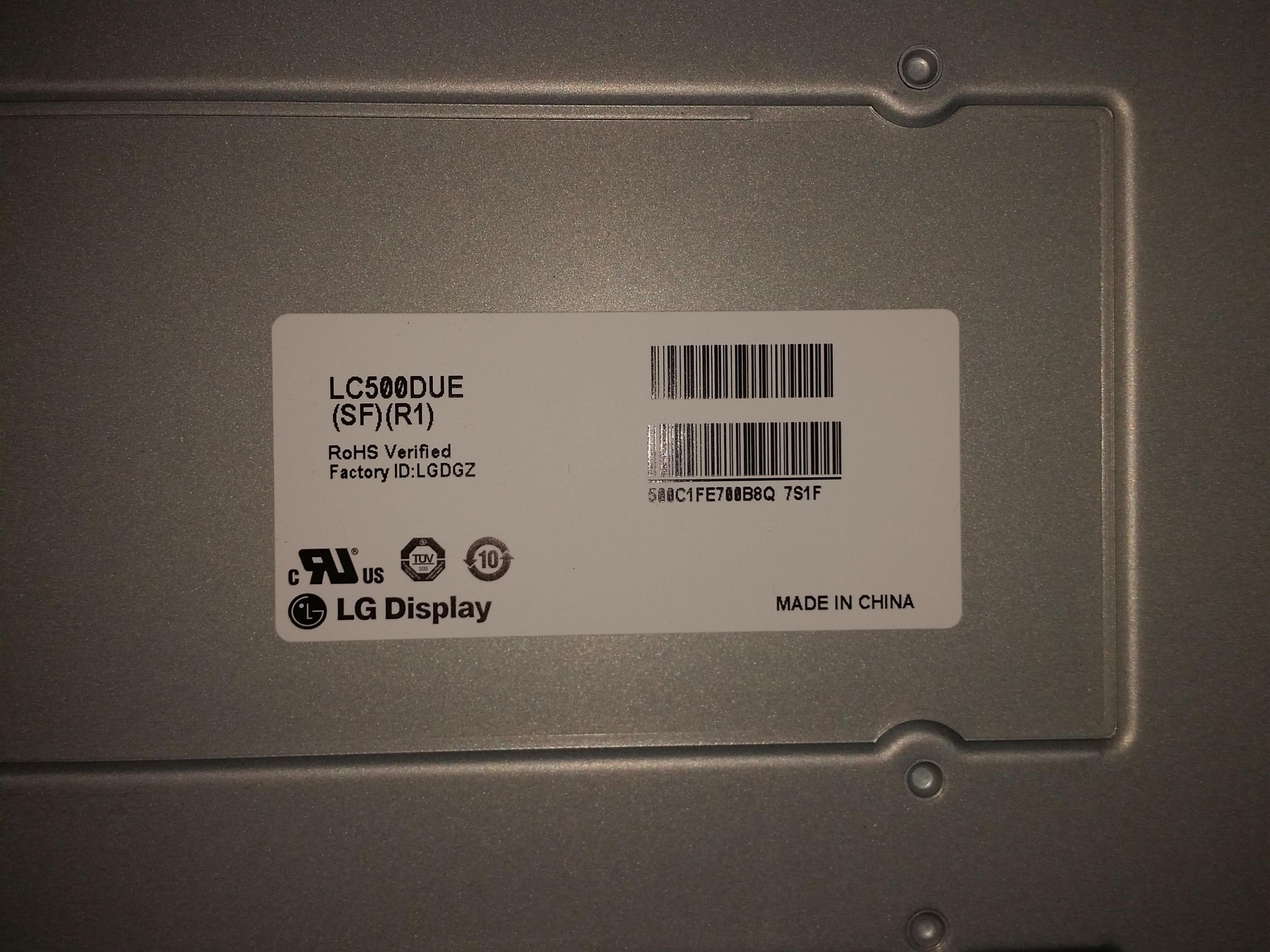

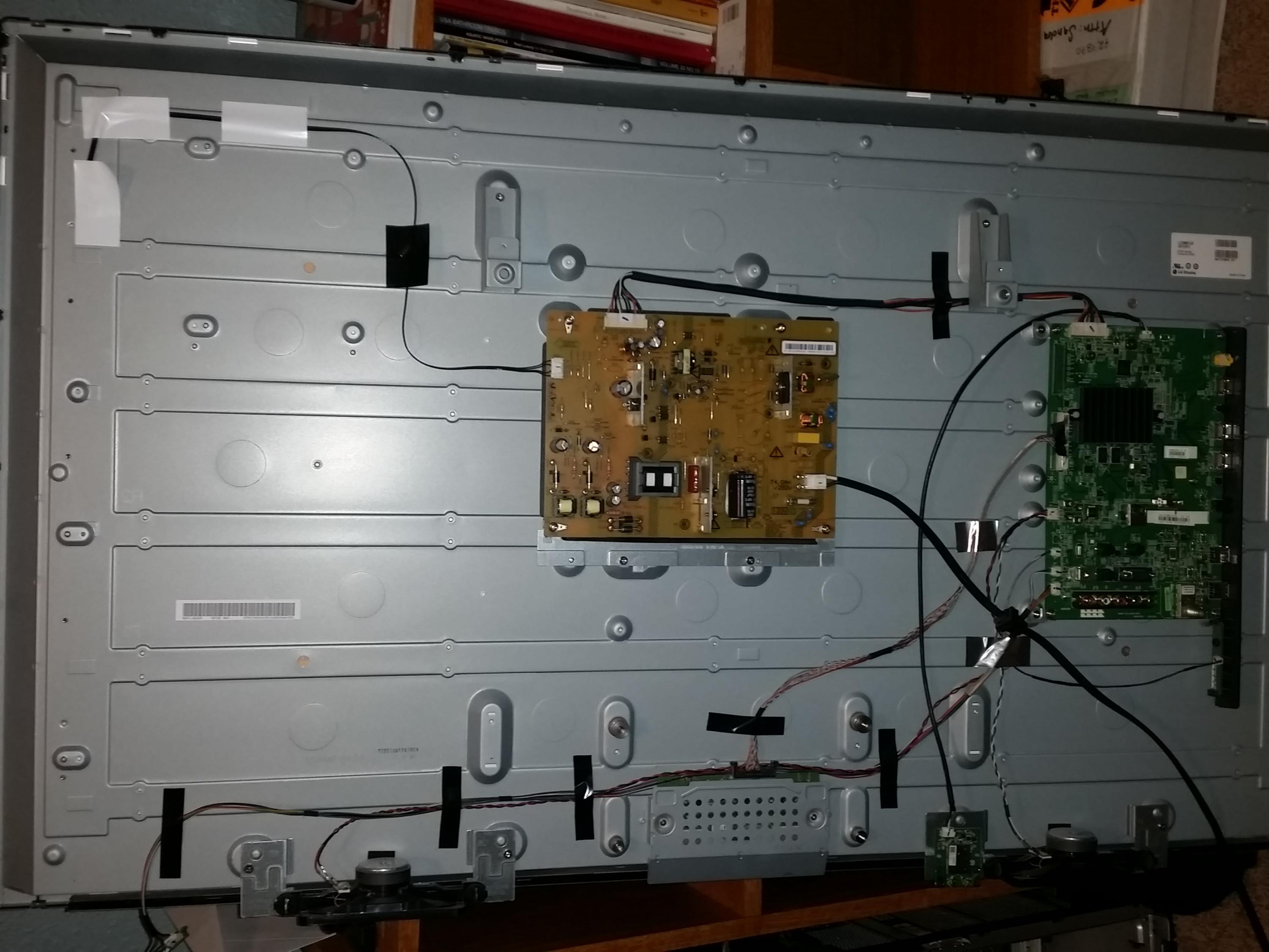

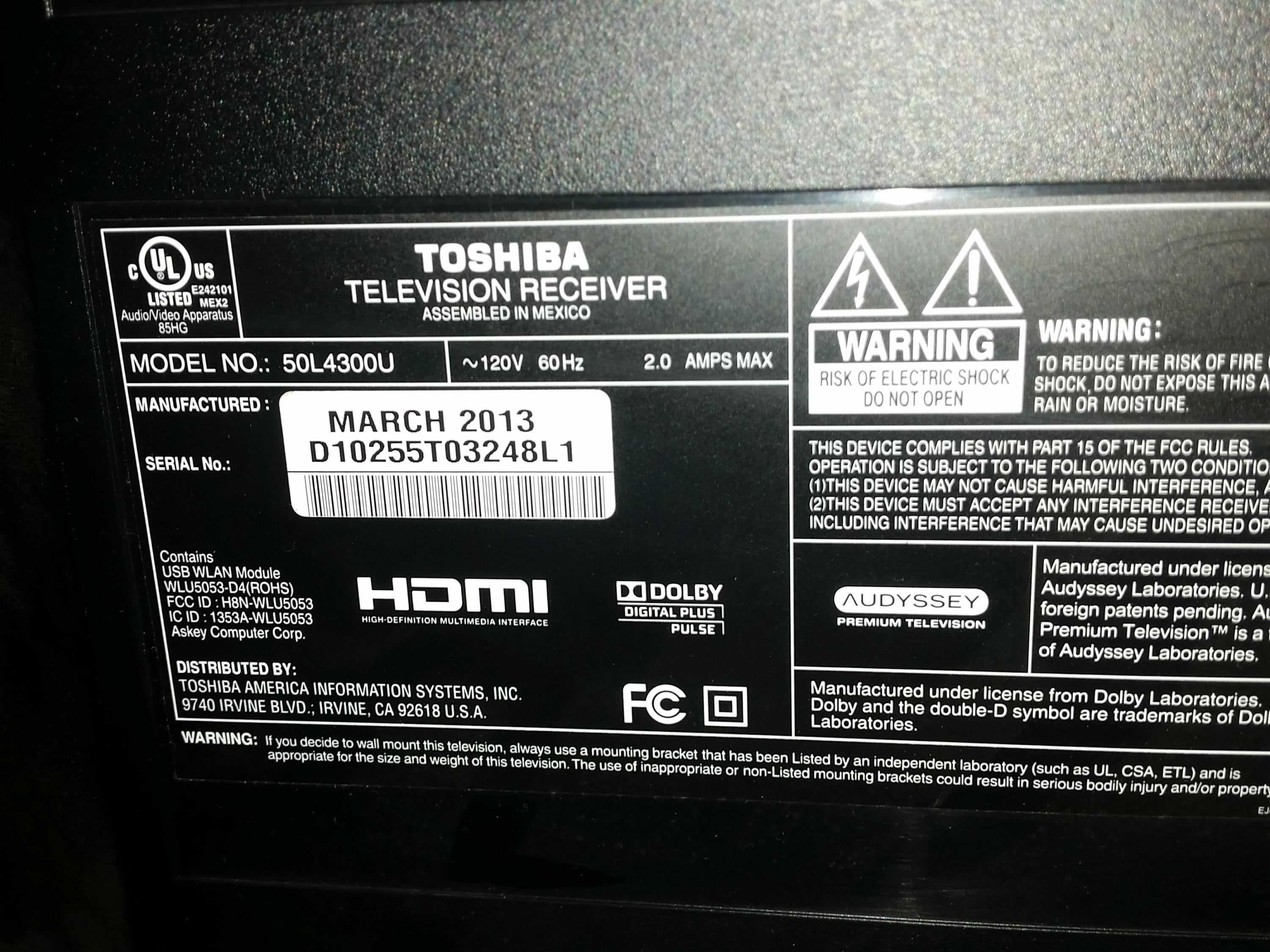

Toshiba 50L4300U Backlight
  • Eyes.Only
    • Mar 2017
    • 10
    Toshiba 50L4300U Backlight
    The backlight flashes very quickly on power up but that's it. Can see the menu with light. This unit doesn't have an inverter board so is it the main power board? Or could it all flash quickly because the feedback/return wires are indicating a faulty led and is turning off?
  • dskall
    • Oct 2016
    • 2905
    • usa
    Re: Toshiba 50L4300U Backlight
    Well with LG panel I would suspect bad leds. You can check your voltages at P803 each side when you first power on and see max voltage on each L1and L2
    • nickmatine1
      • Mar 2017
      • 8
      • usa
      Re: Toshiba 50L4300U Backlight
      this one has same power supply with 50l1350uc
      • Eyes.Only
        • Mar 2017
        • 10
        Re: Toshiba 50L4300U Backlight
        Checked the voltages and it does appear to be the LEDs. I took the diffuser out and did a power on test and the center bars don't flash, just the top and bottom ones. Do you guys suggest a stack method or just new strips?
        • finntricky
          • Jan 2014
          • 449
          • uk
          Re: Toshiba 50L4300U Backlight
          check each LED to see if it lights up, because it may just be the connection blocks on the strips that are not making good contact.
          • dskall
            • Oct 2016
            • 2905
            • usa
            Re: Toshiba 50L4300U Backlight
            Numerous ways to repair depending on how you want to do it. You can replace strips. Buy a strip and cut it up for stacking or buy just leds and replace. Those are on order of time and skill level. There are youtube videos on each.
            • Andrew F. Ali
              • Jan 2014
              • 2450
              • Trinidad & Tobago
              Re: Toshiba 50L4300U Backlight
              It will be less costly to apply Reecey's Stack Method, which is a proven fix. If it is more than 2 LEDs, I will recommend a new strip replacement. After repairing the backlights turn down the Backlights Level control to about 75% and that should prevent further issues.
              • diif
                • Feb 2014
                • 6978
                • England
                Re: Toshiba 50L4300U Backlight
                I think your TV is edge lit. You'll have to replace the faulty LED(s) or the whole strip.
                • Andrew F. Ali
                  • Jan 2014
                  • 2450
                  • Trinidad & Tobago
                  Re: Toshiba 50L4300U Backlight
                  Originally posted by diif
                  I think your TV is edge lit. You'll have to replace the faulty LED(s) or the whole strip.
                  +10..Get whole strip...best bet.
                    Re: Toshiba 50L4300U Backlight
                    The way the chassis looks, it does not look like edge lit panel.
                    LC500DUE-SFR1
                    http://www.shopjimmy.com/lg-6916l-12...strip-only.htm
                    http://www.shopjimmy.com/lg-lc500due...-12-strips.htm
                    You may want to verify.
                    • finntricky
                      • Jan 2014
                      • 449
                      • uk
                      Re: Toshiba 50L4300U Backlight
                      Defo not edge lit, normal vestal back light strip LED's,
                      like i said, check each LED first,
                      6 rows of LED's = 12 strips in total,
                      12 plastic connection blocks, loads of soldering,
                      Last edited by finntricky; 03-30-2017, 01:21 AM.
                      • diif
                        • Feb 2014
                        • 6978
                        • England
                        Re: Toshiba 50L4300U Backlight
                        My bad, this review here has it as edge lit.
                        https://reviews.lcdtvbuyingguide.com...-50l4300u.html
                        • Eyes.Only
                          • Mar 2017
                          • 10
                          Re: Toshiba 50L4300U Backlight
                          So the first leg which is the top two sets and the bottom set all appear good.
                          The second leg however is bad. I tested as individual strips.
                          L1: All good > R1: 1 bad LED
                          L2: all bad > R2: All good
                          L2: had 2 bad LEDs > R2: 1 bad LED
                          Is that many bad LEDs common? Should I just get a set of strips? Should I replace all of them if others are soon to follow? (Why only the second leg? Power board surge or something?)
                          • dskall
                            • Oct 2016
                            • 2905
                            • usa
                            Re: Toshiba 50L4300U Backlight
                            L2 probably not all bad. An open led can disable the whole strip. Would need to test each one in that strip.
                              Re: Toshiba 50L4300U Backlight
                              Originally posted by Eyes.Only
                              So the first leg which is the top two sets and the bottom set all appear good.
                              The second leg however is bad. I tested as individual strips.
                              L1: All good > R1: 1 bad LED
                              L2: all bad > R2: All good
                              L2: had 2 bad LEDs > R2: 1 bad LED
                              Is that many bad LEDs common? Should I just get a set of strips? Should I replace all of them if others are soon to follow? (Why only the second leg? Power board surge or something?)
                              They drive those LEDS real hard close the max spec they can handle, and with poor heats management it does not help.
                              So ONLY two bad LEDS? that is nothing. It is a big panel so it kind of taking chance that other LEDS may go out later on too, you can replace them all of just the bad ones and run the backlights level as low as you can to extend the life of the LEDs.
                              • Eyes.Only
                                • Mar 2017
                                • 10
                                Re: Toshiba 50L4300U Backlight
                                Any tips on the best place for a set if I were to replace them all?
                                • hisalive
                                  • Aug 2015
                                  • 4
                                  • canada
                                  Re: Toshiba 50L4300U Backlight
                                  Good Day Eyes.Only
                                  Did you happen to replace the LED strips? Did you get this set working? I have same issue and looking for best place to purchase new strips!
                                  • Eyes.Only
                                    • Mar 2017
                                    • 10
                                    Re: Toshiba 50L4300U Backlight
                                    Yep I did. By replacing the bad strips everything was fixed. I was only able to get a full set so now I have many I did not use. Do you know which strips you need?
                                    • triplefour
                                      by triplefour
                                      09-13-2023, 10:43 PM
                                    • Boyxba
                                      TOSHIBA BACKLIGHT MAINBOARD C55-a-1h9
                                      by Boyxba
                                      I have a toshiba laptop satelite series c55-a-1h9 with a burnt item on pcb motherboard which is responsible for backlight display. the short came after installation of cable lvds and broken the leg with the v+ of backlight and made this short . the lvds cable replaced and i have working display now but not backlight. the problem is i dont know what was the component that burned in order to change it. voltage i have in this points of burned item at up side 19v and dropping and from down i have steady 19v . can anyone help me? i shall post some photos to see....
                                      05-13-2023, 11:47 AM
                                    • DanPoka
                                      Guide me through repairing a Dell p2210f LCD ccfl backlight monitor
                                      by DanPoka
                                      I bought this p2210f dell monitor to fix. Schematic is the same as p2210.
                                      Behaviour is that monitors comes on but then backlight switches off almost instantly. If I look with flashlight I can still find the "No signal message". So definitely a backlight issue. Trying to advance the issue I proved that the protection circuit is switching off the backlight by shorting out C3 and resistor to disable the INL chip then re enable by removing the short.
                                      This is where it gets interesting. When I disassembled the monitor to solder leads on c3 capacitor I noticed the backlight flickered...
                                      02-15-2025, 05:05 AM
                                    • Comp_Pro
                                      No Backlight Macbook A1990 820-01041
                                      by Comp_Pro
                                      Hello all,
                                      Am trying to figure out this backlight issue with this A1990 Macbook Pro.
                                      Tests performed:
                                      There is no backlight even with a good screen.
                                      Backlight IC is receiving the correct support voltages.
                                      Fuse F8400 ok
                                      Current sense resistor R8400 ok
                                      Backlight IC is receiving 3.3V on enable pin.
                                      Backlight IC receiving voltage from PPBUS_G3H, aprox 12.5V.
                                      Backlight IC receiving 5V from PP5V_G3S
                                      Backlight IC BKLT_SCL and BKLT_SDA both measure 0.545V diode mode to ground
                                      I2C_BKLT_SCL and I2C_BKLT_SDA both measure...
                                      05-06-2024, 10:23 PM
                                    • willis6732
                                      Toshiba 55lf621c21 Dim Picture / Backlight afterbypassing a Burnt LED
                                      by willis6732
                                      This TV came in for a backlight Repair. I bypassed the Burnt LED as shown in Picture. I thought it was fixed and returned to customer. So I dont have the TV anymore, but customer says its not really watchable.
                                      Now the TV Is much dimmer than before. It does a quick bright flash when it first turns on.
                                      The Driver board looked pretty toasty in the LED Driver Area.
                                      So I am wondering.. how can i Tell if this is a LED or Driver Board Issue?...
                                      12-17-2024, 04:09 PM
