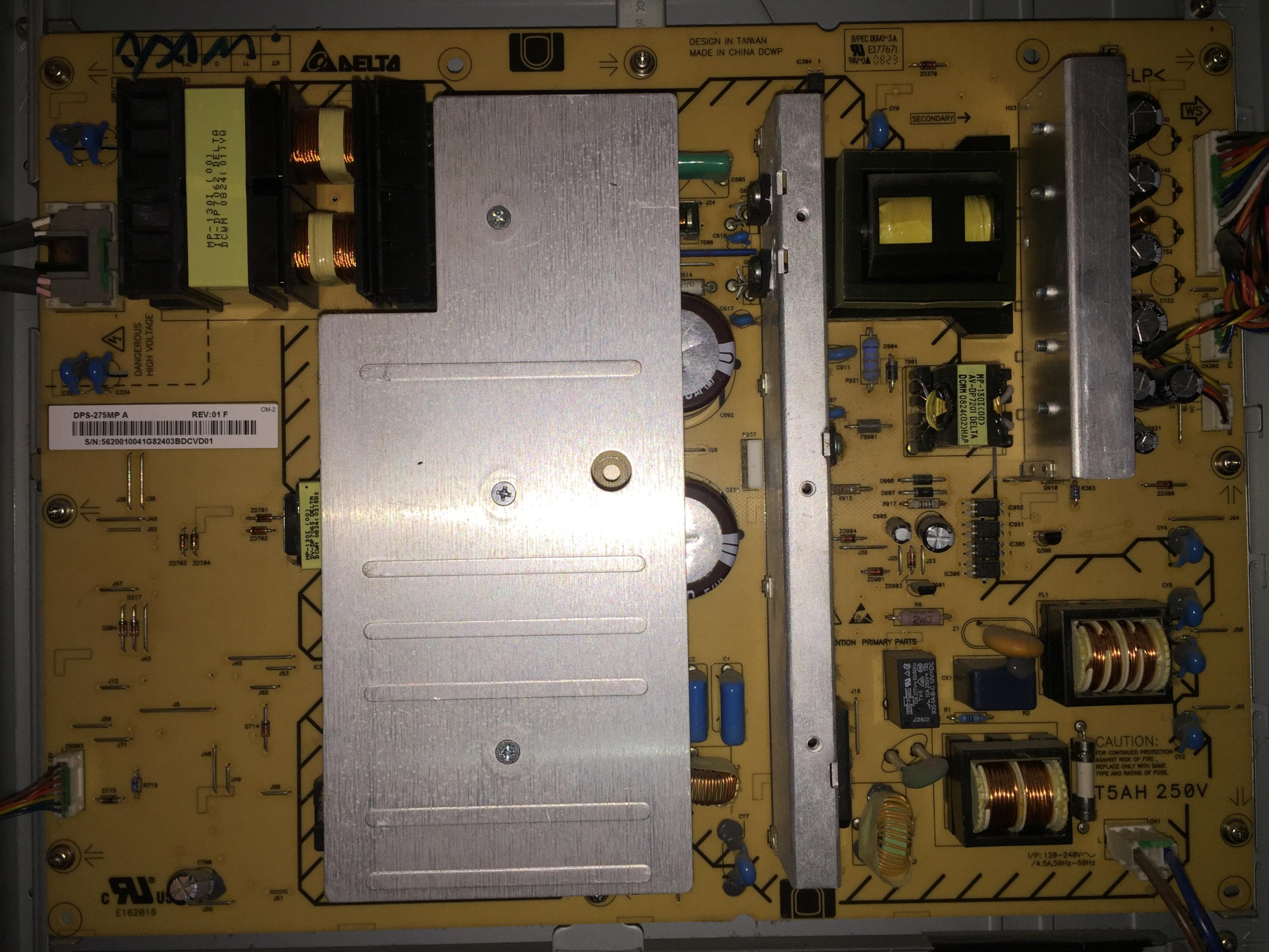

                      I just purchased a replacement power supply board off of eBay (they have an acceptable return policy) I'll let you know if that helps.
                      Thanks again for the feedback and keeping the post active - Tim

                        The used power supply from eBay did not solve the problem.
                        The TV ran for about 30 hours, and then today exhibited the same symptions; hear a click of the power going on in the TV (after pressing the remote 'on' button), but the screen won't turn on. Same as before.
                        I guess based on the feedback here, I should attempt to replace the TCon board? Any other thoughts? Is there some troubleshooting I should do first, to help narrow down the issue. As a reminder, I already swapped the Main Board, but the problem existed there too - although I'm very curious if the eBay auction board just had the same problem as mine... works for 30hrs and then dies. Again, reminder, this TV will work for about 2 days if I unplug it and don't use it for a month.
                        Thanks for the ideas and feedback so far!
                        Tim
