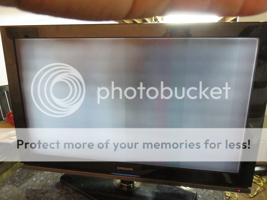

bn41-00944a succesfull component level repair?
    bn41-00944a succesfull component level repair?
    I have a samsung lnt4069fx with gray/white screen issues and slow blinking red light.(see pictures) It has a bn41-00944a frc which apparently goes bad.
    tv red blinks the same way with that board disconnected from the motherboard
    So far Ive tested the 5 pins voltage regulators and they output the correct voltage at 2.5V and 1.8V. I tried reflowing but the heatsink wont let me heat it correctly
    All Im seeing is people replacing the board altogether. Anyone ever fixed one?
    10 second after turning it on:
    20 seconds after turning it on:
    Re: bn41-00944a succesfull component level repair?
    What do you get if you have the ribbon cable between the T-CON and the LCD panel connected one at a time?
      Re: bn41-00944a succesfull component level repair?
      Hi, Did you ever resolved the issue with the white screen? I have same issue as well.
      M.
