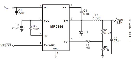

    Anyone know where I can buy that IC?
    MP2396ES
    C0DBAYY00727

      Re: Panasonic 65" VT20 10 blink code
      Originally posted by tn245
      What's the resistance between pin 2 and gnd on both boards?
      Bad board:
      8.1k
      Good :
        measure the same points in reverse as there is a diode in the circuit which maybe impacting measurements.... maybe. It doesn't look good for the IC based on some of your work to date. But possibly do some more resistance check comparison between the working board and non-working. This may give you some further pointers to either the IC or supporting / connnected circuit component issues.
            Originally posted by infrag
            Bad board:
            8.1k
            Good :
            9.3k
            What value resistors are connected to pin 2 as in attached diagram marked as R1 & R2

              • infrag
                • Jun 2012
                • 89
                • australia
                #67
                I dont mind to try desoldering/soldering the IC. However I'd like to find and order a backup one or 2 just in case and then try while the backup ones are on the way here.
                    you could try utsource but check package and dimensions of what's currently fitted just in case there's more than one package size.
                    Datasheet has it as SOIC 8, 5mm x 4mm
                    UTSOURCE has SOP8, which could be an error
                    expect 3 weeks turnaround
                      Ordered a couple of them just in case.
                      Thanks heaps.
                      I'd never heard of utsource.
                      Cheapest other one I found was the same price but postage was minimum of $30.

                                Well I have an update.
                                The replacement IC's came in. I soldered the chip in and turned the TV on. It worked!. I checked output voltage from the IC it was 8.5V. Then I turned the TV off.... and tried to turn it back on again. The relay clicked to turn on and then the TV turned off with the same blink code again. Bugger...
                                The other symptom is the IC does get hot while the TV is on.
                                Since I've tested most other parts in circuit I feel I'm chasing my tail.
                                I've done a non normal fix I guess and used a 5v relay to trigger when the 3.3V panel on comes through. This triggers a separate adjustable output voltage regulator which is powered by the 15V and changes it to the required 8V and feeds that back into the circuit.
                                The long and short of it is that this seems to work but theres obviously some other part in circuit thats not performing correctly. I've had the TV on for an hour and nothing seems to be getting hot.
                                If it dies I'll just have to get another board.
                                Thanks very much for the help in finding the faulty area!
