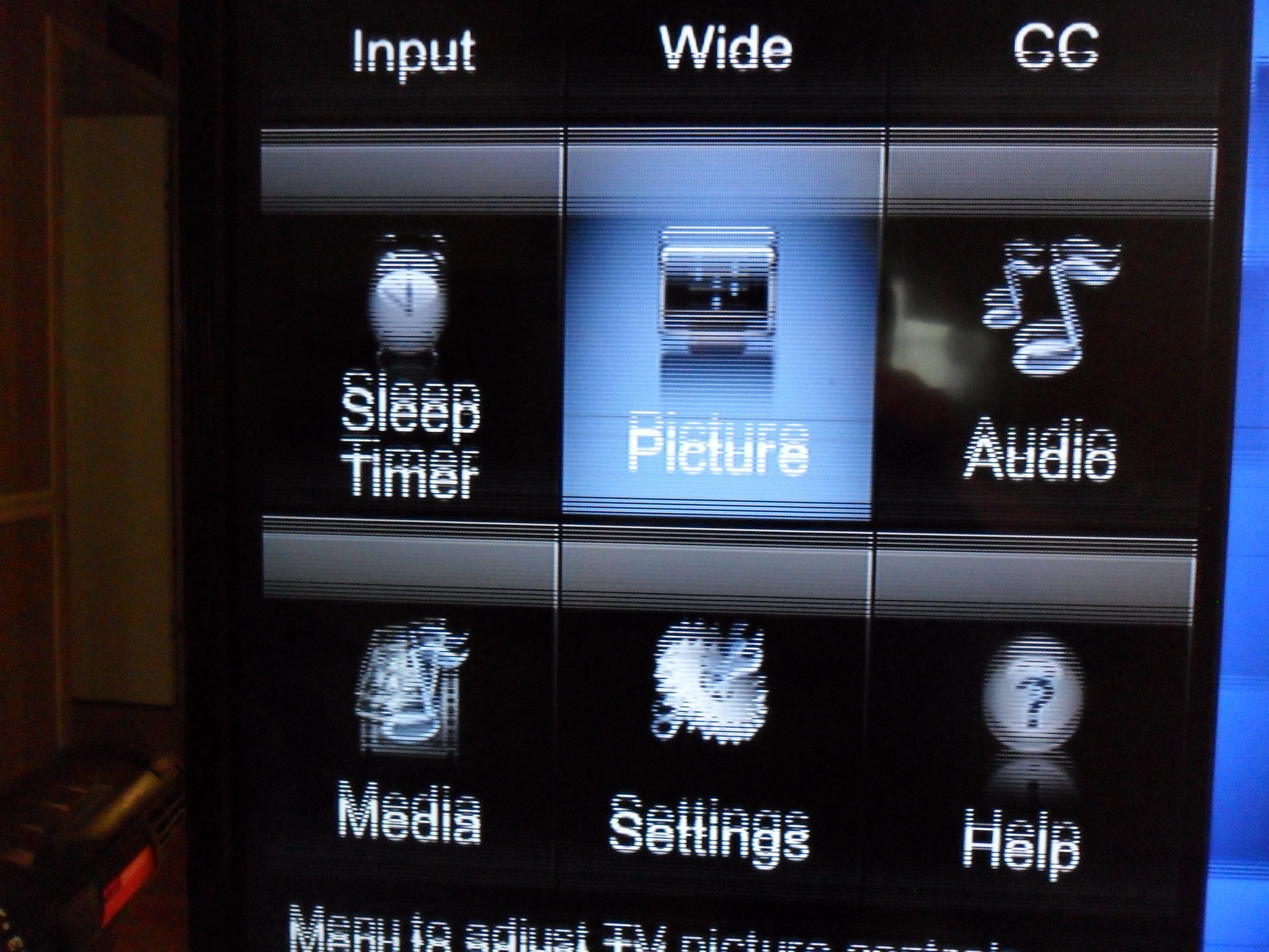

    I turned on my TV the other day and the screen had these lines that were shifting up and down. I re-seated the cables from the main board to the panel and there was no change. Should I buy a new main board or is it the panel?

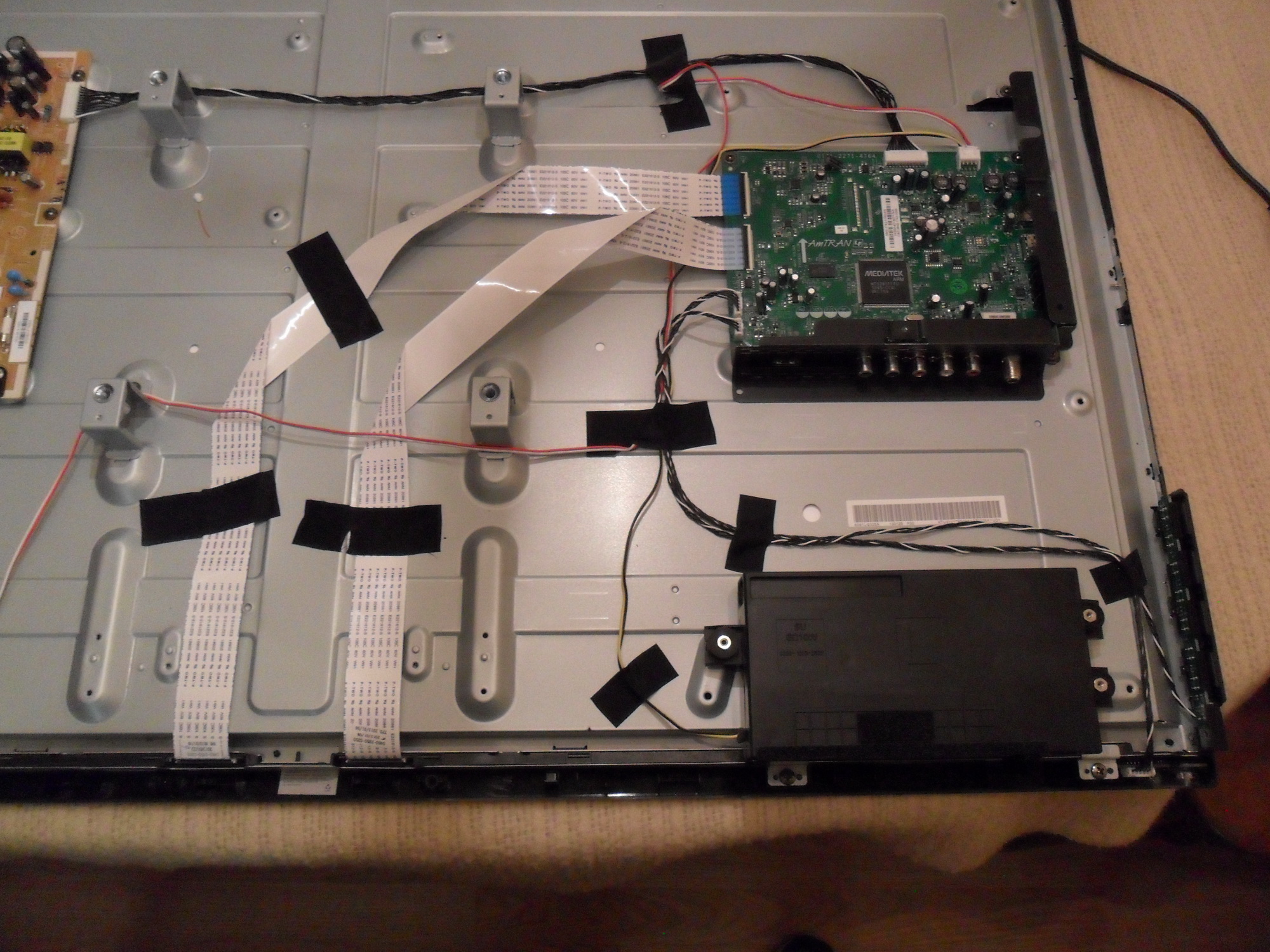

    remove one side of the ribbon cable from the tcon to the panel, while leaving the other side plugged in. Check the picture then do the same thing vice versa.

      When I disconnect the top cable from the board the screen is half black and half white and I can see some lines in the black half but not the white half. With the bottom cable disconnected same half black half white but I see no lines in the black half

        Since you have no t-con I would say mainboard

          try this trick:
          https://www.youtube.com/watch?v=j7vl7-vZEL8

              Don't know why it worked for him. But tried it and no help, guess it's time to order one unless there are any other suggestions?

                Panel fault IMO.

                  You will have to experiment with how many tracks you block with the tape and which tracks. It takes time but it often does work.

                    It's a panel fault. This trick does work but not always... unfortunately...
                    as martino already mentioned you have to experiment on which and how many tracks to cover. I thought it was worth a shot...

                      Got around to playing with tape widths and so far I found the right tracks to cover and the picture looks fine. It worked, don't know why, but go figure. Will see how long it lasts

                          Hi there, any chance you could share which tracks you covered? I'm afraid I just bought the same model and am having this issue. Thank you.

                            You might have a long wait, that post 3 years ago was his last, you just need to experiment with how many you cover, some only need to cover a few on one end.

                              No worries, thanks for the response. Was just checking in case I couldn't get it. Hopefully no one else needs the information, but if they do... left one, towards the right side with a very small piece of post it worked for me. Covered maybe 4-7 pins. Thanks so much for keeping this place up and going!
