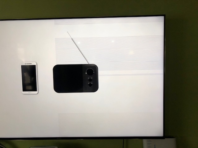

    I have a Sony Smart TV XBR65X900H that started to have horizontal lines on the right side of the screen (see attached picture). When I played video on Youtube green horizontal line at regular intervals(1/4") across the screen.
    I replaced the T-Con board but the lines are still there.
    I believe this issue is from the Main Board. Before I replace the Main board, I wanted to seek advise if this is the problem from the Main board or something else?
    Thank you for the help.

    Not main board. Tcon or panel. Check all connections on panel on the side the proble is and slightly push on the buffers while running see if it makes a difference.The buffers on the side of the panel.

      If you replaced Tcon it's a panel issue but likely fixable. Take a little piece of copy paper or kapton tape and stick it in the large ribbon connector of the Tcon on the affected side. Walk it around until it starts clearing up then trim.

        Are these static or moving around?
        I had something similar with RCA TV except it was random dots and the bars on right side which were jumping around and sometimes going away.
        It was main board problem.
        When it's a panel, the lines are usually fading gradually in horizontal direction. This is because they are driven in parallel from both left/right side.

          I've tried the tape method without getting rid of the line. these lines look like they are generated by the main board. The reason I suspect the main board is when playing Youtube in 4K, I get the green horizontal lines across all over the the screen but if I used Smart Tube to play the same video in 1080P there is no horizontal green lines. I believe this is something with the graphic processor on the main board.
          Alfatv - the lines are static and they are permanently in place. they are similar to a burn in problem.

            The fault is not panel, post some other photos, other type of image on screen, most probably main board, processor soldering, or maybe tcon output ribbon cable/connectors

              simple things first, did you try a couple different hdmi cables? do you have any other 4k content to try or does it only mess up on youtube?

                OK. got it fixed by replacing new main board and update to new firmware.
