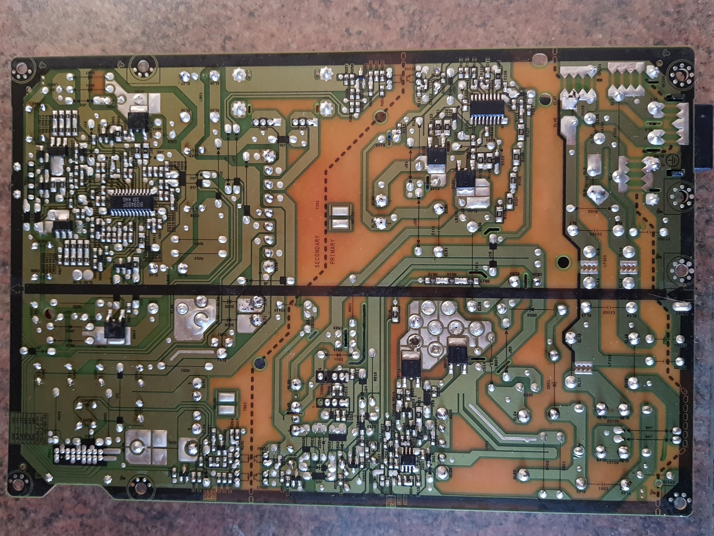

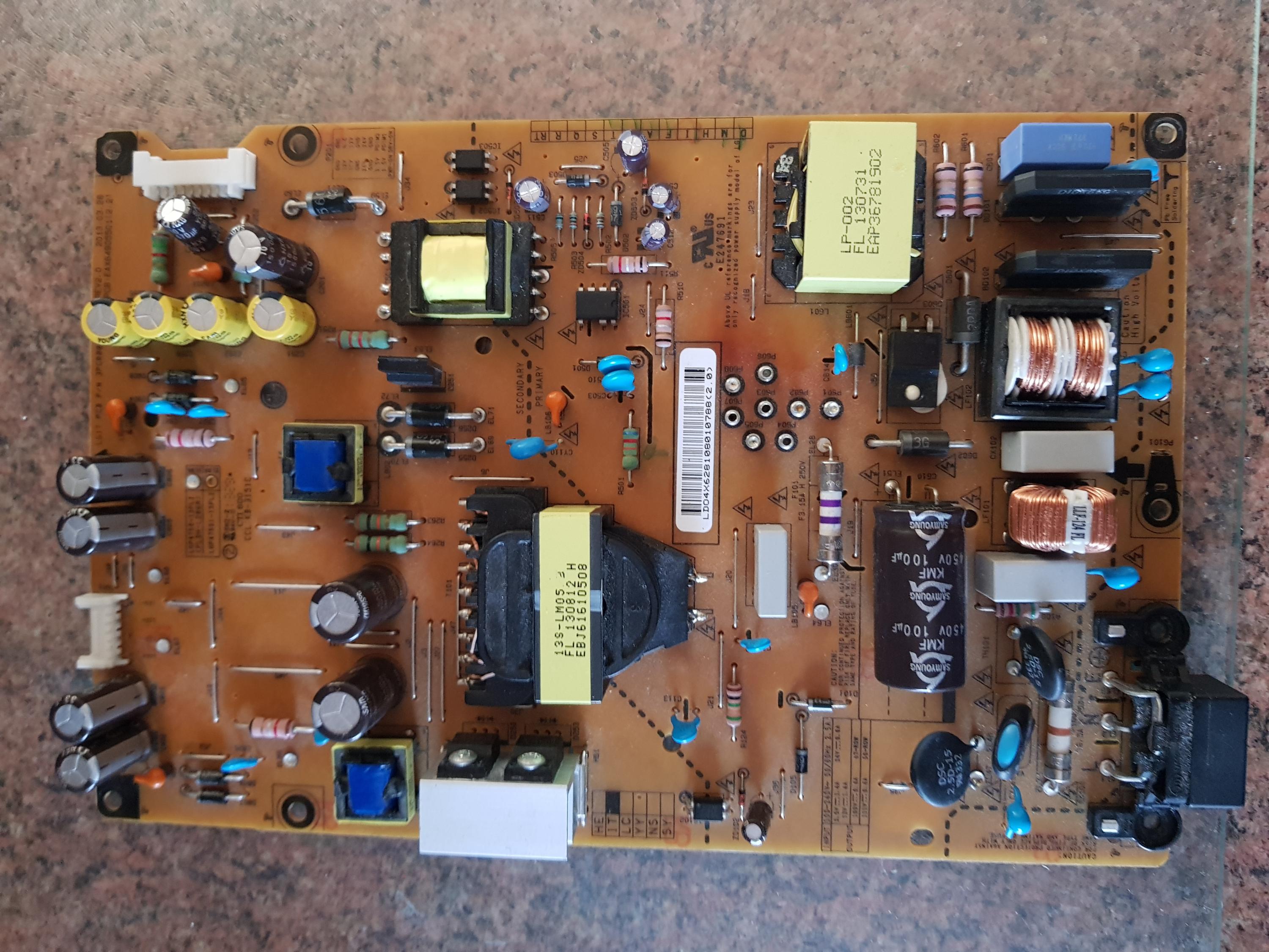

                                  • sordids999
                                    • May 2013
                                    • 2161
                                    • uk
                                    Re: LG TV stopped working.
                                    EAX64905501 power supply
                                    TV LG 47LN575V totally dead
                                    basically have voltage across the primary side but no voltage readings on secondary side,also legend voltages have no reading
                                    done so far:
                                    checked all diodes for shorts all ok
                                    voltage reading across main cap 330 volts
                                    no fuses blown
                                    any ideas
                                    thanks
                                    • vinceroger69
                                      • Mar 2012
                                      • 6714
                                      • uk
                                      i cant find a schematic for your tv but this link is possibly the one for the psu so maybe of use my guess is the pfc circuit has a issue a 330 does seem a little low too me
