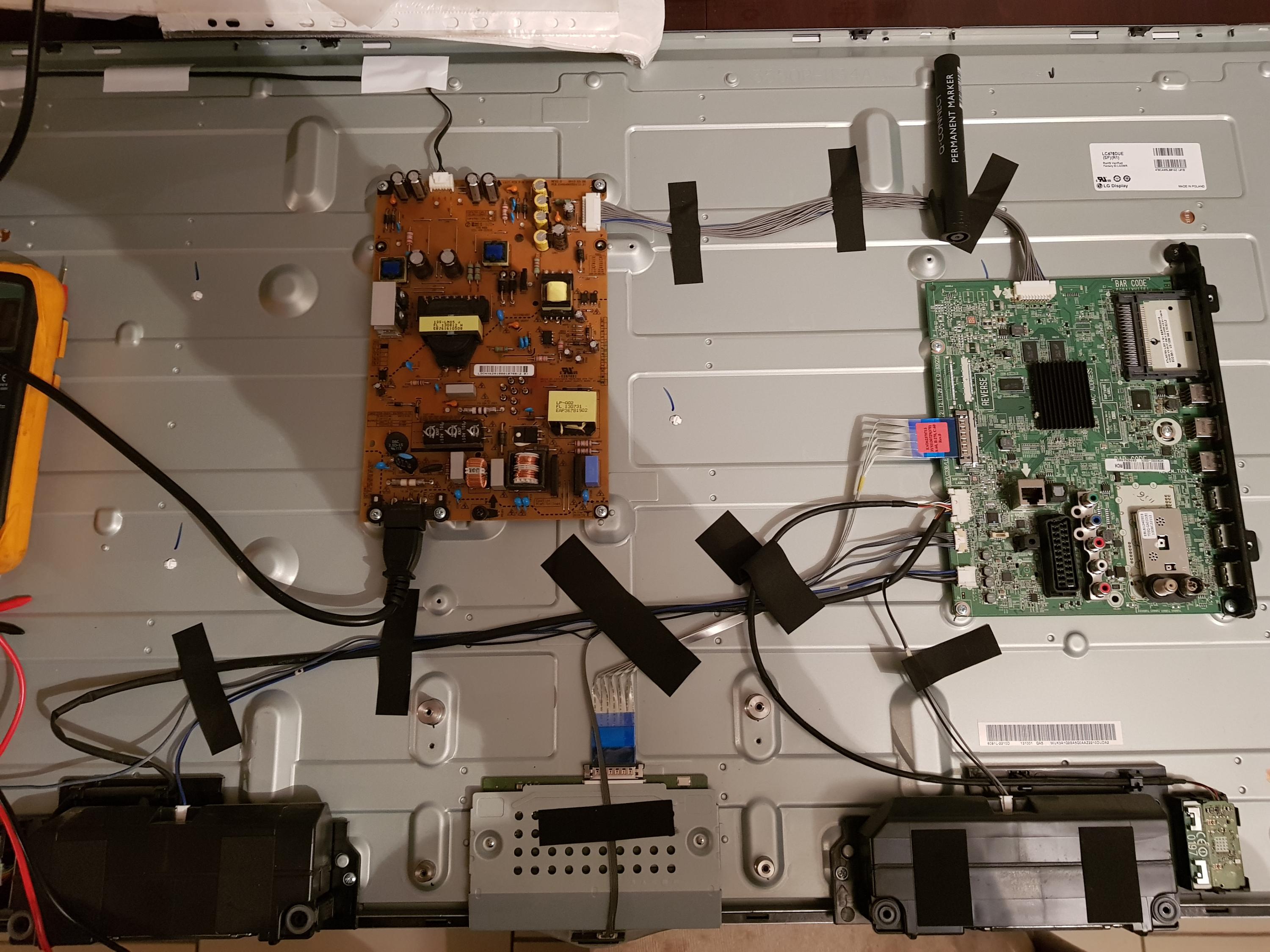

LG TV stopped working.
    Re: LG TV stopped working.
    Originally posted by sordids999
    EAX64905501 power supply
    TV LG 47LN575V totally dead
    basically have voltage across the primary side but no voltage readings on secondary side,also legend voltages have no reading
    done so far:
    checked all diodes for shorts all ok
    voltage reading across main cap 330 volts
    no fuses blown
    any ideas
    thanks
    330VDC is normal (your country AC is around 230VAC) when the TV is not turned on and the PS-ON is not present.
    We need the DC V readings of all the connector on the power supply board that goes to the main board, make sure to put down pin name and follow by the Voltage reading when TV is off and when TV power switch is activated so we can easily see what you have and do not have for each pin without guessing what each pin is for.
    Also pictures of the whole backside of the TV showing all the boards.
      LEGEND P201
      readings when tv is off and on
      gnd gnd
      12v= 0v 12v=0v
      12v= 0v 12v=0v
      gnd gnd
      24v= 0v 24v=0v
      gnd gnd
      3.5v=0v PD/M2=0v
      3.5v=0v PD/M1=0v
      PW-ON=0v DRV-ON=0v
      thanks
        OK, so we need to at least get the STBY power supply running first.
        What is the P/N as printed on top of the SMPS IC501 for the STBY power supply?
        We need to get the spec sheet of the IC then find out what DC V we have on the pins of the IC.
          From what I can read
          3BR4765JR H1331Z2V IE329186C39
          PIN1 -153.4 PIN2 -154.0 PIN3 -154.3 PIN4 0.00
          PIN5 -154.0 PIN6 -154.0 PIN7 NO PIN PIN8 -152.
            What did you use for GND ref. for your meter? It looks like you use the chassis GND. You are making measurement in the hot side of the circuit so the GND ref. for your meter will be the negative leg of the main filter cap in the hot side.
              sorry my mistake now using negative leg of the main filter cap in the hot side
              PIN1 0.00v
              PIN2 0.00v
              PIN3 0.00v
              PIN4 0.00v
              PIN5 0.00v
              PIN6 0.00v
              PIN7 NO PIN
              PIN8 325v
                ICE3BR4765J.
                Check the resistance between VCC pin and GND pin.
                Check the resistance between CS pin and GND pin
                  0.68 VCC to GND
                  0.00 CS to GND
                    #29
                    0.68 Ohms?
                    If that is the case there is shorted parts on that VCC pin, it is either internal shorts or, filter caps connected to the VCC pin shorted, or Zener diode (if there is one) shorted.
                    You have to trace out and see what are connected to the VCC pin, you can remove the IC or remove the caps to see which one will make the shorts go away.

                      #30
                      Desolder the controller chip first, then continue measuring. If measurement on VCC is no longer 0.68 ohms, instead a value more around 10 Kohms or higher, then the controller chip is dead and you need to replace that. If you are still getting a short, then you need to test other components on the board.
                        MLCC C501 is connected between VCC and GND.

                          #32
                          Ceramic capacitors usually fail (almost) dead short. This smells to me like a semiconductor short, my money would still be on the controller chip being the culprit.
                                Update **
                                Ordered ICE3BR4765J fitted voltages came back but also had the dreaded one blink backlight fault so ended up tracing it back to some faulty leds
                                In test mode now
                                Thanks for the help everyone
