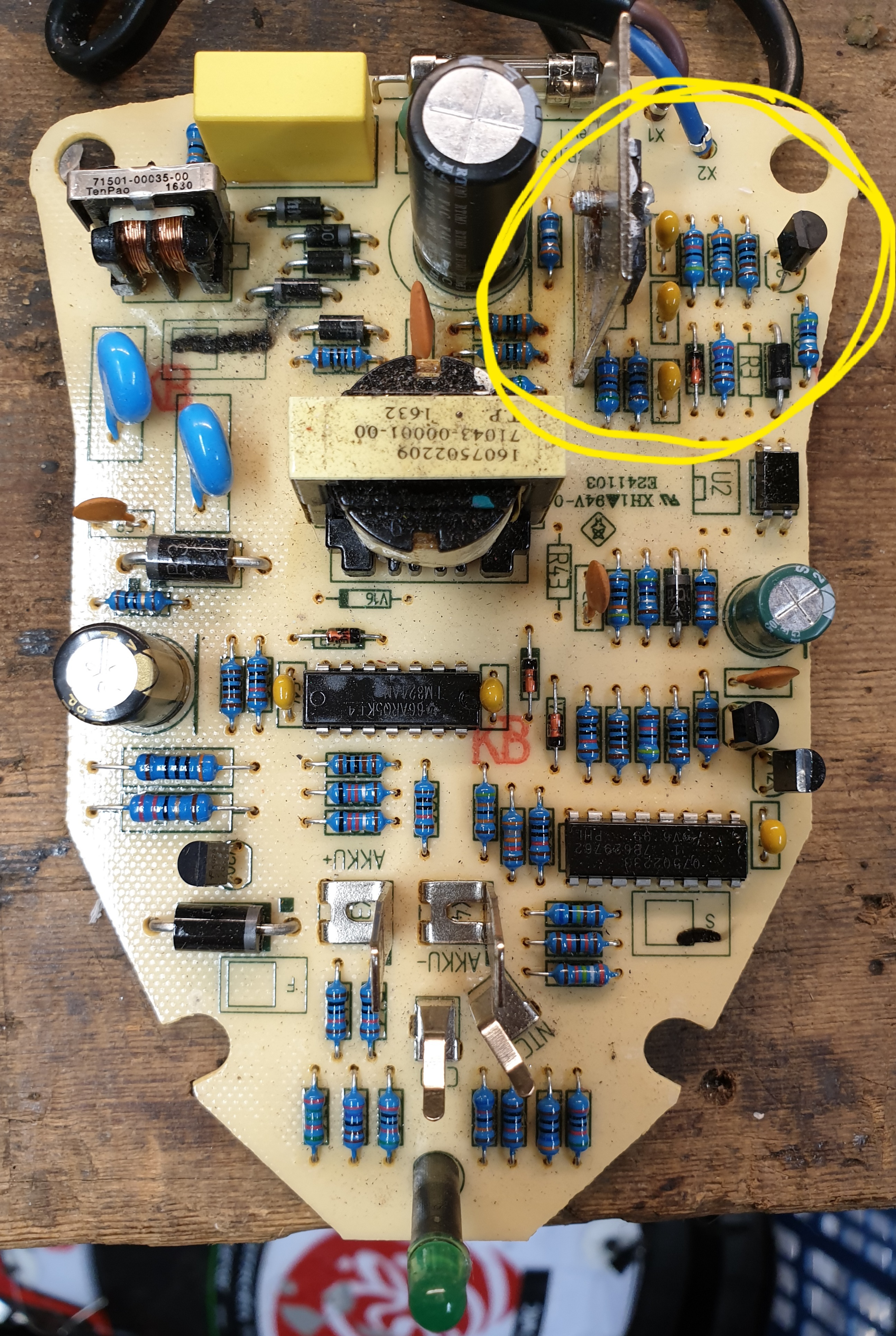

    This is my dremel charger for one of the Dremel / Bosch 10.8v (3s1p) Li-Ion packs. There are many like it, but this one is broken.
    It stopped responding the other day. No light when a battery is inserted, no voltage at the output when tested.
    The dremel itself and its battery are fine and working.
    Looking online, many people just replace this type of charger with an Aliexpress version. However most of the through hole components look straightforward enough to replace if they are broken.
    I'll do some basic poking about (continuity checks etc) later. I've already checked the internal glass fuse and plug fuse (both fine).
    Nothing obviously looks burned or popped
    In the meantime, here are some pictures of the circuit.
    Any pointers for order of testing etc would be greatly appreciated.

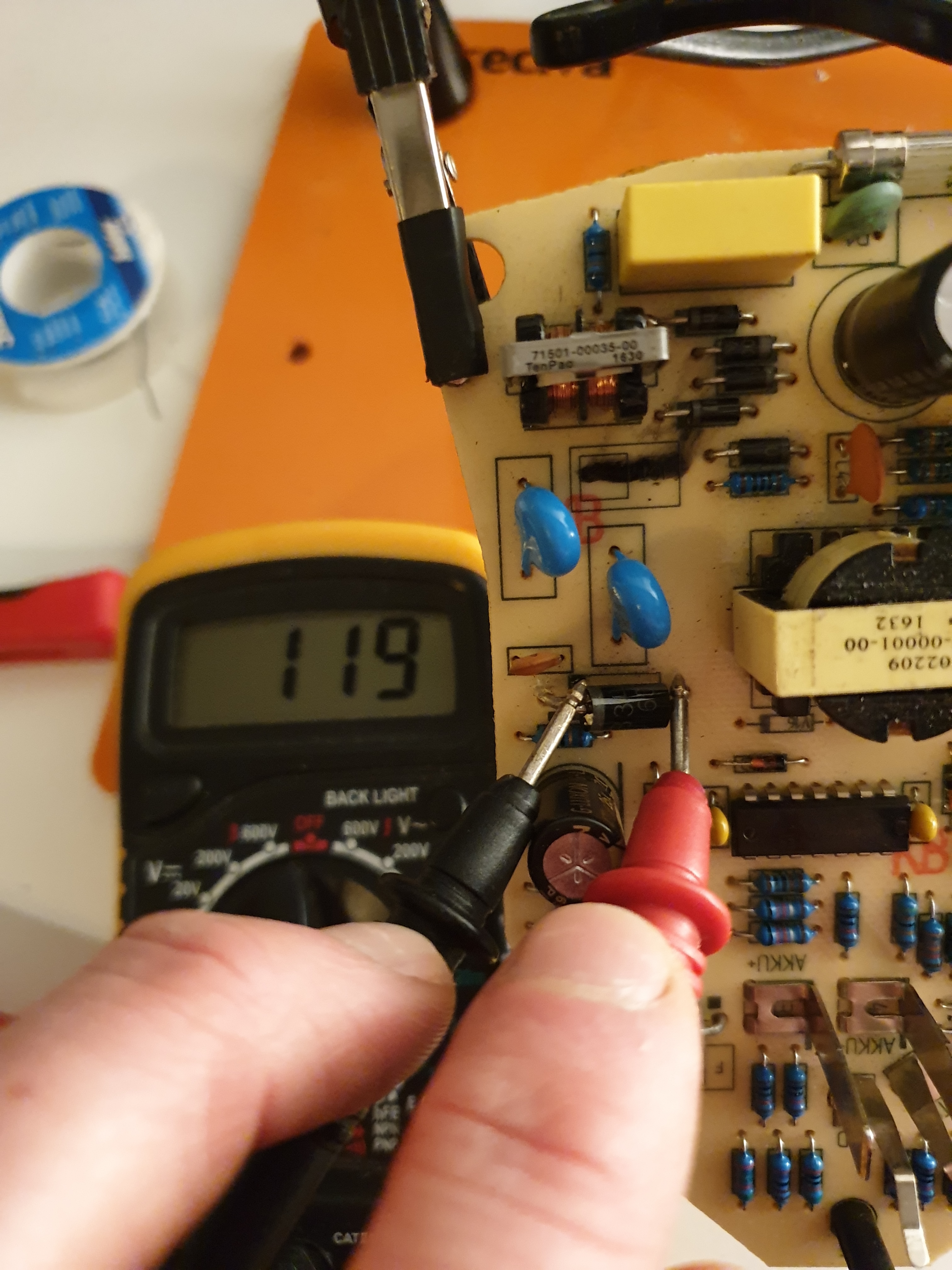

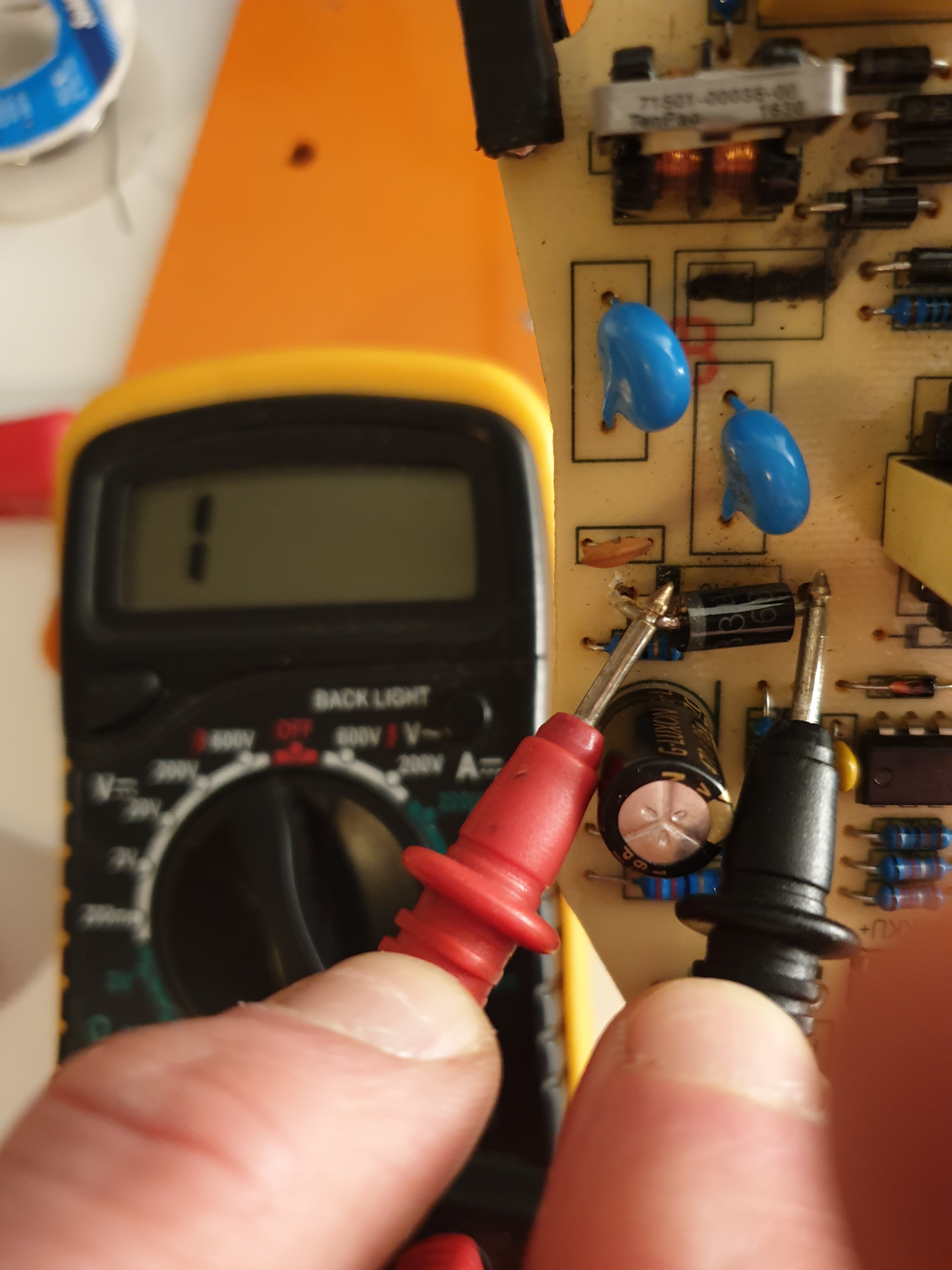

  • lotas
    • Jan 2016
    • 4610
    • Russia
    Check these diodes for short circuits.
    • thaphatmaster
      • Apr 2020
      • 18

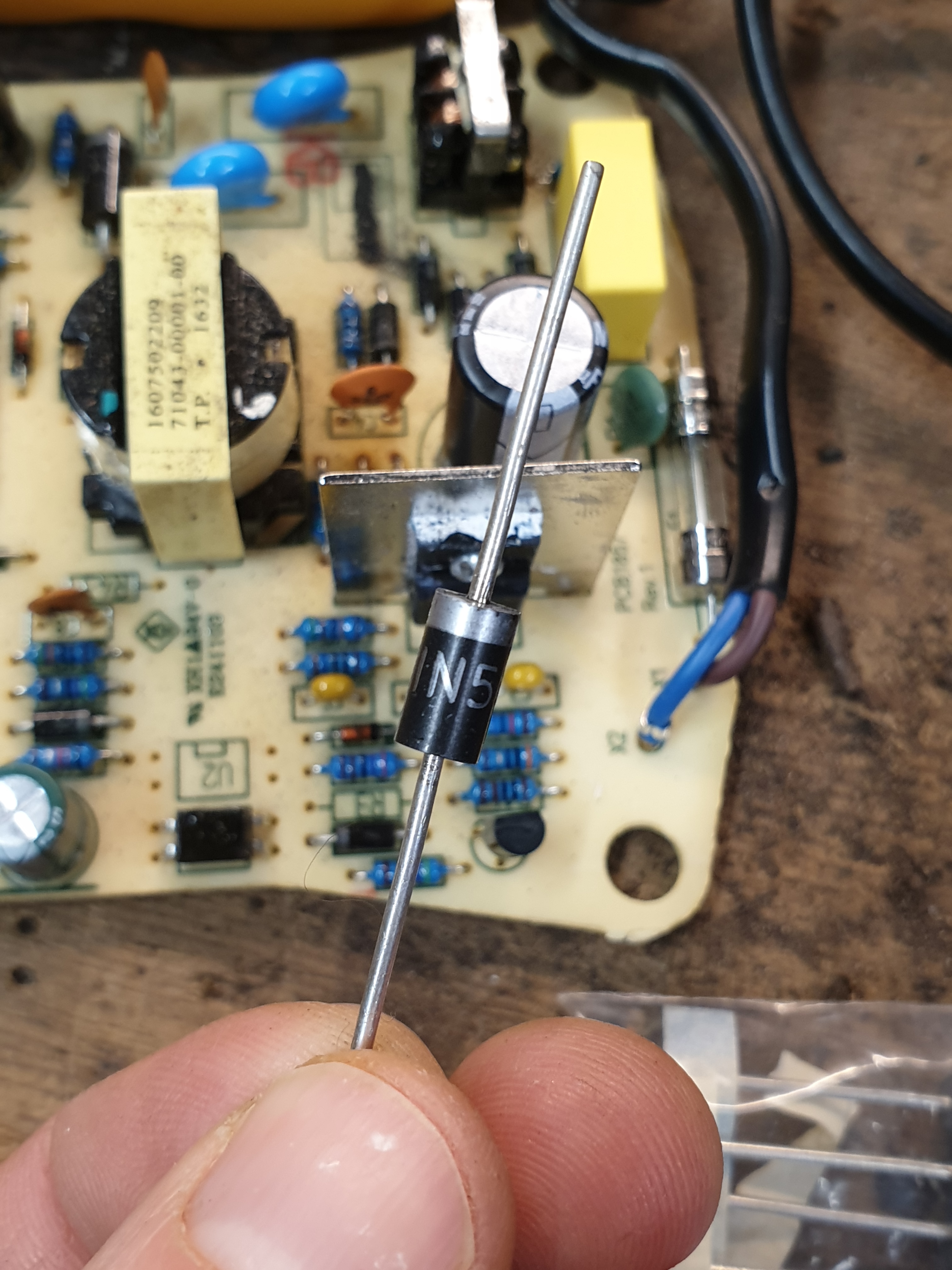

      Whatcha know "top" one looks open both ways.
      Is this a suitable replacement (IN5400)?
      • lotas
        • Jan 2016
        • 4610
        • Russia
        SBxxx is a Schottky diode, it has a lower junction drop than a regular one, raise one leg on it and measure it outside the board.

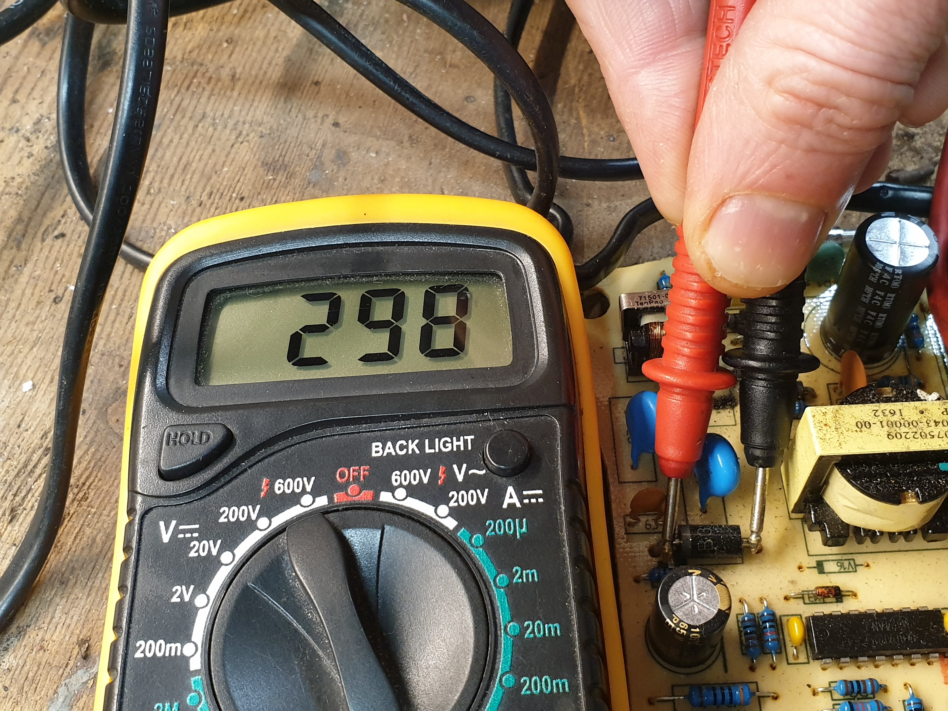

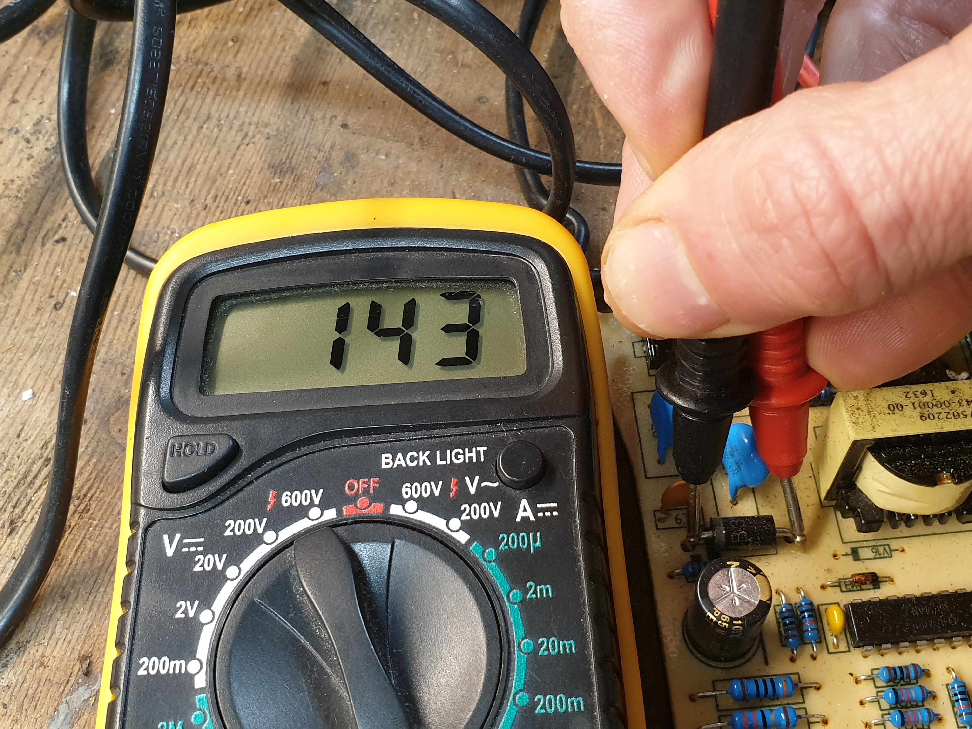

              Results are in (I also brushed it)
              • lotas
                • Jan 2016
                • 4610
                • Russia
                The diode is live.

                  Working?
                  I'll check the components here next as I've seen others with blown resistors / diodes in this area
