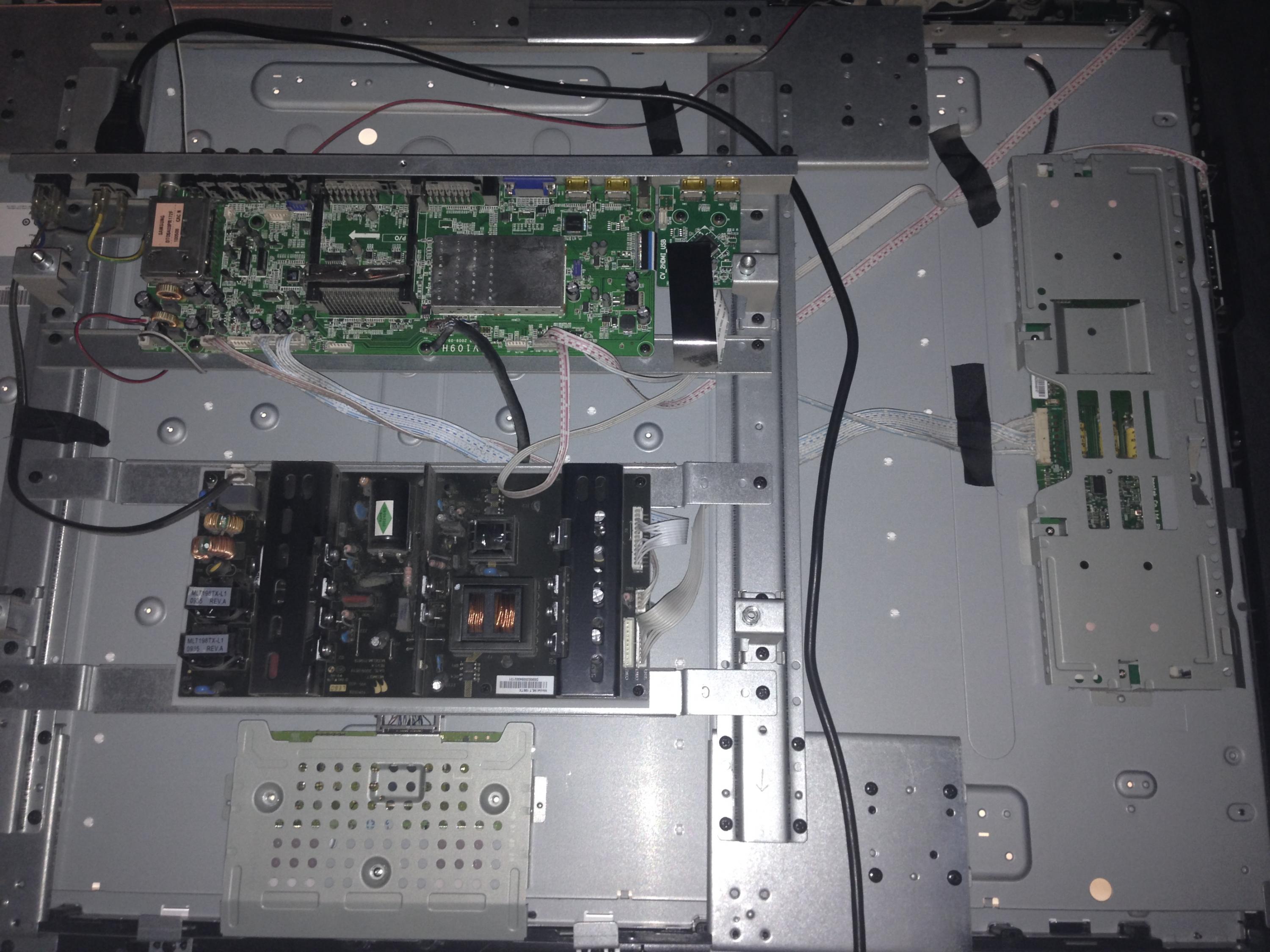

    lets go again
    +12v both 11.95v
    sgnd three of them one is readin 0.01
    5vsb 5.01v
    stb 2.01v
    +5v 5.00v
    +5v 5.00v
    +24v +24v both 23.6v
    sgnd 0.00 and the 3rd 0.01

                  Think I might try a T-con. Got voltages, backlights
                  • LEEDASH
                    • Dec 2012
                    • 481
                    • Bedfordshire
                    #49
                    Re: baird 42 no picture
                    T-con holding correct voltage yes backlights all around

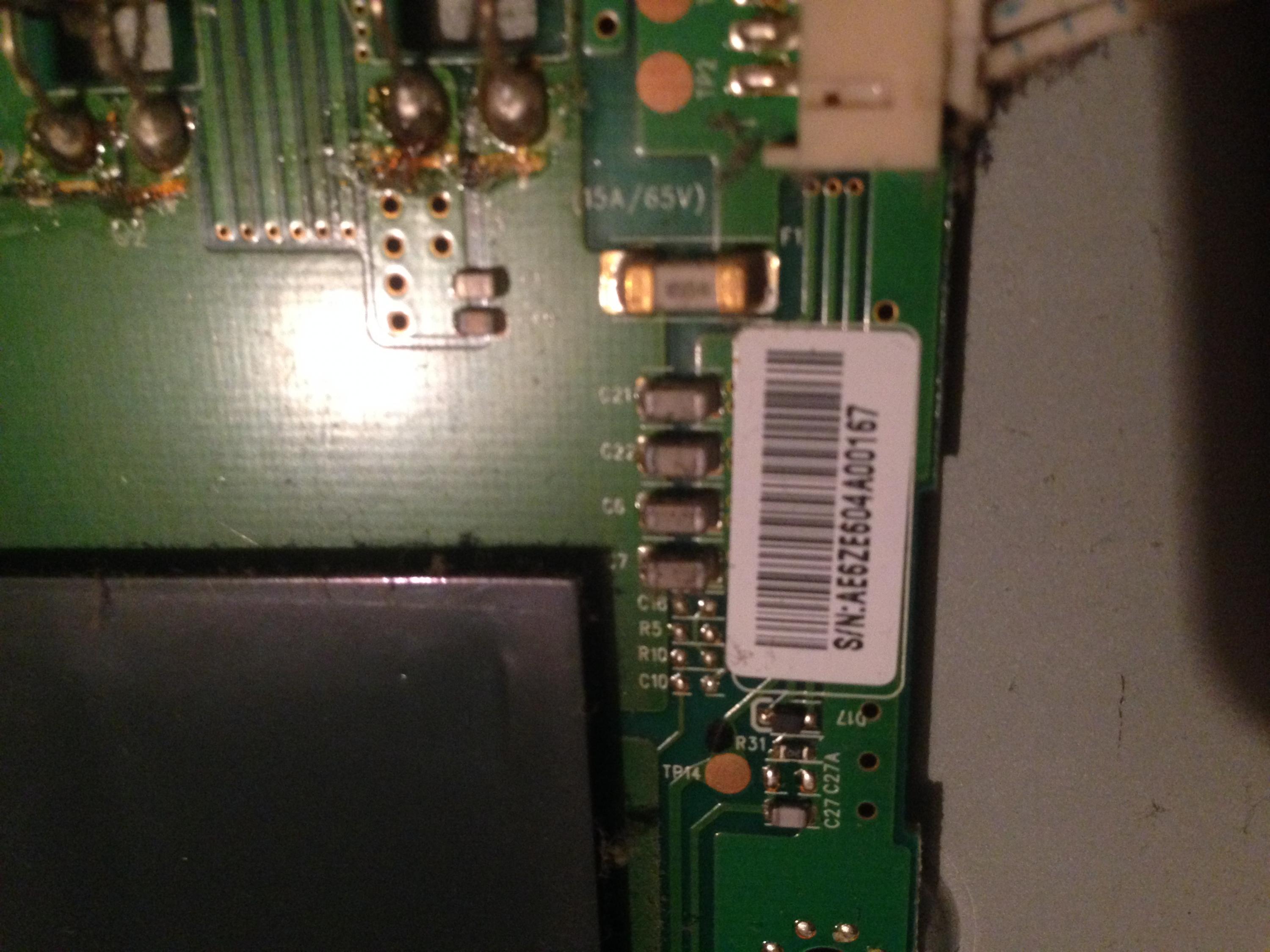

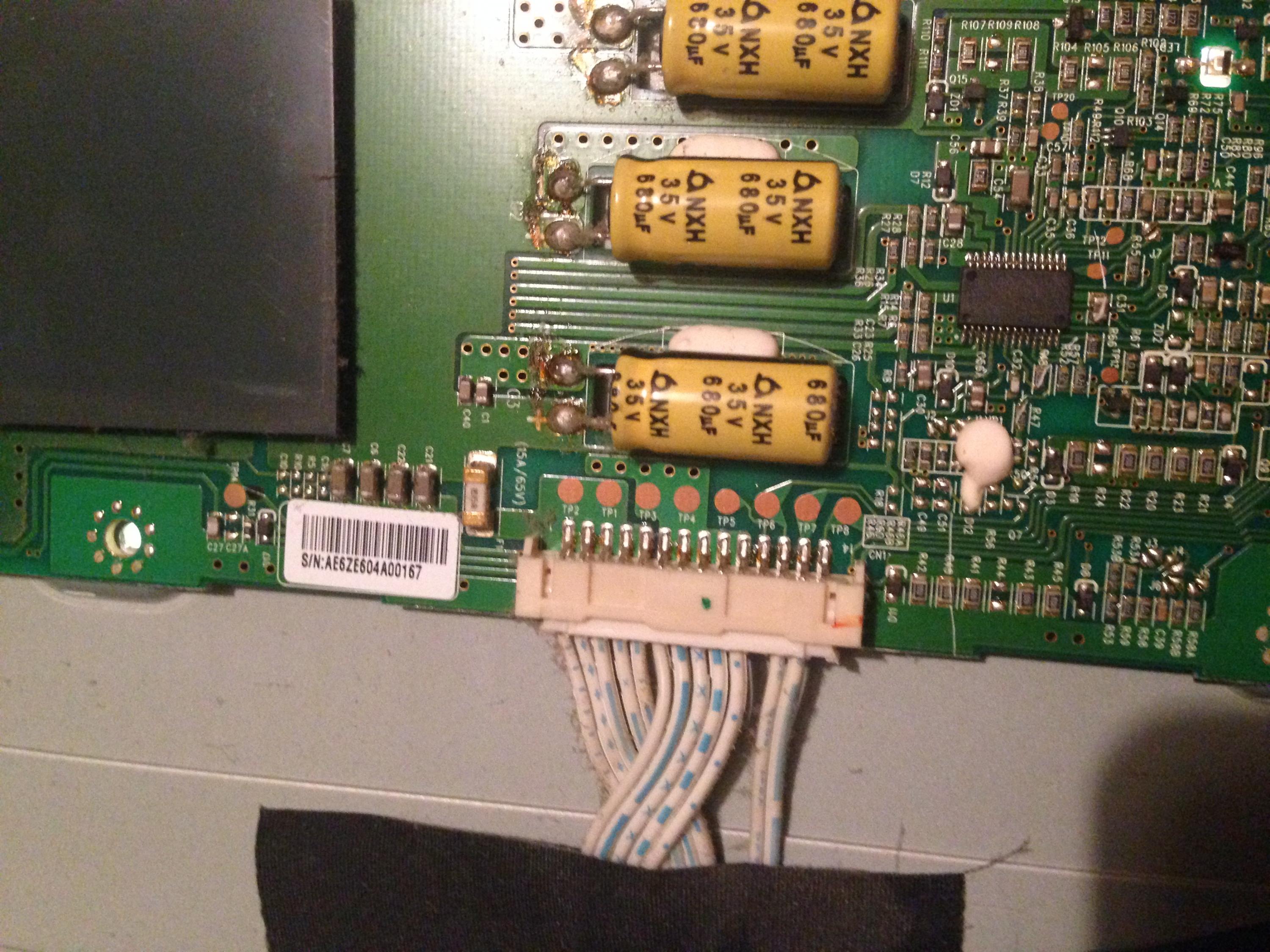

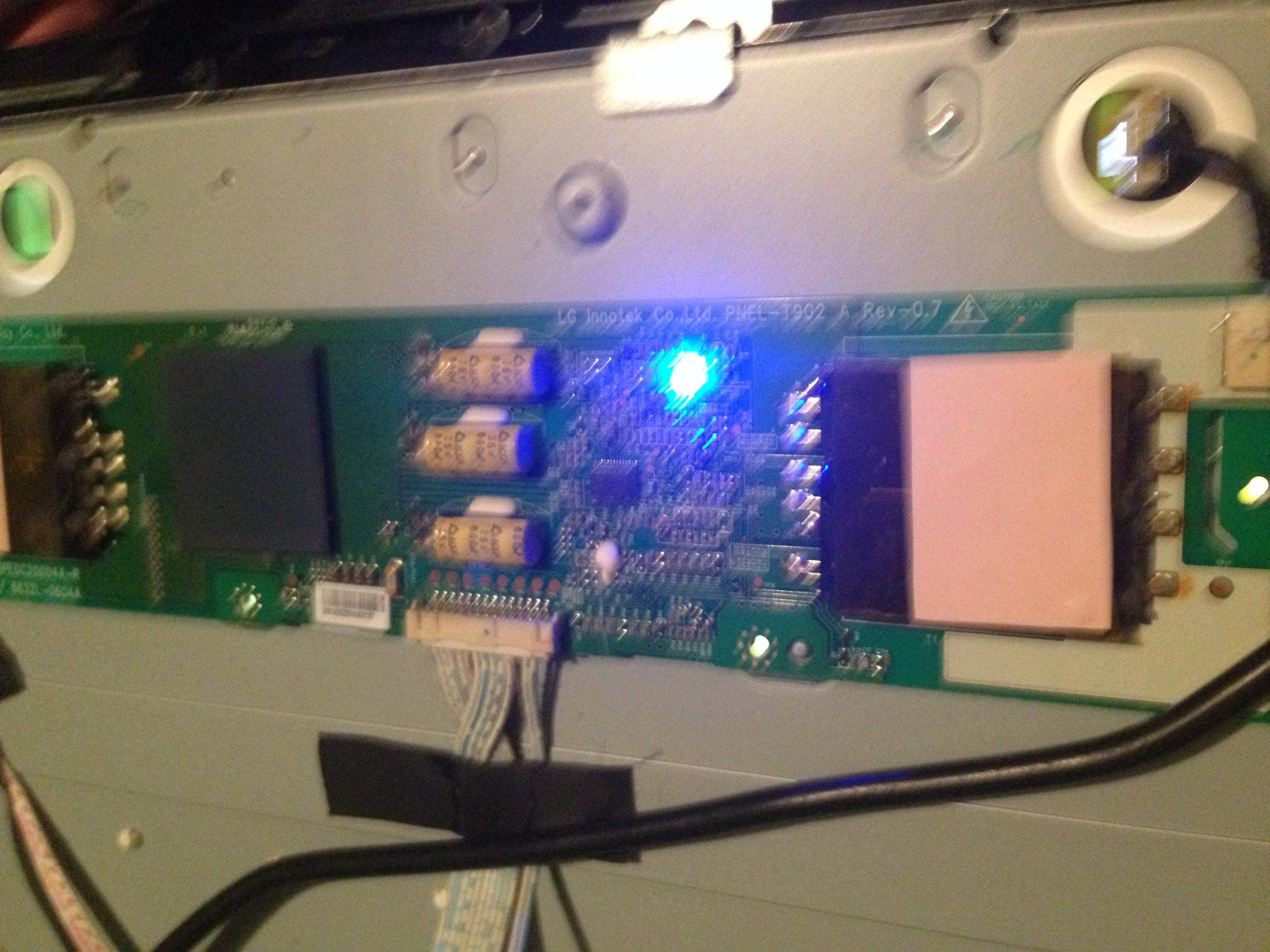

                        #51
                        Just looked at the inverter board,tested a fuse similar like on the tcon,states near the fuse 15a/65v,I got a reading at 23.5v ? when the tv is switched on the tcon highlights a blue light,then goes off after one minute is this correct ?
                        • dick_barton
                          • Aug 2015
                          • 6642
                          • Wales
                          #52
                          Those are all pictures of the inverter which you have already said is working?
                          • LEEDASH
                            • Dec 2012
                            • 481
                            • Bedfordshire
                            #53
                            does it control the backlights ?
                            • dick_barton
                              • Aug 2015
                              • 6642
                              • Wales
                              #54
                              Yes, that is the circuitry that switches on the backlights
