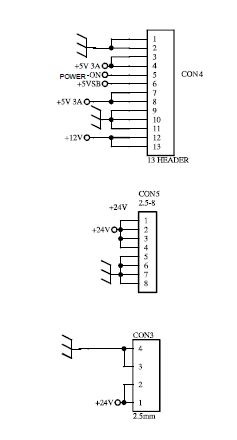

          Re: baird 42 no picture
          Do you have the following voltages:-
          Con4
          Pins 3, 4 = 5V
          Pin 5 = Power _On
          Pin6 = 5Vstb
          Pins 12 & 13 = 12V
          Con3 & Con 5 = 24V

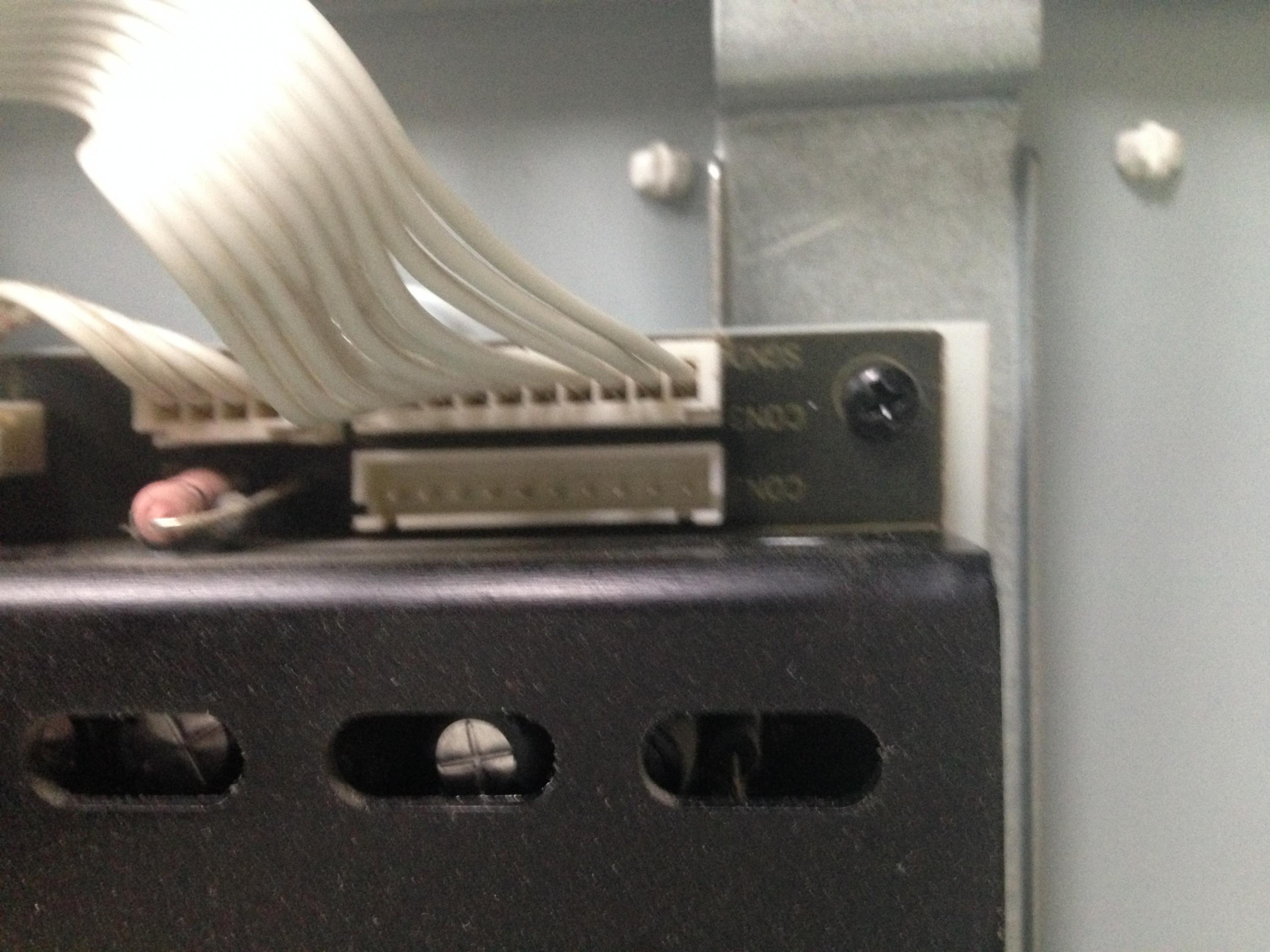

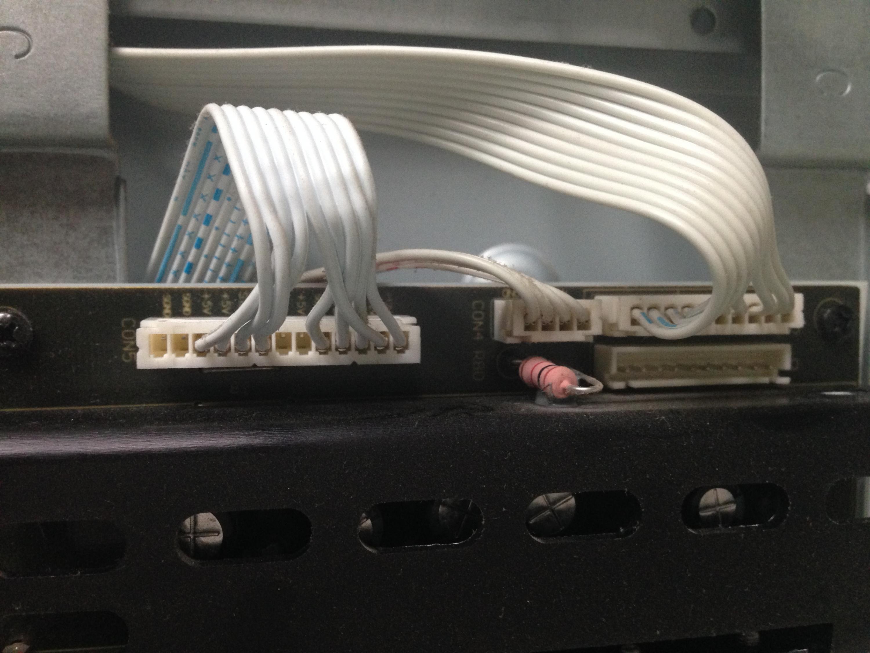

                  Can you post a well focused photo of the edge connectors and any printed labels alongside them.
                  This is MLT668 Rev1.5

                      #30
                      So alongside each connector pin there's a legend.
                      Can you measure the voltage on each wire and compare it to what is written alongside
                      Example
                      Legend Name = Reading
                      GND = 0V
                      +5V = xxxxV
                      5VSBY = xxxxV
                      12V = xxxxV
                      24V = xxxxxV
                      etc
                        yes can do,before i start do i set dc to 200 ? as reading higher than 20v on multi,ground the black and read from the red,placed inside connector with connecting block still connected,if you understnad what im talking about,
                        does the tv set have to be switch on or standby ?
                        • dick_barton
                          • Aug 2015
                          • 6642
                          • Wales
                          #32
                          You can set your meter to 200V dc if you want to. Place the black meter lead on metal panel and the red lead to connector pins.
                          Again do the check in standby and then out of standby.
                            standby
                            +12v zero
                            +12 zero
                            sdnd no reading
                            +5 0.68
                            +5 0.68
                            stb 0.1
                            5vsb 5.04
                            con 4
                            24v 0.07
                            24v 0.07
                            sgnd zero
                            sgnd zero
                            switched on.....
                            con 4
                            24v both 23.6
                            sgnd zero
                            con5
                            +12v 11.8
                            +12v 11.8
                            sgnd all three zero reading
                            5vsb 04.9
                            stb 01.9
                            +5v 04.9
                            +5v 01.9
                              Originally posted by LEEDASH
                              standby
                              +12v zero
                              +12 zero
                              sdnd no reading
                              +5 0.68
                              +5 0.68
                              stb 0.1
                              5vsb 5.04
                              con 4
                              24v 0.07
                              24v 0.07
                              sgnd zero
                              sgnd zero
                              switched on.....
                              con 4
                              24v both 23.6
                              sgnd zero
                              con5
                              +12v 11.8
                              +12v 11.8
                              5vsb 04.9
                              stb 01.9
                              +5v 04.9
                              +5v 01.9
                              Those voltages all appear to be fine except for the last one??
                                      Is there a cable at that location and are you are saying it reads 1.9V and not 5V which is written alongside? Where does the cable go? The power supply provides power to other circuit boards so it's an normally an output not an input.
                                      • LEEDASH
                                        • Dec 2012
                                        • 481
                                        • Bedfordshire
                                        #39
                                        selected 20v on multi,the 5v are reading 5v the 'stb is 2.01,
                                        • dick_barton
                                          • Aug 2015
                                          • 6642
                                          • Wales
                                          #40
                                          So it now looks as though you have all the voltages and power to the backlights and Tcon board.
                                          I don't know what else to suggest. It may be an EEPROM problem which are available from:-
                                          http://www.ohmsupplies.co.uk/BAIRD-C...-PREPROGRAMMED
                                          But perhaps better to wait to see what others on the forum suggest.
                                          Can you hear sound when connected say to a DVD player?
