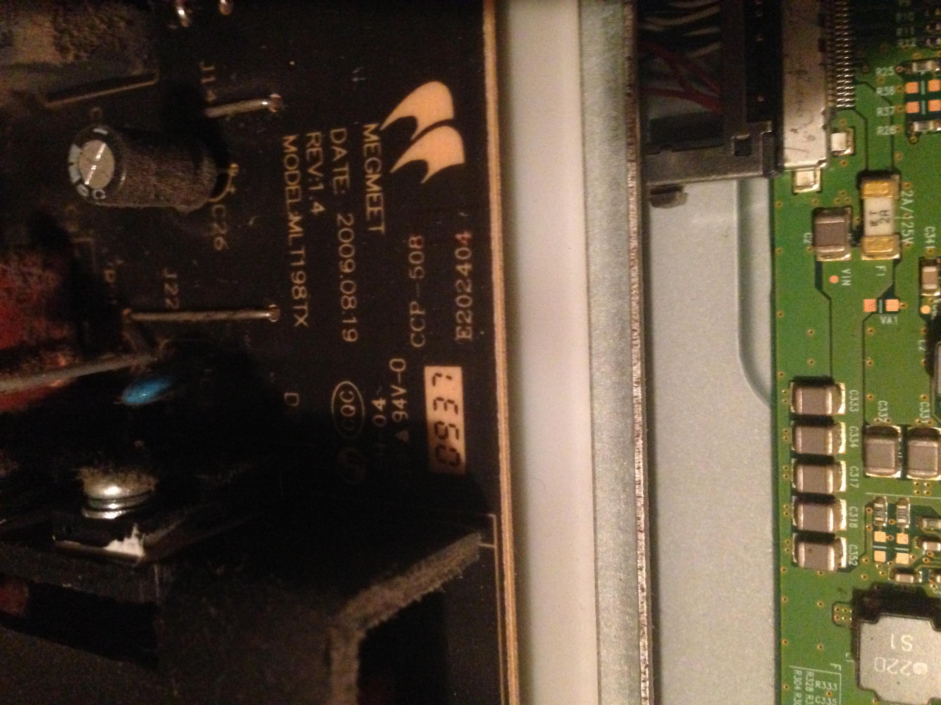

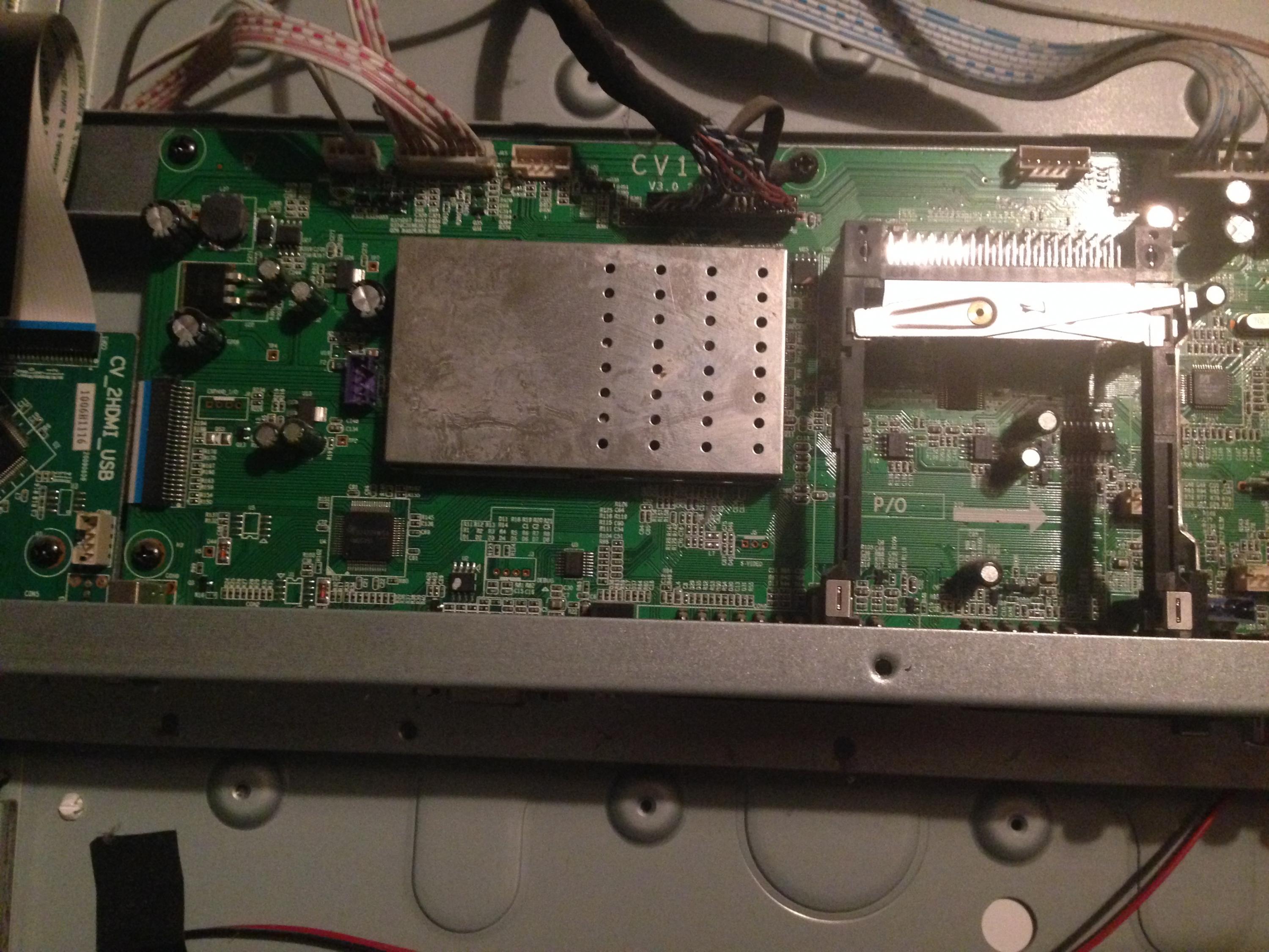

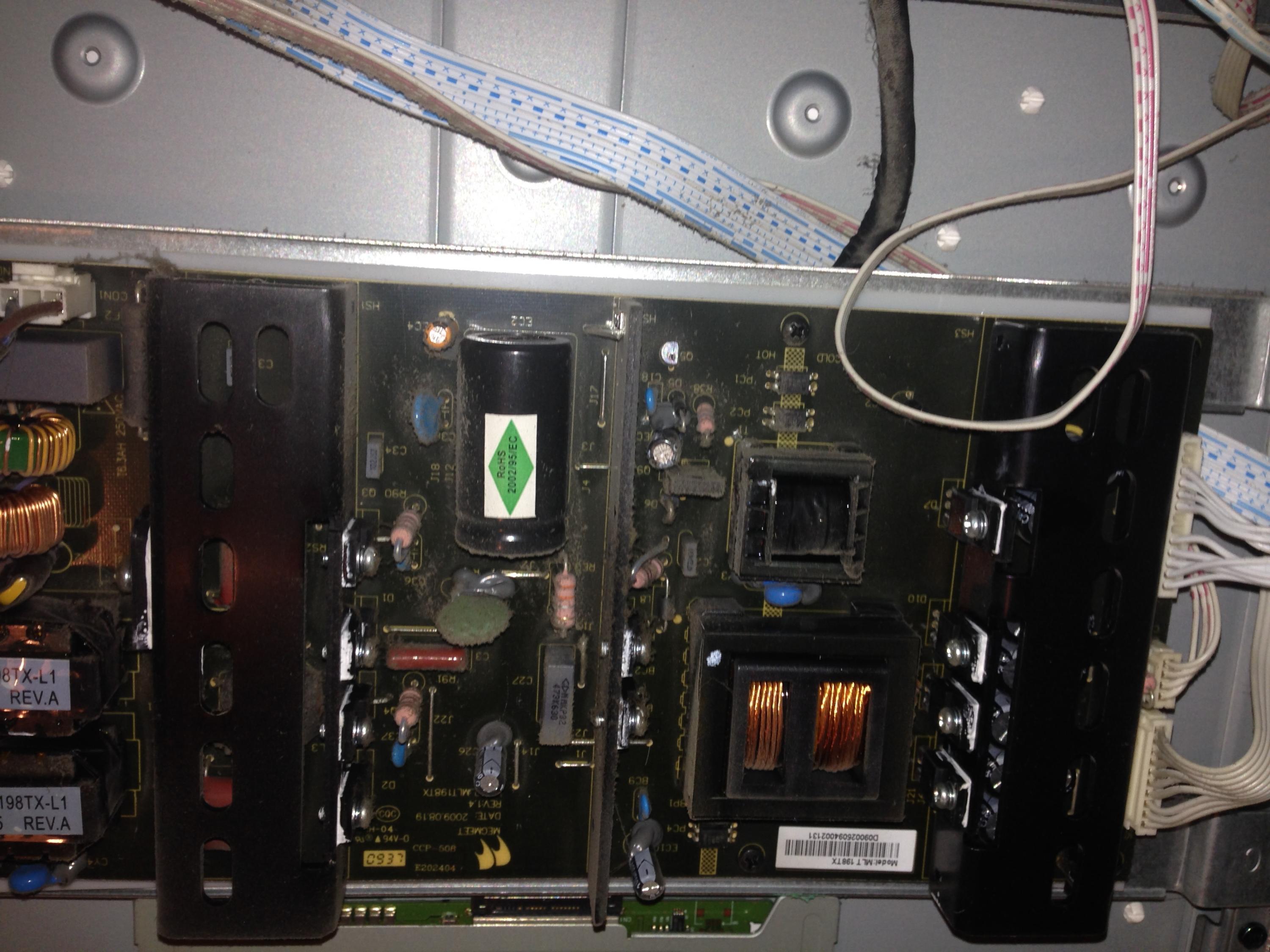

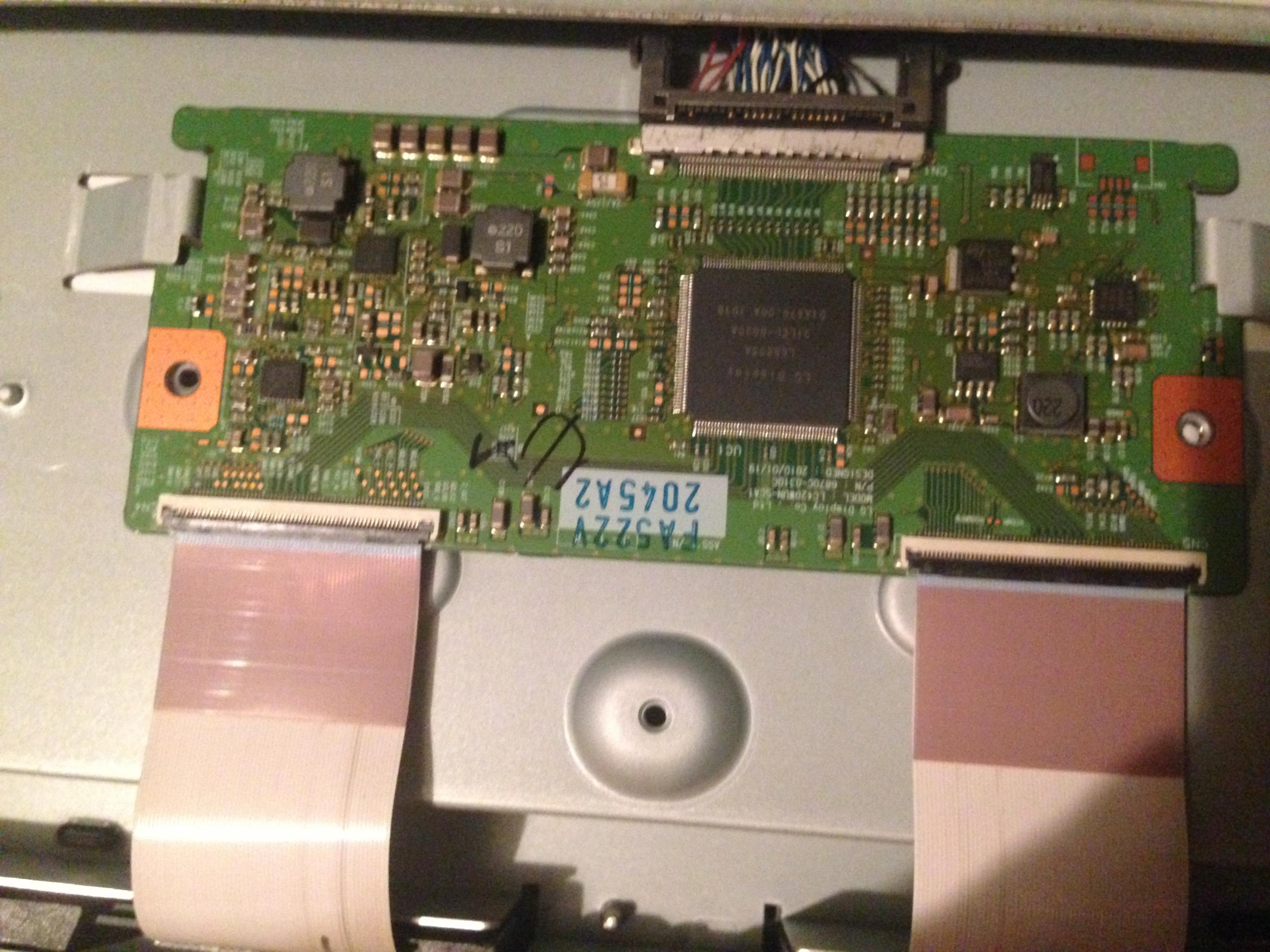

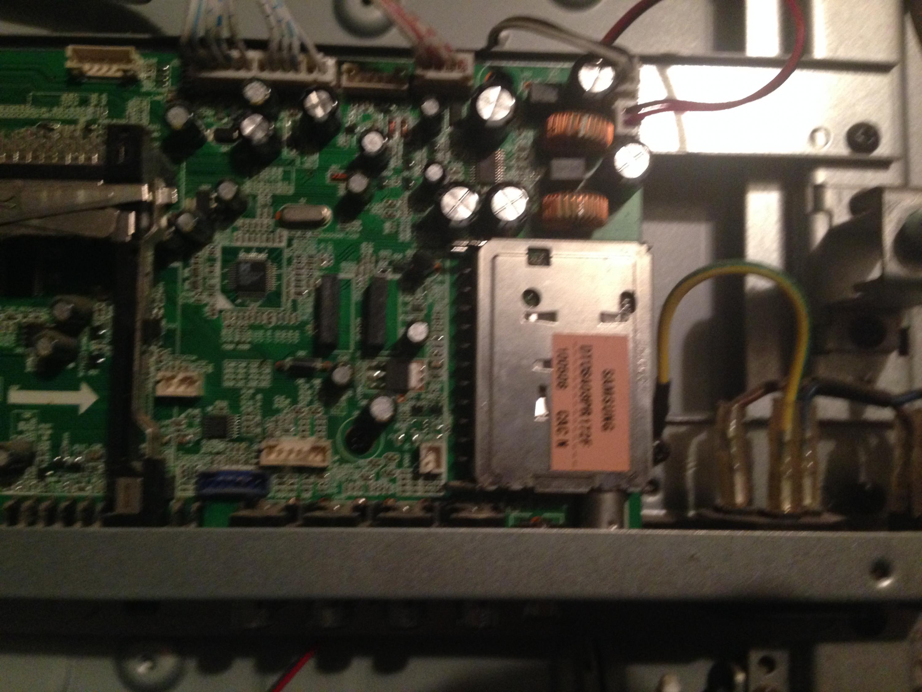

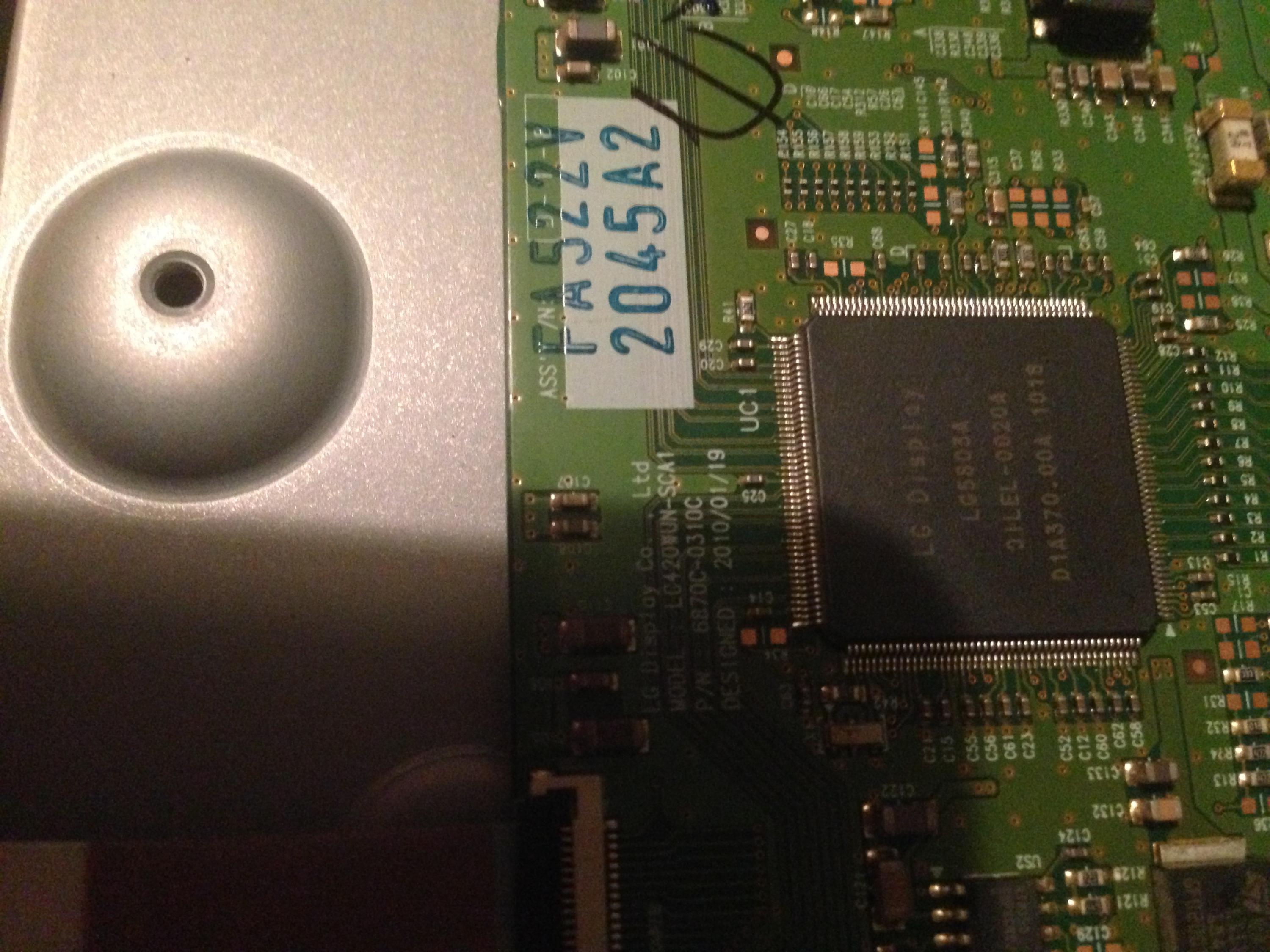

    Hello forum,may i have some assistance,I have a baird 42 inch tv,unsure on model number,It has developed a fault it switches on has sound running through hdmi source also,but show not pure black but slightly greyish white screen,the led lights are working at the rear of the tv,I have opened the back not dicoloured parts or bulging caps,board number mlt168tx and the board with hdmi and so fourth is cv109h.
    could it be the tcon board at fault?

    Posting pictures of the back of your tv showing the boards with clear pictures may help you more with fixing your problem

      Picture would be a good start.

            what happens if you dissconnect one of the top t con ribbons cables and turn the tv on? try it on both sides and see if theres a difference.

              Re: baird 42 no picture
              try one then the other ? or both at same time
              • vinceroger69
                • Mar 2012
                • 6714
                • uk
                sorry try one then the other
                Edit do the test dick_barton suggest s first to confirm you have votage to the t con board

                  Check what DC voltage you have between chassis (using the black meter lead) and each side of the white ceramic fuse (using red meter lead).

                        on the t con just above the lvds cable connector on the right there a fuse there check dc voltage each side of the fuse

                              yes tv turned on meter set to dc volts black probe on tv metal chassis and test each side of the fuse.

                                  5v or 12v depends on panel used i think.

                                    The tcon is reading 11.94 ?
                                    • dick_barton
                                      • Aug 2015
                                      • 6643
                                      • Wales
                                      I assume you mean 11.94 volts and is that on both sides of the fuse?
