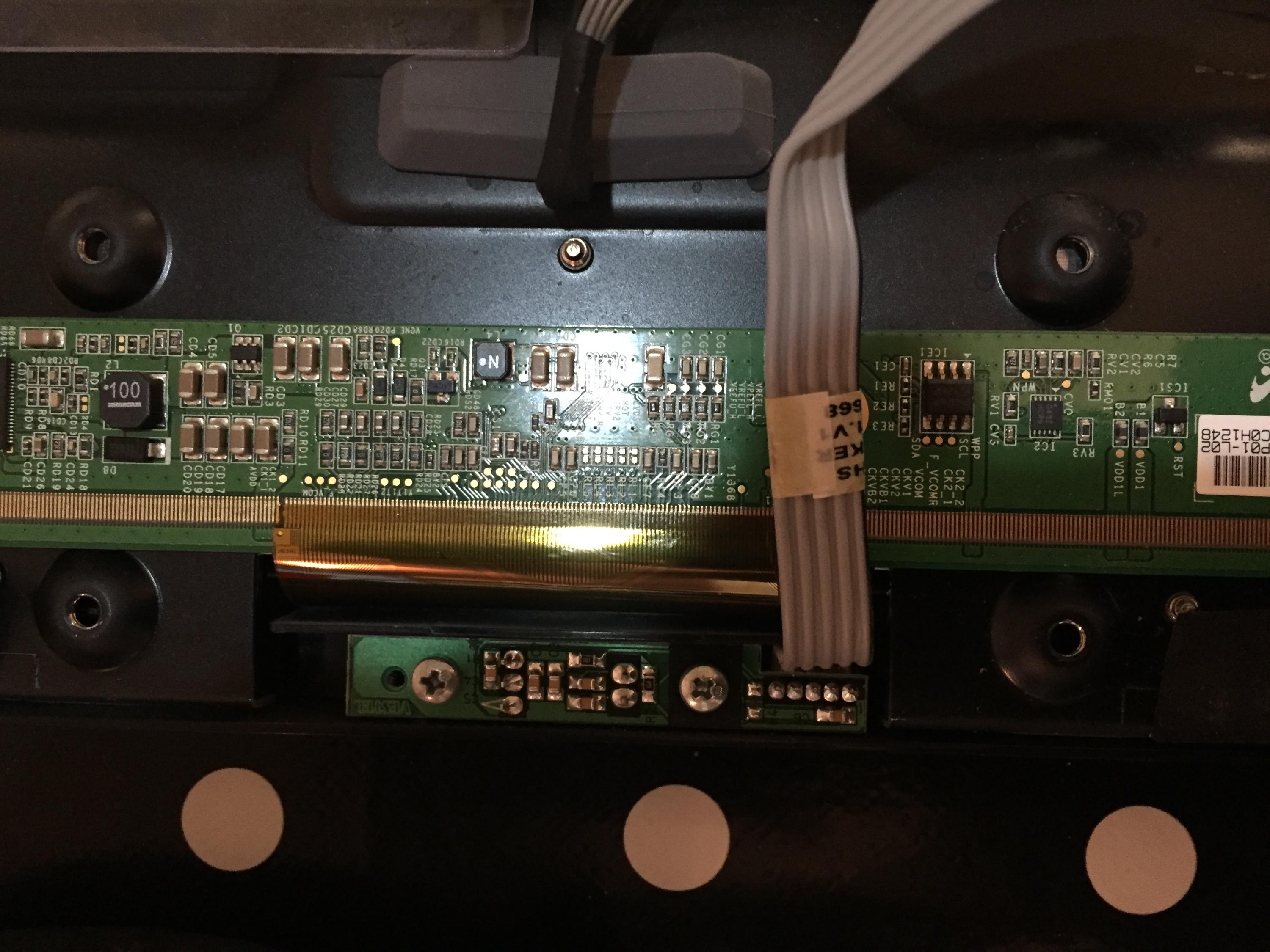

    As the title says, no pic,
    tv turns on, back light/led's come on and stay on, tv responds to remote, but nothing on screen, led's are flickering,
    first thought is main board, tryed removing LVDS cable at both ends, cleaning and reseating, no change, but if i remove one end from main board or control board, the led's no longer flicker, so now thinking control board, but its one of those that is part of the screen, anyway, checked fuse, all good, made sure cables are connected, and removed the cover plate. turned the tv on to take some volt readings, but within a min, i found 3 SMD caps that was so hot to touch, they would burn your skin,
    so my question is, i cant find any markings on the caps to replace them, so now what, and also would this be the cause of no pic, or is that down to the main board.

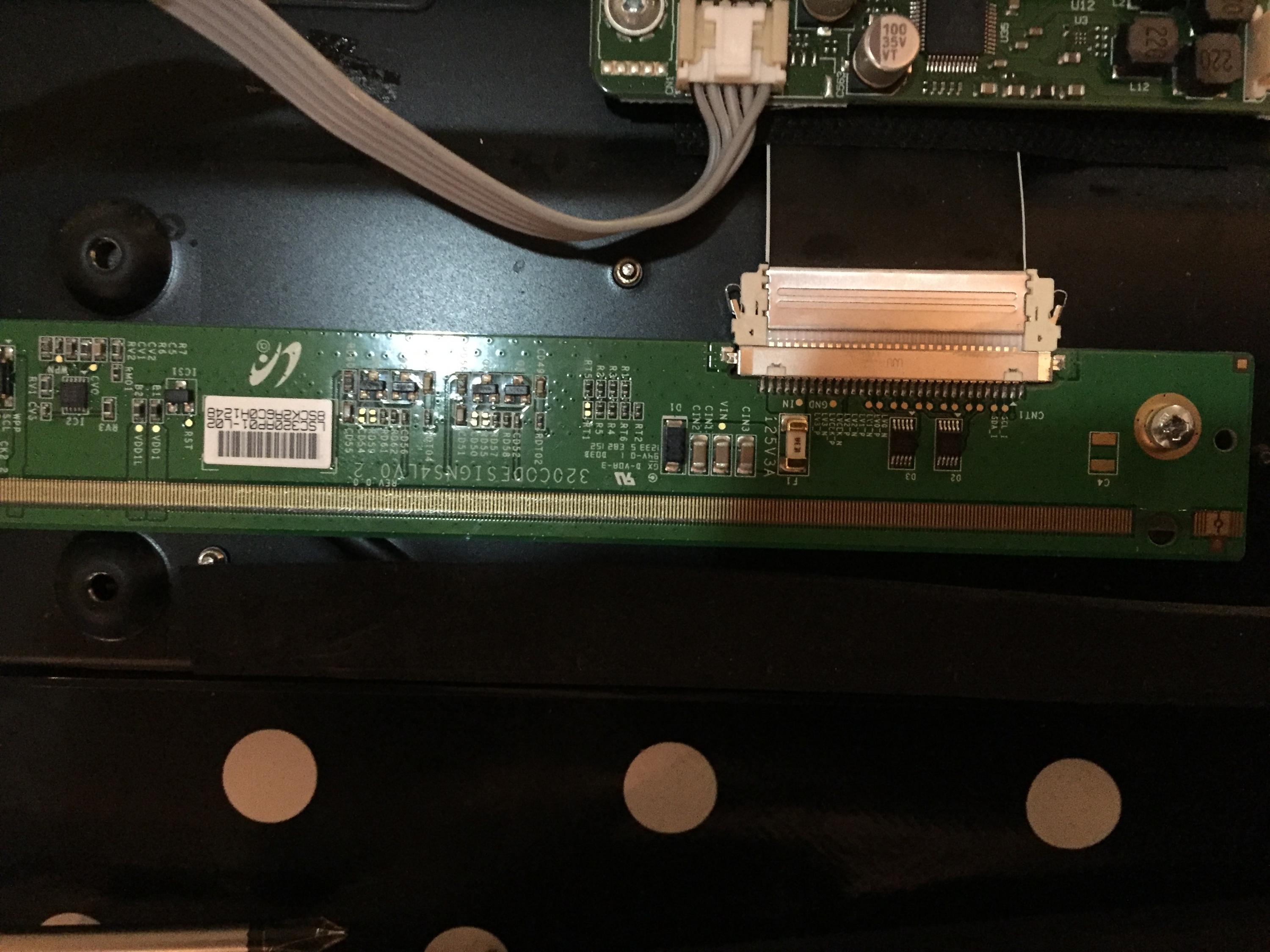

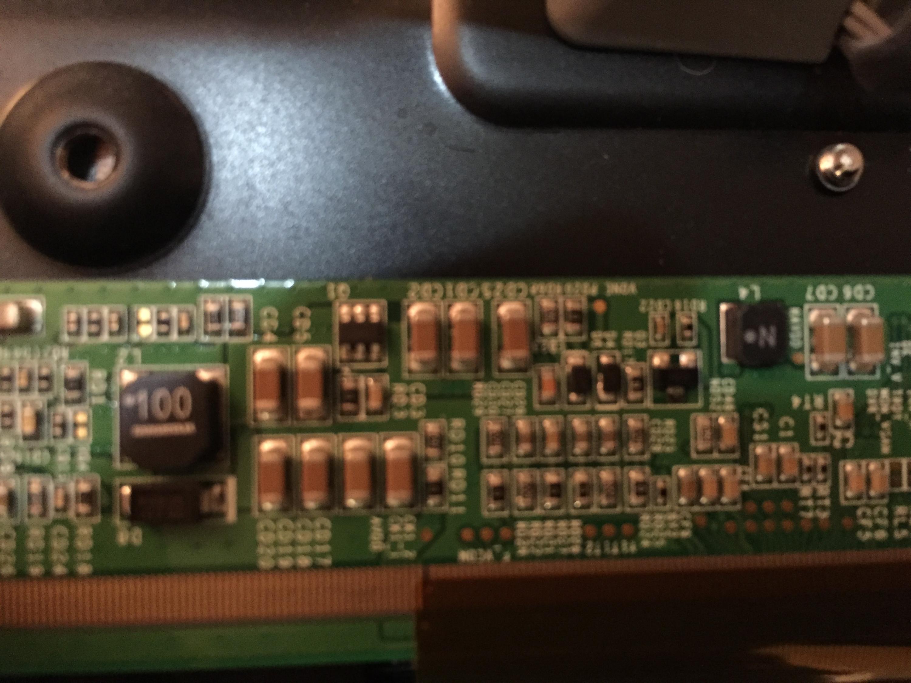

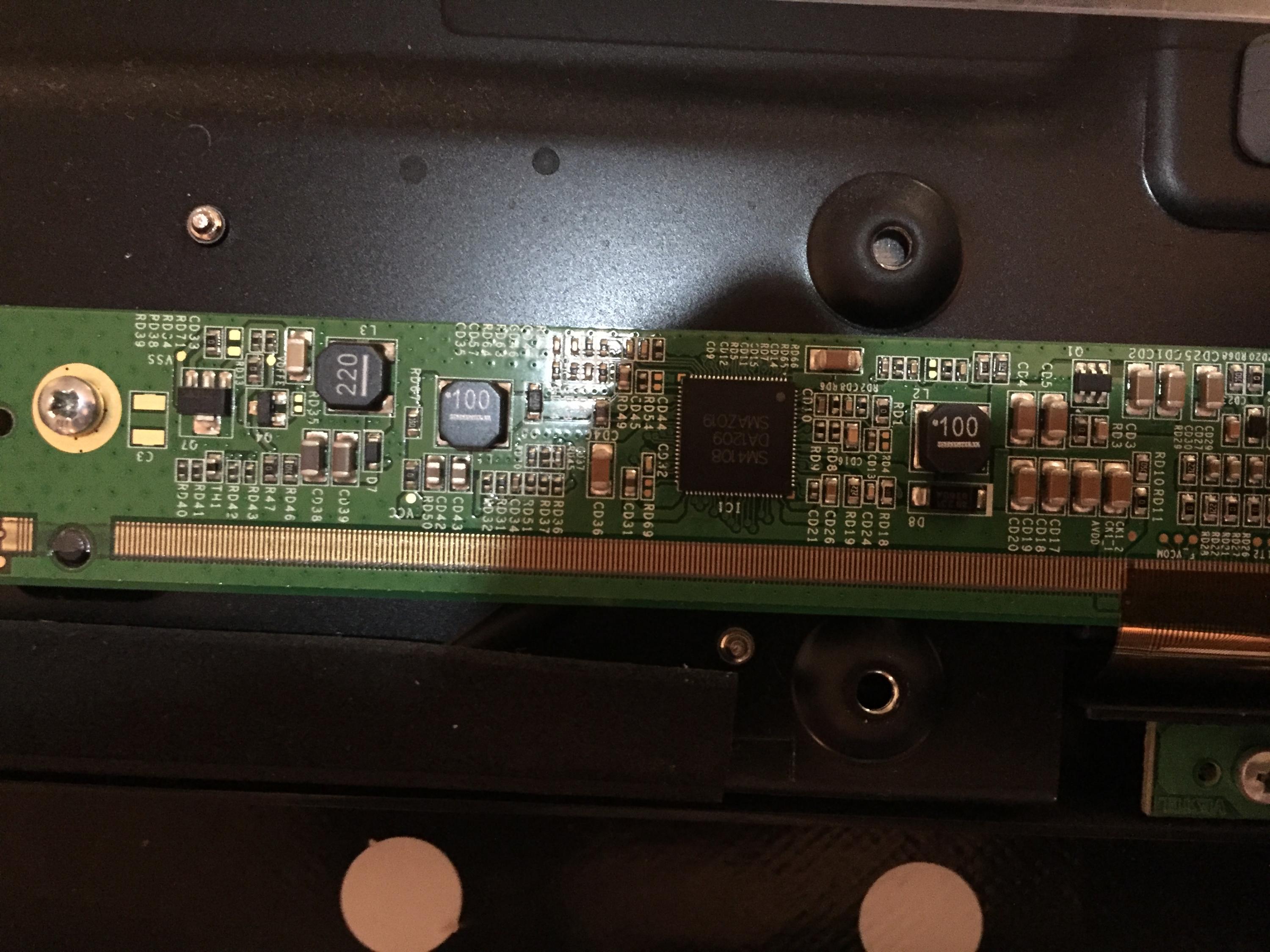

    Which caps in the pictures? Are they connected in parallel? They show low resistance on all three when tested off the board?

      last pic, its the top 3 together, i have had a play with it and found the 3rd one of the 3 is short, and removed to make sure, im now going to take a good one of, and see what the reading is, and dig out some old t-cons and see if i can find one to match,
      i did try the tv while the bad cap was removed and there is no more screen flicker, but still no picture.

        UPDATE, tv now repaired, just replacing the one shorted cap, has now sorted both problems, no picture and flashing led's, job done.
        readings i was getting from good caps was 9.23nf just in case anybody else has the same problem, and they read the same in or out of circuit.
