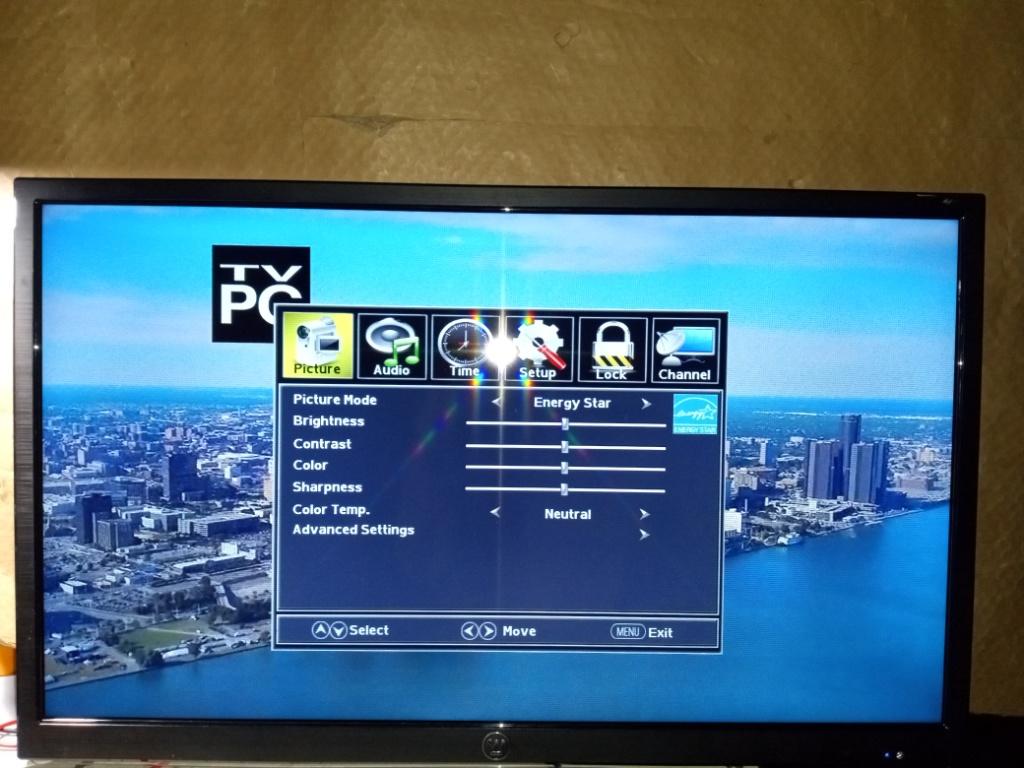

                                Re: Eeprom dump thread!
                                I need bin file for TV Westinghouse Model: DWM32H1G1 using chip MSD3393LUM, attached is the broken bin file, Thanks
                                • lotas
                                  • Jan 2016
                                  • 4831
                                  • Russia
                                  #1416
                                  What is the motherboard number?
                                  • luzmina
                                    • May 2015
                                    • 17
                                    • US
                                    #1417
                                    St3393lup-a1h
                                    • lotas
                                      • Jan 2016
                                      • 4831
                                      • Russia
                                      #1418
                                      Try.
                                      • luzmina
                                        • May 2015
                                        • 17
                                        • US
                                        #1419
                                        You Fixed it!!! I downloaded the EEPROM bin like 50 times, with freeze and without, always get the same CHKSUM, so it was heavy corrupted. Attached is a picture of the TV working, all menus work fine and the sound too, Thanks
                                        • lotas
                                          • Jan 2016
                                          • 4831
                                          • Russia
                                          #1420
                                          Ok., Yes, your dump was badly damaged.
