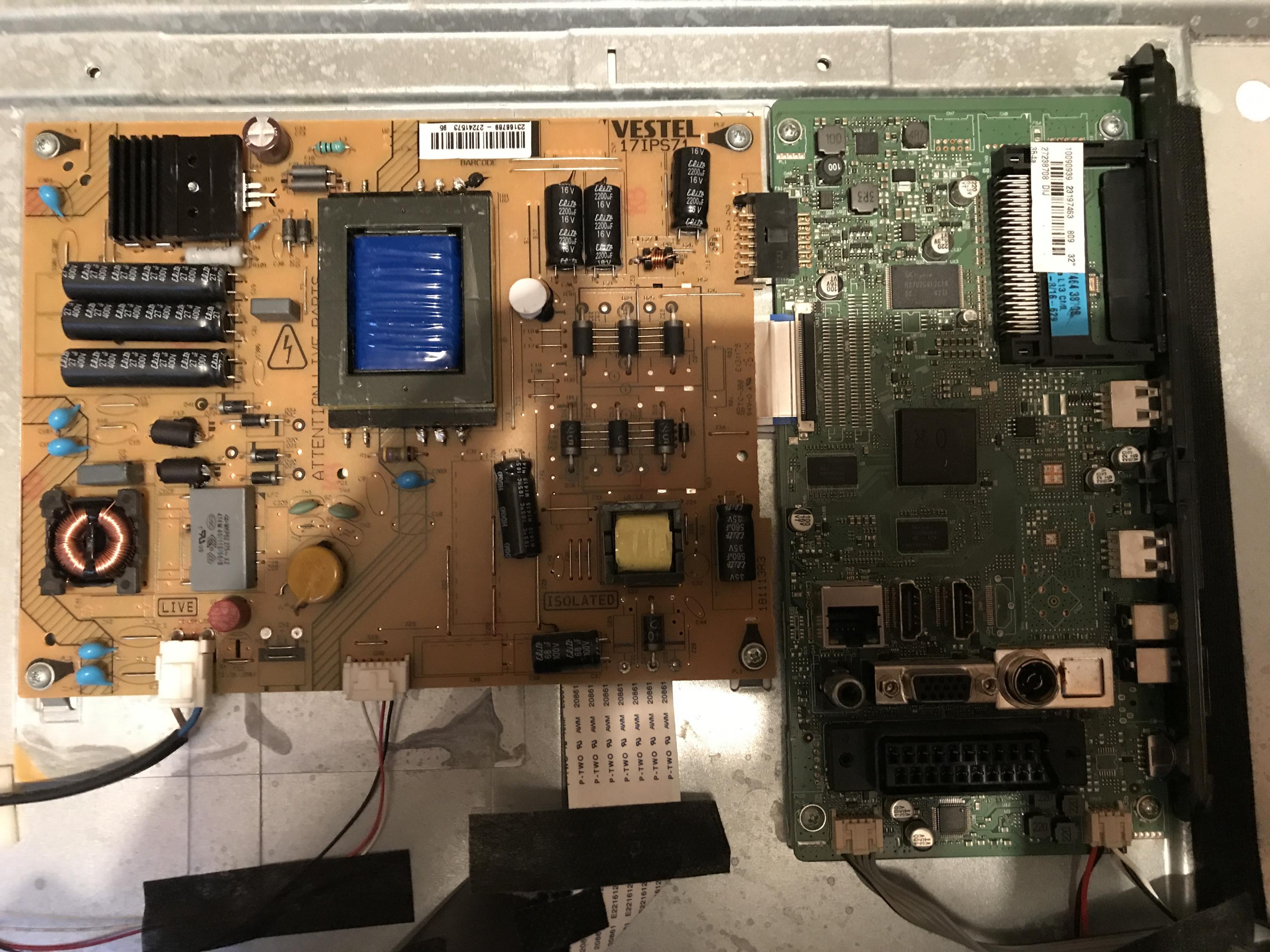

                            • antas
                              • Jul 2014
                              • 148
                              • Ireland
                              #334
                              Re: Eeprom dump thread!
                              Hi, guys.
                              I have Hitachi 32HYT46U with the problem random switching. Turn on, can see Hitachi logo and turns off then. And the same again. I think that reprogramming of U10 would resolve this problem. If anyone, you guys, have a right bin file, please share with me.
                              Thank you in advance.

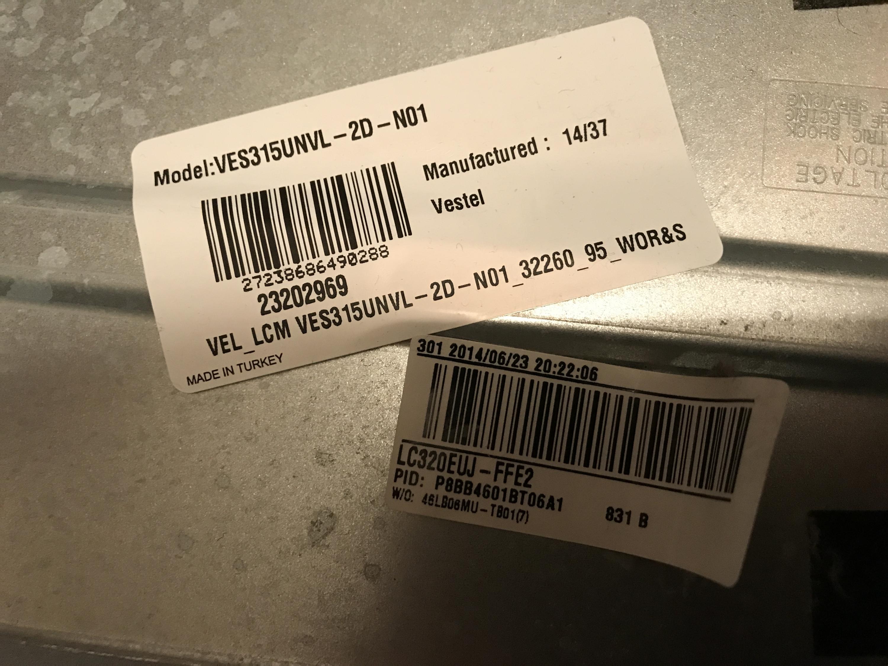

                                • antas
                                  • Jul 2014
                                  • 148
                                  • Ireland
                                  #336
                                  Main is: 17MB95M vestel
                                  Main board: Vestel 17MB95M
                                  Power board: Vestel 17IPS71
                                  Panel: LC320EUJ-FFE2

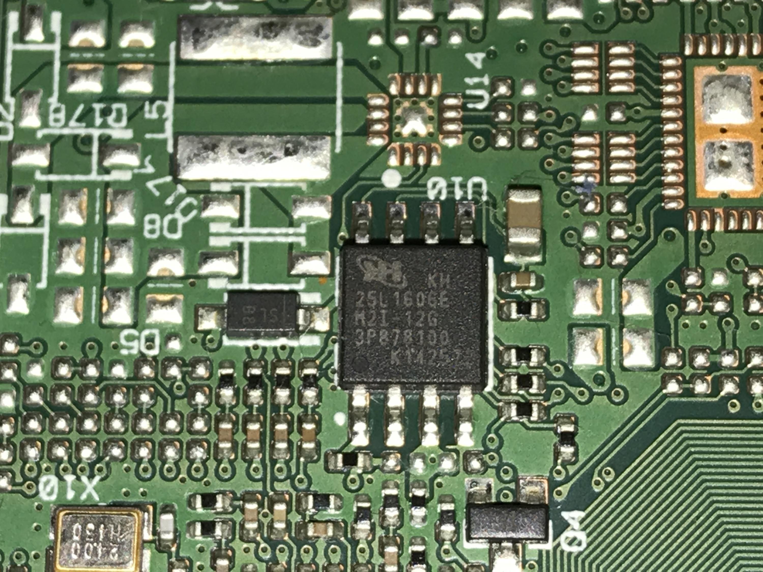

                                  • dani502017
                                    Banned
                                    • Sep 2017
                                    • 85
                                    • Romania
                                    #337
                                    test with this to see if it starts, it's possible to be the trouble nand, do not forget to save the original U10 content
                                    • antas
                                      • Jul 2014
                                      • 148
                                      • Ireland
                                      #338
                                      Unfortunately, with this BIN, it doesn't start at all... The RED and BLUE lights blinking one by one. All the time. With original BIN it starts and shows Logo, then starts again and again.
                                      Any ideas?
