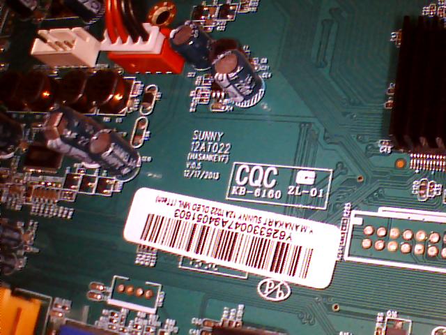

                          Sn032dld12at022-sm dump anolog modul uydusuz v.0.5
                          sunny dump file

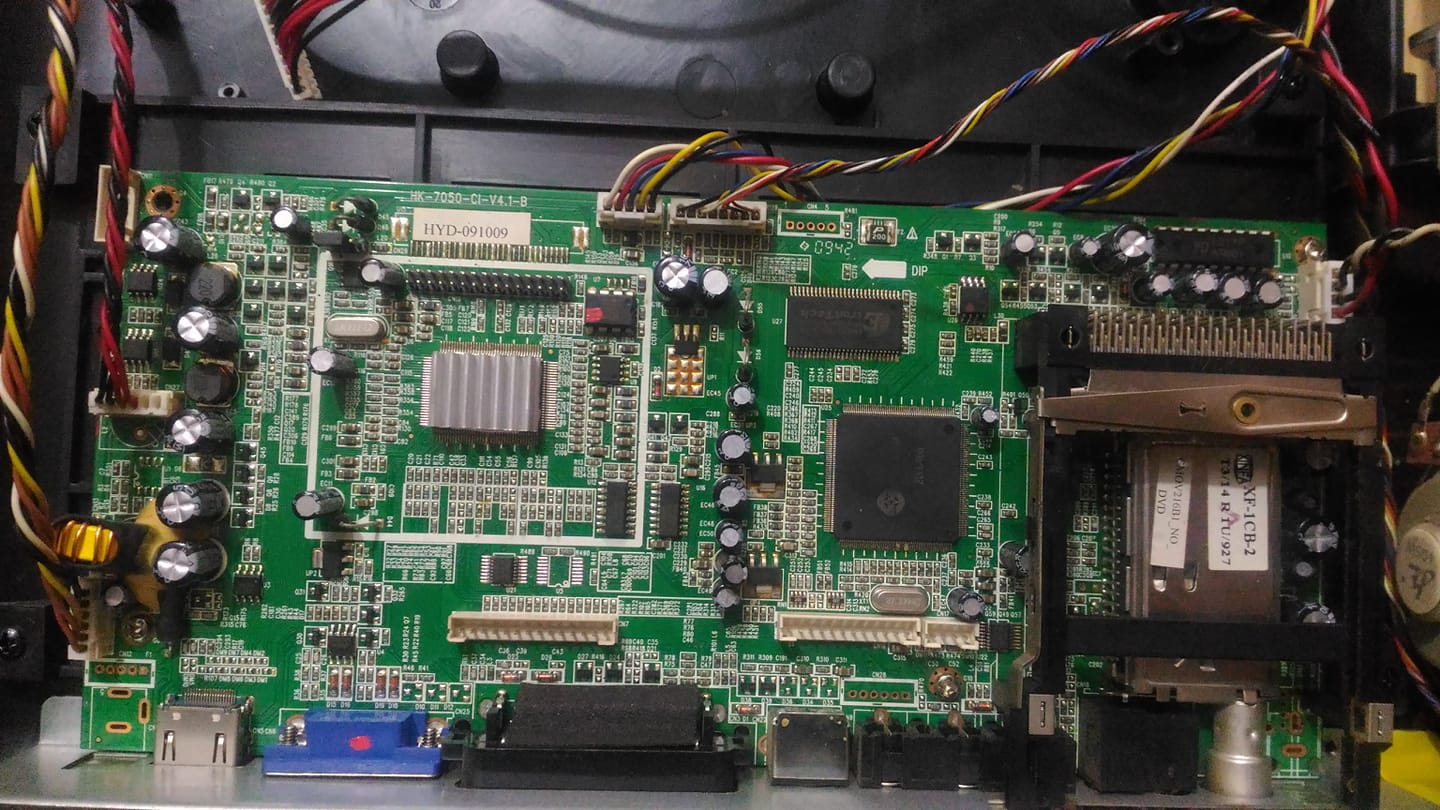

                            I-JOY idi22spb 05 V2
                            pl dump HK-7050-CI-V4.1-B
                            .I-JOY idi22spb 05 V2
                            • dani502017
                              Banned
                              • Sep 2017
                              • 85
                              • Romania
                              #454
                              Re: I-JOY idi22spb 05 V2
                              Try original dump for eeprom+spi
