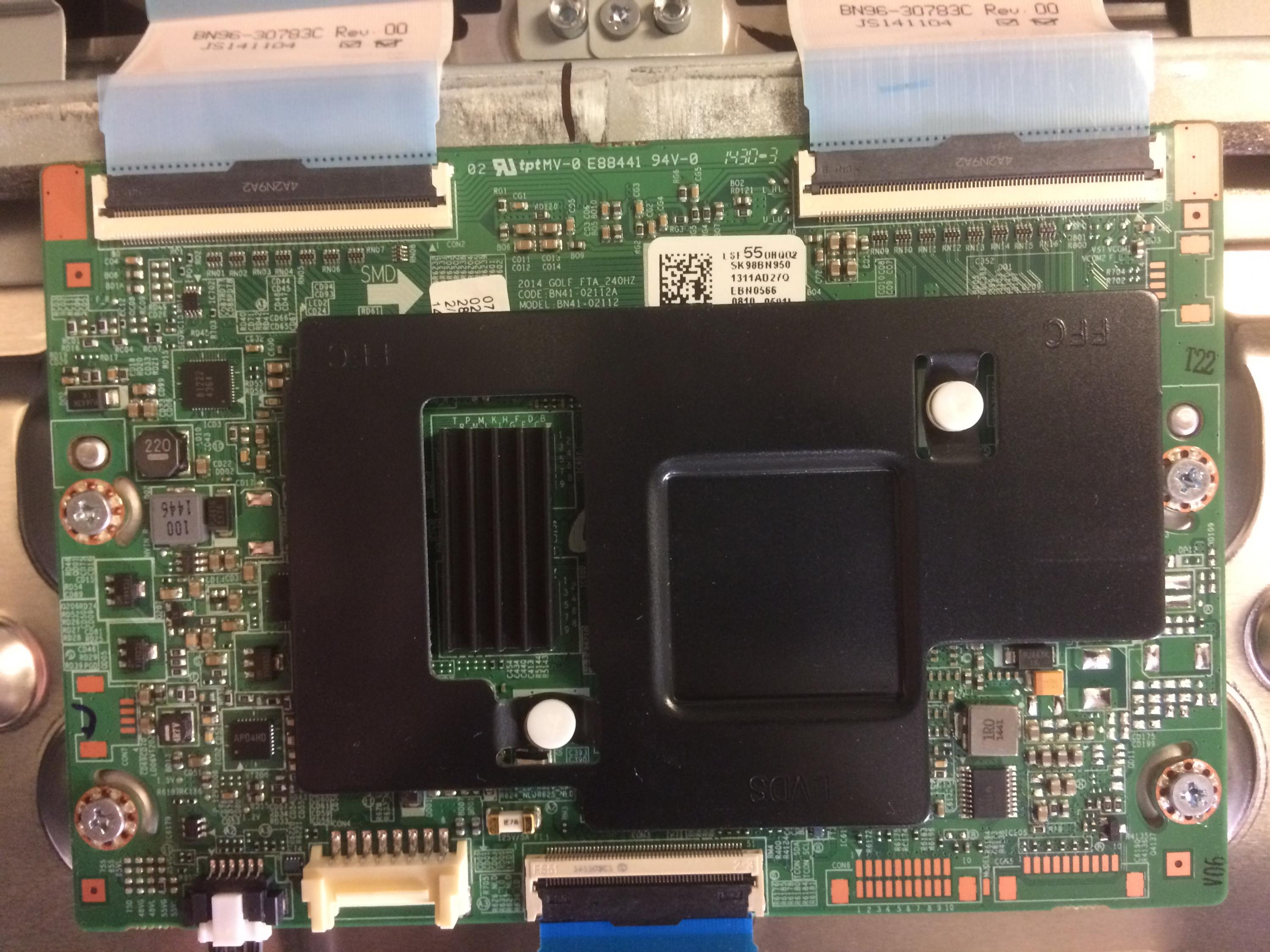

    I got this curved Samsung LED model UE55H8005 which does not show a picture, sound and functions OK.
    Upon start-up, backlight turns on for one second (but no picture shows)
    Some tests done:
    Disconnecting T-CON either flatcable or connection between T-CON and PSU, the backlight will be on continously.
    Obviously something on T-CON doesn't want the backlight on.
    BL-ON signal is high whenever set is turned on, but PWM1-3 goes to zero and backlight turns off as a result.
    Blue control leds on T-CON is on.
    Question is: Is this a bad T-CON ?

        They are PWM dimming controls, it has three control lines for Zone dimming based on the scene of the image..
        There is small connector on the T-CON board which I cannot clearly see, that connector may be used to control the zone dimming. Need closed up pictures of the T-CON (shopjimmy does not seem to have anything on this TV model).

                                    Hi guys, not much to tell at this point. But, mainboard send LVDS and PWM dimming info to T-CON and from a small connector on T-CON to PSU to control backlight dimming.
                                    If I disconnect this small connector, the backlight will be all on but still no picture whatsoever. It can either mean the mainboard doesn't send any picture data to T-CON or that T-CON is faulty.
                                    I would like to know if this T-CON can be put into testmode? (pattern generation or similair) then I could judge if the mainboard needs replacement or not.

                                      I need to be able to read the pin labels of the connector of the power supply board that goes to the main board and also to the T-CON small connector so I can see what the wires from the T-CON to the power supply board are..
                                        Re: Samsung curved UE55H8005 no picture
                                        Yes, budm, here's close up pics on both tcon and PSU.
                                        I turned it on again right now and fuse on tcon went and bad smell of nearby IC, so I think this case will be solved by changing tcon.
                                        PSU is BN44-00727A
                                        T-CON is BN95-01311A
