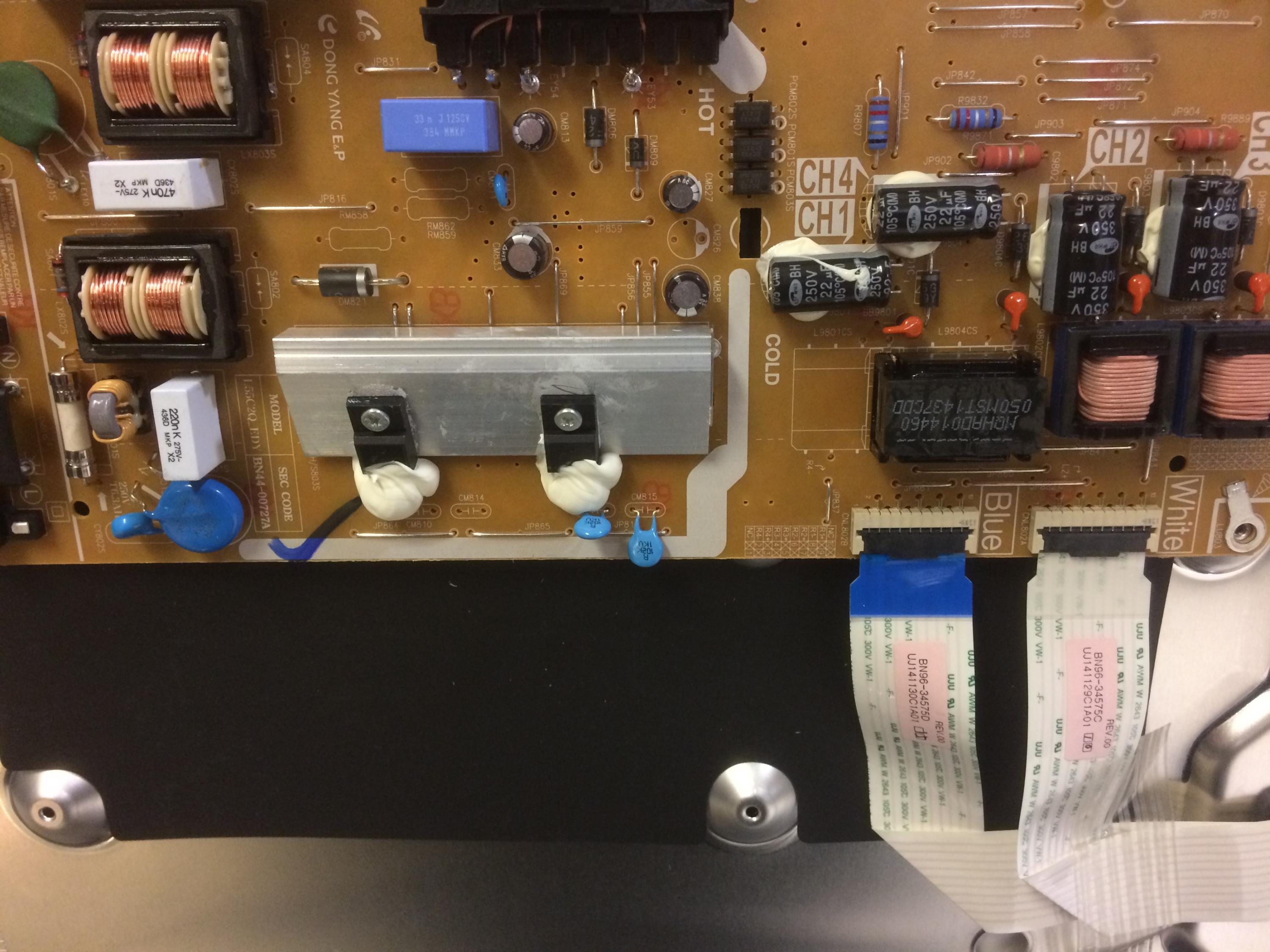

    I suspect it is T-CON as well, since the backlights are present when you disconnect the small cable from the T-CON but no image on the screen.
      Re: Samsung curved UE55H8005 no picture
      Hmm, shopjimmy does not have the pictures of you power supply board.
      https://www.badcaps.net/forum/attach...7&d=1485189009
      Can you zoom in on the that connector so I can read the pinout chart of the connector?
      I hope you do not have shorted panel.

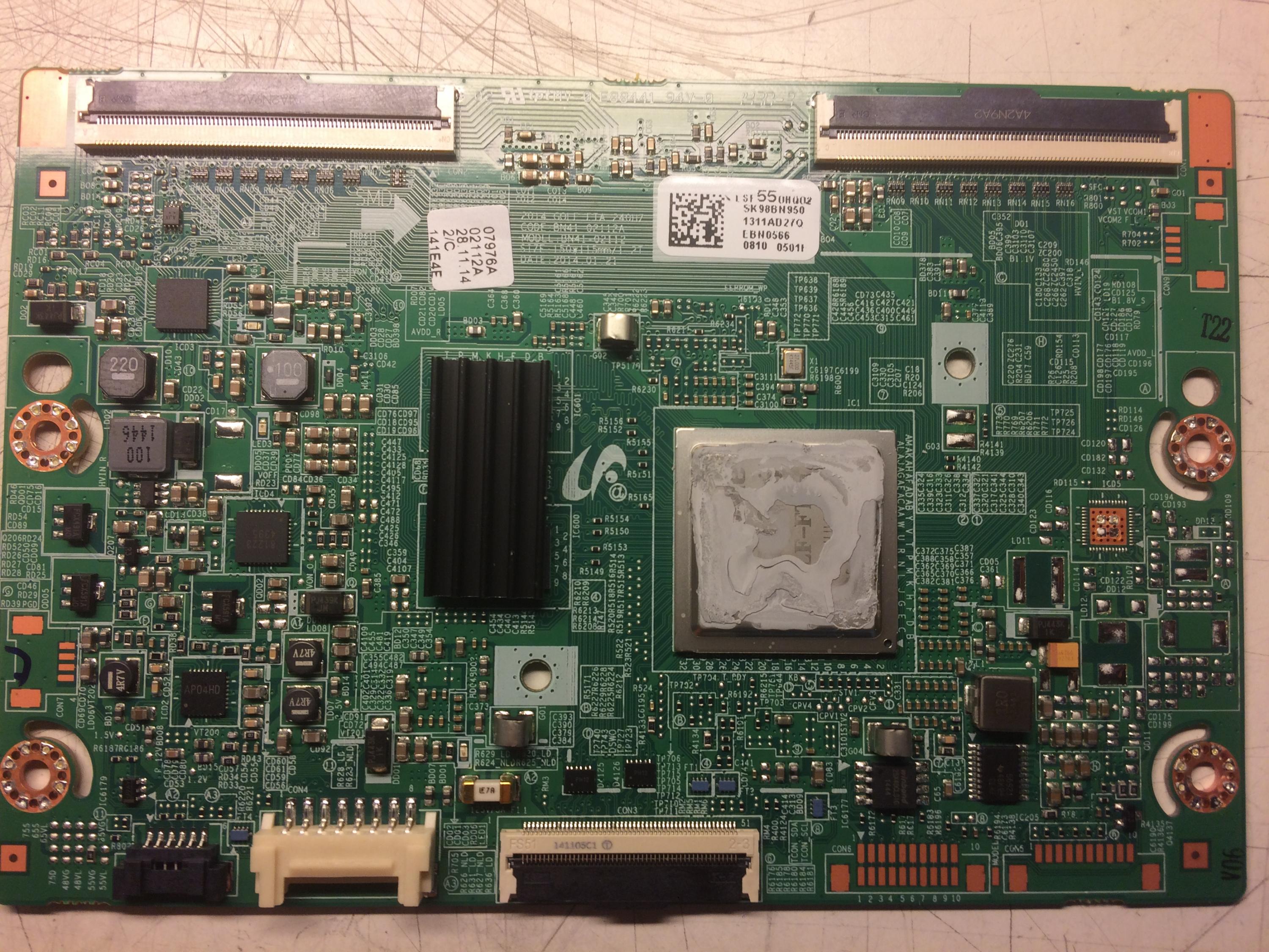

                              The training guide mention there should be 3 blue leds lighting if all OK on tcon. I am sure it was only 2 so I still suspect the tcon to be the main problem in this case. A new tcon will arrive soon.

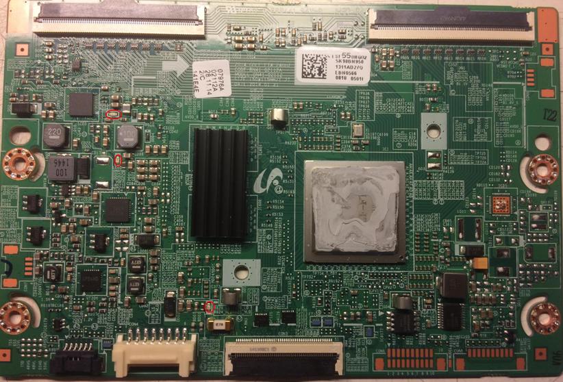

                                Close pictures of failed T-CON (no short can be found) and the PSU connector

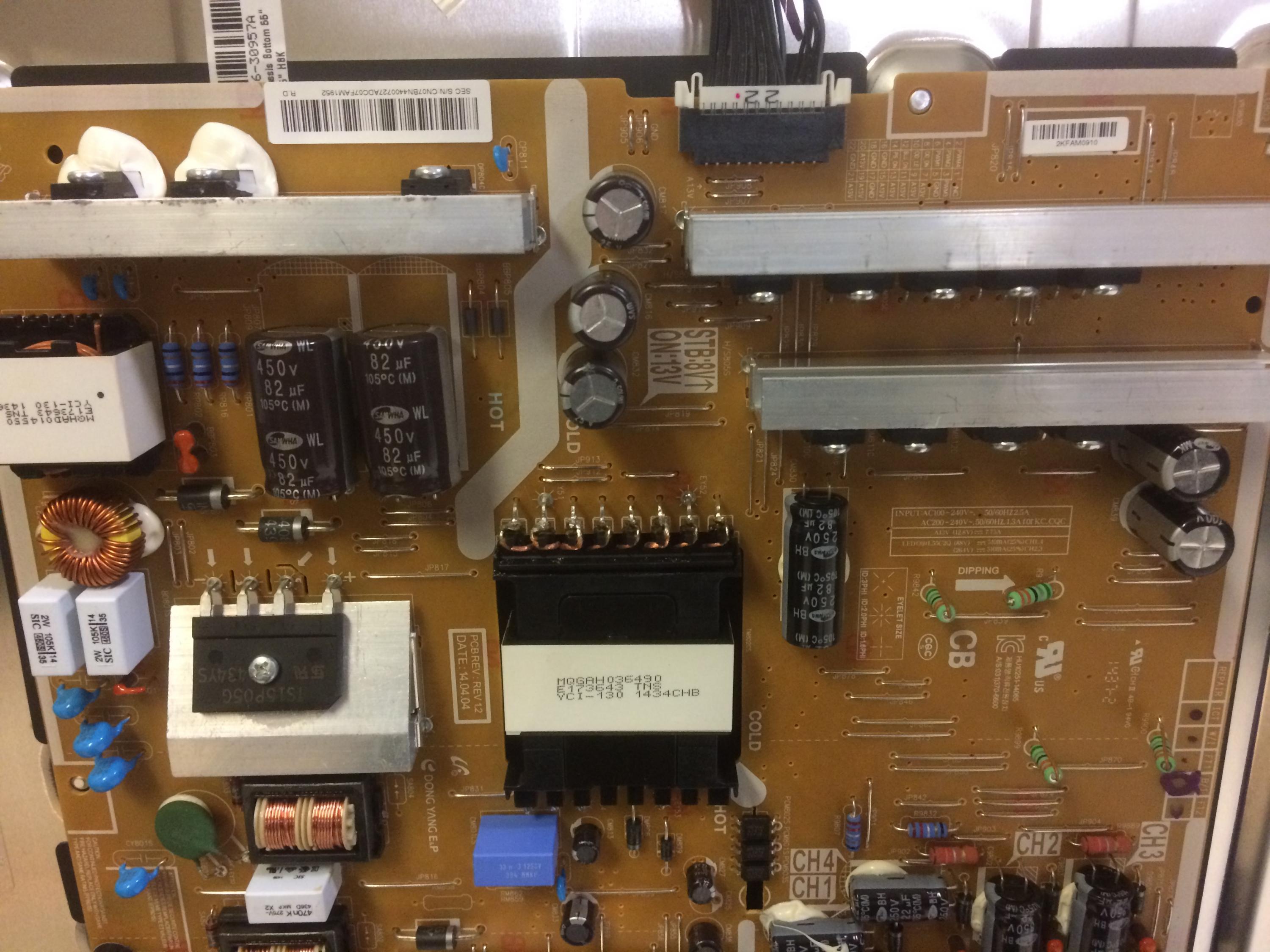

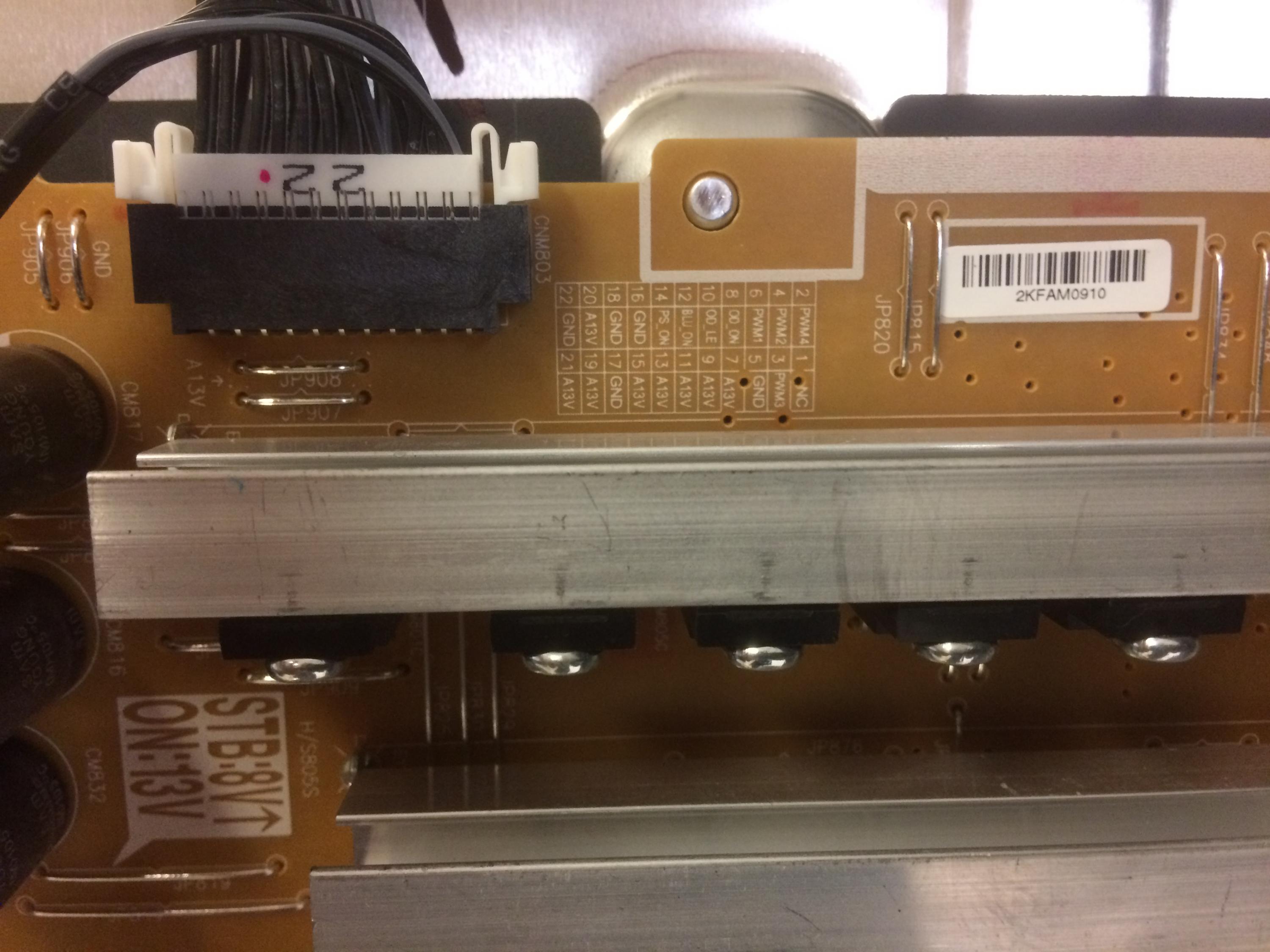

                                  So the six wires from the T-CON to the power supply board are connected to which pin on the power supply board?
                                  I see 4 PWM pins 2, 3, 4, 6.
                                  Since shopjimmy does not have good clear pictures of this power supply board, can you please provide the straight shot of top and bottom side of the board.
                                  So it looks like the T-CON sends the PWM control signals to the LED DRIVER driver circuit, the LED current return lines are not through the T-CON otherwise you will see POWER MOSFETs on the T-CON and it will be stupid design and the LED will not light up if the LED (-) return is on the T-CON, how can it light up when you disconnect that small connector on the T-CON.
                                  The PWM controlled MOSFET for the LED returns are on the power supply board, T-CON only sending the PWM signal for the active backlights control based on the scene of the images.
                                  That T-CON board is not cheap.

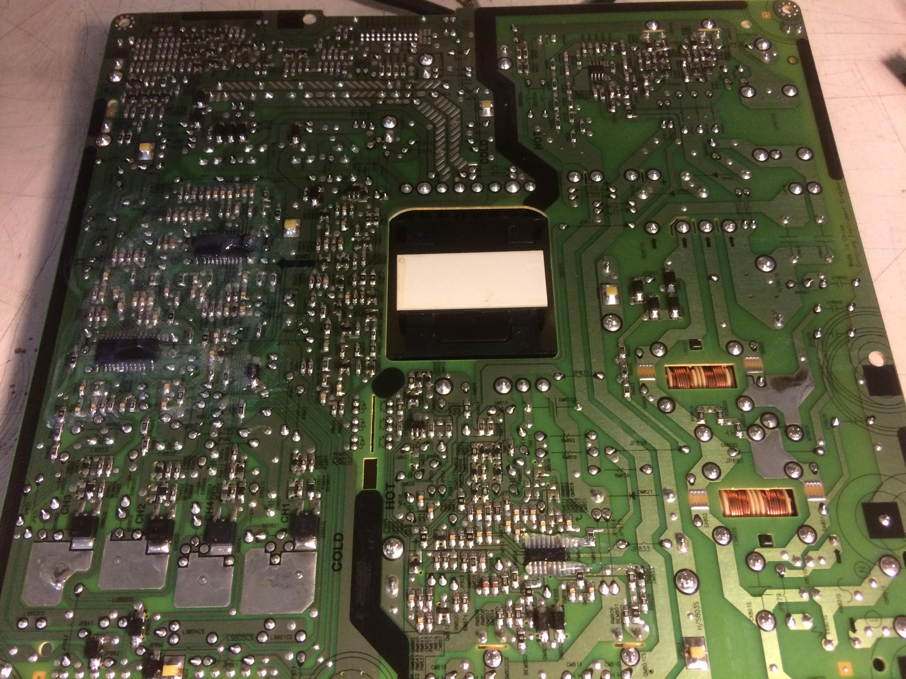

                                    The six wires contolling led pwm is connected to pin 1-6 on the psu connector. it's possible to see a bundle of 6 wires hanging away from the rest of the wires.
                                    Attached picture of top and bottom side of the PSU board.

                                      you have 3 LED on T-CON you said was only 2 ON. i think one was on near the Fuse and which one the other ?
                                      did you see the back side PWB cold area the 2 IC of backlight control got smoke so i can see from the photo !
                                      • PowerAmpFreak
                                        • 982
                                        • Sweden
                                        #39
                                        I can't recall which one of the two close blue leds on t-con was on. At least, the one close to the fuse was on.
                                        There's no smoke from the backlight control IC's, it's PCB coating to help for isolation!

                                          So today new T-CON arrived, but still no change.
                                          I tried to enter T-CON testmode (pattern generation) but does not show anything at all.
                                          Must then be bad panel...
                                          Still 2 leds only on T-CON (should be 3)
