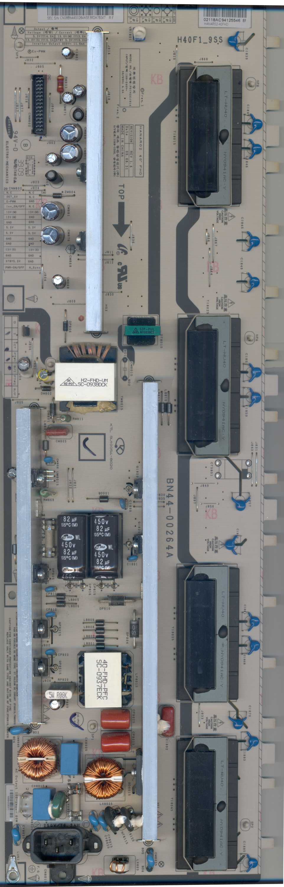

    Found this at the road side. As per the many threads regarding this power supply I replaced the bad fuse FM802S and bad MOSFETS QI820 and QI821. Hooked up the dim bulb tester with up to 425W of bulbs. The set has standby light. When turned on the startup chime plays then the LCD lights flash on and off continually as do the tester lights. The screen shows static and a weak signal message as it is on whatever it was when I picked it up.
    The capacitors across the replaced MOSFETS C1890 & C1891 show OL measuring their resistance when removed from board.
    Capacitor C1892 shows 456nF when removed from board.
    Main caps CP815 & CP816 show 162V with set off and 390V when turned on but fluctuates slightly down to 300V and back.
    CNM802 voltages when on and lights flashing
    PWR - ON/OFF 1.169
    STBY5.3V 5.15
    GND
    GND
    5.3V 5.13
    5.3V 5.13
    GND
    13V 12.77
    13V 12.77
    INV_ON/OFF 4.7
    E-PWM 4.23
    DET_5V 0-3.7-4.78 It stays at 4.78 for a moment the cycles through the voltages always staying on 4.78 for a moment
    None of the voltages change as if they are reacting in time with the flashing of the lights.
    Disconnecting the cable between the PSU/Inverter and the mainboard and plugging the TV in the light flashing begins without pressing the power button.
    Disconnecting the cable from the main board to the TCON has no effect on the situation.
    Disconnecting the FPCs from the TCON to the panel has no effect.
    The last attached file, LN40B500P3F.pdf is actually a video of the problem. As video is not a valid upload type you will have to download it and change its file extension to mp4 before you can play it.
    I don't know where to go from here. I have a feeling that using the dim bulb tester even with up to 425W of lightbulbs it is causing the issue but I am hesitant to try the set with out the dim bulb tester so as not to ruin what I just put in. So before I did anything foolish I thought I should check with the experts.
    What should I check next? Have you ever experienced this behavior?
    Your help is most appreciated. Thank You

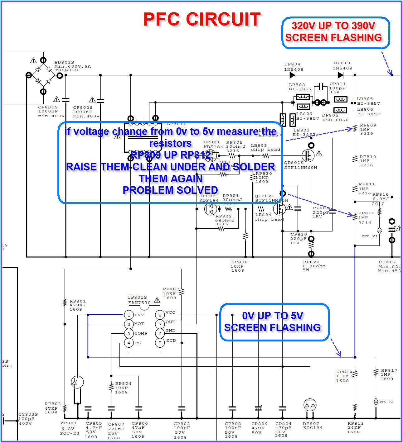

        Hi
        Imeet that fault the problem with the 4 resistors :
        1- change value (smaller)
        2- need to clean under them
        3- resolder them
        and I found that voltage to pin "INV' change from 0v up to 5v
        and pfc voltage change from 320v up to 390v .
        all finished after the 3 steps above .
        there is a pic here
        thanks

          check CI892 0.47uf 400v .. its at the side of one of the heat-sinks .

              I reflowed resistors RP809, RP810, RP811, RP812 which resulted in no change to the situation.

                did you test that resistor string mentioned earlier ? these are part of the repair kit for your problem

                  I tested the resistors before I did the items in my last post and after I reflowed them.
                  Before:
                  RP809 0.793 M Ω
                  RP810 0.795 M Ω
                  RP811 0.702 M Ω
                  RP812 0.704 M Ω
                  After:
                  RP809 0.579 M Ω 0.900 0.620
                  RP810 0.585 M Ω 0.618 0.640
                  RP811 0.935 M Ω 0.898 0.620
                  RP812 0.921 M Ω 0.903 0.620
                  I seem to be measuring them more times in the after condition and keep getting different readings, perhaps this would have occurred before also. They also slowly drift up.

                          re post 4 did you remove each resistor and clean the pcb i saw a video the other day on you tube with this issue that maybe why your tests keep altering.

                              i think its something too do with glue under the resistors? not too sure but there was a video on it i think budm may of saw the videos too where budm mentiond he must of been a samsung tech? i think capwizard linked the videos but cant remember too be honest.
                                Re: Samsung LN40B500P3F - BN44-00264A Backlights Flashing
                                that 0.08 ohm resistor will be fine ..
                                the 1 meg resistors will test better from one end of the string to the other ... if i remember right there are 4 of them so should read 4 meg-ohm as they are in series .

                                  I removed the four resistors cleaned the pads and adhesive that held them down and that was left on the bottom of them. Cleaned it all with isopropyl alcohol and put them back on.
                                  RP809-RP812 measured 0.994-0.997 MΩ off the board. I measured each one as I put them back on and they measured the same as off except when I put on the last one, RP812. Then they all measured 0.719-0.778 MΩ. Measuring them all in series my meter starts at a higher MΩ reading and slowly drops. I thought it would settle on 4MΩ but it kept going so I don't know what either of these things mean.
                                  I put it back in and tested it with my original 350W in the DBT to make the testing as consistent as possible and nothing has changed, the same thing occurs.
                                    I would like to thank everyone who helped me, I appreciate it. I would also like to apologize. My father always said having a little bit of knowledge is a dangerous thing. So it goes, my ignorance of the dim bulb tester has got the better of me.
                                    As I speculated in the my original post the use of the dim bulb tester was the reason for the problems I have been describing. Thinking this after testing all that I did I took the dim bulb tester around to my other working LCD TVs. I worked up in 25W increments until they turned on. Collectively the exhibited the same pattern. This current set did not. It really had no pattern of what would happen as I increased wattage of the bulbs. My other sets turned on and did not show any glow in the bulbs when using between 1.5 and 2.6 times the sets rated wattage in collective bulb wattage. This set took 3.3 times its rated wattage before the bulbs did not glow and the 390V was solid.
                                    I guess the conclusion I can draw is that the dim bulb tester can only show an clear dead short via a constant bright light that does not change. Then I know there is a problem. The blinking, flashing, pulsing or cycling could be the result of the current limitation of the tester. I hope that my experience and observation may help someone in the future who happens upon this.
                                    To reiterate I replaced the bad fuse FM802S and bad MOSFETS QI820 and QI821. These fixed my set, but I checked many other things to be safe.
