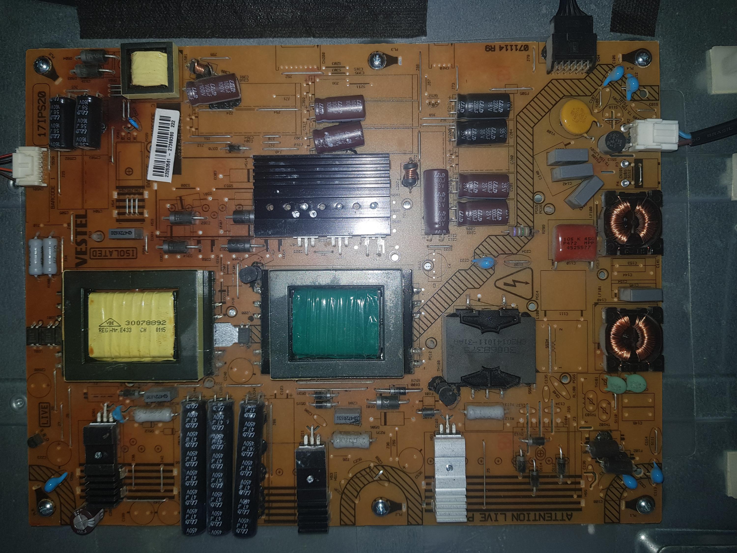

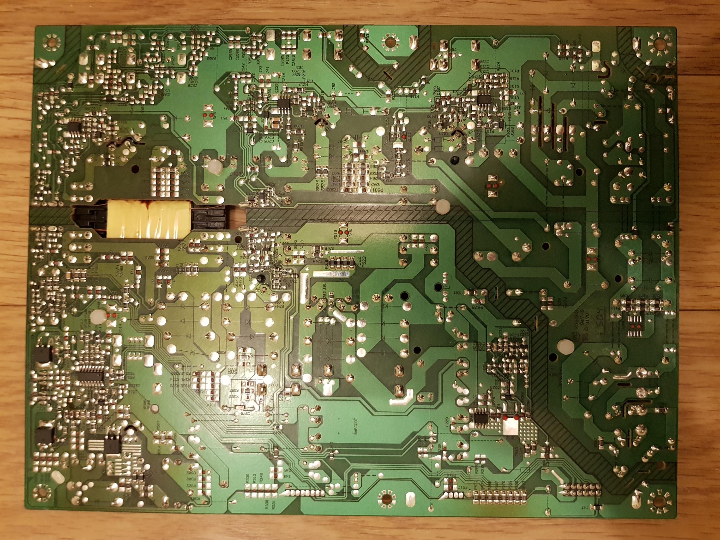

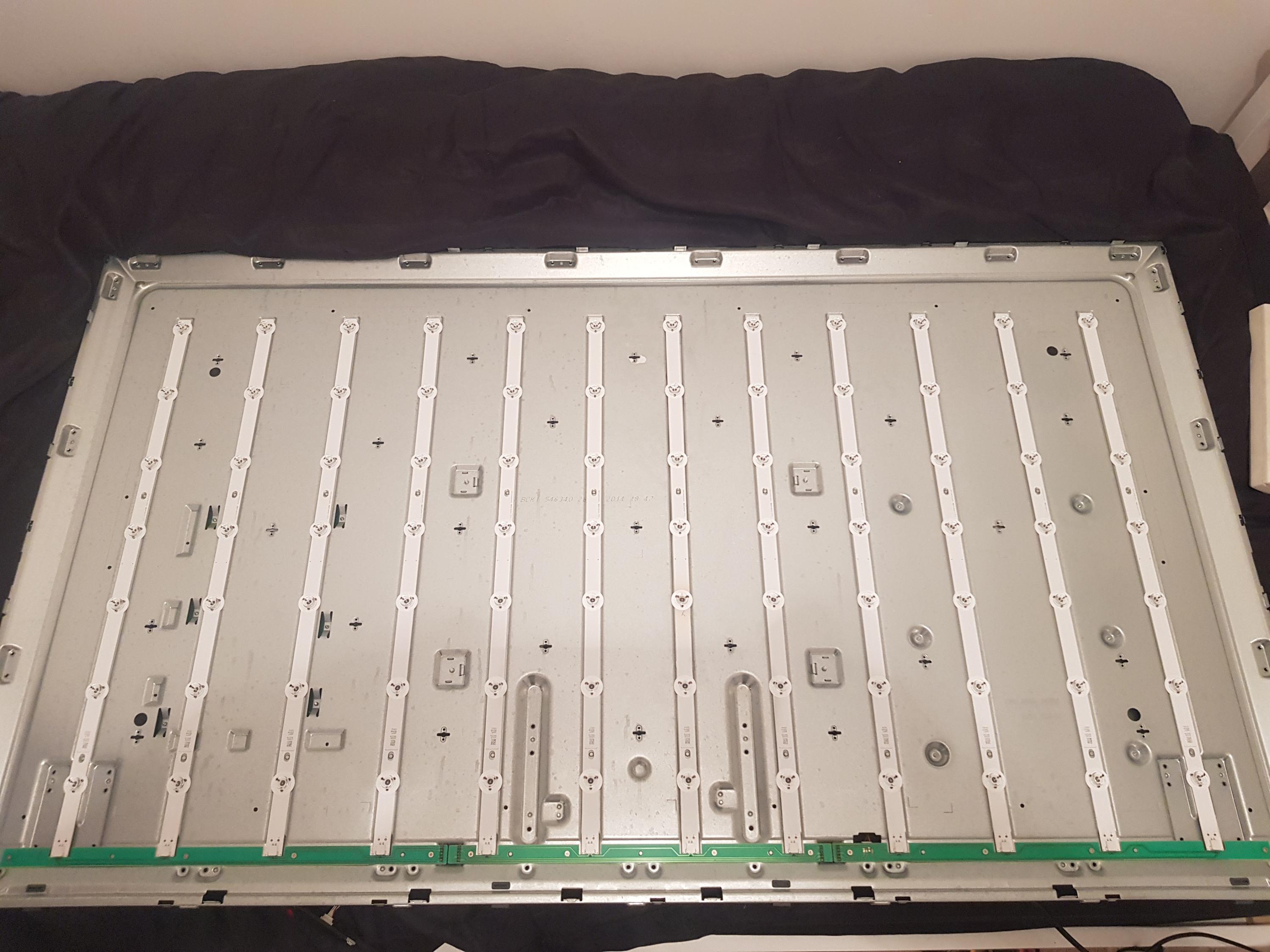

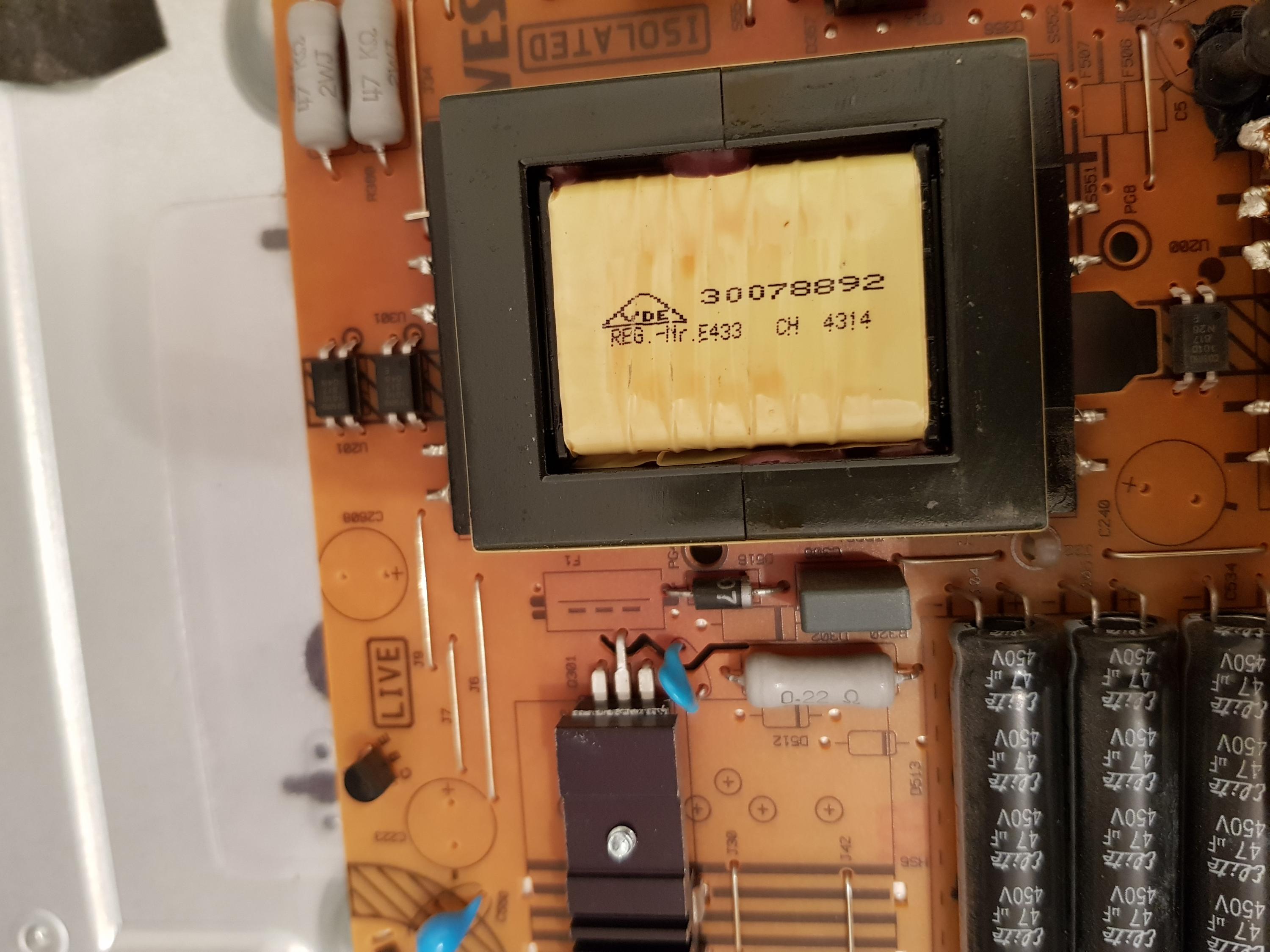

    Hi peeps, have a Panasonic TX-55CX400B here, guy I got it from said he tried to turn it on other day, and no backlights.
    When I received it last night, I plugged it in, and it came straight on and appeared to be working fine, so knowing this would only be temporary, I left it running for a good few hours, and they eventually went off. I tried turning it off and back on again, and this time the backlights started flashing at a steady continuous pace. So I turned it off and left it overnight as it was getting late.
    This morning when I turned it on, same problem, backlights flashing, so I stripped it down and tested the LEDs and 1 was dead. So changed the dead LED, thinking that would solve the problem, but it hasnt.
    So now even with the bad LED replaced, turn it on, and backlights flash in a constant uniform manor, only difference now is, they are all illuminated. Also you can hear a noise from the powerboard, that runs in time with backlights flashing. However if I unplug the backlights from the powerboard, and switch on, this doesnt happen, it comes on and holds steady.
    Ive included a pic of underside of PCB, cant see any dry joints etc, but I have included a close up of a section of the board that caught my eye, just would like peoples opinions on that section please?
    Anyone came accross this before? Or could point me in the direction of where to start with diagnostics now please?
  • nomoresonys
    • Jan 2013
    • 12276
    • U.S.
    Re: Panasonic TX-55CX400B backlights flashing on and off
    The joints in the R551 area look a little funky??
    • nomoresonys
      • Jan 2013
      • 12276
      • U.S.
      That cap by C514 looks a little suspicious.
      • nomoresonys
        • Jan 2013
        • 12276
        • U.S.
        Check all your diodes.
          Do you have backlight tester?
          If you do, what is the Vf of each LED string?
          BTW, the bad LED, was it shorted or open?
            Ive ordered one a couple of weeks ago, bit still hasnt arrived yet
            And the bad LED was shorted

            • Bloopeta
              • Jun 2018
              • 526
              • United Kingdom

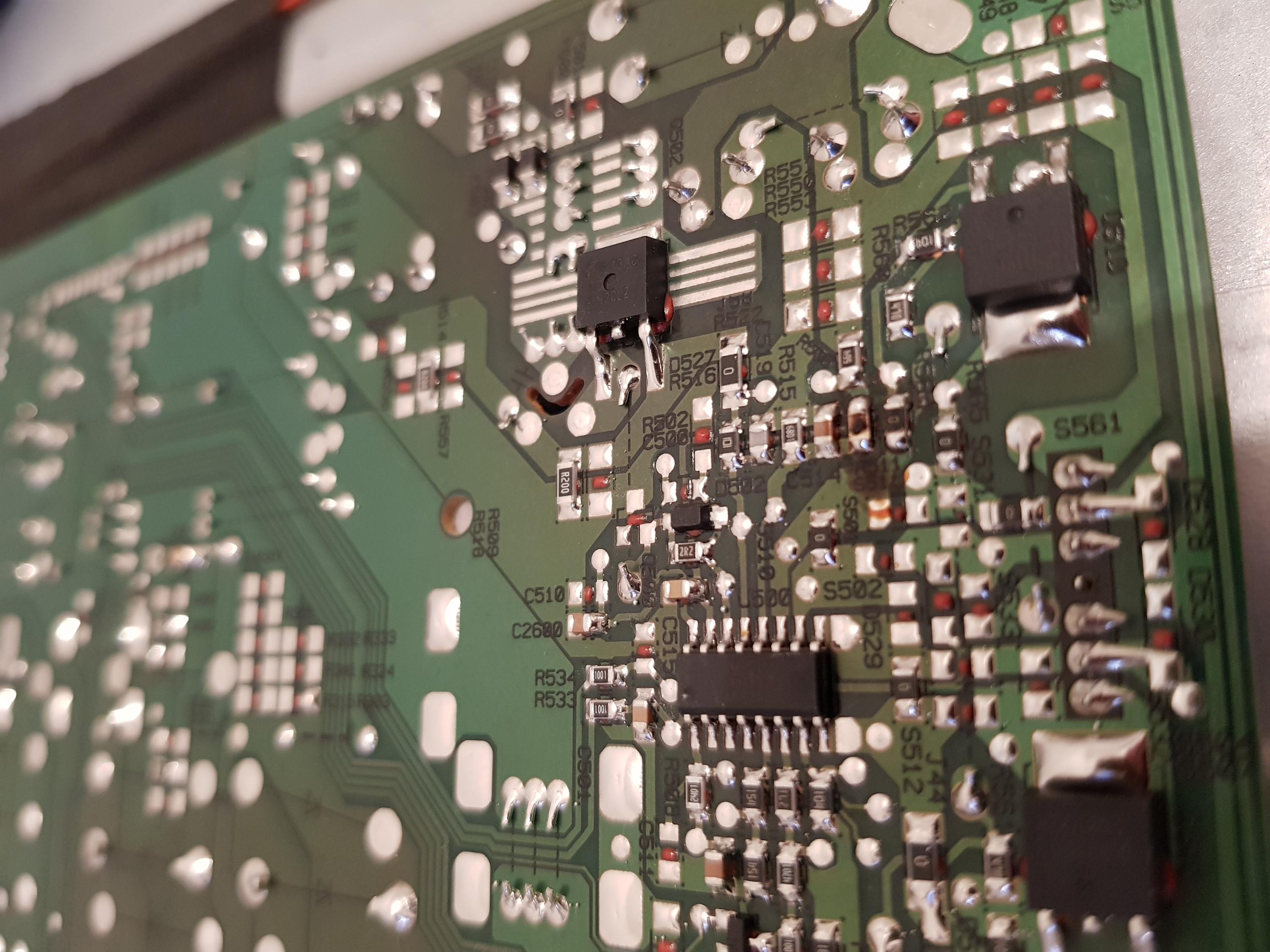

              Ive tested all diodes with DMM, and this one D516 is raising suspicion, on diode test mode its reading 020 both ways :/ and beeping both ways.

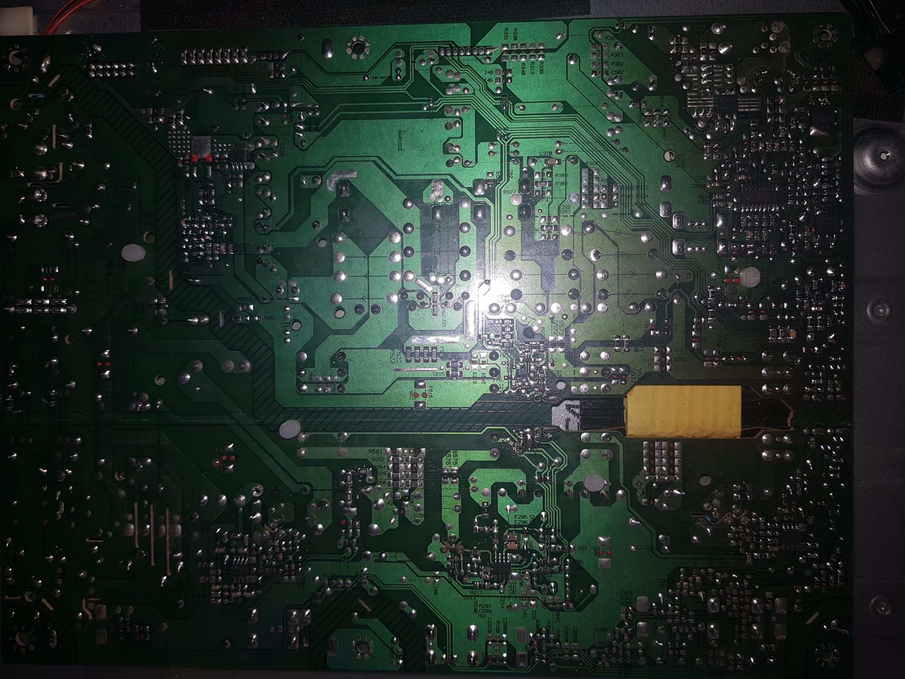

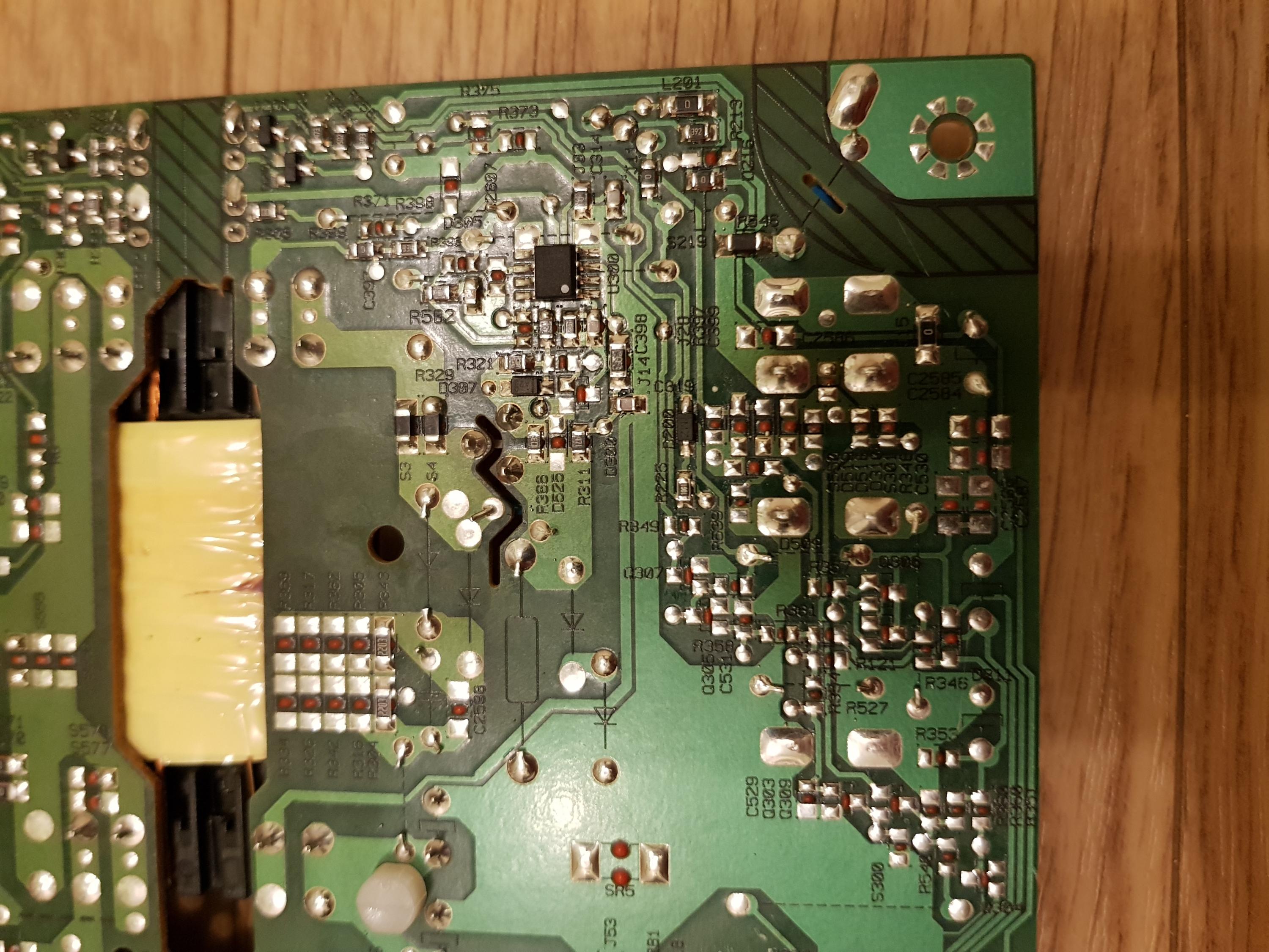

                Cane we see the bottom side of the board so we can see how that diode is connected in the circuit.
                Try lifting one leg off the board and re-test the diode.
                • Bloopeta
                  • Jun 2018
                  • 526
                  • United Kingdom

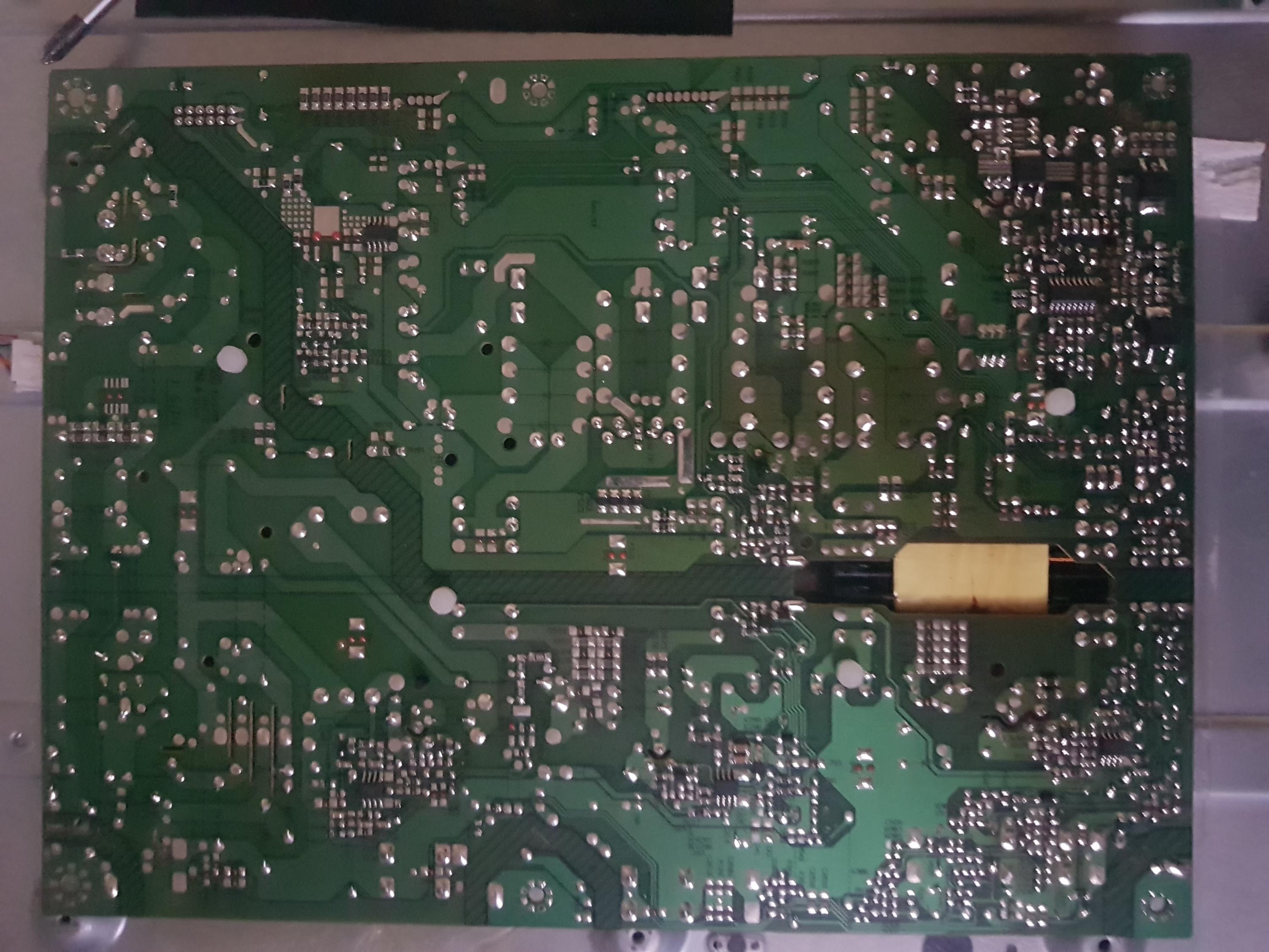

                  Here are the pics, ill lift a leg and retest and report back
                    That diode is part of RCD (Resistor/Capacitor/Diode) Snubber network.
                    The solder joint on the leg of the cap that is connected to the Cathode of that diode D516 has ring around the joint, that should be re-soldered, look at other solder joints as well for that kind ring forming on component legs.
                    • Bloopeta
                      • Jun 2018
                      • 526
                      • United Kingdom
                      I have lifted 1 leg of said diode, and getting the same reading as before, 020 and beeping both ways. So that will need replacing?
                        What are the numbers printed on it?
                        • Bloopeta
                          • Jun 2018
                          • 526
                          • United Kingdom
                          HER207
                          I have replaced it, resoldered the area you pointes out, and went over board and touch up any points that looked remotely like needed it, and hey presto, we have functioning backlights! Gonna leave it now as its 23.27pm here, and ill get it all resembled in the moring.

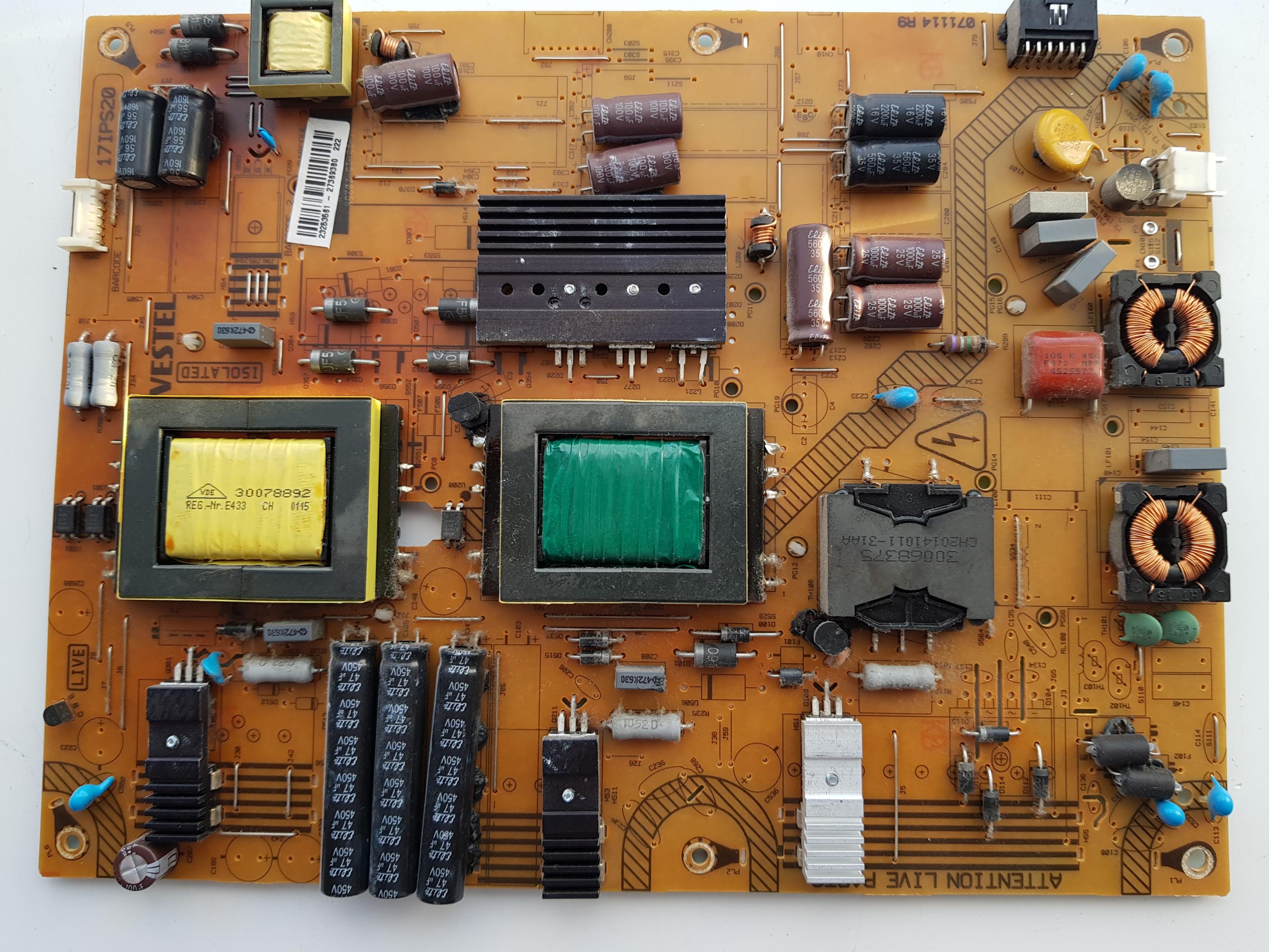

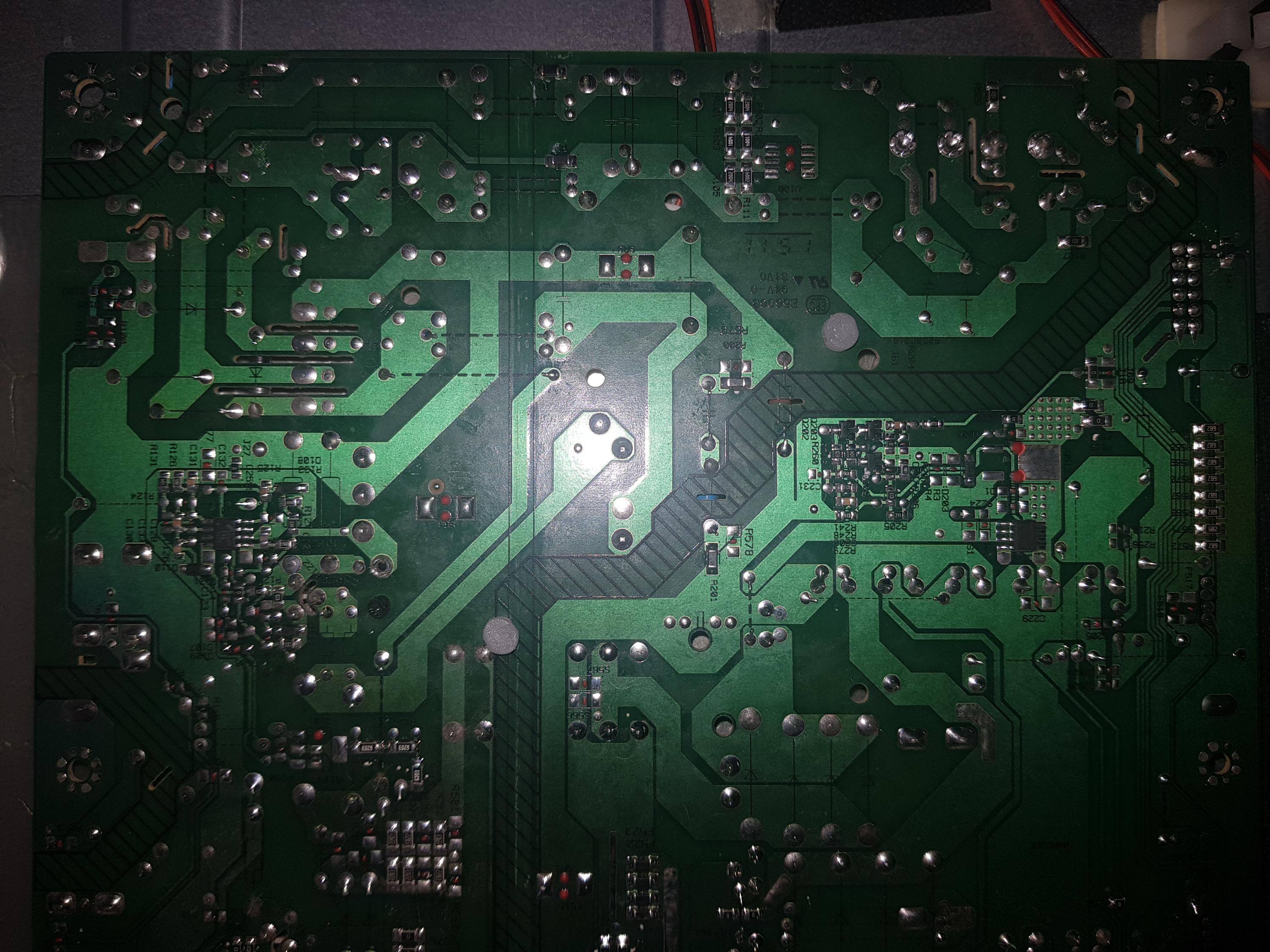

                            Backlights working but sometimes the backlight will go off
                            17ips20 low voltages across most caps
                            Led voltages upon turning on the tv will jump to 155 volts but does not drop
                            Led - 10v led + 155v led - 10v led + 155v
                            Any help please
                            • sordids999
                              • May 2013
                              • 2161
                              • uk

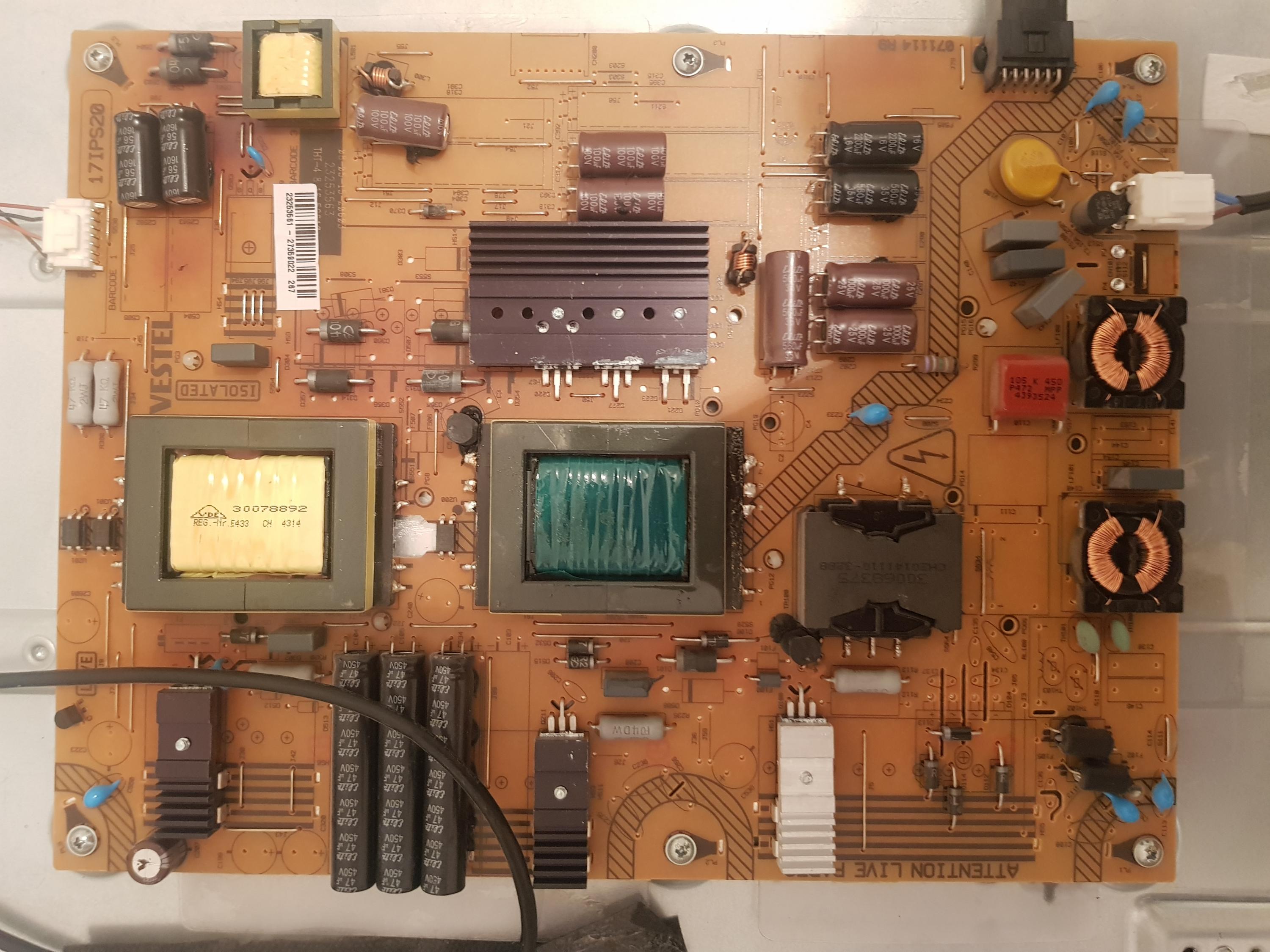

                              Pictures of the psu
                              • sordids999
                                • May 2013
                                • 2161
                                • uk

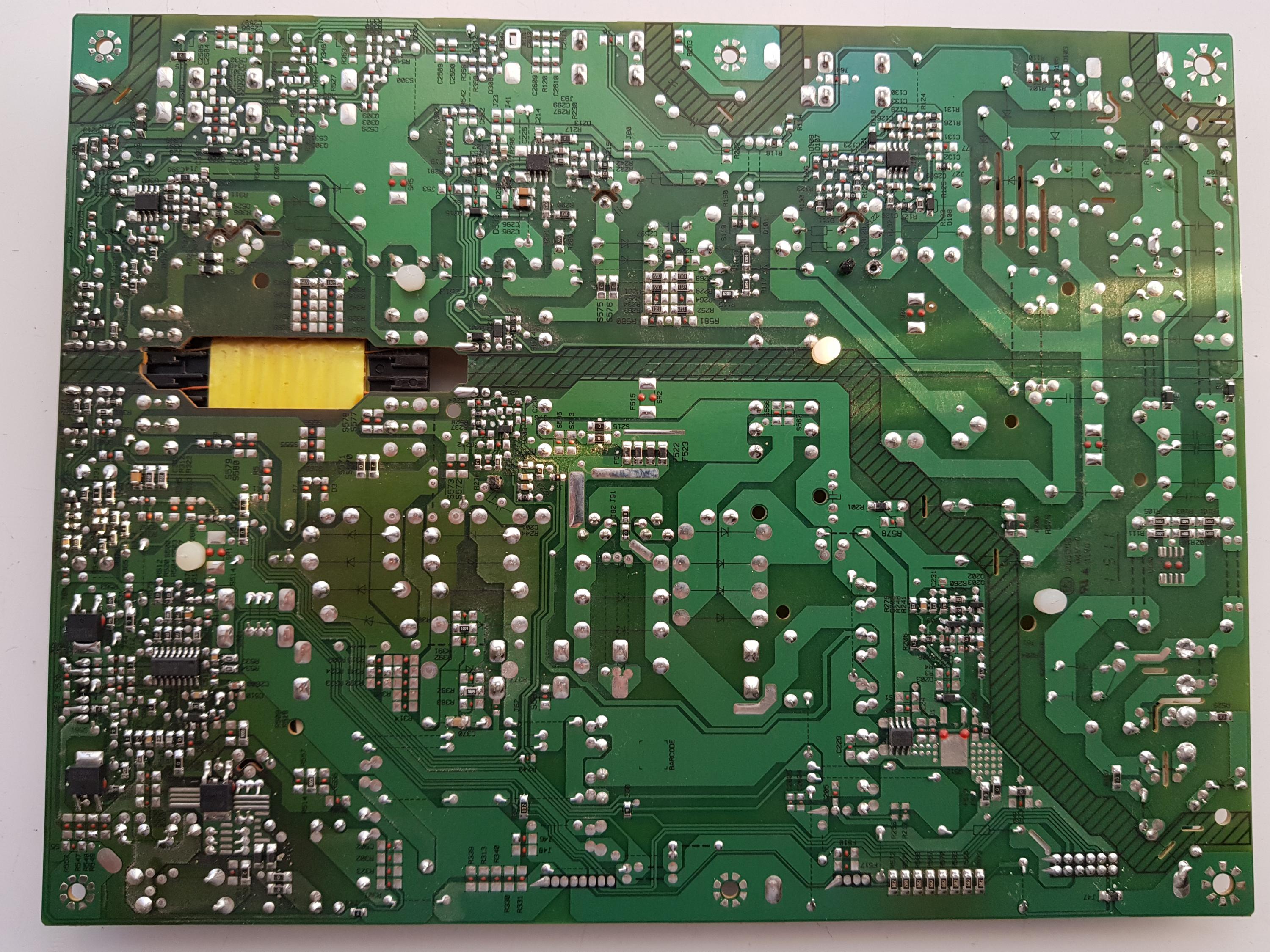

                                Sorry hopefully better pictures
                                • neilc6
                                  • Nov 2015
                                  • 1550
                                  Possibly an intermittent LED in the backlight. Did you try turning down the backlight level? Not sure if that model has local dimming as well.
                                  • sordids999
                                    • May 2013
                                    • 2161
                                    • uk
                                    The strange part is if I swap the 17ips20 which as you can see in the picture has taken alot of heat in the top right with another 17ips20 but slightly different I'm now getting a dark patch in the middle of the screen so its possibly pointing to a bad led inside the screen
                                    It's a shame because I cant find any new sets of these leds anywhere

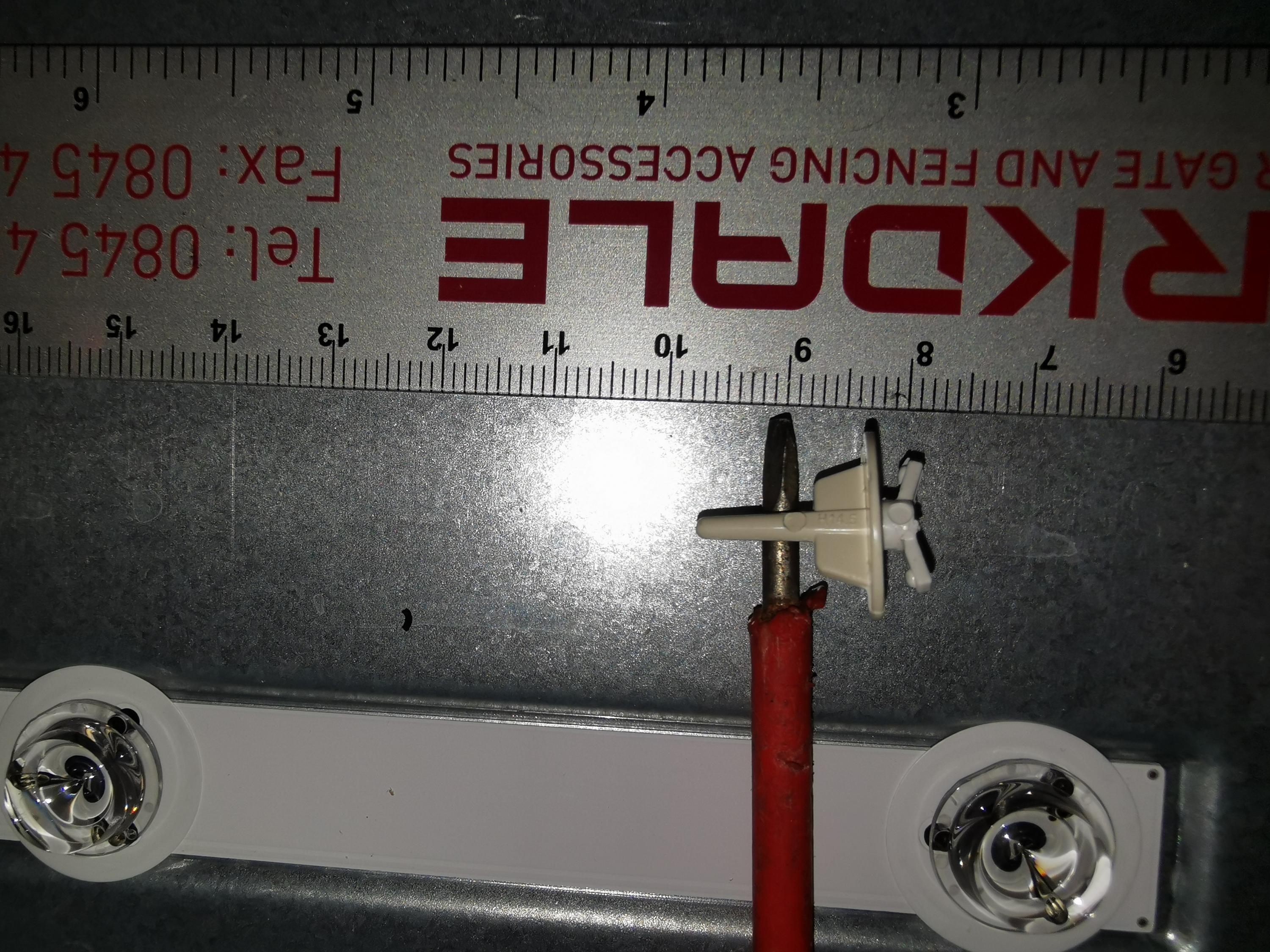

                                    • Judderz
                                      • May 2020
                                      • Uk

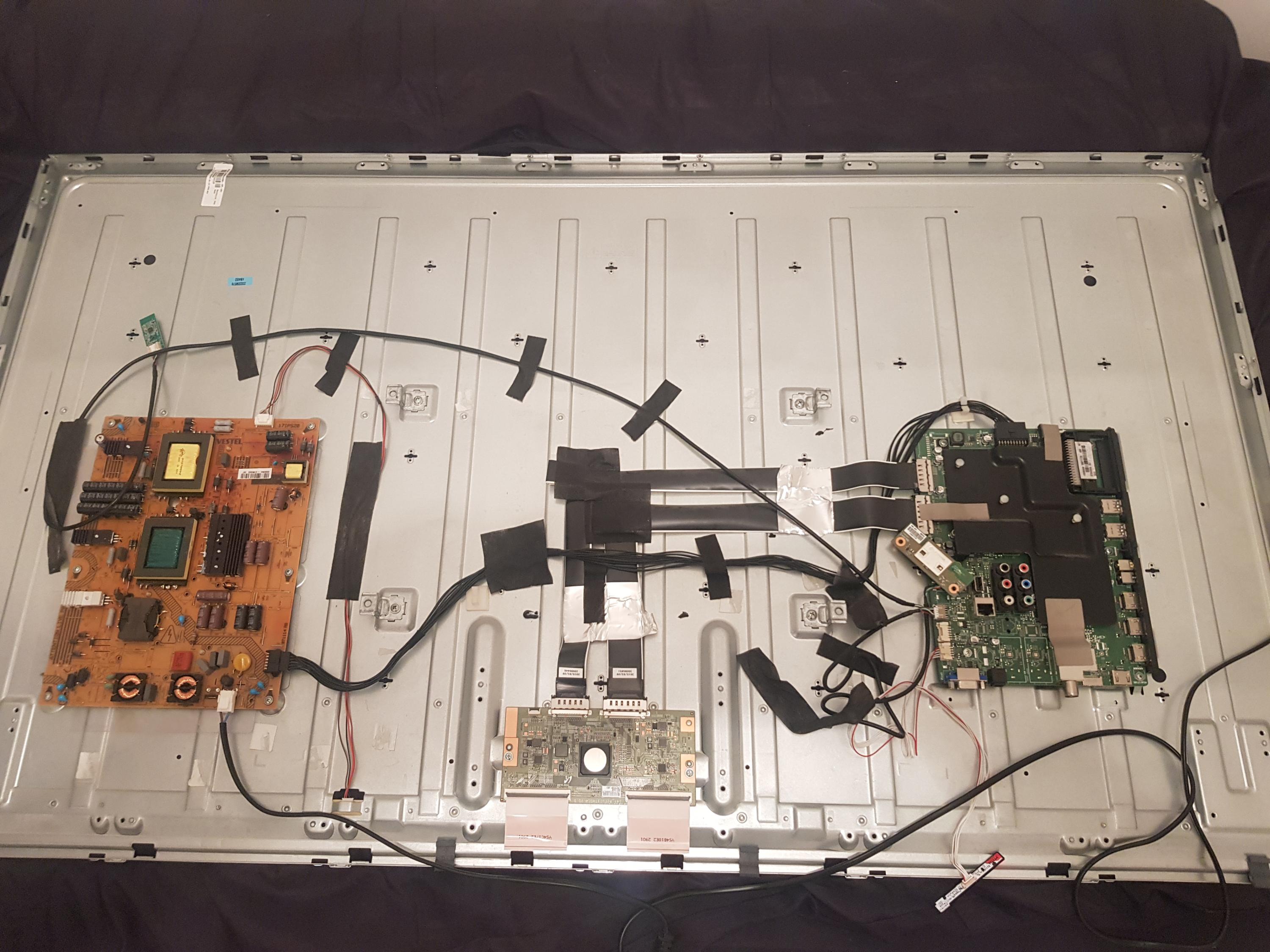

                                      Hi guys sorry jump on this thread but it's the only one with my TV
                                      (Tx-55cx400b)
                                      I'm waiting for a few bits to arrive to test properly, the screen was blank so I've done the strip down and checked and I have 3leds out (fingers crossed that is the only fault)
                                      But whilst I'm waiting for items to arrive I've just remembered that some of the spacers/risers/standoffs where brittle and broke so I'm now looking for those, but what the 🤬 are they called🤔 (see pic) please help me.....
                                      • diif
                                        • Feb 2014
                                        • 6978
                                        • England
                                        Where have they broken ? If its just the attaching lugs i just use dab of hot glue for sticking them down.
