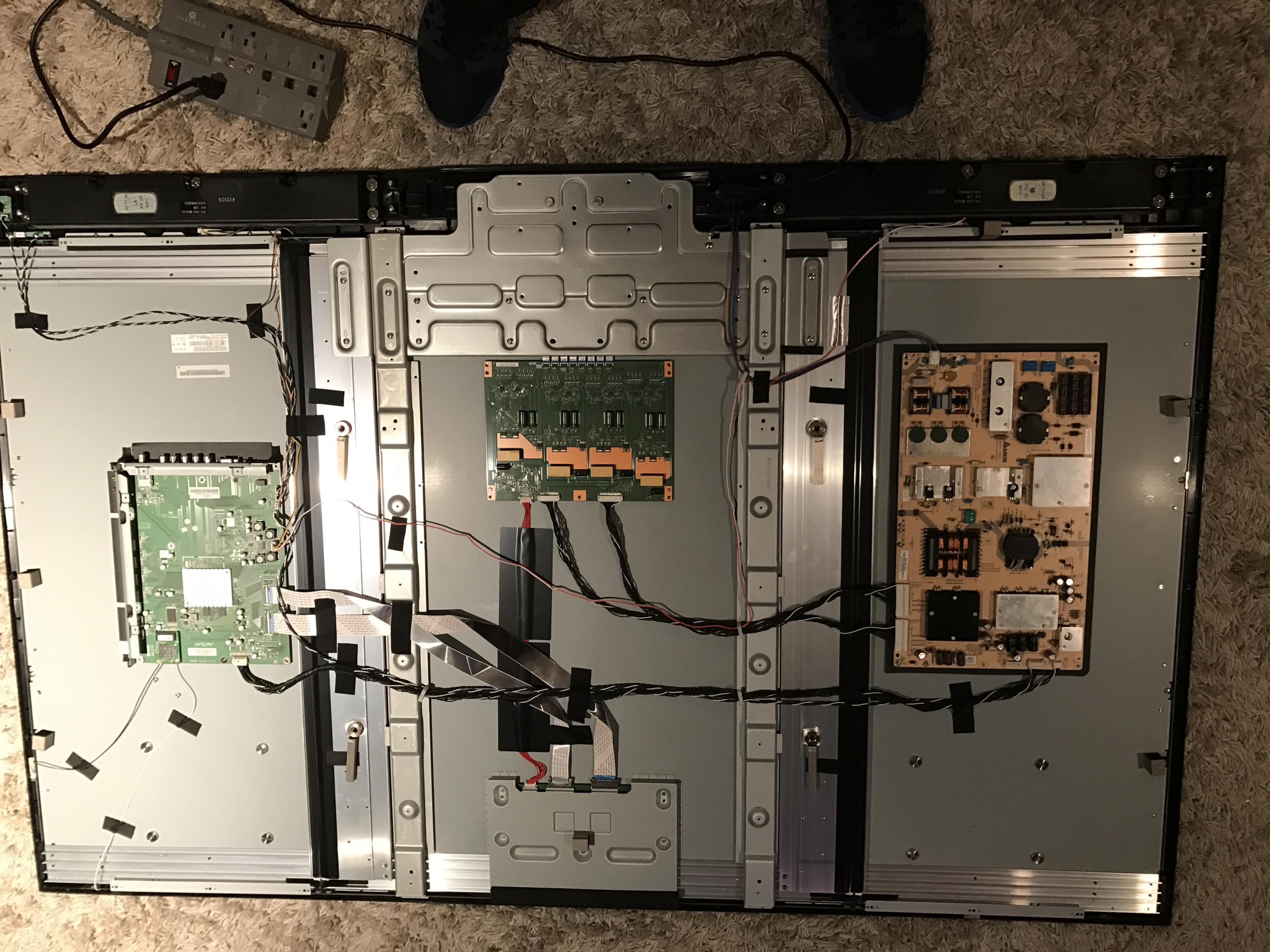

    I acquired this 65” LED 3D TV from a friend. That the claimed that while watching tv it just went out. There was nothing being displayed on screen and no sound. No light coming from the TV what so ever. There was no pop when it went out at least not loud enough to be heard. They did claim that the tv did something similar earlier in the day but it did turn back on. It was a couple hours later that I finally went out and has not been able to be turned back on by press the power button on the TV or remote.
    I've taken the back covers off and checked with my multimeter that I am getting 5vsb at the power board pins and the 5vsb makes its way to the pins at the main board even to the connections at the power button on the TV and the remote IR senor in the tv I believe that is what is called. There are actually 4 5vsb pins. When I press the power button or remote button I can measure the volts in each of their pins and can tell it is it is trying to push the 5vdc through. It doesn't appear that the main board processor is sending the turn on signal to the power board. The PSON Pin commonly referred to on many other posts on this power board I am assuming is the one titled Remote_ON/Off. There is also 1 BL_ON/OFF pin and 1 DIM_PWM_Signal pin along with 3 12vcd pins, and 5 SGND Pins.
    I watched a youtube from Jimmyshop on how to test a power board. There was a part that mentioned using a jumper from the PSON Pin (assuming it is the Remote_ON/Off titled pin on this power board) to a 5vsb pin. When I do this it does then generate the 24vcd from the power board to the led drivers connections and the 18vcd from the power board to the main board which powers the speakers. I have the TV plugged into a surge protector as soon as I flip the power switch at the surge protector I can hear a poof sound from the speakers. I unplugged the speaker connections to clearly hear for other sounds and I do hear a faint I guess you could call it a click. It sounded like maybe a relay switch on the power board.
    I would assume that based on my limited tv and electrical knowledge that I would blame this tv's issue on the main board because the power board appears to generate the vdc to power the necessary components of this TV.
    In the same youtube video about checking your power board there it was also mentioned checking to see if the backlights would turn on. I am confused on this part. I can't seem to figure out how to force the backlight on. I thought that I could do another jumper from the 5vsb to the BL_On/Off pin and or another jumper from another 5vsb pin to the DIM_PWM_Signal but when I try to this nothing happens as far as lights coming on, I do appear to get the 5vcd on the BL_On/Off but only 2.5vcd on the DIM_PWM_Signal at the led driver pin. I am just using a straight wire to do the jumping from the connection unplugged at the main board. I already get the 24vcd from the power board to the led drivers. What might I be doing wrong trying to get the backlights to turn on?
    Is it possible that I may have both a bad main board and led driver board at the same time? Is it necessary for the main board to work correctly to even be able to attempt to test the backlights?

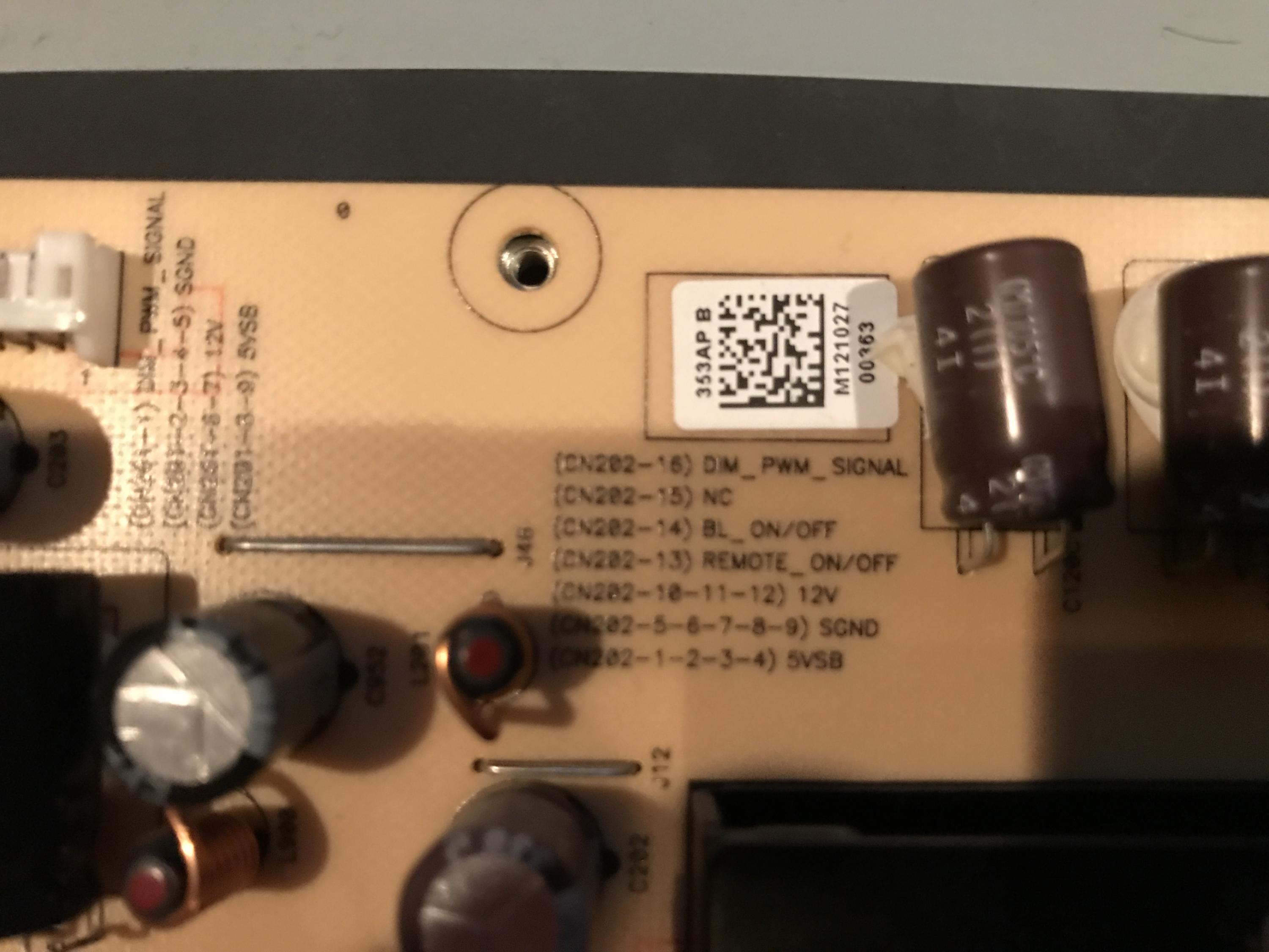

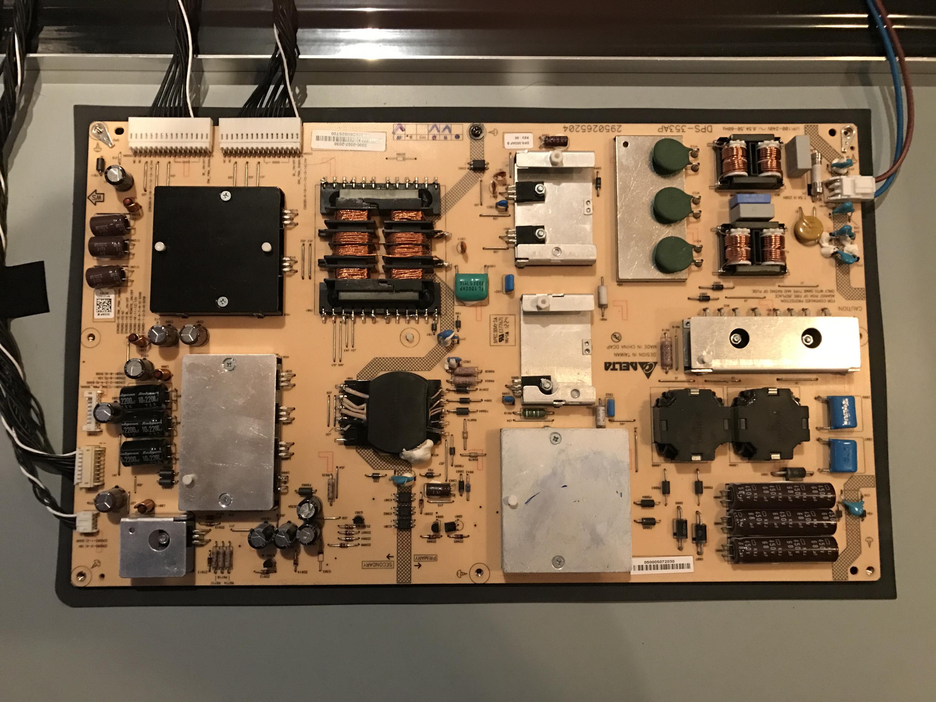

        I have numbered the pins, provided their descriptions and dcv readings.
        Budm by “when TV is not turned on” I want to ensure you mean the tv is plugged in and the surge protector on. If so then the dcv readings are what I have listed.
        By “power switch is activated” are you referring to when I attempt to press the power button on the remote or remote power button? If so there is absolutely no change to the 5dcv readings. Nothing appears to happen at all pressing the tv or remote power button.
        I do want to point out that when using a straight wire on CN202 on the main board end and jump from pin 1 (5vsb) to pin 13 (REMOTE_ON/OFF) I do get the dcv readings that I should be getting.
        Power Board CN202 connector. CN202 connects to the main board.

        Power Board CN203 connector when the TV is plugged in. I believe this connector powers the speakers. CN203 connects to the main board.
        1 SGND = 0vcd
        2 SGND = 0vcd
        3 18V = 0vcd
        4 18V = 0vcd
        Power Board CN204 Connector. CN204 connects to LED Driver

          OK, so when the power switch on the TV is activated, I expect the:
          13 REMOTE_ON/OFF (same as PS-ON) = to go high (>2.5VDC) when power switch is activated, this is PS-ON signal from the main board to turn on the rest of the power supply.
          '13 REMOTE_ON/OFF = 0vcd
          14 BL_ON/OFF = 0vcd
          15 NC = 0vcd
          16 DIM_PWM_SIGNAL = 0vcd'
          So right now the main board is not sending any command signals to the power supply board at all.
          Main board will have to be troubleshoot.
          There are two SMD fuses on the main board, one of them is for 5VSTBY so you should have 5VDC at both end on one of the fuse with ref. to the chassis GND.
          Another fuse is for the switched 12VDC.
          "I do want to point out that when using a straight wire on CN202 on the main board end and jump from pin 1 (5vsb) to pin 13 (REMOTE_ON/OFF) I do get the dcv readings that I should be getting."So when you remove the connector from the main board and force on the power supply, you should then see the 12V and the 24v at the power supply connector if the power supply is OK. BTW, I always 1K resistor for jumping in case the mistake is made so you will not damage the circuits.

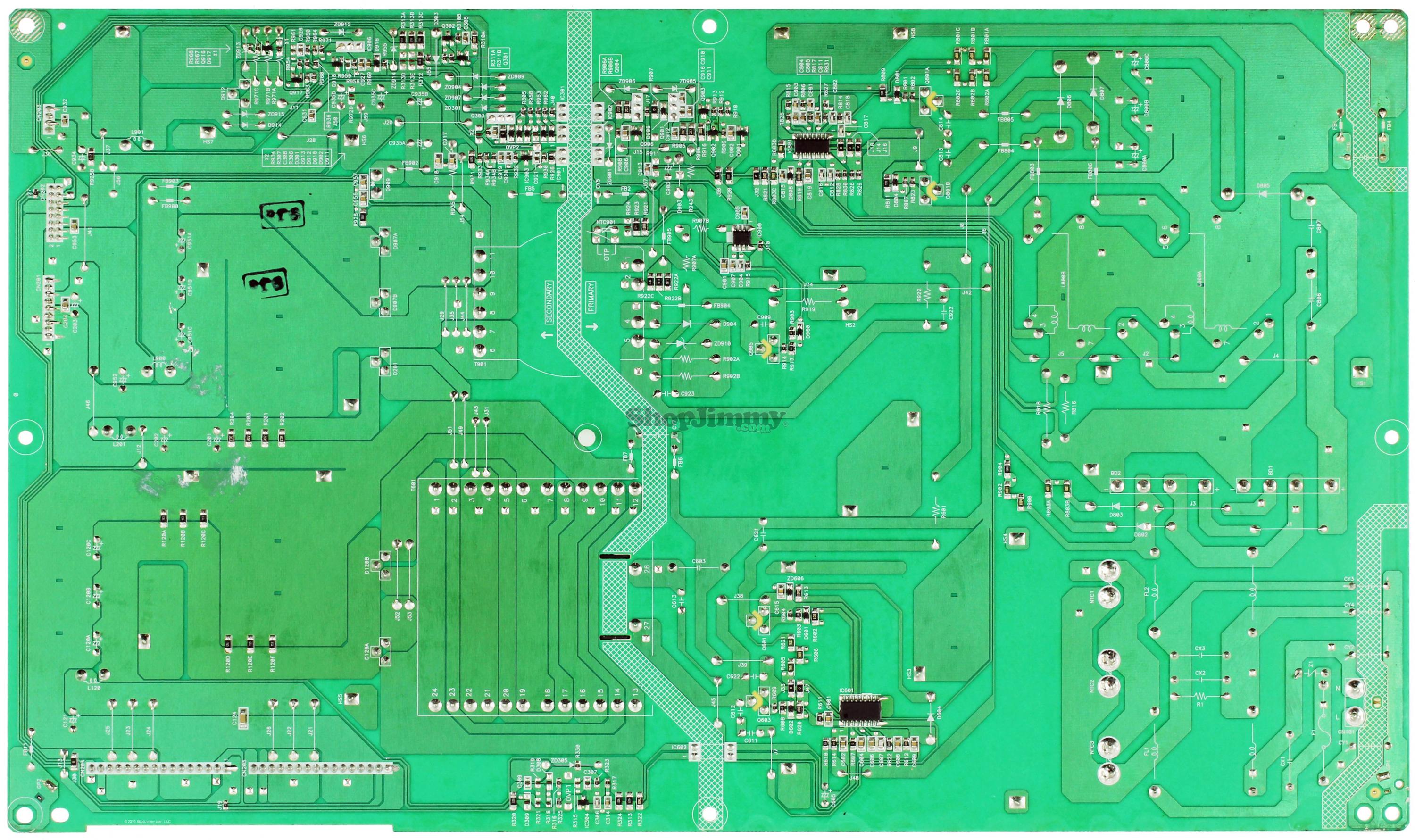

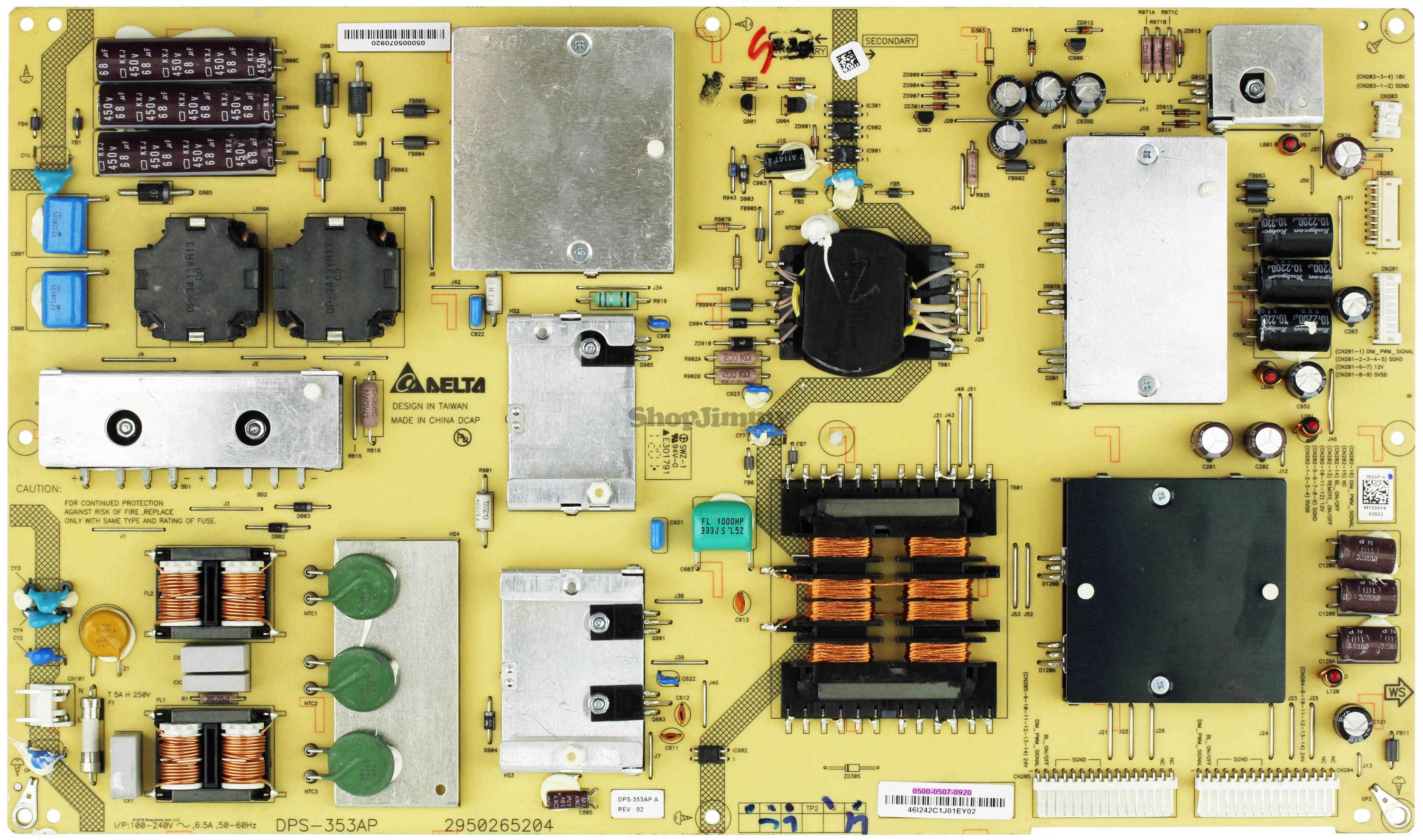

                    I would inspect the power supply real well for bad soldering works first.
                    Vizio 0500-0507-0920 (DPS-353AP) Power Supply for M3D650SV
                    http://www.shopjimmy.com/vizio-0500-...upply-unit.htm
                    Check the fusible resistor R601 (0.22 Ohms) for the 12V/24V SMPS section.
                    Pictures provided by SHOPJIMMY.

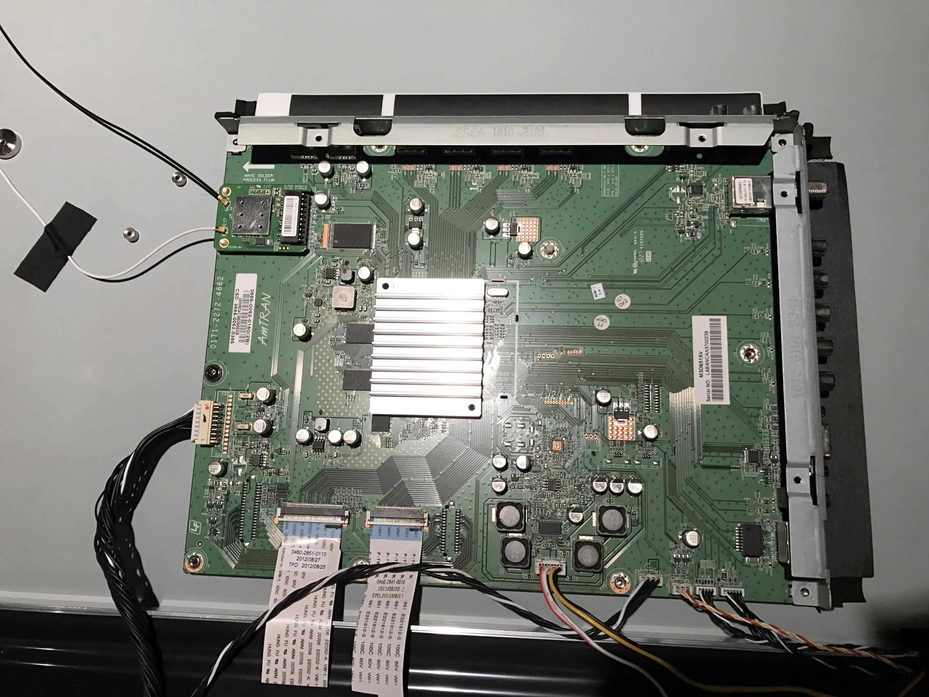

                                I have checked the voltage regulators and here are the vdc readings.
                                The main board appears to have 3 voltage regulators.
                                UP13 board location
                                H11170 line 1 of voltage regulator
                                1.2 224 line 2 of voltage regulator
                                Pin 1 0.00
                                Pin 2 1.21
                                Pin 3 3.31
                                UP14 board location
                                AX 11170 line 1 of voltage regulator
                                2153 line 2 of voltage regulator
                                Pin 1 2.06
                                Pin 2 3.31
                                Pin 3 5.23
                                UP15 board location
                                Pin 1 2.06
                                Pin 2 3.31
                                Pin 3 5.23
                                It appears the voltage regulators are working properly. There are 2 capacitors next to each of the voltage regulators and they line of with the voltage in and voltage out readings.
                                Are there any issues with the vdc readings? If not what is the next step to check?

                                  Well after reviewing some other posts. Since I think the voltage regulators are ok and looking over some other posts maybe the next step is to check the Low Dropout Voltage regulators. These appear to be 8 pin LDOs.
                                  There appear to be 4 of them on the main board. The printed letters and number are so tiny to read off the LDOS I am going to need to get a magnifying glass to read them but for now I'll try to post what I thinking the printed letters and numbers might be. There is a small white dot around the LDOs I am going to assume that is supposed to indicate that the pin nearest to the dot is Pin 1.
                                  Here are the their vdc readings
                                  CL1 Board #. This LDO is located nearest to the connector that supplies the 5vsb.
                                  4635P line 1 of LDO
                                  ACCJAP line 2 of LDO
                                  Pins 1 through 8 all read 0.00vdc
                                  UP 12 board #. This LOD is located below the LDO mentioned above.
                                  0291 line 1
                                  A152B line 2
                                  Pin 1 5.22vdc Pin 8 5.21vdc
                                  Pin 2 0.80vdc Pin 7 0.96vdc
                                  Pin 3 0.00vdc Pin 6 0.00vdc
                                  Pin 4 0.80 Pin 5 5.20
                                  UP 10 board #. This board is located to the right of the LDO mentioned above.
                                  A152B line 2
                                  Pin 2 0.80vdc Pin 7 2.08vdc
                                  UA1 board #. This LDO is near the connector that supplies power to the speakers. When I use a jumper between a 5svb pin and PS_ON I can hear the speakers power on. I do not believe this LDO has an issue. I will list their vdc readings. I will get these readings with the jumper in place.
                                  Pin 1 8.48vdc Pin 8 17.05
                                  Pin 2 8.50vdc Pin 7 8.50
                                  Pin 3 8.28vdc Pin 6 8.50
                                  Pin 4 0.00 Pin 5 8.28
                                  Unfortunately I don't have an idea of what the 1st 3 LDOs should read. Why does the 1st LDO not have any vdc readings. LDOs UP12 and UP10 are about the same except for Pins 7 on each LDO, is there an issue with Pin 7?
                                  I think we are pretty sure the main board is the issue. There just aren't any main boards with my board # or part # available. I am going to have to figure out what on the board is wrong and replace whatever pieces are the issue.
                                  What should my next step be?
