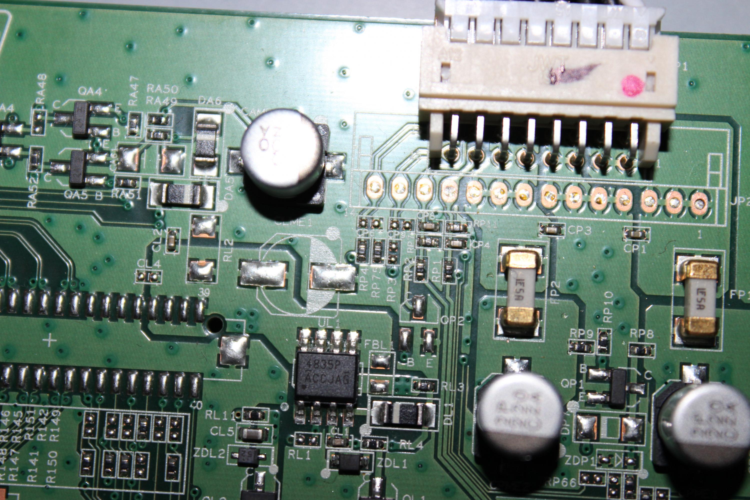

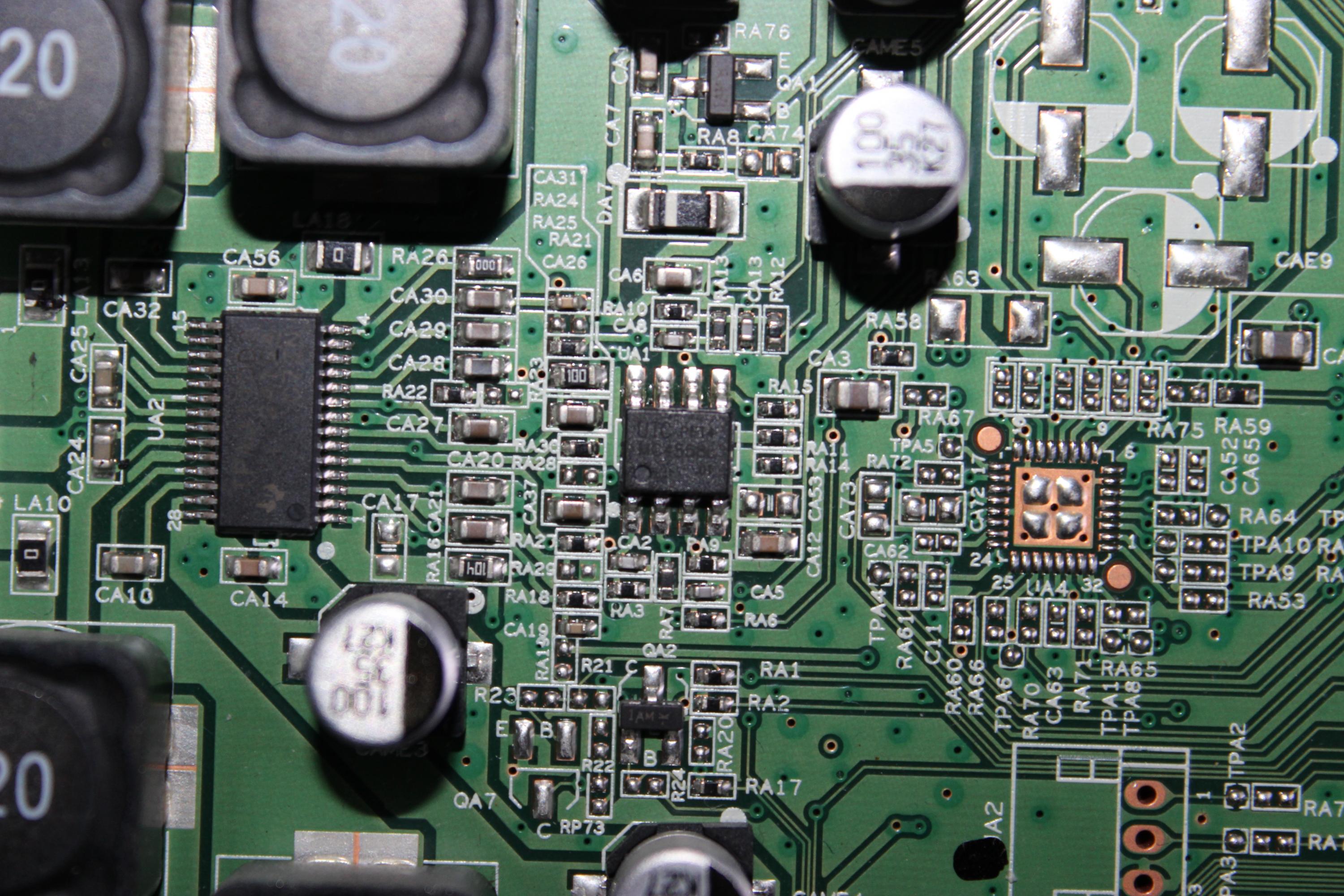

      After looking at pics of some EEPROMS I think what I listed as the 1st and 4th LODs on my post about LODs vdc readings could possibly pass as an EEPROM instead of LODs. I had to get a good camera to take picture a good picture of those tiny things.
      Attached is a picture of each.
      The 1st pic is located near the main connector from the power supply board.
      The 2nd pic is located near the 2nd connector from the power supply board. I can get these 8 Pins to read VDCs when I jump the main connector 5vsb to PS_ON.
      No matter what I can't get the 8 pins in the 1st picture to get VDCs.
      Are either of these the EEPROM? Are they both EEPROMs?

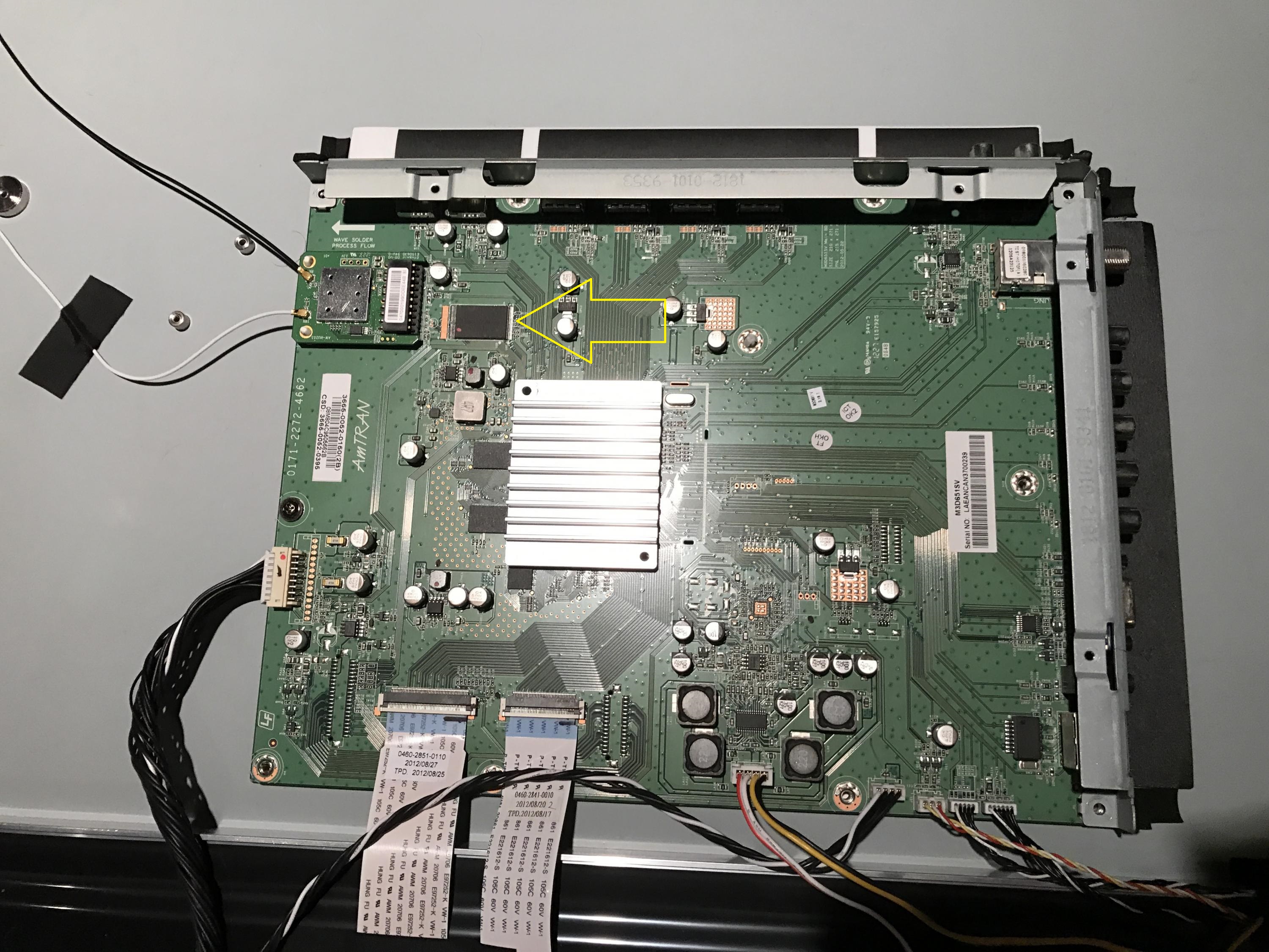

          This is a smart TV, it have a flash memory not a EEPROM
            Re: Vizio M3D651SV will not power on
            I aways make this mistake im so used to working on older tvs with eeproms/spi flash so ecking767 do you think the flash memory could cause the issues hes having? can it be reloaded?
              So the 2 pics in my last post are LDOs? Were the vdc readings ok for the ones I posted vdcs for?
              I can not find much information regarding a flash memory or flash chip for this tv. Is there any other testing I could do to pin point you get me closer to narrowing down the issue?

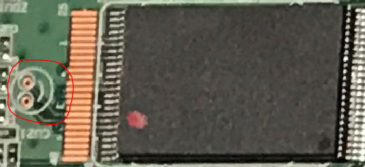

                I was doing a close up of the flash memory to see if I could see some numbers printed on the flash memory unfortunately I could not.
                However upon looking closer is it just me or do y'all notice the smiley face to the left of the flash drive. I have circled it on the attached pic. I feel that this main board is laughing at me. I swear that smile is intentional on this board.
                How about those 2 points on the eyes is there some check I could do on those that would tell me if the flash memory was the issue?
